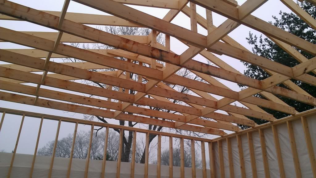

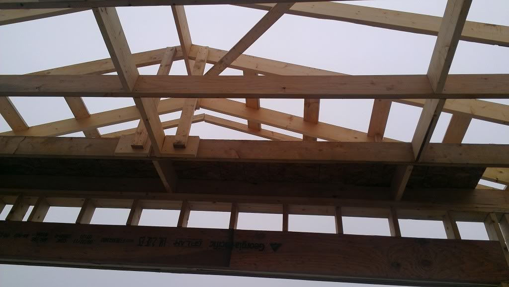

Been doing some roof work.  No trusses, framing it all with 2x8 rafters.
Showing the ladder framing for the gable end overhang.  Notched the last rafters and layed 2x6's across.

R u gona do a overhang on the gable ends or just run them flush with the wall?
jeremy_nash
  • Posts: 129
Re: Building a garage!
« Reply #64 on: January 24, 2012, 02:22:00 AM »
In the pic looks to be a 12" or 16" overhang
