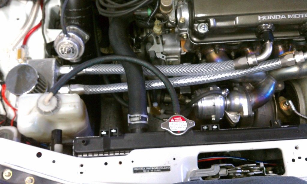

Catch can is in! Need to get a couple of heat slaves to put over the catch can lines. Couldn't find any braided line local for a decent price so went with this veal. Would rather use garden hose if it didn't get so hot.
Also replaced pass side axle seal. Bitch was leaking pretty good. Seems good now though. Getting a alignment tomorrow, and if the roads dry up I might get a touch of basemap clean up action!
