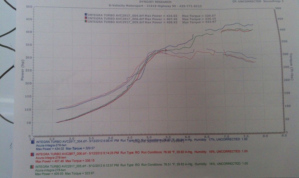

Well I met my goal.........
I said I was gonna push something to the limit. And I did.....and that was time. If I had more I would have kept cracking the mbc up. I was hitting and holding 27.1psi and the last 500rpms it was falling to 25.9psi so it held pretty solid. Maybe next year we will crank it up some more and mix in a little race fuel. All in all I'm really fucking happy.
 RHMT LSV 26psi on pump gas

Send me a copy of your .cal....
And a log if u have one...
I wanna see why that dyno graph looks like that....
Otherwise I know how you feel...
T04e fed into a Jrsc unregulated...  Gives you the same feeling you get @6k, at about 4k....    Whiplash machine;  doubly so when boostcut was set at 18psi (top seen was 38; usually 32 from heat losses).  This is 6.5psi turbo x 6.5psi Jrsc - heat losses from Jrsc == retarded.  Resulted in exploded oem jdm d15b.

You can see where you reach target boost;  the graph hp increases, but is very wavy....  Usually you see a steady increasing flatline or curve.  Also how tq rises just after 6k and doesn't stay flat ( showin me its not being tuned for mbt; in which tuning for mbt is when you usually see the best power curve).

Well I really wouldn't call it a tune, more like "have Dave, watch my shit on the dyno and make sure I don't blow it up"
I'm leaving for Jamaica in 3 weeks to go on vacation and when I get back I'm gonna probably get with dave and have a full street tune done, and then finish it off on the dyno until my clutch slips.
Also, we were running old crusty ngk 4644 that were gapped @ .035 and then threw a set of 4554s in and it cleaned up a little. So I have a feeling that there is still quite a bit more power to be made. It's just a matter of weather or not I can put it to the payment.

I see 30-50+up based on the drop in tq and the dip before 6k.
I know for sure it's the VTEC crossover causing the early dip; but your fuel and timing maps will reveal the true story of the pre and post 6k dips.
Plus I'm interested to see final timing's role in your hp number.... And how far you pushed it up if at all.
I myself gravitate toward .75*/psi above 6pounds...  On extremely high compression your timing window is immensely smaller.
So if u get a chance, shoot it over.  I'll give some notes on what I see and why it affects it.  Helps you build the knowledge :)
4554 is my favorite plug.  Never needed 9's...  I generally rape 7173 until I get blowout @.019; then switch to 4554 @.027 and work my way down.

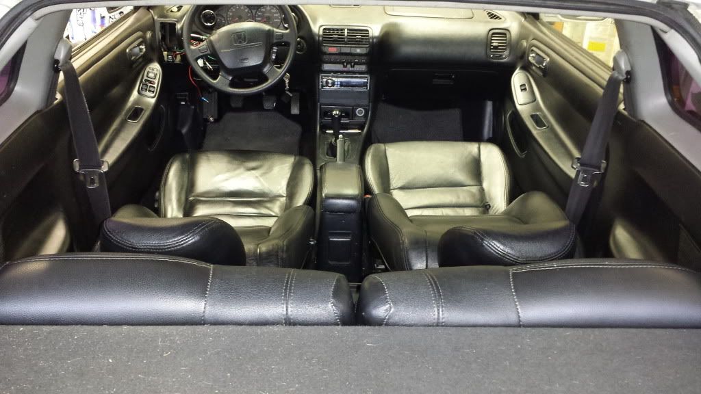

Well its sold. Since the last time I posed in the thread my family has grown. Had a kid and swinging a car seat in and out of this teg everyday was a pain. Had a really good friend that was looking for a boosted car and I told him I would sell him my dc. He paid me $6250. Figured I didn't do to bad considering I only paid $500 for this rolling chassis. Probably broke even with everything I've put into it. I installed new carpet b4 i sold it. Hes gonna clean this thing up better than i ever would have.
New carpet

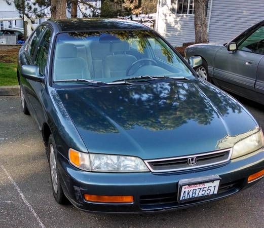

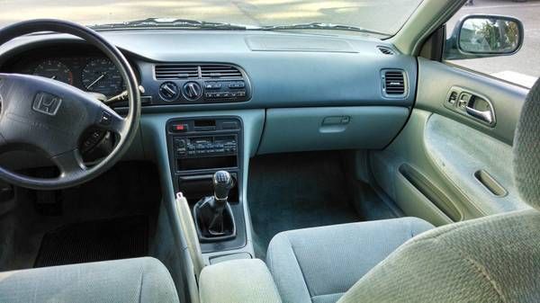

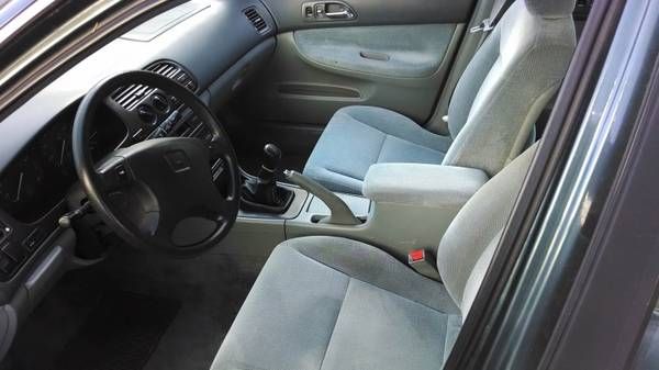

In the meantime i Picked up a new daily beater. 96 accord lx 4 door 5 speed non vtec, non abs :) $1800
I'm the 3rd owner of it. The guy I bought it from is in the Navy and is getting shipped overseas. He bought it from the the 1st owner who lives in the same town as me and all the original paperwork from when it was purchased from the dealer is in the glovebox. Clear coat is peeling in some spots and the front bumper has some pretty good scratches in it but for a daily beater I'm pretty happy. Only spent 1800 so I can't really bitch. Overall I really like it.
Gonna do a timing belt and water pump cam seal and balance shaft seal. Ordered up some window tint gonna try my hand at doing it myself. I guess I'll see how much of a pain it is. Other than that I'm gonna drive it until the wheels fall off.
