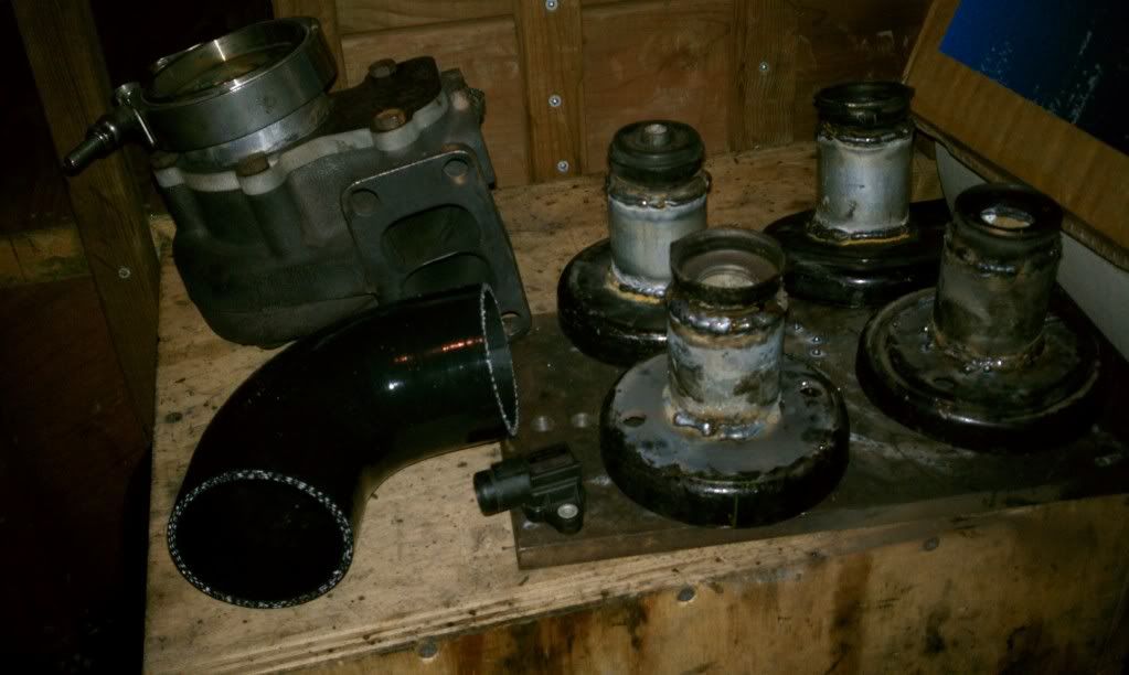

ok, so I got a couple of things done.
1. Got my RHMT extended top hats built. Although ripping through them on the hf Mig I managed to flip one of the pieces and weld it on upside down, so it has to meet Mr. Chop saw and get re welded.
2. Received my ported 12cm exhaust housing from crxvtec91
3. Got a Holset exhaust flange from Adam At Columbia River Mandrel Bends
4. Welded up my 3" x 1/2" exhaust piece on the Holset exhaust flange so I could weld my v-band flange to it so I could still get to the bolts if I had to.
5. Made a 4bar map sensor in a stock case.
6. Received my 2.5" 90* silicon coupler for my Holset, so Now I just need to grind down the v-band on the outlet of the compressor.
And I also Had a buddy weld a couple of an -10 fittings on my spare valve cover so I can vent it when this bitch is boosted.
7. So I got me a ebay 3 point strut tower bar for christmas so now that bitch is bolted on now too.

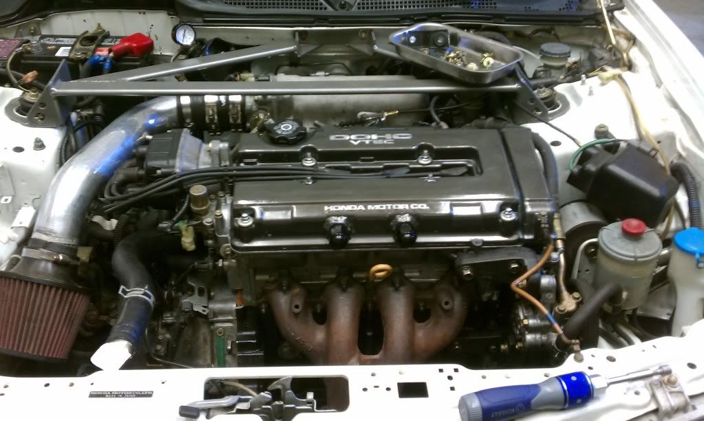

Well IM DOIN WORK! Got ectune. Took me awhile to figure out all the flaming hoops of glory but got it down. Tuned the car pretty easy myself. To the point I would feel comfortable tuning it on 15lbs myself.  And then taking it to the nog for the final rippers. Also been doing some work in the garage finally (4 years later) wiring up my lights. I had 2 light bulbs hanging from the 12' ceiling. I now have 8 8' HO florescent fixtures. Im gona get a sunburn while working on cars now. So Friday and Saturday are gona be dedicated car days for me this week. Got a huge list of things I want to knock out.
1. Get metal shavings out of valve cover
2. Put on new valve cover
3. New oil pan gasket
4. Put my other oil pan with my turbo return line bungs on.
5. New cam seal/vtec sol gasket/dizzy oring
6. Put half core rad in
7. Put new cv axles in
8. Wire up resistor pack and put 72# injectors in
9. Put 255 pump in and re wire with 10 gauge and relay
10. Put 4 bar map sensor in
11. Tune it so I can at least drive it
12. Mount intercooler for mock up
13. Start fab of charge pipes
14. Grind Compressor vband off.
15. IDK what else, ill have to look at my whiteboard if I get that far.

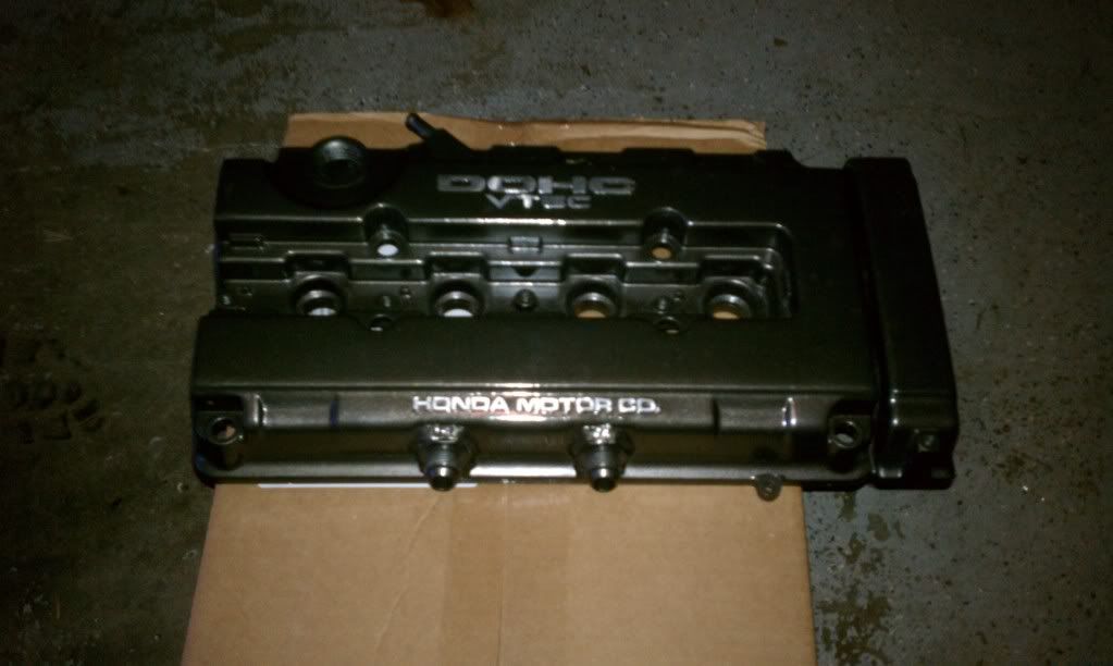

Well I had a friend weld up a couple of -10 an bungs on a spare valve cover that he had. Turned out good but he didn't clean out the metal shavings b4 he painted it for me. Needless to say I couldn't use the good old brake cleaner to wash out all the shavings. So said fuck it, in the dishwasher it went. Loaded her up with dishwasher detergent, and set that fucker to pots and pans. House later it was spick and span clean.  It left some water spots on the valve over...lol should have used jet dry... So a little simple green and a paper towel and its good as new!

Got some of the shit done. Also put my Russell fuel filter fitting in with my fuel pressure gauge. Confirmed that the car ran with injectors. Ran rich, but fairly ran. Flushed the coolent system because the copper head gasket spray that was on the portion of the head gasket where the coolent hits made that water fucking nasty. So I got the half core in but before I go any further with installing it I pulled the front bumper off because I figured while its out I can get my intercooler mocked up and see where I need to hack my radiator support for the double back door portion of the charge pipes to clear. Also gona buff the headlights lenses while the bumper is off too. I'll get pics if shit tomorrow while I button shit up.

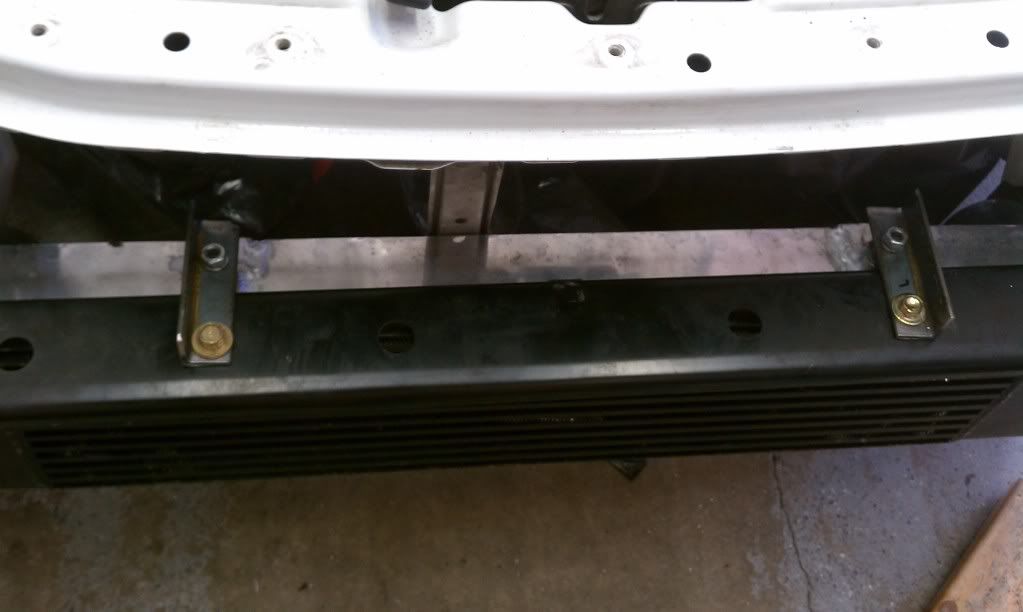

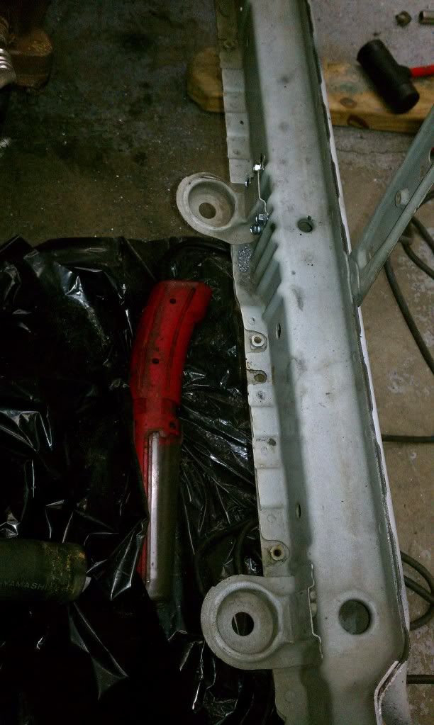

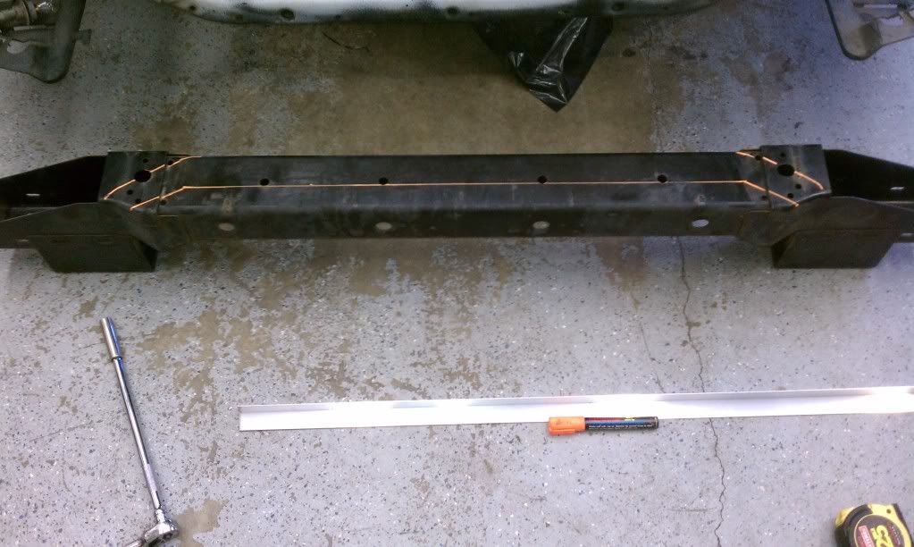

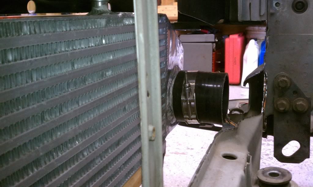

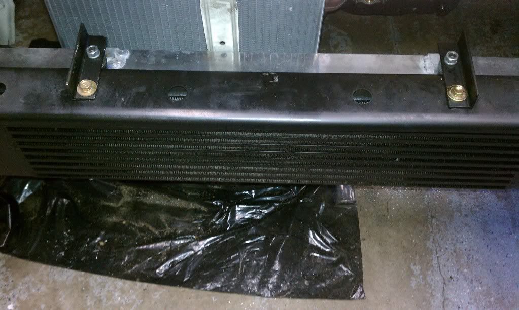

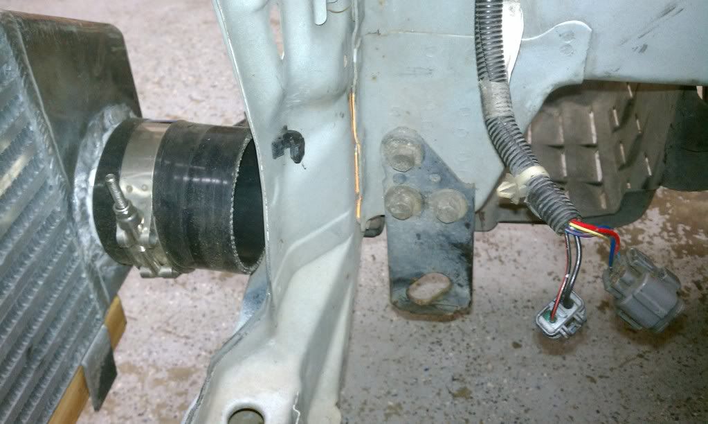

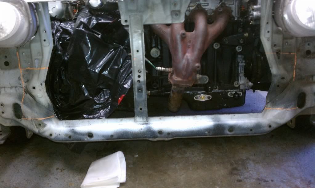

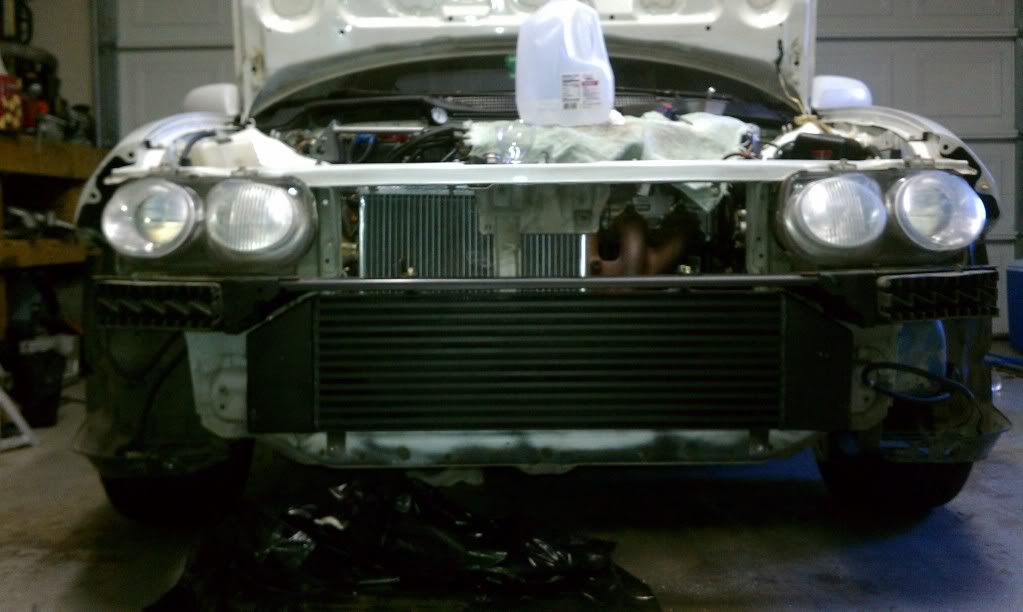

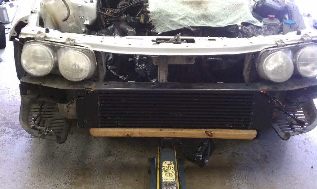

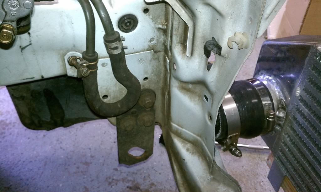

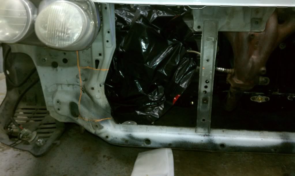

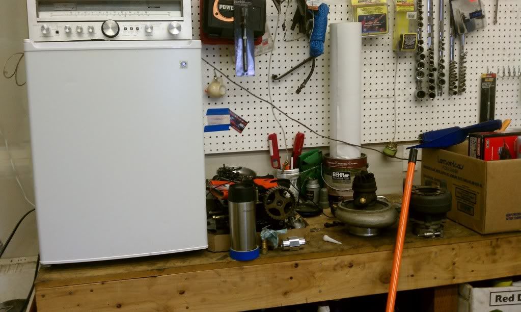

While it may not seem like alot of work in a whole, it was very time consuming getting the intercooler and radiator installed non ghetto fabulous. It turned out really good though. I like how stout and secure everything is.  Pics!
new beer fridge!

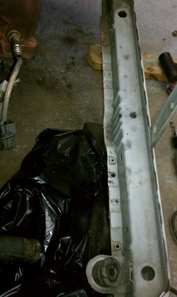

shit cut where I need to

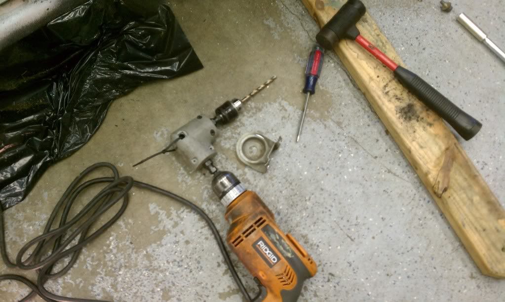

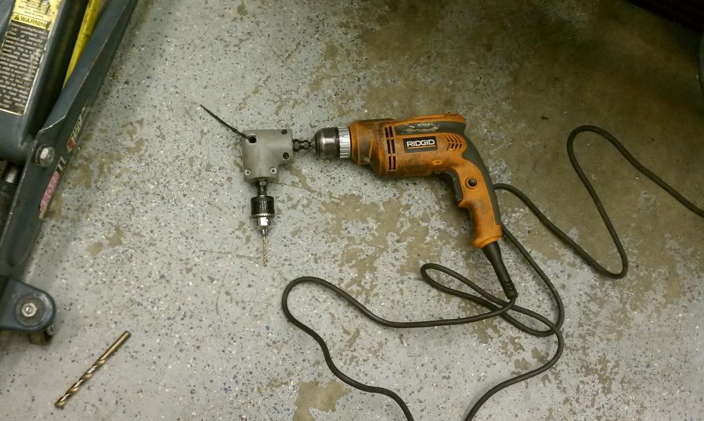

Time to hit up the rad support bracket. To tight for my drill so I used my right angle attachment
I might move the whole rad over if i need more room so for now I just attache the bracket I drilled out with some self tapping sheet metal screws.
intercooler brackets
painted up and checking fitments with ic and rad

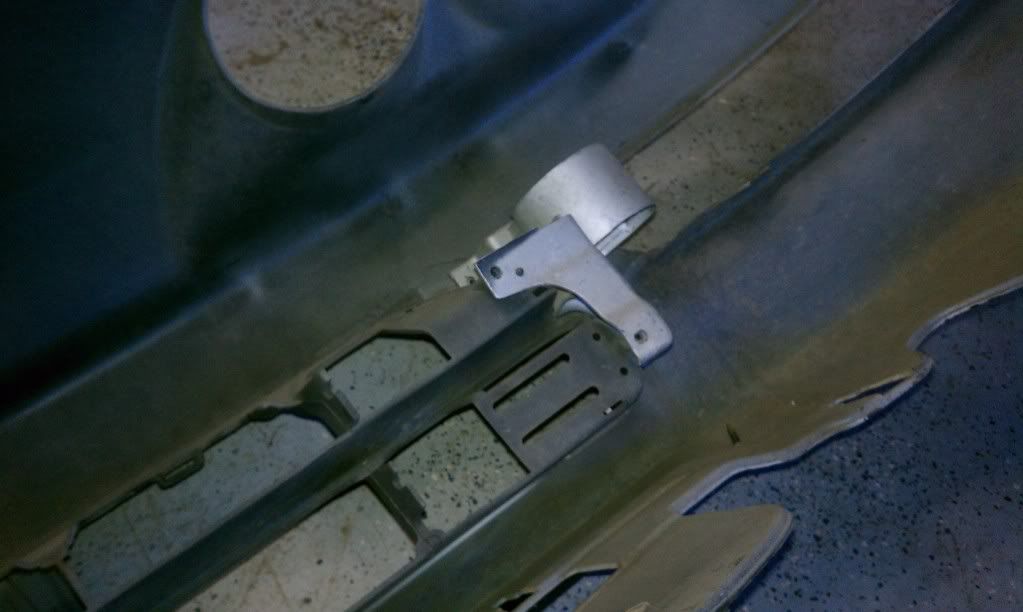

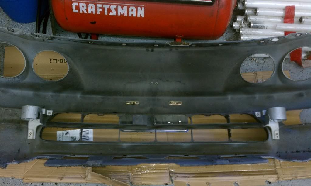

Now time to do work on the bumper cover
before modding turn signal brackets
After modding brackets and bumper cover

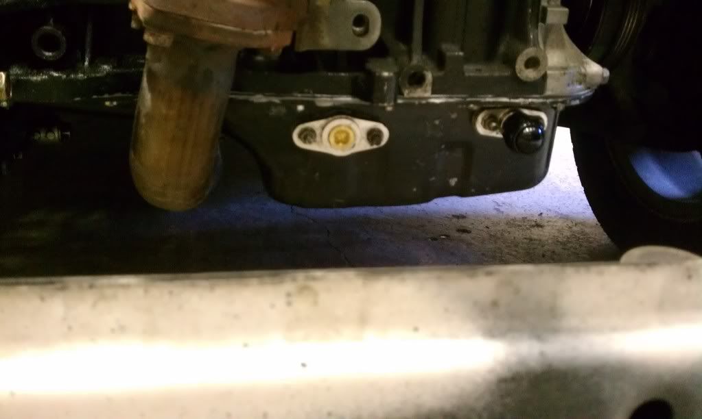

Also threw on the turbo return/catch can return oil pan
Also put on the new valve cover
also slipped the resistor box in
and no nigger rigging here. I de pinned and repinned the resistor so I wouldt have to cut and splice. Although I was bummed I had to cut and solder inw injector clips, But it turned out ok. Just took up more time. Story of my life.
Also ran out of time, but I didnt get to take a pic of how well the bumper fitment with the intercooler turned out But I will. Since I had the bumper cover off I also did a quick buff on the headlights so I can actually see at night. And did  quick basemap so I could drive it to work.

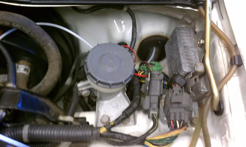

My life plans for this week are quick 15 min jobs on the car. I need to drop the walbro 255 in and wire up a relay for it to.
Put the 4bar in now that I know everything runs pretty smooth with the stock one and I know I didnt fuck anything up. I was gona do it while I had everything apart, but then If I had any problems with injectors I didnt want to be chasing my tale trying to sort shit out. And maybe some odds and ends here and there too.

Here's a ic shot
