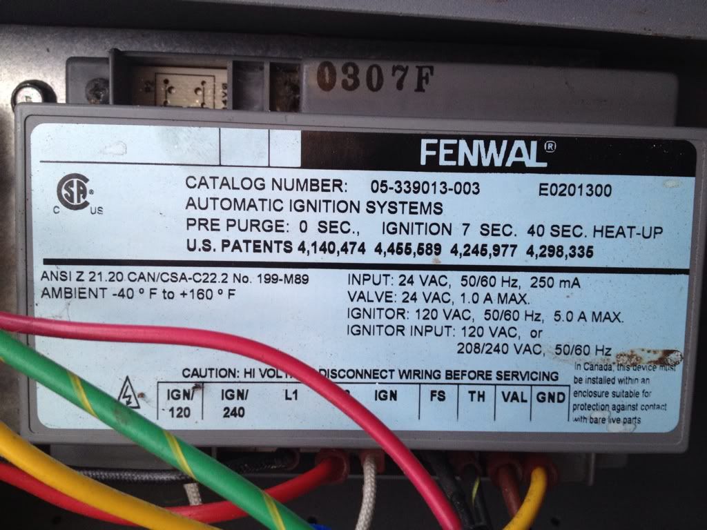

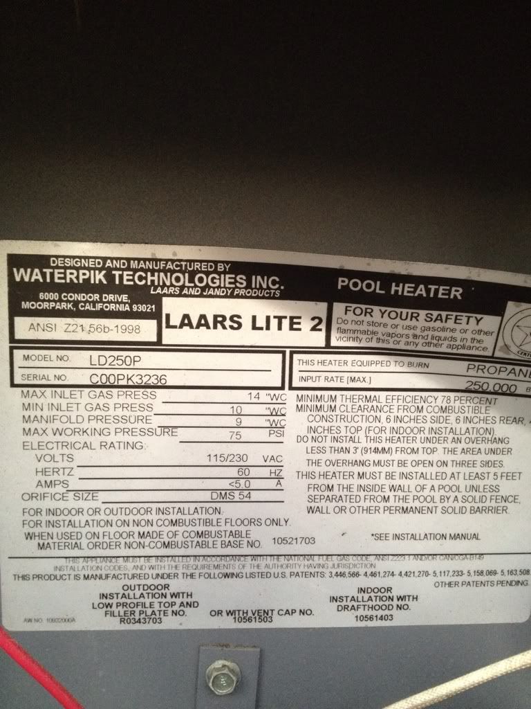

I have this hot tub heater
When I decided to use it for the first time this year it wouldnt light off. I just get a buzzing sound from this
I dont remember if it did that when it was working or not. I did a little poking around with a multi-meter and it seems that the ignition control box doesn't work. It's a $350 part so I want to make sure before I spend that much money.

I think it sparks cause there is always a "tick" sound right before it lights off. I'm not sure though. I tried to light it manually(from far away with a stick) with no luck. That box also seem to activate the gas valve from looking at the wiring. The gas valve wasn't getting any power which is what makes me think it's that ignition box. I'll check the ignitor tomorrow for spark or glow.

I got a hold of the troubleshooting guide from the manufacturer. Went through all of the steps and it pointed to the ignition controller. Opened it up and found a bad capacitor, changed it and it exploded instantly, thinking I put it in backwards I put another one in the other way. Got about 20 seconds and popped the second one. Then I gave up and started searching eBay for a cheaper one.

By the look of the wires its carborundum ignition. Which is a glow ignitor. The tick you hear is the solenoid opening on the gas valve. The control is similar to the ones I use at work and shouldn't be hard to find.

all of the wiring looks good, i originally thought the gas valve was bad. ill check that out next chance i get. the controller isnt hard to find at all, but its expensive. its so simple inside, i dont see why it costs $350. i found one on ebay for $90, but i dont want to put it on just to have the same thing happen. i definitely want to do more research on the matter
