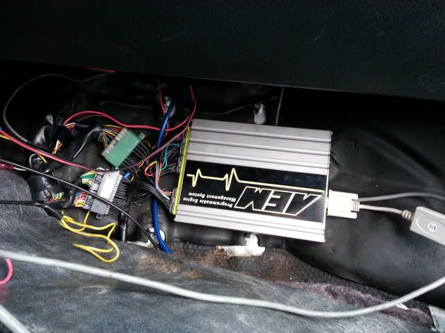

its a series 1 AEM.... its serial port.
it came with a serial to usb adapter, and like 10ft of usb cable lol.
issue is that i keep trying to send a tune to it after disconnecting (sometimes im not sure why it did) and it wont do it cuz its running, then it wont connect to it, invalid ecu or error out.

Your problem might be the adaptor. The only one I have ever been able to use with tuning equipment is the one Moates sells.

not sure what it is? it was in the box with the AEM. and i installed some random ass driver for it ::)
i do have a serial cable, maybe ill give that a try.

I bet the converter is you problem. I have never had connection problems with just a serial cable

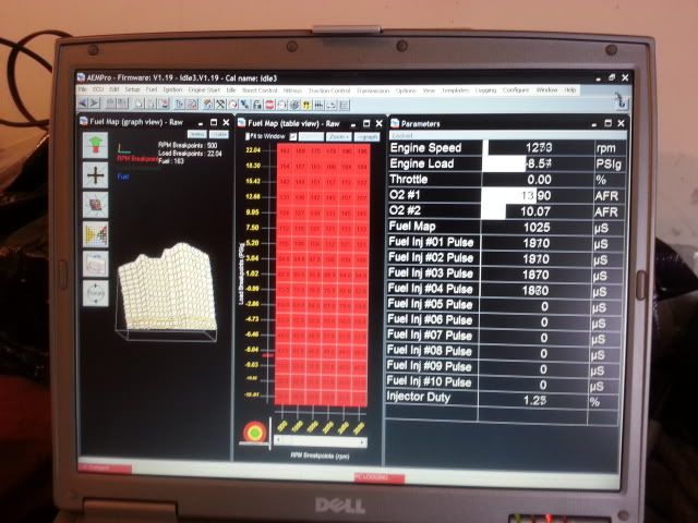

ok. had a glitch with my map that showed me maxing out my fuel. with some JD help, i got it fixed it looks like. so i went for some more tuning. needed some re dialing in of the map for the rescale.
so everyday i seem to learn something... and today i noticed this...
i checked my KS log on this pull. as you can see, doesnt look like its all happy.
AFR's arent on that plot cuz it only lets me do 3 at a time. dont remember what they are, but seemed fine. only did a pull to.....well fuck i just did a pull, i dont have a tach lol. from that it looks like 5800rpms. getting irratic shit from the KS from 4700-5800. most the time its below like .5-.6v
here is #3 before you ask...
they all looked fine, the same.
took little over 1 deg out that area, for now.
btw, im sure JD or someone will as, or want to. but its a Honda B-series KS. cuz thats what i found. wire is shielded (honda 02 sensor wire).
thoughts?

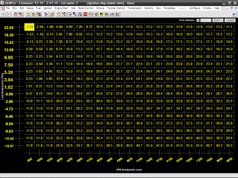

this is my ignition map:

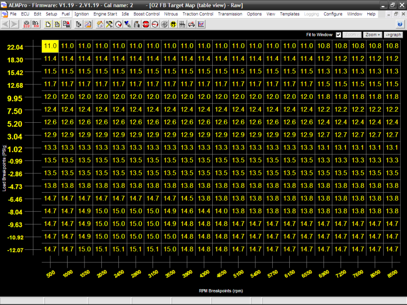

this is my o2 feedback table:

Looks good, a little conservative though
Re: turbohf ~ never ending CRX project...
« Reply #208 on: January 20, 2013, 11:55:38 PM »
which one? i seen a knock voltage of like 4.5 on todays drive... like 4500rpms at little over 12psi
« Reply #209 on: January 21, 2013, 12:08:22 AM »
Fuel is fine. My memory is shot, do you have vitara pistons? If so they need a good bit of timing
My last vitara setup that was on a dyno was at 19° at 15psi and made 310whp.
