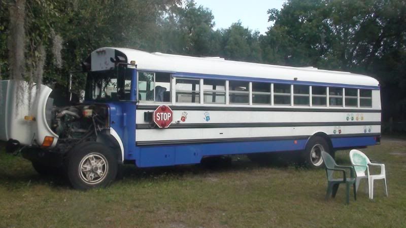

Here's the vehicle:

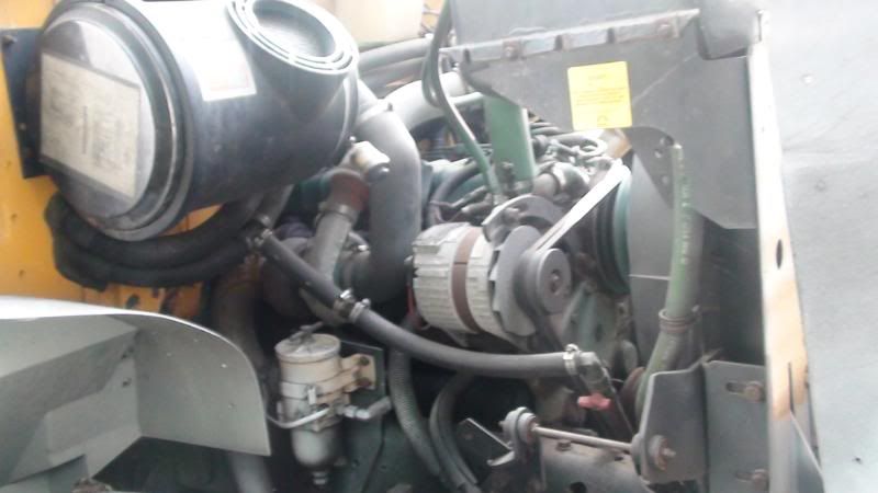

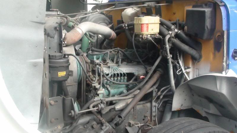

Side shot of the engine bay, I believe the motor is an International Navistar DTA360:
Not sure which injectors are outfitted on it, as there was a collaborative effort between Caterpillar and Navistar around the era the motor was produced on electronically controlled injectors, but I believe them to be mechanical:

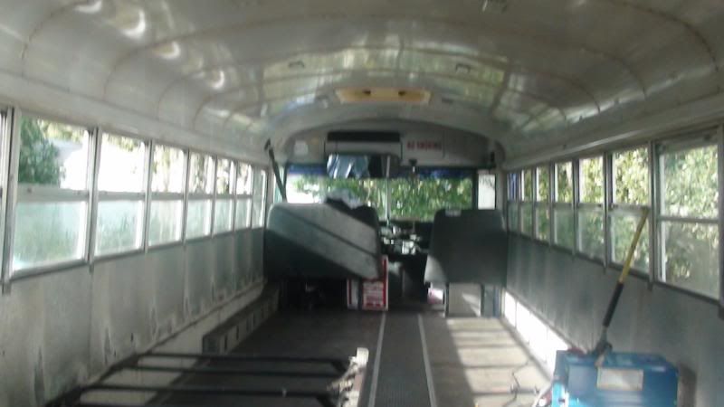

Deceiving shot of the interior with all of the seats removed, also $90 fluxcore-madness on the bed frames being constructed from recycled seat frames:

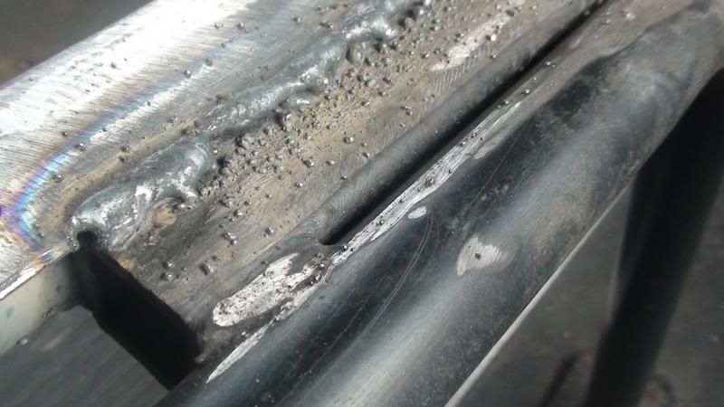

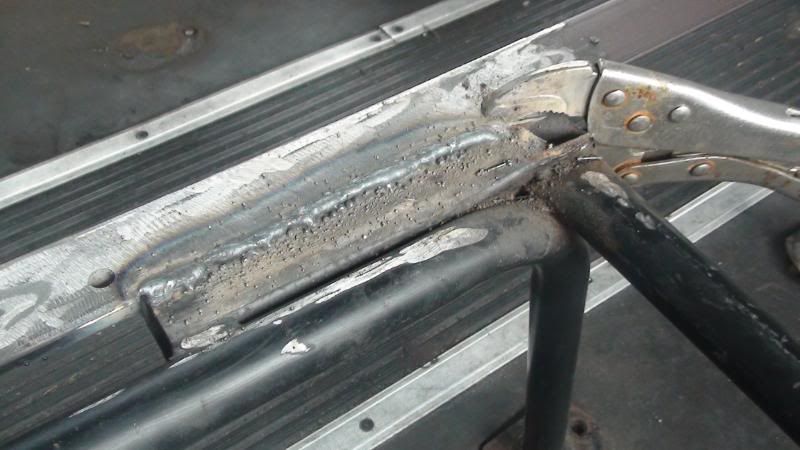

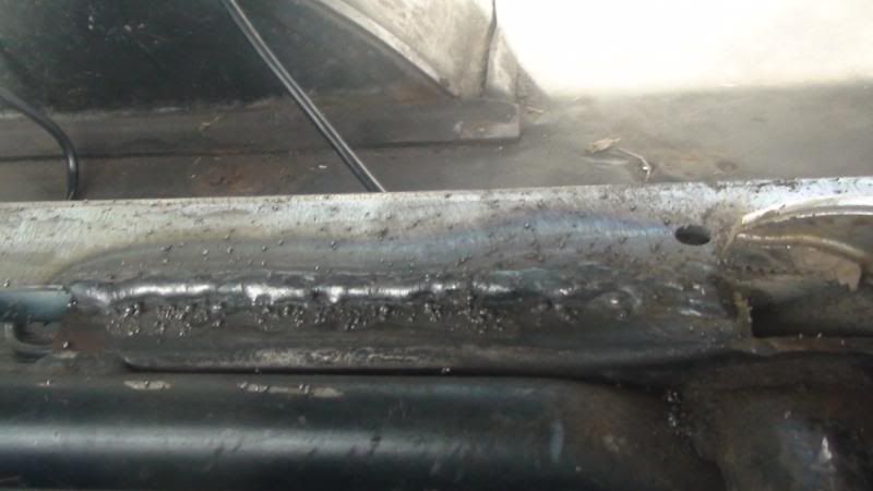

Gnar fluxcore on galvanized steel and who knows what other kind of metal/paint/coating in a poorly ventilated area.  :mexi:
Please criticize the shitty welding:
Steady hand:

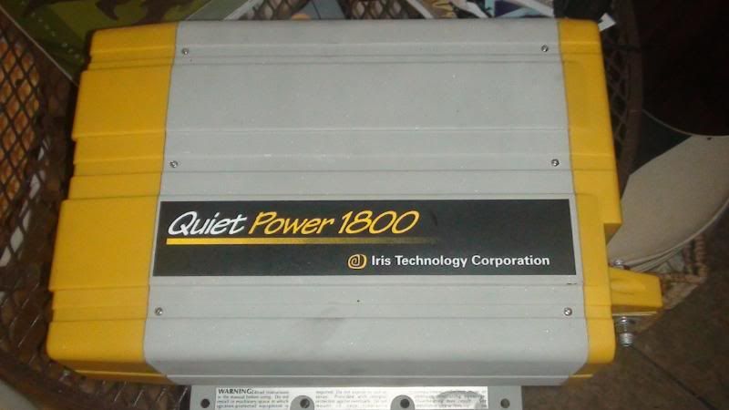

Working on getting it registered as an RV now (currently a Commercial Vehicle) so now I'm starting to wire up this Quiet Power 1800watt inverter I scored off of Craigslist:
Also starting to source parts for the second battery bank, for the "house" which needs to be 24V for the inverter to work properly, most likely going to run a dual-alternator setup as it seems to be the most cost-effective overall.
Any recommendations on models of light duty truck or any vehicles that came with 24V alternators would be more than welcome (assuming that they actually operate in the 25-29V range). I know a few older military Jeeps had 24V systems so I was planning on trying a local Jeep specialty shop, again any pointers are welcome.

Yes those are mechanical injectors. Based on the mechanical injection pump pictured.
I figured as much, there are a few sensors on that pump so I was unsure if there was some kind of solenoid to control flow or something. I am no big truck specialist.

I would assume the "sensors" on the injection pump are actually the cold start advance solenoid, and the fuel shut off solenoid.
