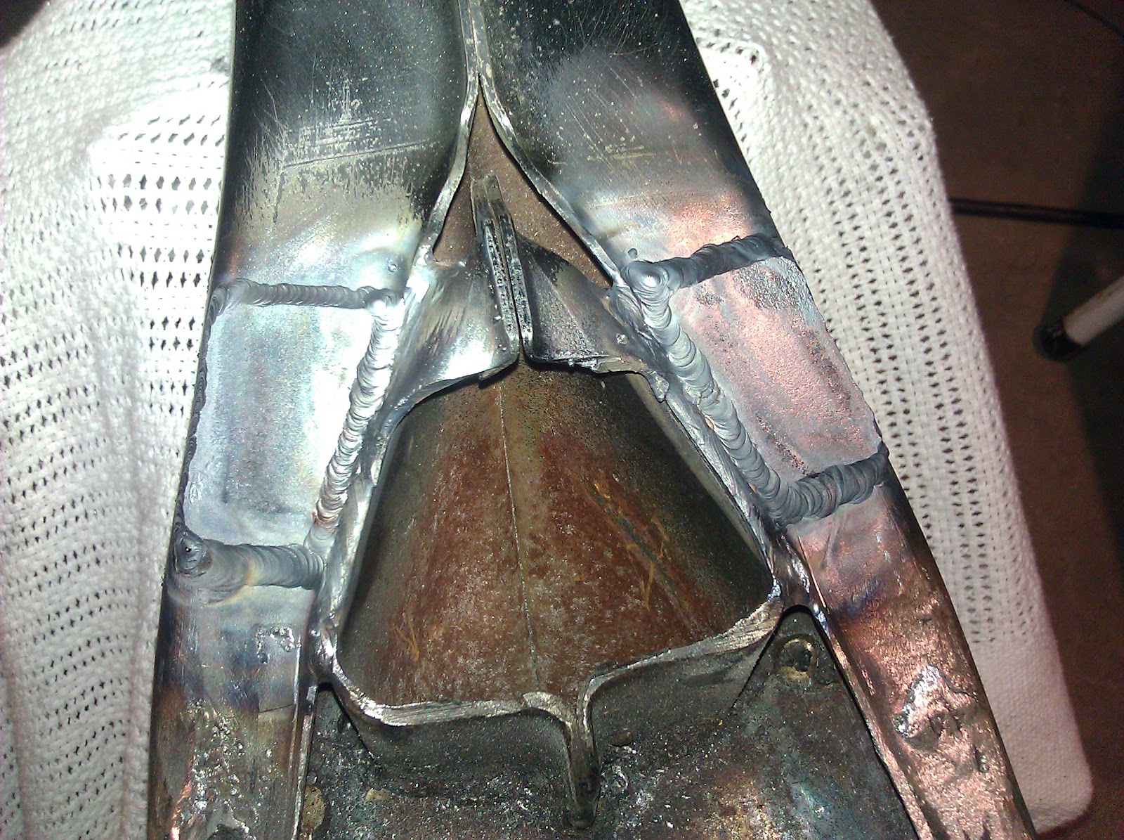

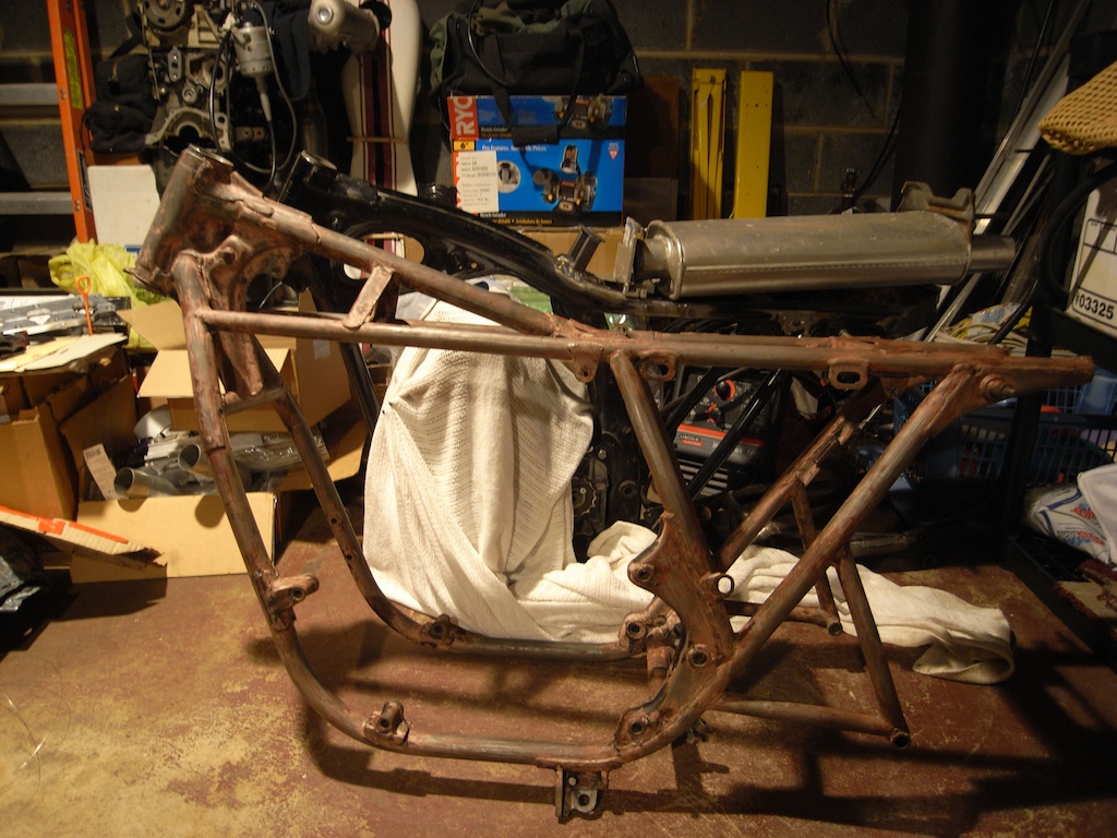

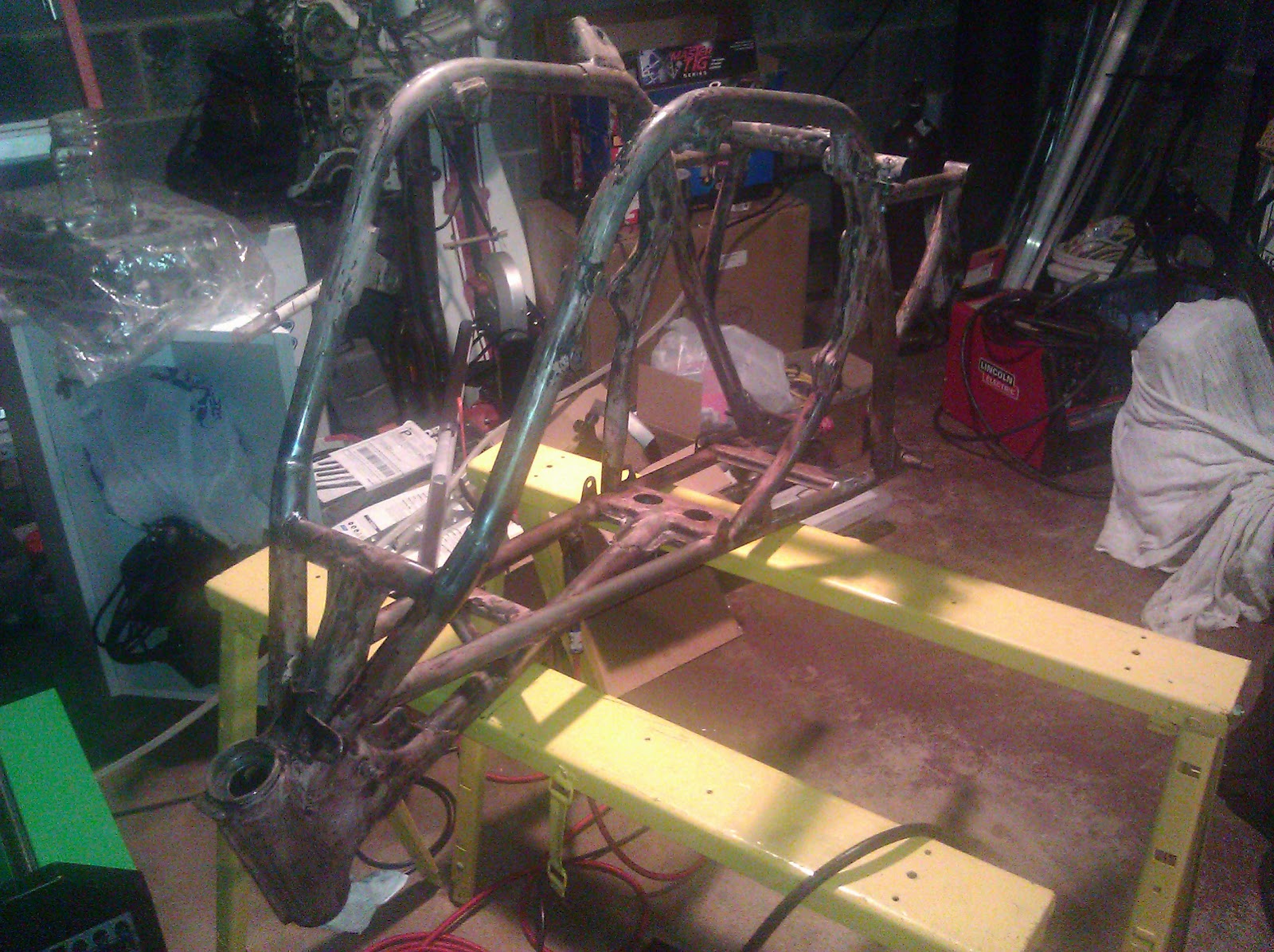

CB450 frame:
I detabbed some of the frame and am going to be constructing a seat pan and battery tray for the above bike bike.

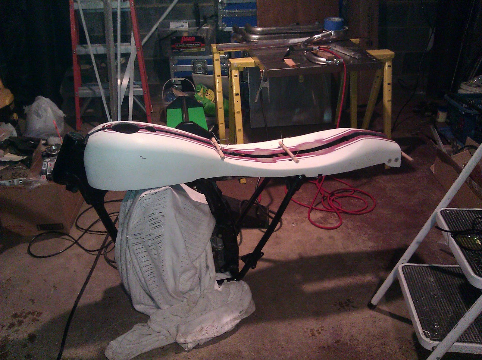

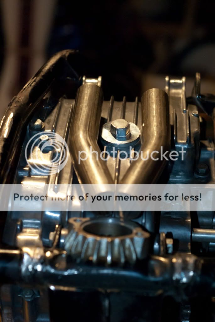

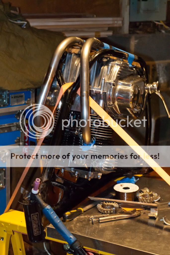

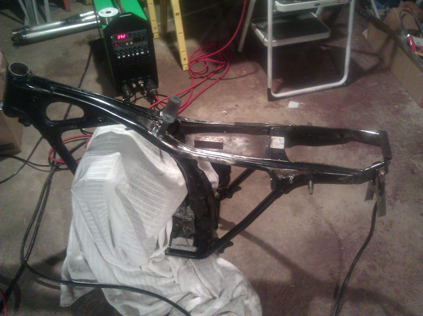

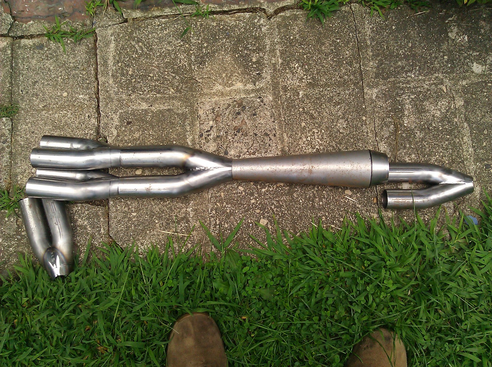

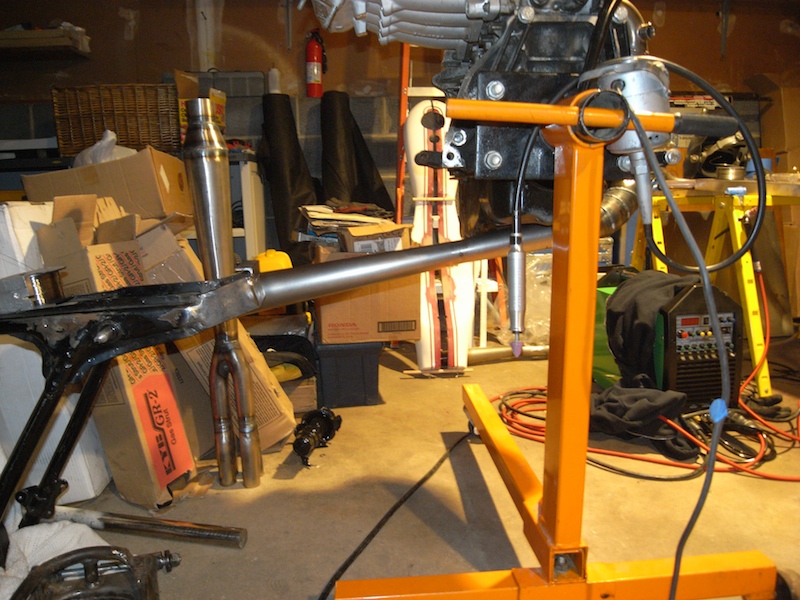

I've got another bike that is in for a custom SS 2-1 header and frame mods to fit this custom body that is going to be 'glassed at some point:
Welding reinforcement plates to the frame for a standoff to raise mount the body to:

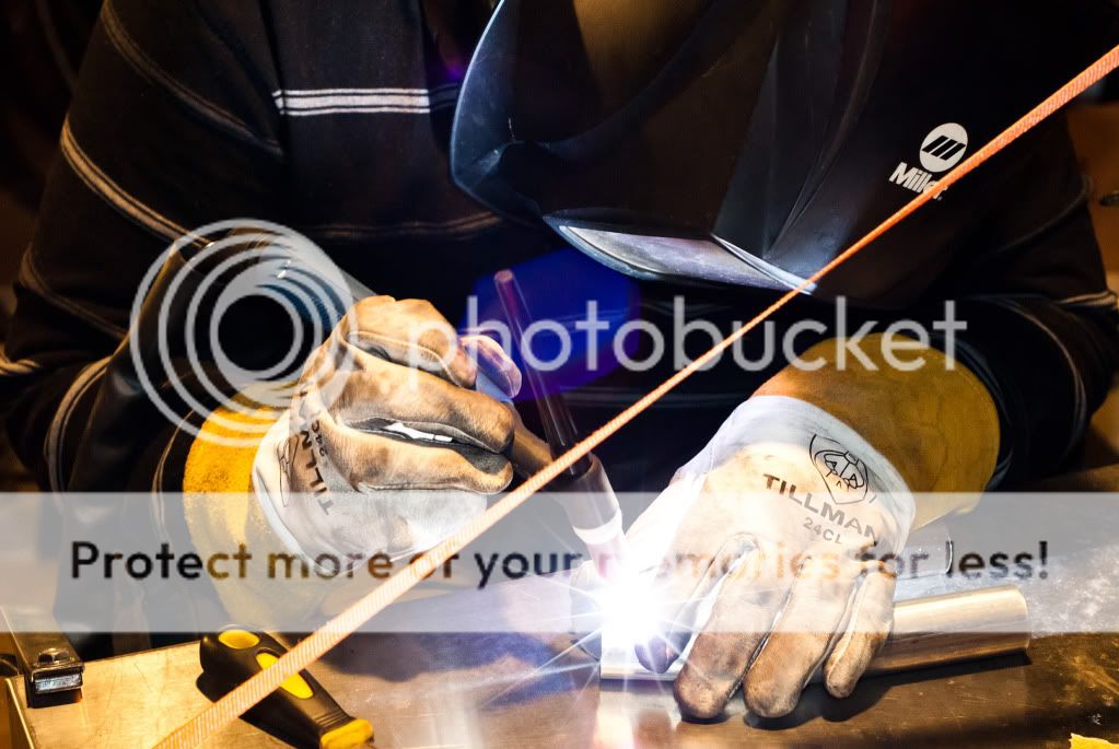

In action tacking:

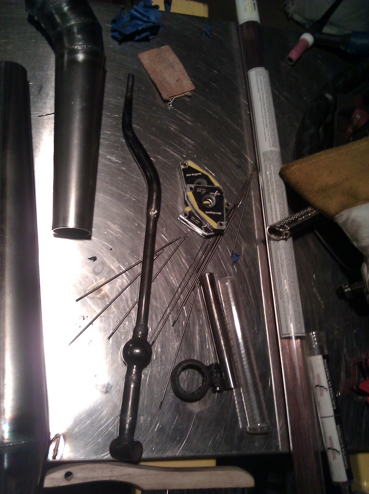

Custom extended shifter:

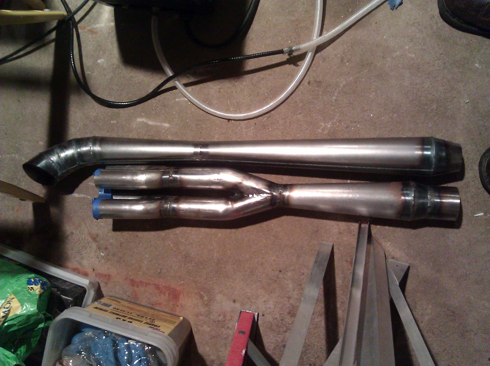

Working on my own tri-y:

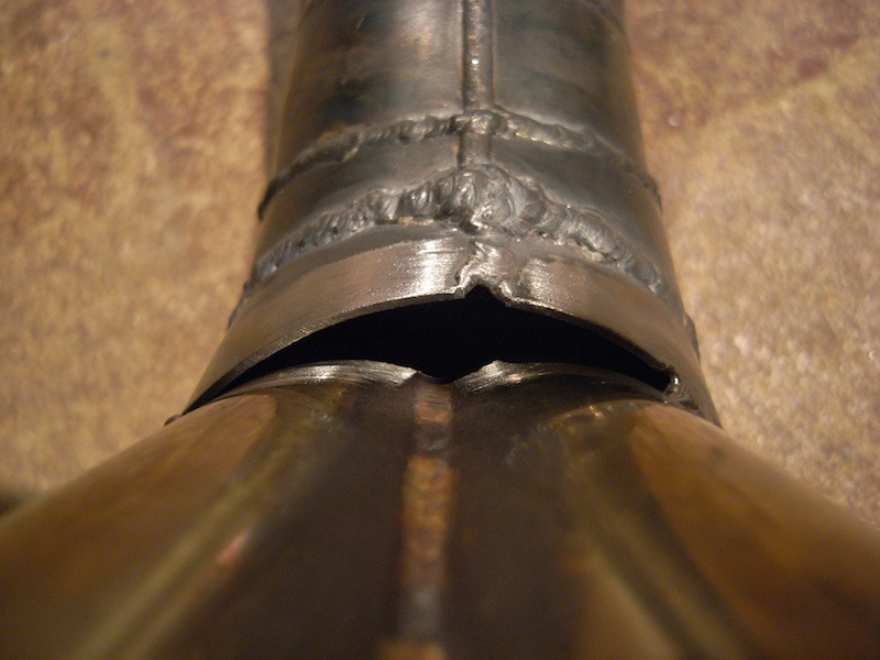

Some of you may be familiar with these pieces of poo:

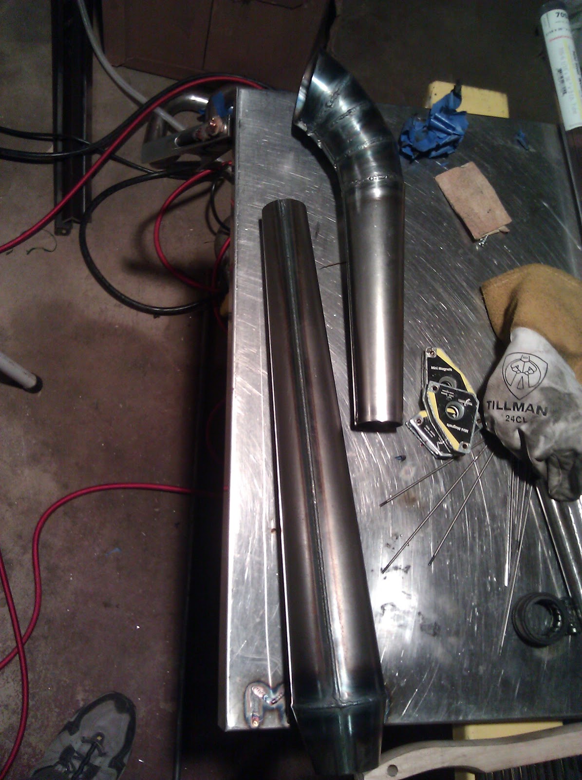

The collector fell off. Clean crack right through the effing weld. The header had already had nearly every single weld crack before, but it was repaired by someone competent. Then the collector fell off. So I got to thinking . . . What can be done to improve that piece of crap? 2.5" collector on a D-series engine? Sure. That's optimal.

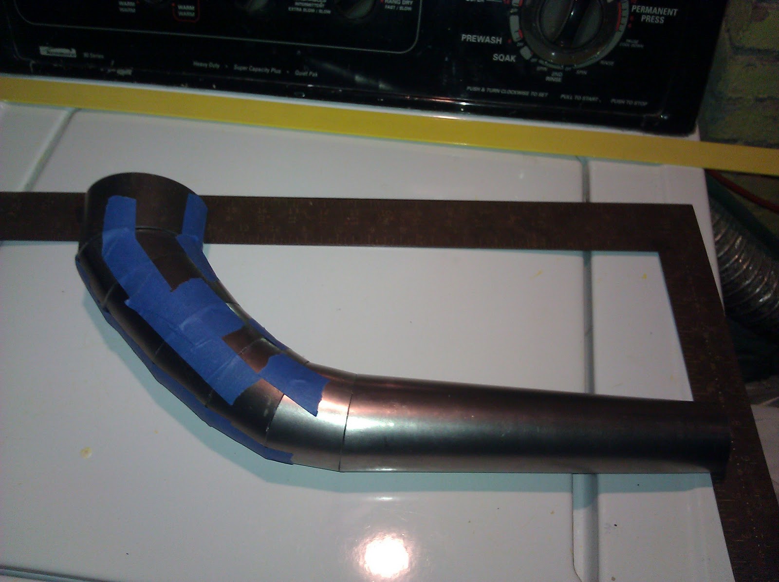

Pie cuts are at home on this forum, right?
It took a while of test fitting and changing a few things around to fit as per my customer's requirements, but eventually it ended up looking like this:
And then this:

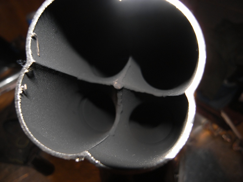

Before I welded the header to the new collector, I took the liberty of cleaning up this:
Isn't the the kind of collector you love seeing on a $700+ header, custom made for your engine?
After 10 minutes with a crap stone on my grinder:
*shakes head and walks away*

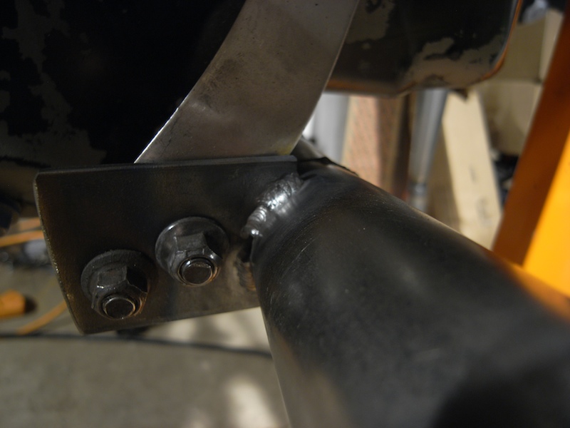

Hanger, because race car! (Unlike Bisimoto's hard parker crew!)

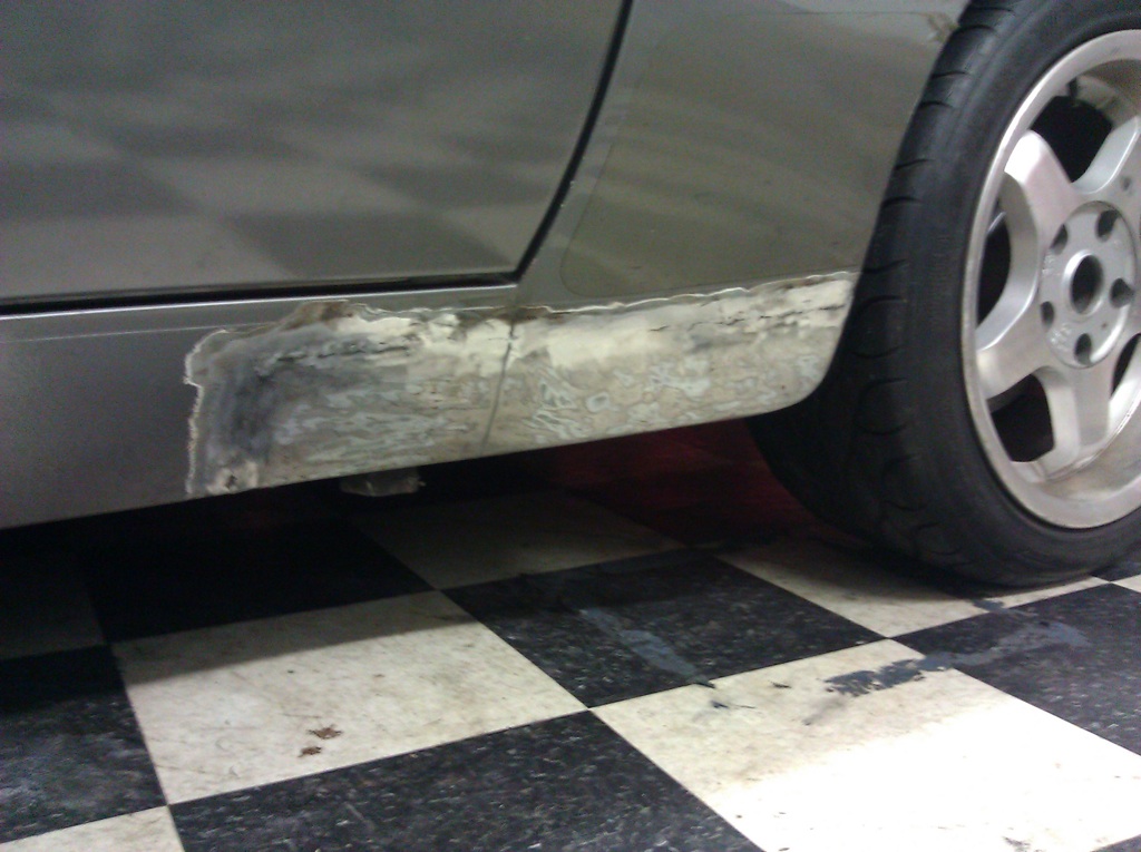

Patch panel on a Porsche 944:

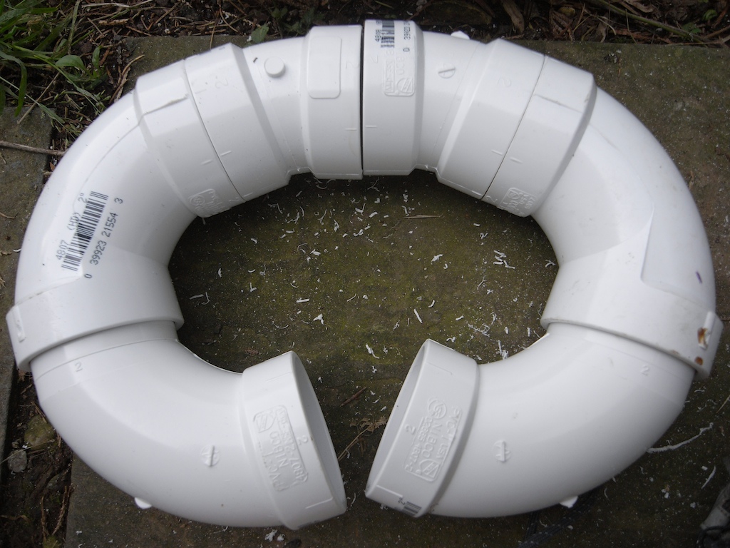

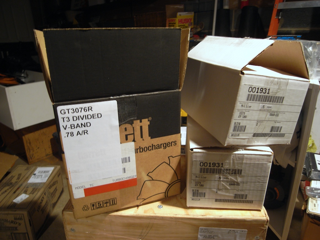

And these are for an upcoming project:

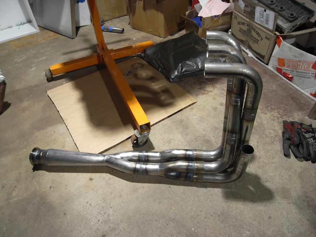

« Reply #19 on: May 22, 2012, 01:18:20 AM »
I tend to stay away from 'all in one' packages. I would like a plasma cutter in the future, though.

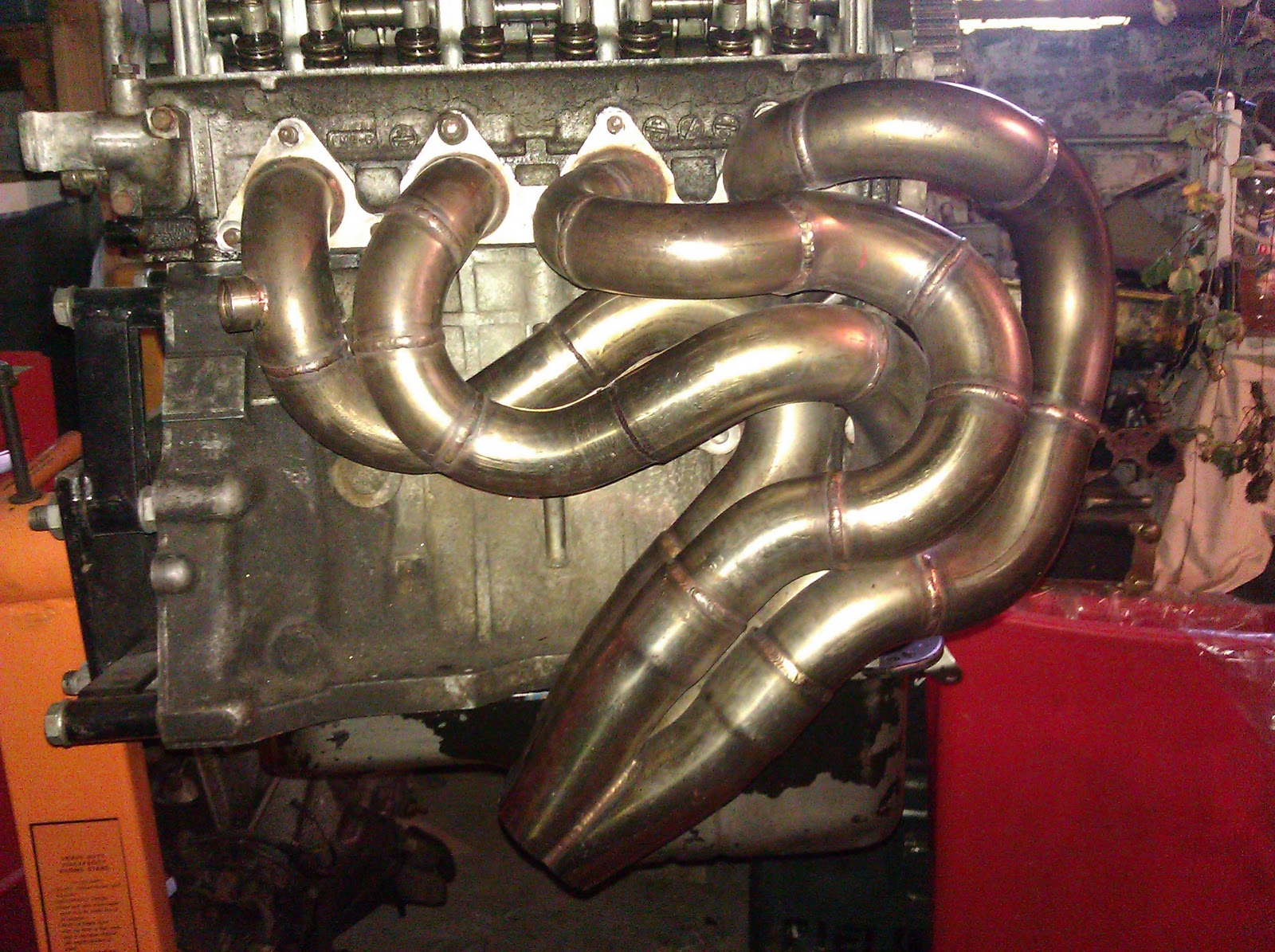

Still no porn, but I offer this:
*fades into the background to avoid the silliness of rules from a self-professed lot of rule breakers . . . *
Not so obvious and ruthlessly odd.
Fab blog: http://beaverbuilt.blogspot.com
Re: Blah. Lots of y'all know who I am already.
« Reply #20 on: May 22, 2012, 09:08:23 AM »
Looks good, b-series?
The_Beave
  • Posts: 2511
  • The Red Tape Avenger
    • Beaver Built Blog
« Reply #21 on: May 22, 2012, 09:11:40 AM »
D. B-series likely in June.
« Reply #27 on: May 29, 2012, 08:34:31 AM »

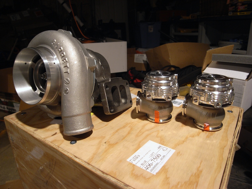

Where are you going to put the turbo flange?
The_Beave
  • Posts: 2511
    • Beaver Built Blog
« Reply #28 on: May 29, 2012, 12:52:39 PM »
On this:
Or, more accurately one what that actually leads too.
