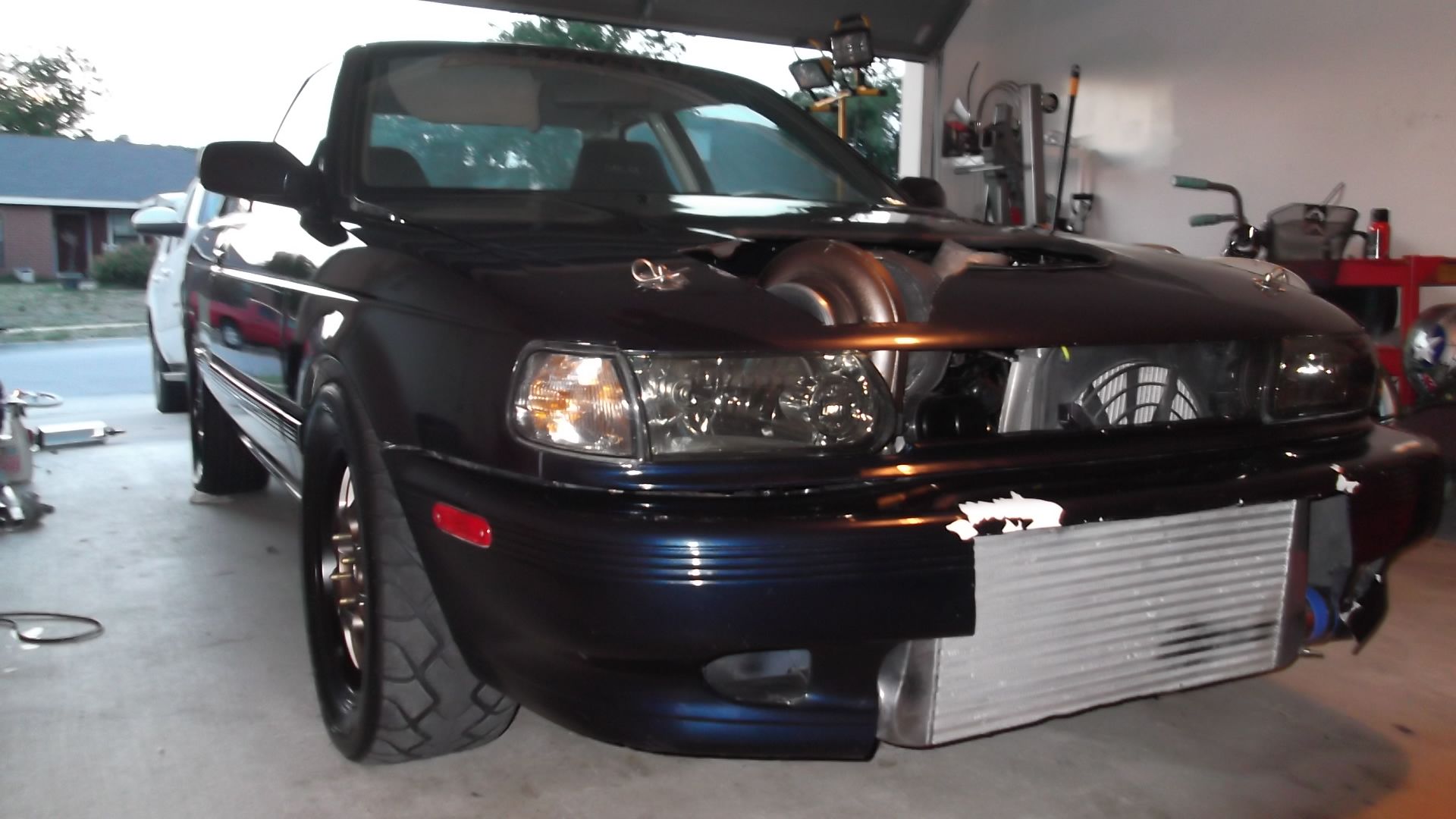

This is my friends car, just got tuned at Converse in San Antonio on Thursday to 723 WHP. Was shooting for 800+ but didn't bring a strong enough wastegate spring. Only got 29 pounds of boost out of the turbo. He will be going back to get more tuning done after the SR20-forums.com meet in Ohio next week.

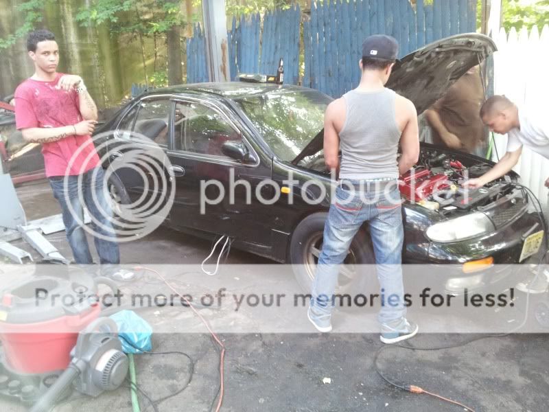

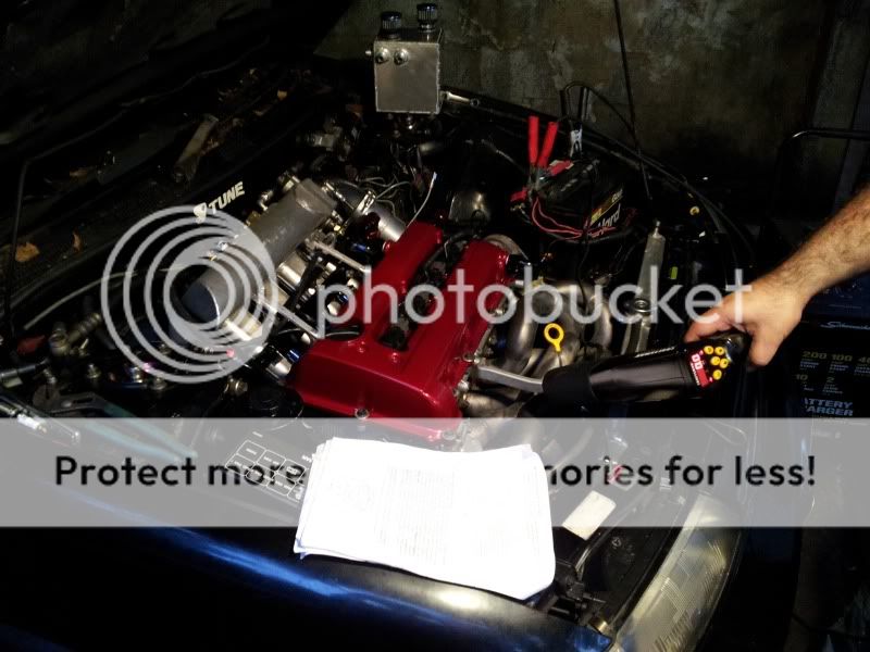

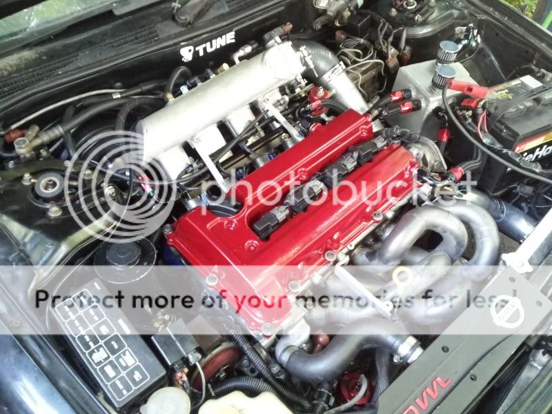

Ill post up my buddy sr, he going to the same meet. Sr20vet, 20v head, sleeved, 6567 bb turbo, getting tuned this week. The main difference is my buddy hooks all 4   ;)
Wow 20v head? I never heard of that how rare are those?  :noel:
It's a rare head, but it's not a 20valve head, the valve cover is stamp 20v. Ports are bigger, better shape, and seems to make more power.

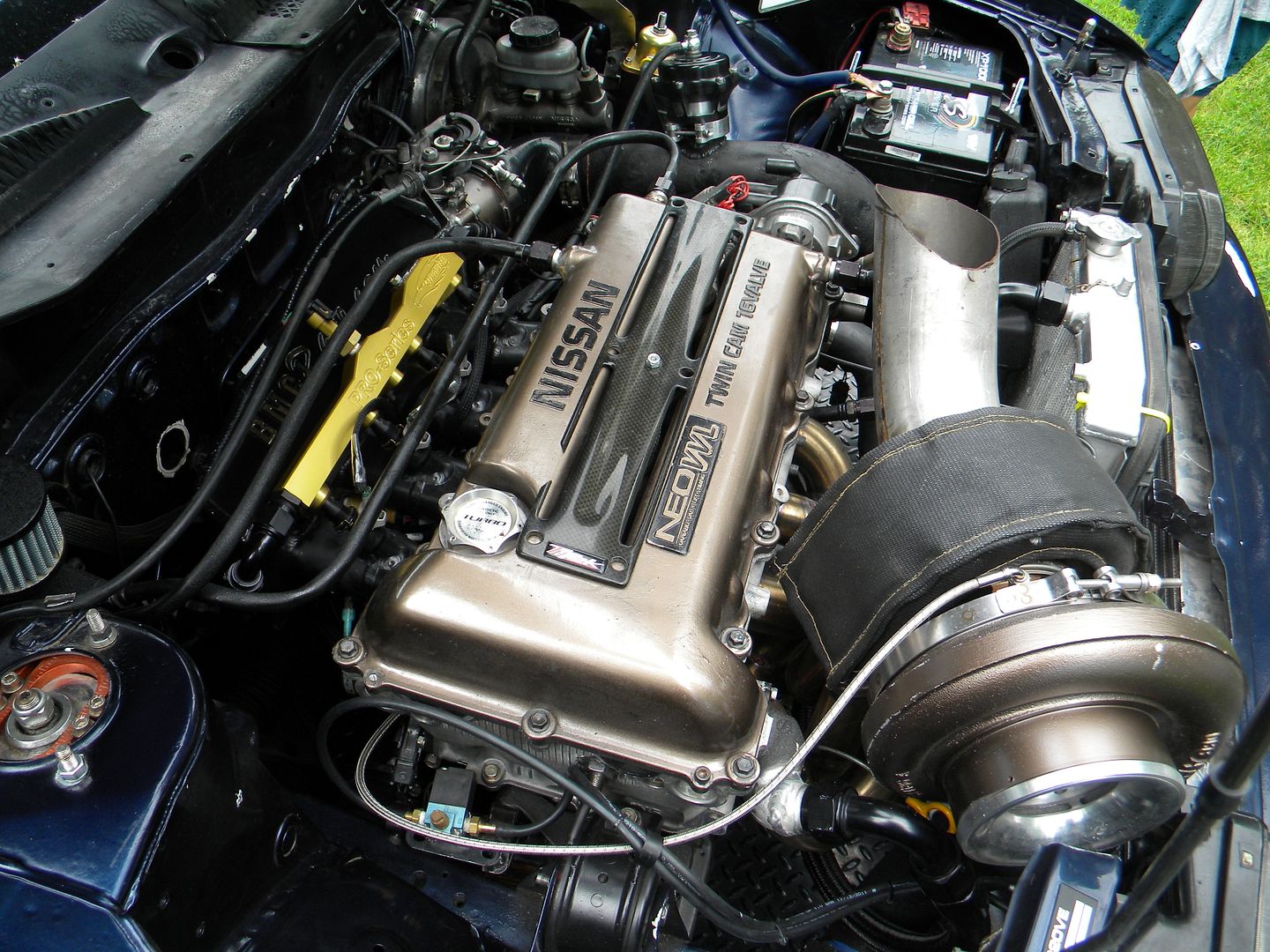

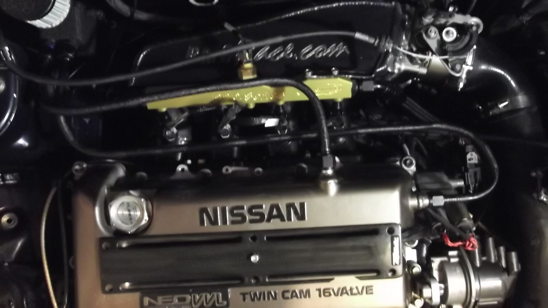

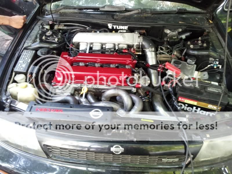

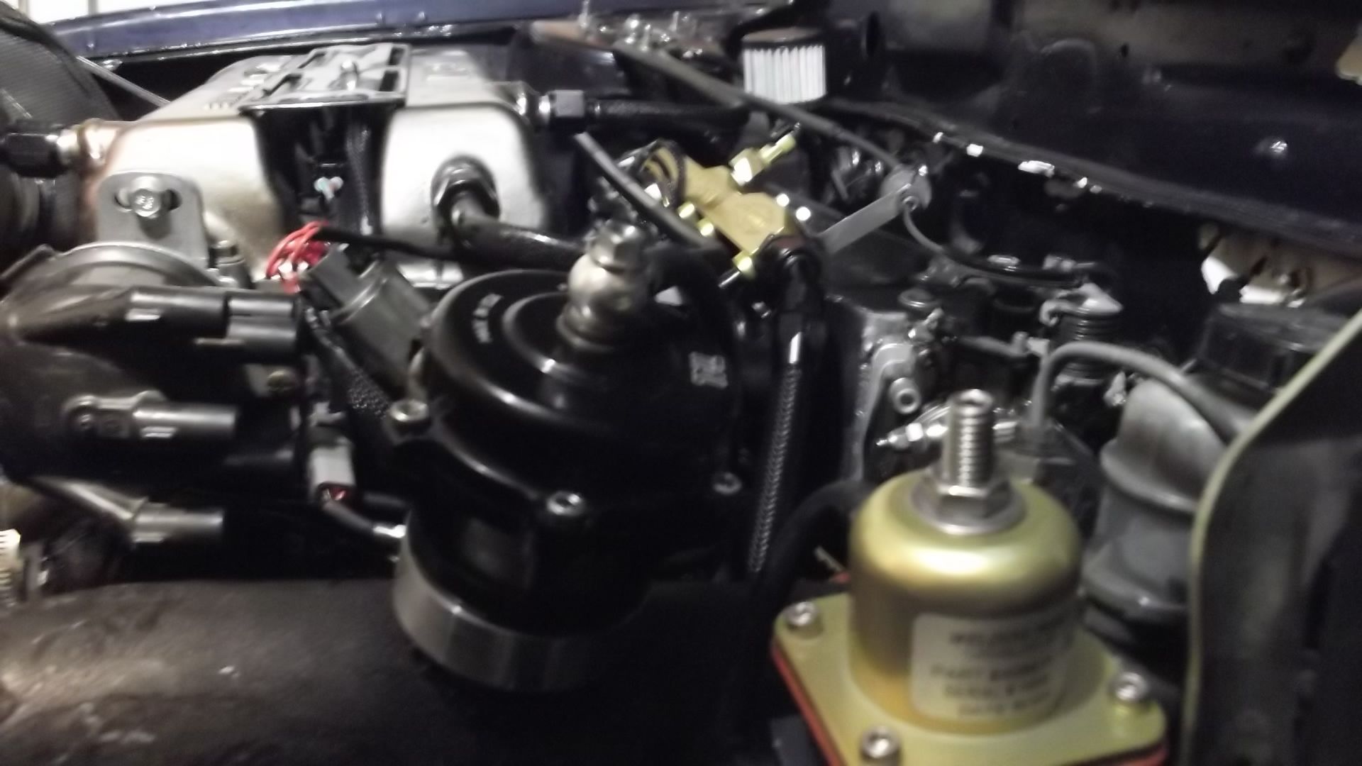

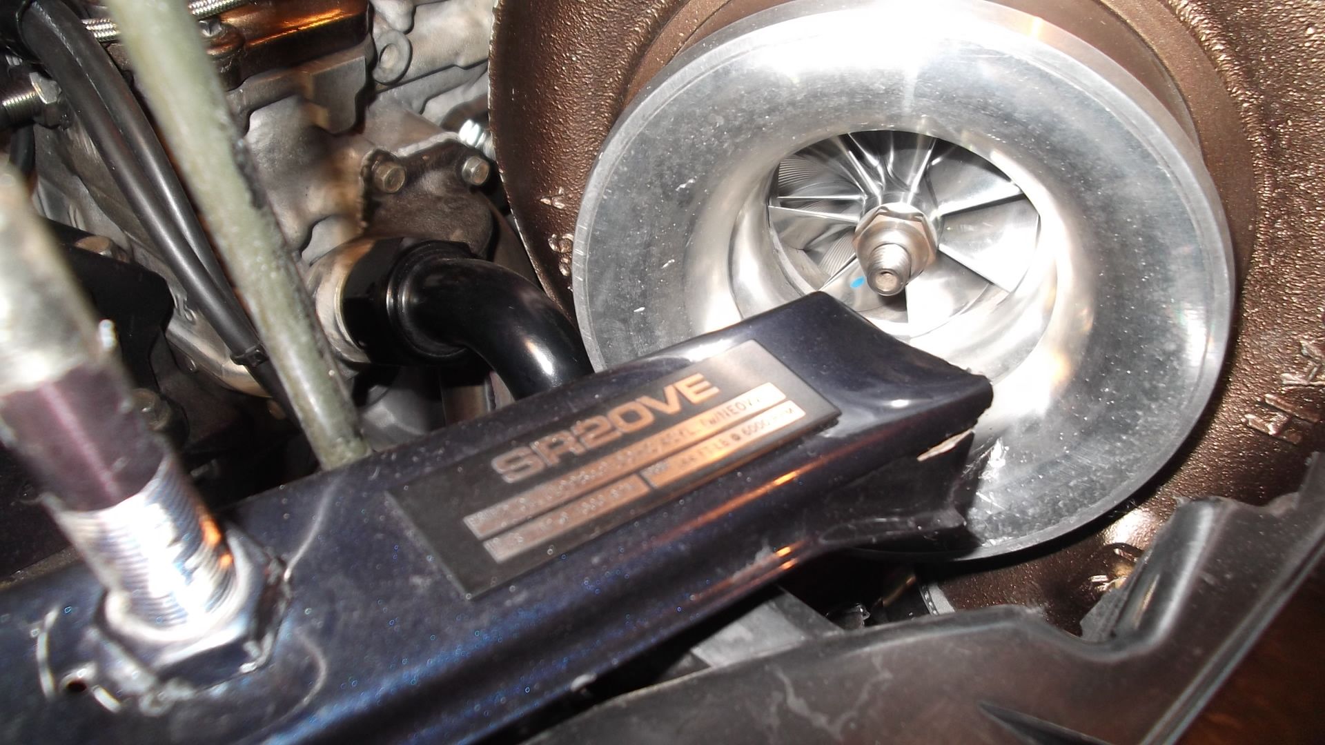

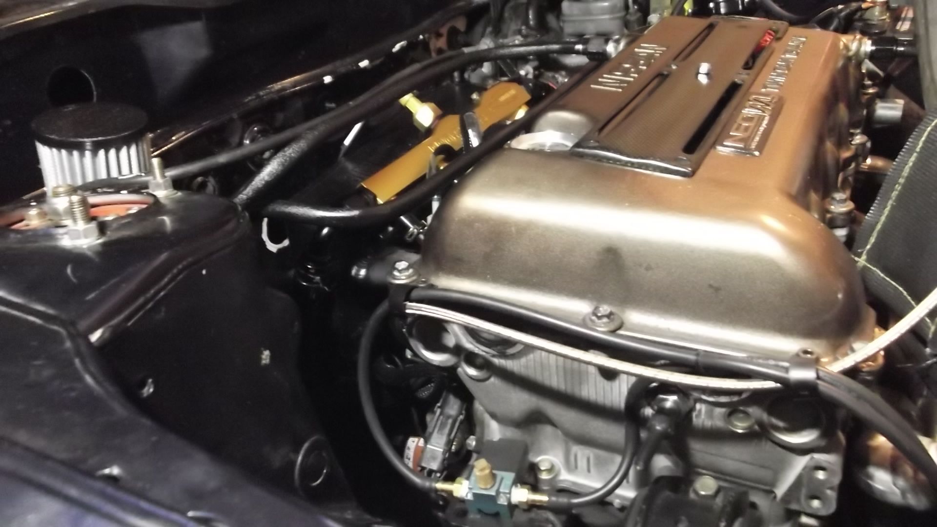

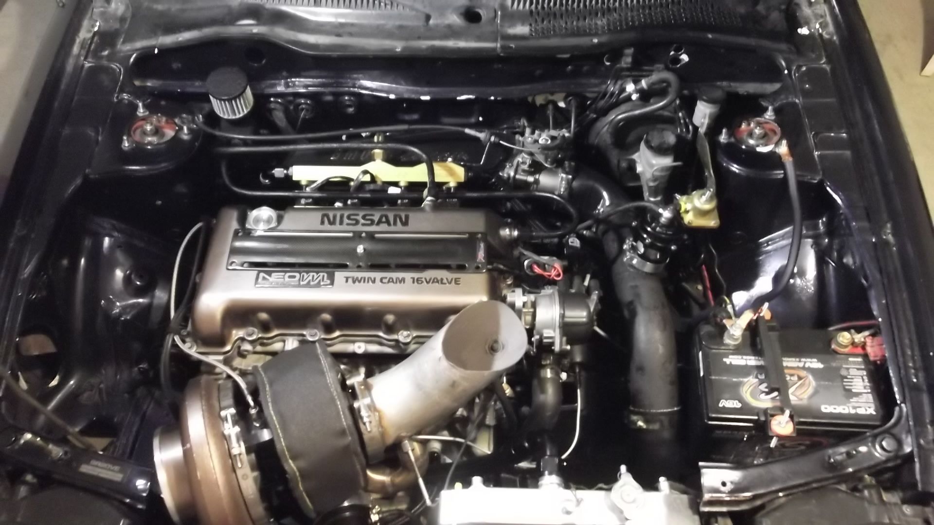

Thanks Eldon for posting up.  Here is the setup.
Will be going to the track next weekend during the Convention.
Setup:
SR20VE block Sleeved and stepped by Mazworx. Drilled for 1/2" studs
SR20VE head w/ mild port work and port matched to the manifolds.
Mazworx 1/2" Headstuds
SR20VET metal headgasket
SR20VE oil pump and stock SR20VE crank pulley
SR16VE N1 cams
Supertech 130 lb Springs and Titanium retainers, Stock valves.
Custom Crower Billet Steel I beam rods
CP SR20Ve 9:1 86mm pistons w/ upgraded tool steel pins and upgraded clips
ACL Race 5 hole main bearings
ACL Race 19mm GTIR rod bearings
GTIR main bolts
AEM EMS
AEM Twinfire (new box)
Denso GSXR coils
AEM boost, fuel, and wideband gauges
AEM EGT sensor
Comp Clutch Custom 6 speed swap Twin Disk Clutch
04 Spec V 6 speed trans mated to a JDM P12 Bellhousing
Stock Spec V axles w/ B13 outer CV joints
DOC Race Equal length open scroll T4 manifold w/ JGS 50mm flange
JGS 50mm wastegate w/ 1 bar spring
BW S400SX billet 67mm w/ 1.10 AR turbine housing.  Divider was thinned out and port matched to the manifold.
BMC Race Custom Intake manifold
Golden Eagle B-series Pro series fuel rail
ID2000 injectors
Sumped stock tank
Weldon 1100-A fuel pump
Weldon fuel filter
-10 feed line
-8 return
Weldon 0-200 regulator
k-sport coilovers
ES bushings all around
Racing Hart Cybers w/ 225/50/15 drag radials for dyno use.
All work and assembly was done by me. Tuning done by Jorge at JMS Racing.
Here is a vid of the dyno.  Going back after the Convention to hit that 800+whp goal.  Just a wastegate spring swap away and maybe 35-36 lbs of boost. Plan to go to 40 lbs of boost.
723whp Turbo Nissan Sentra SE-R Dyno
