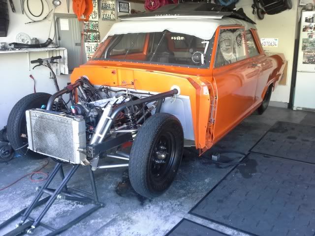

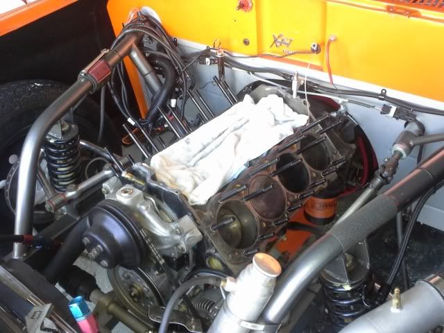

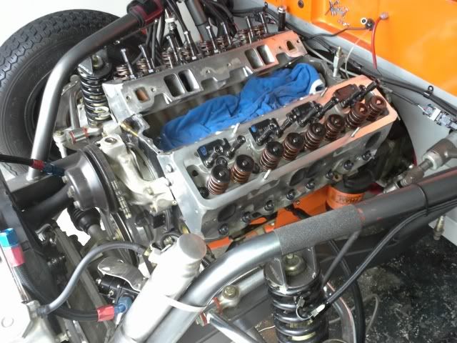

« Reply #198 on: September 10, 2013, 06:18:52 PM »

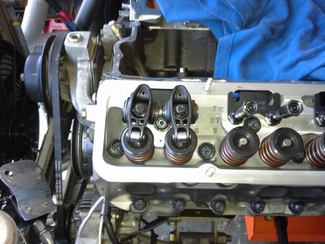

small update... studded and ready for 4.030 .060 cometics mls
heres the heads tautly torqued to 80 lbs..
then ran into some problems..
the old style rockers now hit the studs when lashed.. because the pushrods are now .021 shorteer..
so ordered up the correct pushrods and rockers.. comp magnum's 1.5 on intake 1.6 exh. pics of parts soon..

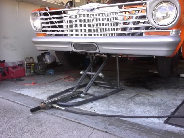

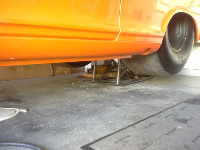

some random pics.. the high lift jacks..
these are fucking so slick to use... 30 sec
oh and the wifes mammies.. lol
more to come...

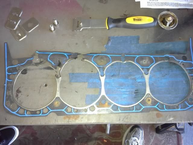

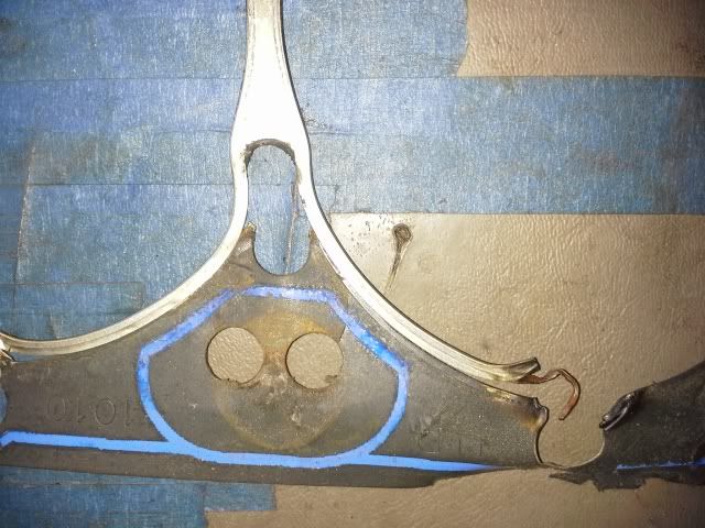

forgot the old gaskets that shit the bed.
.039 fel pro's 4.166 bore.. wrong shit.. and only had arp head bolts..
rest of the motor,walls,pistons heads are all fine.. no damage
lasted a few hits on the street.. and a pass at the track..hg hit the pushrods and was folded against them..
Re: Jacer's 63' Nova Twin build.. Update..VID's ..check it
« Reply #200 on: September 10, 2013, 08:00:17 PM »
Damn, it ate those HG's up!

« Reply #201 on: September 10, 2013, 08:02:39 PM »
yep @ 15 psi

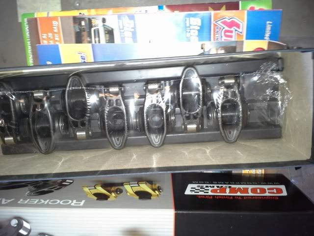

some parts showed today..
the rockers..

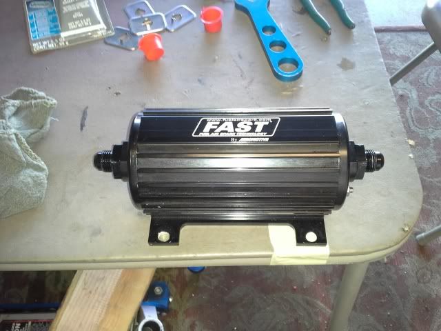

pump back from some repair work, had some debris get by the pre-filter and boom.. 210 bucks later. my fault..
