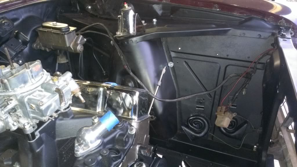

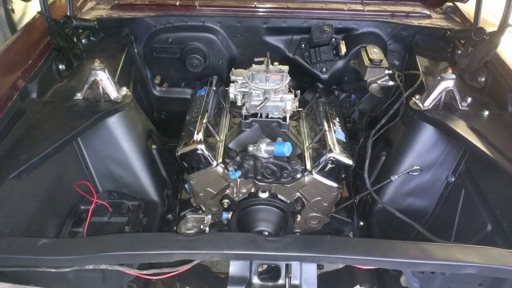

Well got a bunch of little shit done in the last couple of days....
Drivers side suspension is all checked and tight.
Shock cover/bump stop is bolted on drivers side.
Ps bracket is painted and mounted
batt tray is painted and mounted
bumper and grill is all mounted and turn signals wired
hood latch painted and bolted in
headlight trim bezel is on
some wiring ran
wiper motor is painted and bolted in
Horns bolted on..
Not much but its all the little shit that takes time

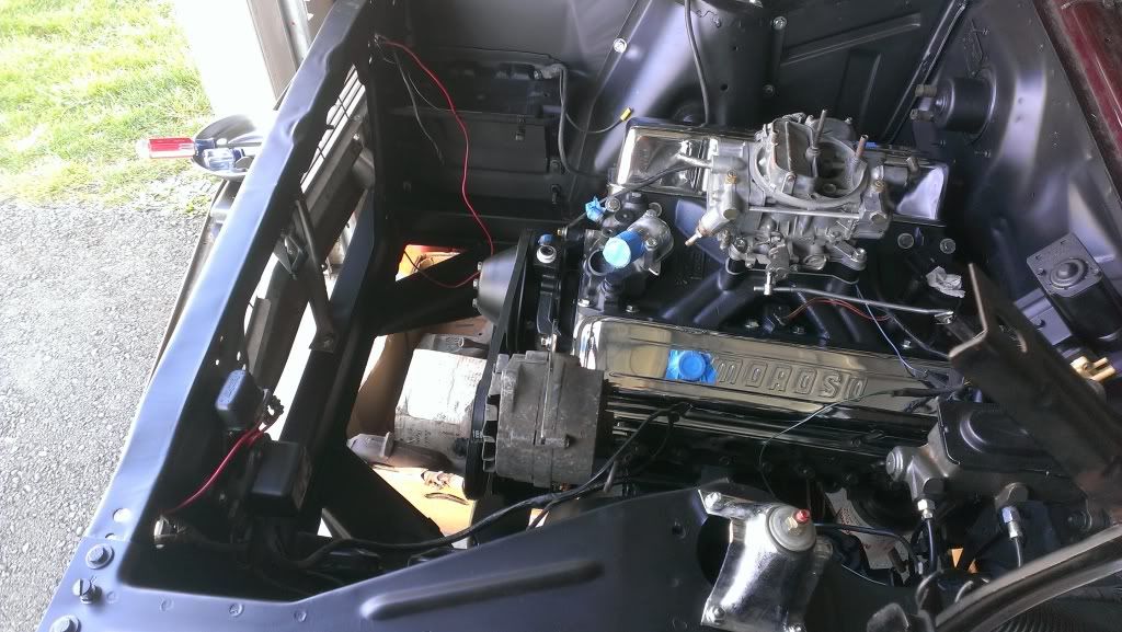

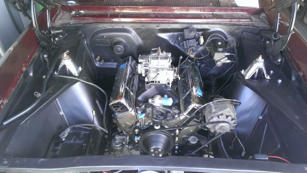

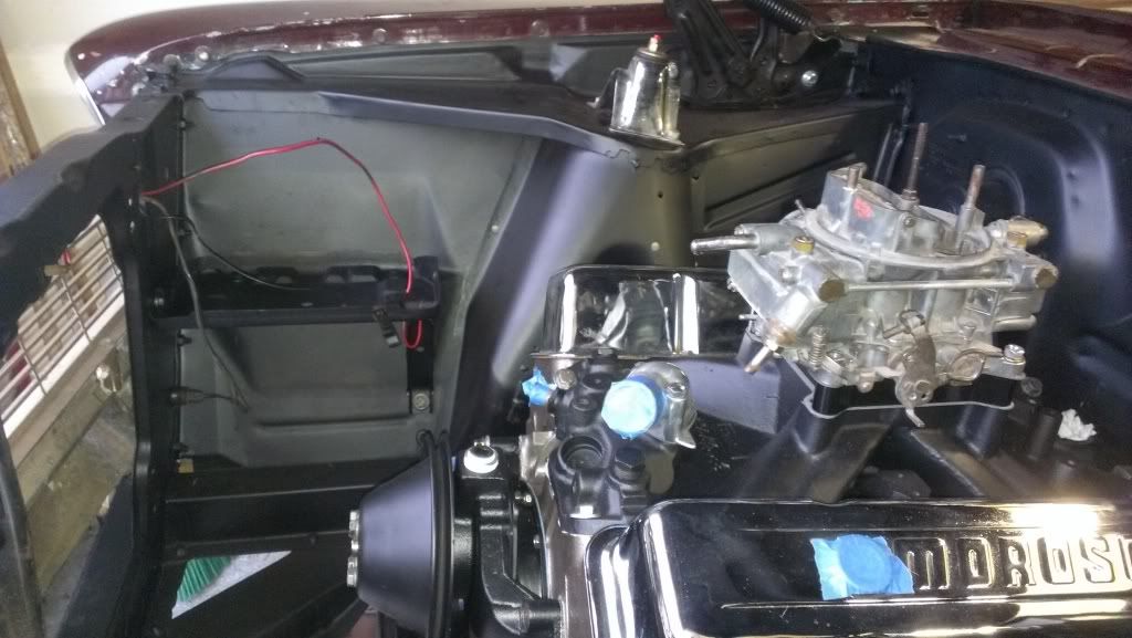

Kinda ran into a wall. Lots of of little fab shit I have to do and not enugh time this last weekend, but I got a few more little things done
PS pump and belt in
Alt test fitted and belt length is good on it
Main relay cleaned up, wired up and bolted in
Voltage regulator cleaned up, wired up and bolted in
Wiper motor wiring hooked up and linkage bolted to it
throttle linkage bolted in the car now
horn wires hooked up
Drivers side suspension is all done and tq down.
Front wheels TQ'ed down
Started to fuck with shifter linkage bracket that mounts to the transmission so I can shift it through gears, but it looks like im gonna have to do some fab work on it because it doesn't just hook up. Its the wrong bracket. Think its for a floor shifter or cable and my linkage is just that , LINKAGE.
And the dipstick tube that I though was for the Powerglide Is defiantly for something else. Once the tube is in, the bracket for it to bolt to the transmission sits about 3/4" higher that the bolt hole. So I think Im gonna weld a washer to the tube or something.
and last but not least, I pulled the batt out of my integra to just test the wiring, and low and behold, All my wring on the car works. Horns, turn signals, brake lights and everything else except the radio because the fuse for it is missing.
