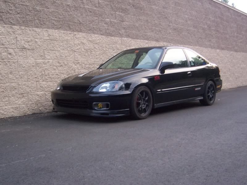

That black coupe looks nice.
yeah it was. . . had a ton of good things done to it. o well WTF can you do

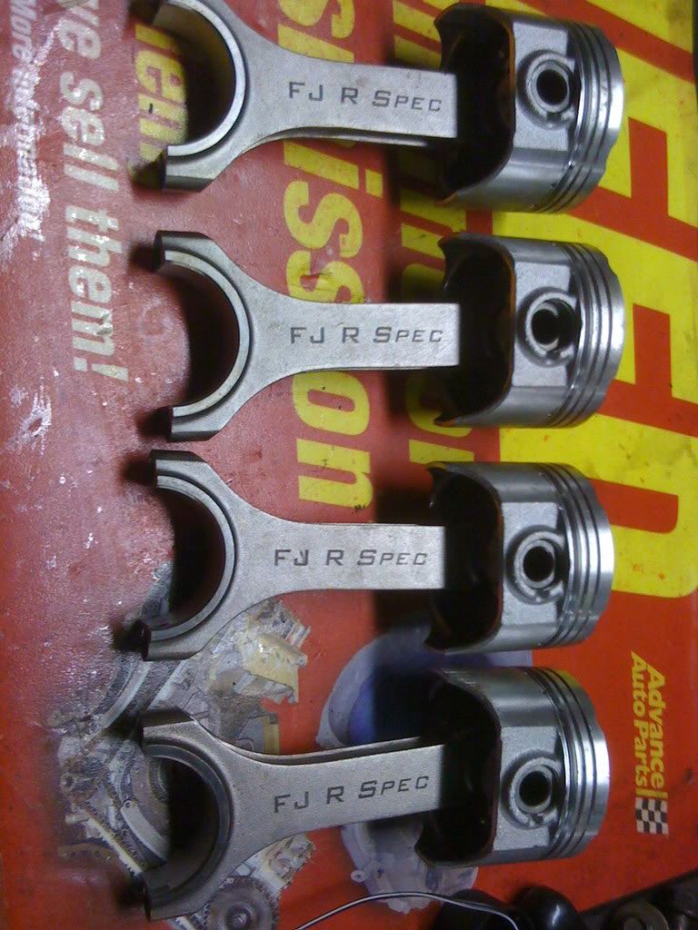

vitaras have slight scratches on the skirt from poor notching, said they were never ran just mocked up. . . idk getting kinda fishy. . .

got a closer pic, will polish off them never got to rings was only at the very bottom
wither way decent buy for 300 bones even come with new NPR rings

yeah i planed on plsting them anyhow. I want to try and just leave the mains alone but i have to take the cap off to tq the rods :-P
you can see the scratches on the piston way tp the right on the bottom of the skirt, he gave me another close up pic but cant find it.

Not bad what does the tops look like?
speedjunky01
  • Posts: 1015
Re: boost atempt number 3. . . 4 doohs fo' mo' ho's!
« Reply #20 on: May 04, 2009, 08:50:31 AM »
new nothing on them
