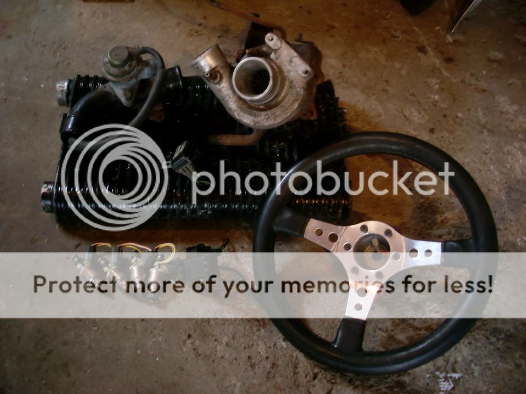

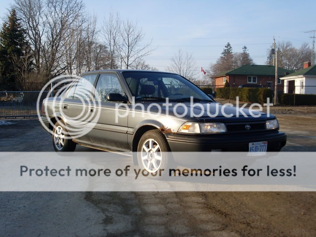

Vehicle - 1991 Toyota Corolla, 4AFE.
Options
1) FMU + cold start injestors and psi switches.
2) SAFC + 626 Turbo injectors
3) 2bar map + 626 Turbo Injectors
This thing is a feild car (was going to be my navex car but I decided to focus on the Accord instead)... it was just decided it needed some more power for spinning "too big" farm tires in the mud.
All the items listed are things I already have, so I would prefer if I could use that shit. I know that NONE of the listed setups is "good" but Im only shooting for "good enough".
Cheap and dirty is the name of the game on this shit box. Max boost its going to see might be 10psi. (Mitsu TE04H turbo).
