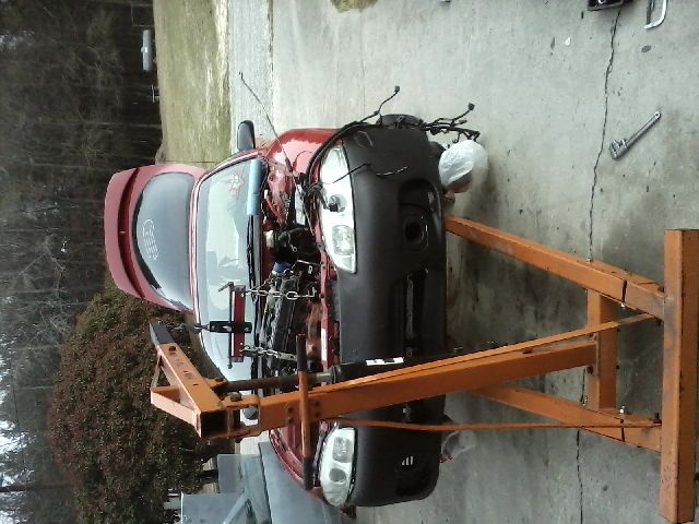

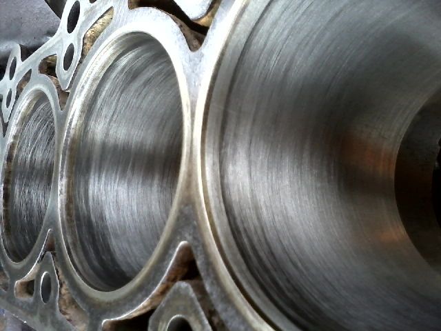

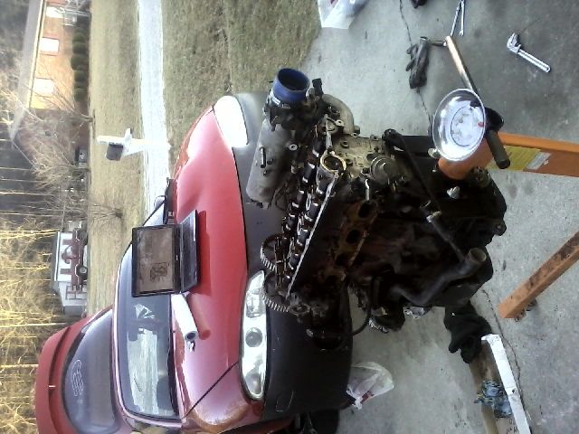

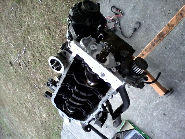

Built the motor and put it in the dsm.  Would have been running today but one out of our 3 man party had to go run.   The owner and myself put the clutch, gearbox, mounts and stuff back on in roughly 3 hours.  That's with food, cigarette and bullshitting breaks. Lots of people kept showing up today.  Had to loan my engine crane out, had to borrow one from another friend....
Anyway, that will be done hopefully tomorrow.
S13 got a nifty new hole in it's fender and cut the core support.  Oe radiator STILL wont fit even slanted.  Fuck it.  From the get go i knew about the only thing that would work for this without modding the radiator would be an rx7 unit.    Didn't have a chance to do anything with the downpipe yet but i'll get on cutting and tacking some of it tomorrow if i get a chance.  Dude wants to drive this thing to the beach friday to break it in so i may have to wait. He'll be paying me soon, taxes came in.  Not alot but enough to put some fun parts on my car i need.   We're going on a trip next week to go trade/sell alot of my parts i have.  Etc....  I can't say what is going on exactly right now aside from radiator and downpipe since those were the two big issues going on with the build.  THe rest is just bonus fun/parts.

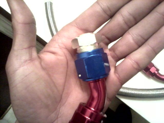

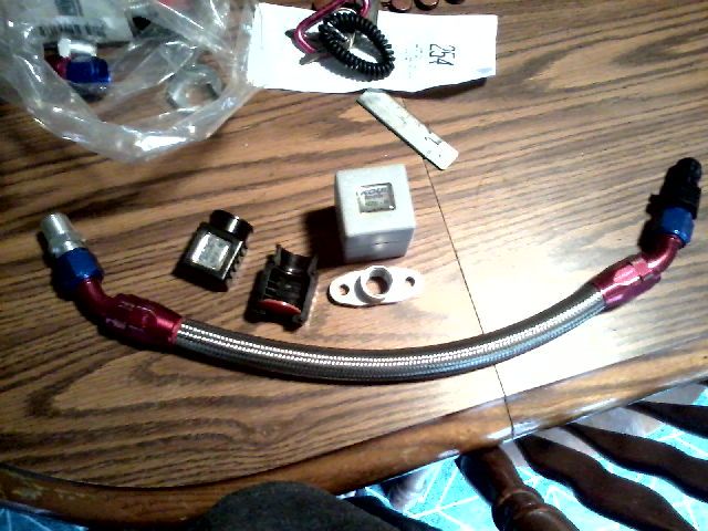

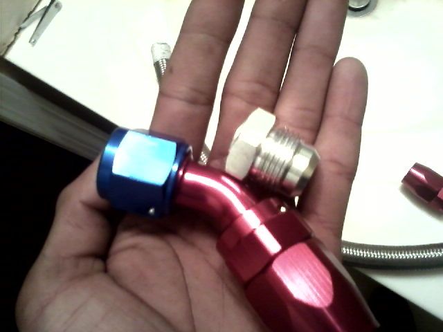

I plan on doing alot of ss braided shit in the future and was thinking there had to be a tool to make this shit easier.  Sure nuff.
https://www.youtube.com/watch?v=IL4kPrSZSEc

Well fine faggot.  This is a small scope of pictures documenting what i've been doing for my fren....
I ran back through this.  Hone fucking fell apart on me swinging it the other way to get the CROSS part of the crosshatch....
Fast forward.....

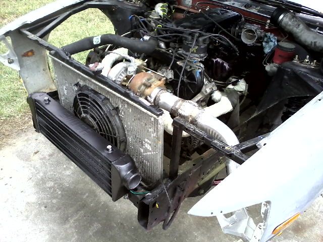

It's bolted in.  Finishing up tomorrow morning, putting fluids in, starting it, checking for vac/oil/coolant leaks and i'm back to work on my shit son....granted i never stop working on it.  I work on it at work writing formulas, fucking around with my ms (i literally bring it to work and plug it into my laptop in the truck) etc...  Nerd shit.  I'm bout dat life.
In my defense he just dropped off a bunch of nice non crush bent 2.5" bends, some 1.5" bends and some old aluminized steel trampoline shit i'm going to use to do some more happy fun things to my front end.  I ordered some coilover suspension and i'm going to pick up some more shit tuesday.  Relax niggaaaaaa!!!!
240 is still the same way i left it in the previous post but hey, here's a visual!   :noel:
Exhaust goes here.  Why not?  Fuck a quiet car.  Fuck sleeping.  I got plenty of nigs here locally talking mad shit wanting to run but wont talk shit to my face about running it so fuck them.  Fuck the police.  All out baller as fuck.
And i has to make new core support.  Can't do that until my radiator comes in and the radiator has no cap so like, i had to order a $40 remote fill neck.

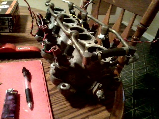

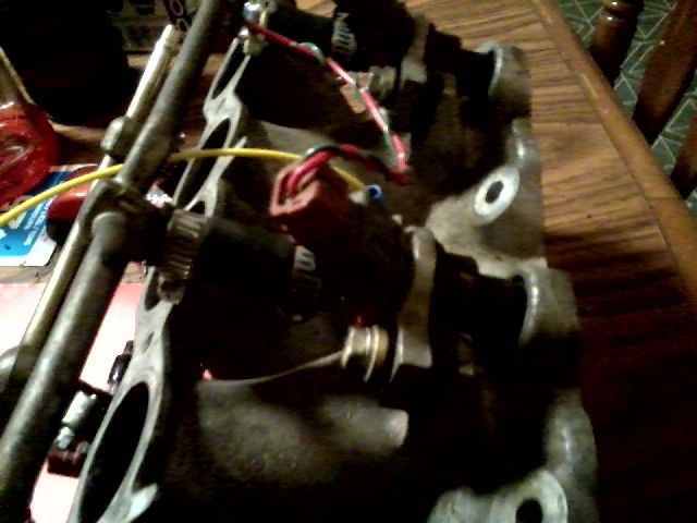

Tomorrow night i should be finished hanging the new injectors on the lim.   Clamps i picked up today are too small.  Excitement.  ;DDD   Because i'm lazy i'm pulling the motor back out again (not shit because no stupid crossmember in the way anymore.  Doing a multipiece now.  Should take me a days worth of work if i have one or two friends over helping.   Crash bar will bolt in and radiator/intercooler bracket/core will bolt in.  Makes life easier.

Side feed?

No, top fed bro.

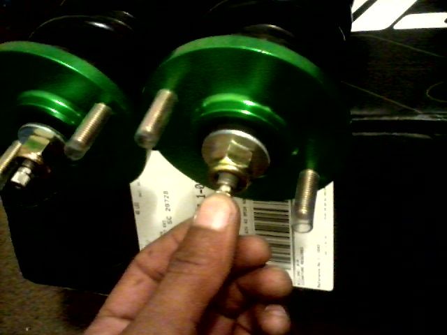

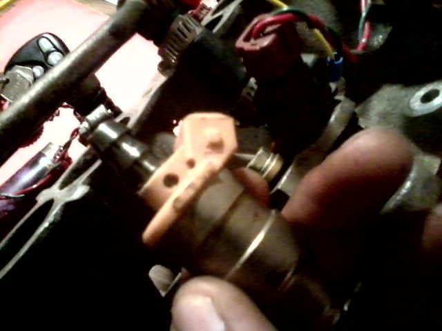

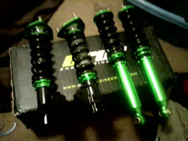

Coilovers came in today.  Injectors got done BEFORE i went to work.   Sd card wasn't switched over in my phone so i lost a good bit of that injector swap process but you can read about it here if you're interested.   I take ZERO credit for the link.  In fact, this very link is where i got my info from.
http://www.redz31.net/pages/fuel/fuel.injectors.html
All i really have to add is removing the stock fuel hose clip things are a pain in the ass.  Over an hour with tin snips and a metal pick to remove all 12 of them.  New injector (which is not barbed) recieved an o ring and a worm gear clamp.   The injector body hold downs fix the injector itself to the lower intake manifold and the clamps just keep the rail from blowing off the injectors.  They drop right in using z31 turbo seals and plugs.  You have to shave the tab off the bottom for the plug to fit but that seems to be how it is with injector swapping half the time anyway.

that is the most retarded thing i have ever seen. thats a fire waiting to happen. i worked in a nissan dealership at one point and dont remember that at all
NoPistons!
  • Posts: 495
Re: s13 build. Finish the damn do already!!!
« Reply #99 on: April 13, 2013, 01:22:27 PM »
No, if you're dumb enough to reach fuel pressures towards 100 psi and shit it's a fire waiting to happen.  They do make an o ring rail but it's aftermarket.  This is oem.  Mercedes also has this setup on one of their cars.  Injectors are 420cc.  Hose barb style.  Look this shit up.

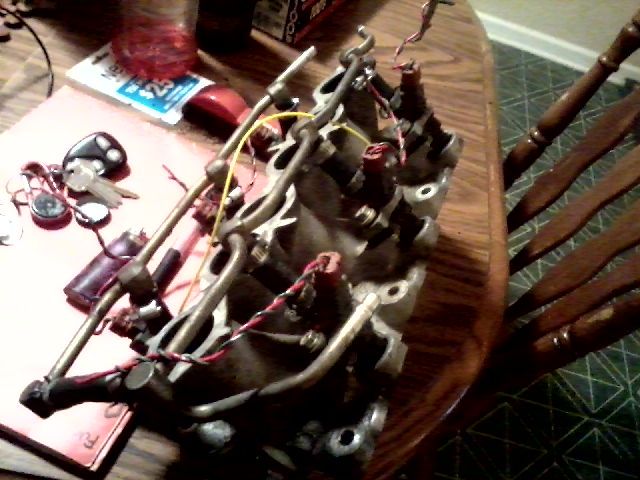

I've seen people hose barb and use the injector body locks to run additional injectors on older skylines and rx7's way back in the day over in j-land and the shit worked.  PR does it too.  This is why i love my cars.  Each and every one of them have stirred the pot until the water boils.  Must be doing something right.  =D
Anyway, mines:
The pink top barbed is in my hand.  The o ring rx7 injectors are on the rail.  Rest assured it was a BITCH to remove the oem ones.  those  weren't going anywhere without a razor blade and tin snips and i'm pretty sure these wont go anywhere either.  Seen several setups (identical intake/rail/injector combo) that are still living today done exactly the same as pictured putting down over 400 wheel.  Imagine that.
I may zip tie the rail down with 150 pound ties just for extra security.   Yes, i'm serious.

Oh, yeah, coilovers.  I've always been like "meh, coilovers".   I wished the pictures i took yesterday would have worked.  Came out alot better.....  I've owned JIC (garbage), D2 (Came on my car when i got it.  Msrp is high but great coils.  Damping could go full caddy to full pissing blood from kidney fail in 32 clicks) and now these.  With my stock shocks free'd up i can cut them apart and work on the billstein hd setup which i should have done in the fall.  That's going to take some time and money......   These SHOULD hold up fine and if they dont, warranty.  =D

My problem with the hose on the injectors has nothing to do with pressure. It has everything to do with sitting on top of an engine, heat cycle after heat cycle till they dry rot and bust. It's not making the power, I know it will work, it's longevity

As long as it's fuel injection hose it'll be fine. Unless you're worried about your feed and return lines as well?

ALL my fuel hose is high pressure fuel injection hose. Wouldn't dream of using anything else aside from aluminum hard line or SS teflon lined.
Edit:  O rings and injector seals have around the same life expectancy as the rubber hose.  If you are stupid enough to just let that shit go and dry rot you deserve to watch the shit burn to the ground.
I've owned 2 rx7's.  Pretty sure my ass is covered from the paranoia those things put me through.   Just because i switched back to pistion engines doesn't mean my rotary basics were forgotten.   I think about safety quite regularly.
I made my own DSM injector seals with buna-n hose, which means it contacted fuel/oil/manifold at the injector bung. It took about 2 years before it showed any aging. I'd estimate 5 yrs for this setup, so it should last just enough to get it running! ;DDD

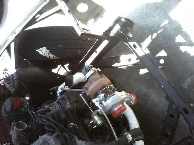

Ghetto as fuck.   Pipe mockup was done David Blaine by hand because i think i need to order some couplers.  Def a 3" for the cold pipe.  Opting to use the composite stuff for that.  No steel or pvc needed and i have leftovers for my buddies car or whatever.
And i love this motherfucking toooooooooooooolllllllllll.

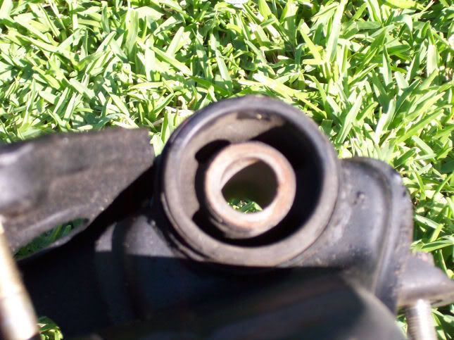

And this is ONE of the stock bushings.   Subframe is held in place by 4 bolts to the chassis and these are the bushings.  Enough play in them to have me concerned about consistent geometry.   A good driver can get around it.  I know i can but because i have power and retarded amounts of steering angle, stability and traction must be on point.  I'm crazy and LOVE throwing the car as hard as i can.  If i spin, oh well.   Gotta keep it nasty as fuck but safe and competent!
Way this works is the slotted collar goes on top and the 360* goes on the bottom.  No need to lower the whole subframe (which is a pain in the ass if you dont have a transmission jack.  I can borrow one from my homeboy but no need.  They make subframe RISERS which you need to remove the stock bushing and it gives you a bit of roll center correction WHILE lowering the car a little bit as well but i dont have time for that and probably do not need them.  Collars are fine for 90 percent of the driving people do with these cars.

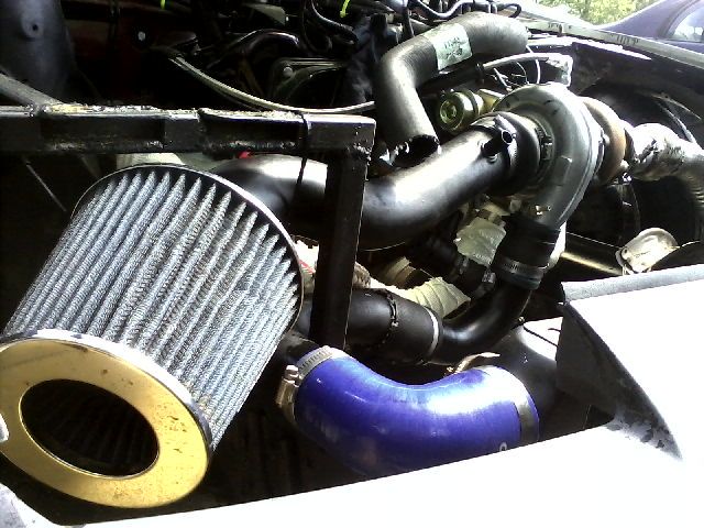

Two good things happened today.  Finished my charge pipes without having to order shit.  *nog level over 9000*

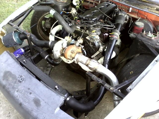

Little overview of the bay as it sits.  This was maybe an hour and 20 minutes ago...

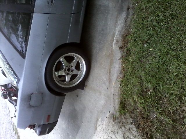

Wheels have changed.   Color is changing as i get windows of niceness to actually do some rattle canning and sanding.....    Got a sabelt and Gforce sfi approved harnesses, both seats are OEM so they will pass tech.    I broke my vband clamp and need tires.  Oil i got in here is rotella 15w40.   I put 6 quarts in and it's barely at the "MIN" mark so i guess that means my ass doesn't need an oil cooler huh?  Oil changes gonna be a bit pricey in this bitch.

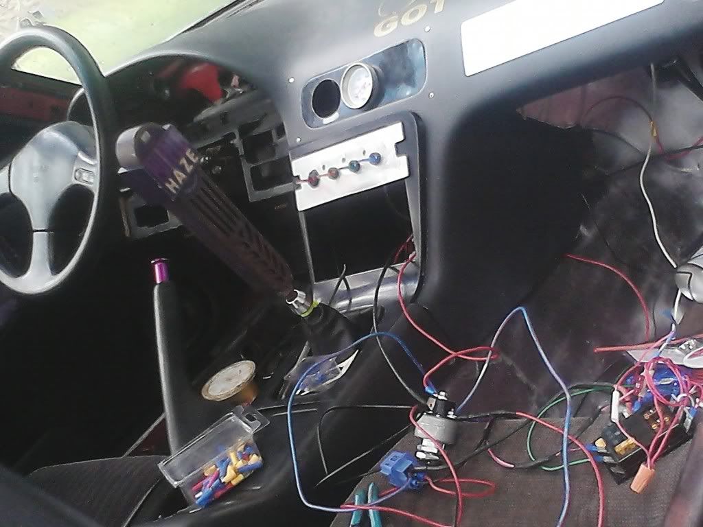

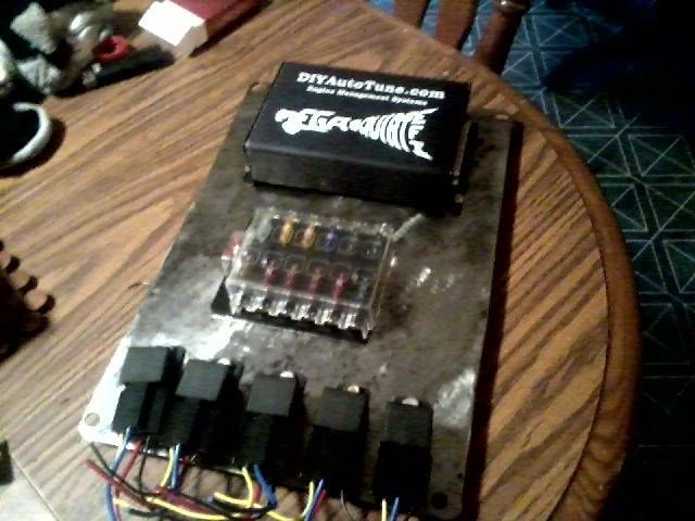

Wiring And because I'm an intellectual being,  megasquirt.  this is just the main efi shit.  I haven't wired in any kill switches.  Red switch is for main power to ign switch, yellow switch is lamps, green switch is fuel pump, blue switch is efan granted i can mod the squirt to handle that.   I'm now running n onboard bip coil driver in the case since i couldn't get the stock ignitor figured out.  Didn't want to get the resistor value wrong and break something.
I'm trying to start it today or tomorrow depending on how well of a job a do, what doesn't work, what does work, what registers, what doesn't.  Meh.  I hate wiring.  Really.

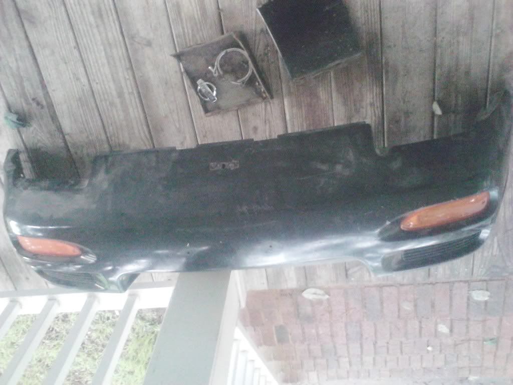

Also old bumper vs new bumper.

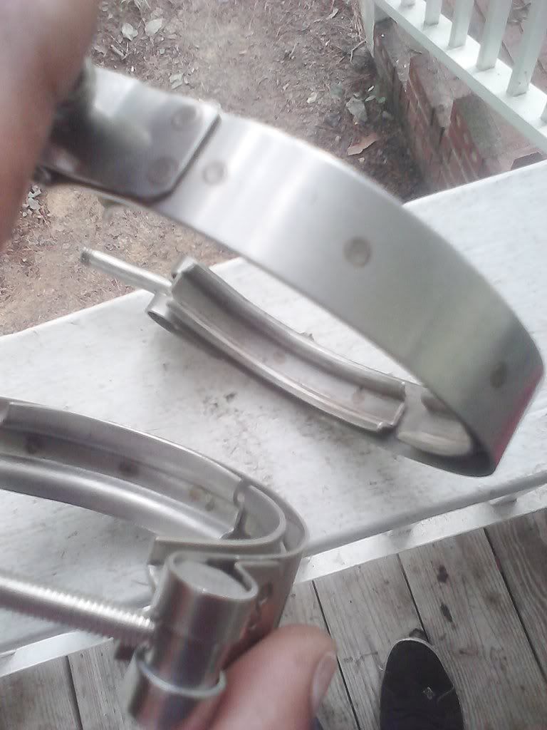

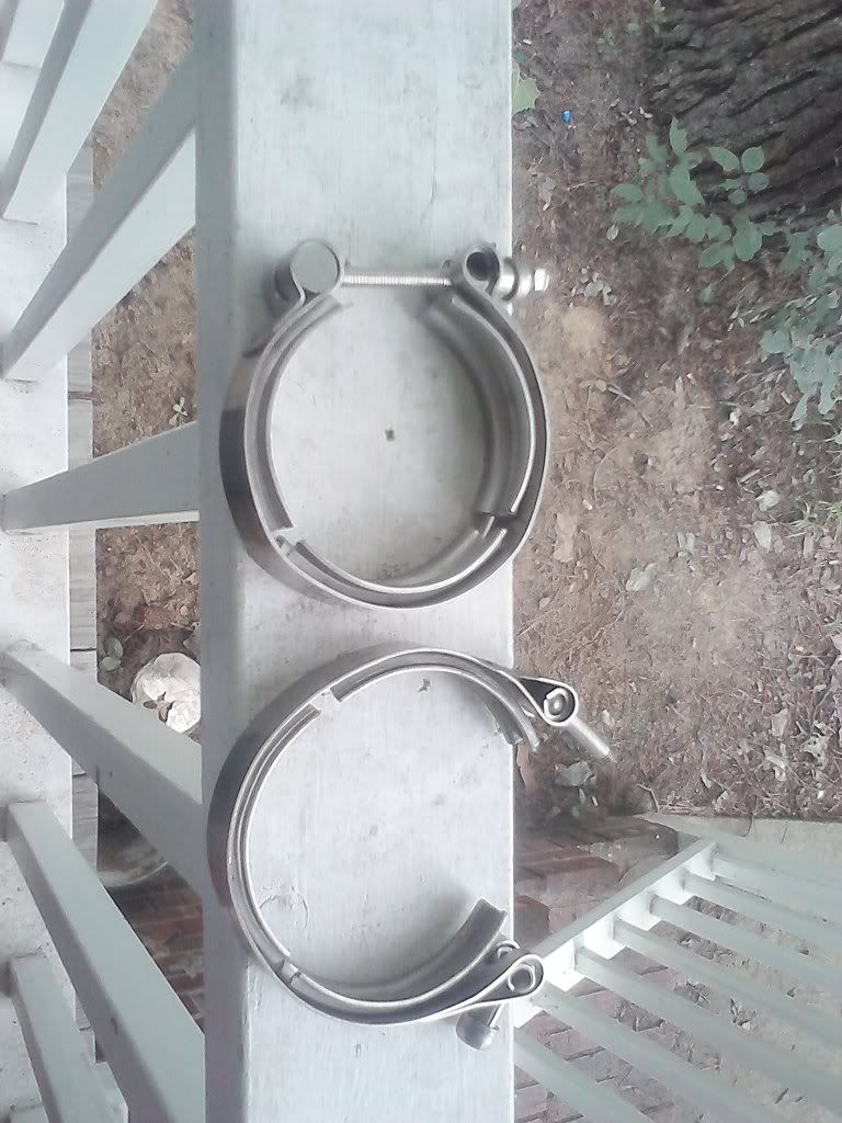

I paid $10 for a new v band clamp to replace the broken one.  Pulled it out of the package today and it looks TWICE AS STRONG as the other one i paid $30 for.   Also the clamp area is better designed.       Original V band i broke came from ORIGIN MOTORSPORTS ON EBAY.  THEY ARE SHIT.  FUCK EM.  DONT ORDER ANYTHING FROM THOSE GUYS.  They are VERY dodgy when it comes to answering questions about their fab parts and boost goods......    This new clamp came from a seller called "SPEED DADDY".
I dont condone buying shit from ebay/china but in a pinch you do what the fuck you gotta do.  "Speed daddy" clamp on the left.  Origin motorsports clamp on the right.  Fucking garbage.
Guess i'll go put my downpipe back on now.
« Reply #117 on: July 12, 2013, 04:01:06 PM »
does the 'beefier' one use drilled pins and a standard bolt?
The cheapo ones I have have look like the smaller one in your pic
once the threads rust and the stud snaps it's garbage.
The latest one I got, there were two pins with the strap wrapped around them
one had a through hole and one tapped.
If the bolt broke, take it out and replace the bolt.

Lol.  Well fuck you too!
The beefy one looks like the bolt goes all the way through and was welded in on the backside.
The shitty one?  I haven't looked at it.  It just looks to be pinned and bushed.   To be honest i didn't put alot of torque on it.   When i was backing it off (like i had done about 4 or 5 times before) it started to catch and eventually snapped at the thread.  Nylock wouldn't even turn.....  I'll save it and repair it later.  Who knows?  Might put a full exhaust on this bitch someday.  I have work out a better manifold arrangement for it but that's months or maybe even a year or so away.  Idk.  Hope what i got works and isn't too mental at cruise speeds/rpm.  Nothing says "i got the powah pull me over pig" like an open downpipe turbo car.
Nevermind the tuner studio mess.   Easytherm was on some fuck shit and wouldn't cooperate.   I went and rigged up a brand new gm sensor.  Corvette 98 iirc and it fit in the old nissan temp sensors spot just fine.  Did the appropriate cut and crimp so no more worries about inaccurate sensor readings.  Open element ait already in the charge pipe.  Wideband in the downpipe.
Following need to be tested before the first start:
CAS adjustment/ 6 slot pickup (MS LED OFF/ON around 10* btdc for static timing)
INJECTORS (simple on off sprits of 93 will do it for me on both banks rotating the cas by hand)
PROPER SPARK to verify (-) (+) correct on COIL.   I know my transistor is proper,  If coil gets warm i know i got it backward and if it blows i have 2 spare.
FUEL PUMP RELAY triggers ON with ignition key/ms
IGN SWITCH RUN/ACC/START EC CONTINUITY (making sure ecu does what it's supposed to for both these phases)
I did add a relay to the starter as well as the coil.  Can't have them drawing direct from fuse boxes or batt/switch without one....well for my peace of mind anyway.  Most of the ones used are NISSAN units.  They are robust, last forever, handle a good bit of current and if you wish not to use nissan plugs, standard spades work fine!   $12 for automotive relay at parts store.  $6 for 5 of them from china.   Free for as deep as your pockets are at the junkyard.  In some of the older trucks they are weatherproofed.  Nice bonus.
Oh, just incase anyone is wondering about the delslow, that's a family friend's car.  Diff or something is fucked in it.  She's auto.  Bone stock.  My brother is negotiating a buy on it.  He wants to do some dirty thirds boosted and flip it.  Totally down to help with that so maybe you might see more of that car.
