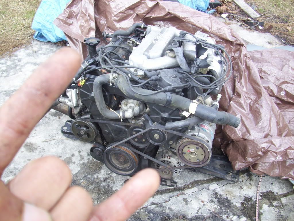

Engine- vg30et.   Pulled from a fwd maxima, rebuilt with $250 ebay kit. 9:1 compression. $200 ebay t3/t4 60 ar housing cold side, 63 ar hot.  2.5" v band adjustable internally gated 5 bolt housing.  Journal bearing. Wheels are are about the size of an hx35, maybe smaller.  i figured i wanted to go between stock and the hx35 for this.  I'm not sure what kills z cars other than neglect and stupidity
the cats meow:
Guys, i'm not sure if that restrictor is safe but if need be i'll just bore it out. put a twist type ball valve or tension spring ball on the line at the oil sending unit. all hardline.  Why not hardline?  Sold my generic e bay to a friend in need, actually sold alot of shit i bought because i didn't care about my car anymore.
quick facts:
VG30E 84-89+: Engine compression ratio of 9:1
VG30ET 84-87: Single Garrett T3 turbocharger with a factory boost setting of 6.8PSI and an engine compression ratio of 7.8:1
VG30ET 88-89+: Single Garrett T25 turbocharger with a factory boost setting of 4-5PSI and an engine compression ratio of 8.3:1

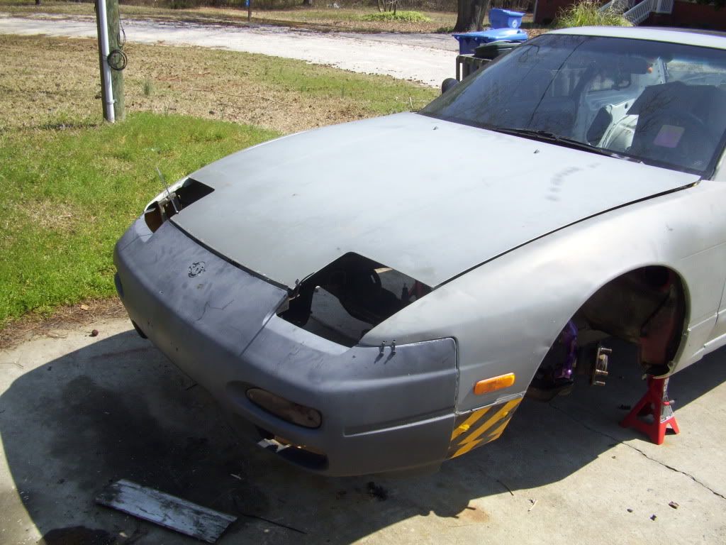

I'm working on the mani.  Header parts are on the way.  I had to cut some corners and you know what?  Zero regrets.
Early progress?
Gave it my evil blessing bunny ears.
I kinda missed when it looked like this.

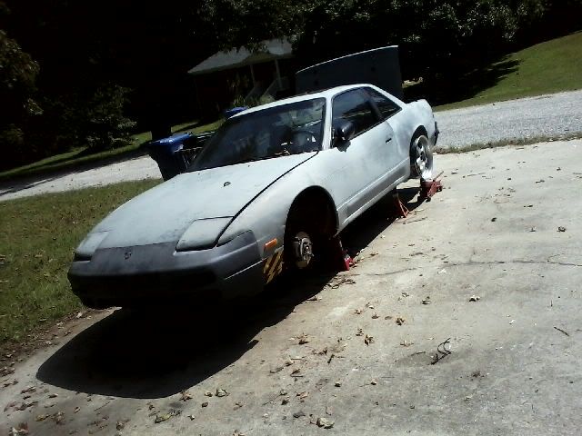

Wanted stock body...that aero was hiding alot of battle damage.....  I'll repair what i can.  Kinda want to gentlemen the thing up but not think to hard about it you know?  Standard resto shit....Next time you see the car it will either be moving or on the ground and not so ratty looking.  Black.  Not flat.   O0

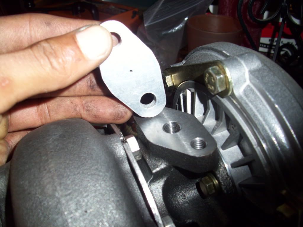

Well since that's all fine and dandy can you guys answer this:
  Is that restrictor too fucking small?   I think i bought it for a gt28r years ago and found it rummaging through my parts bins trying to raise build funds.
I was thinking about drilling it out and using an adjustable ball valve on the feed line.  Ideas?

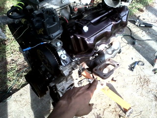

Turbo mani tacked.
Ready to unbox this dope shit with yall here in a little bit.

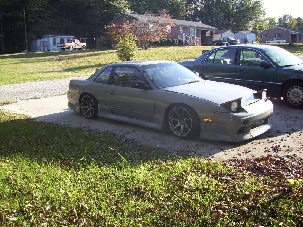

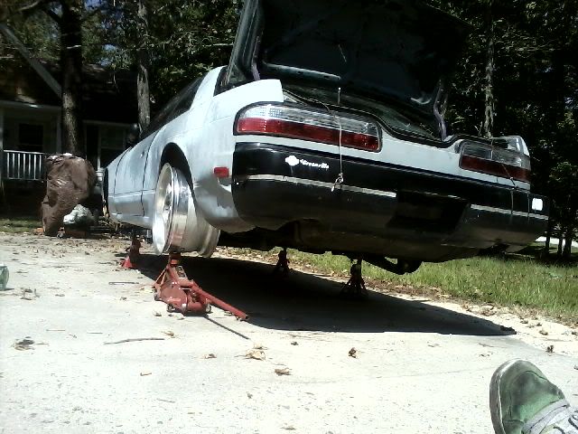

Rained today.  I took some current snaps after fixing a flat tire in the rain while fighting the worst cold i've had all year.
Grip?  Check.
More angle to be had here after adjusting lca, caster and camber.  Bear in mind thats an 8J at -3 offset with a 245 slapped on it.   Well aware there is no cool tire stretch or rim tucking going on in here.  Running in the 90's.  No one sleep in Tokyo.  Got it?!

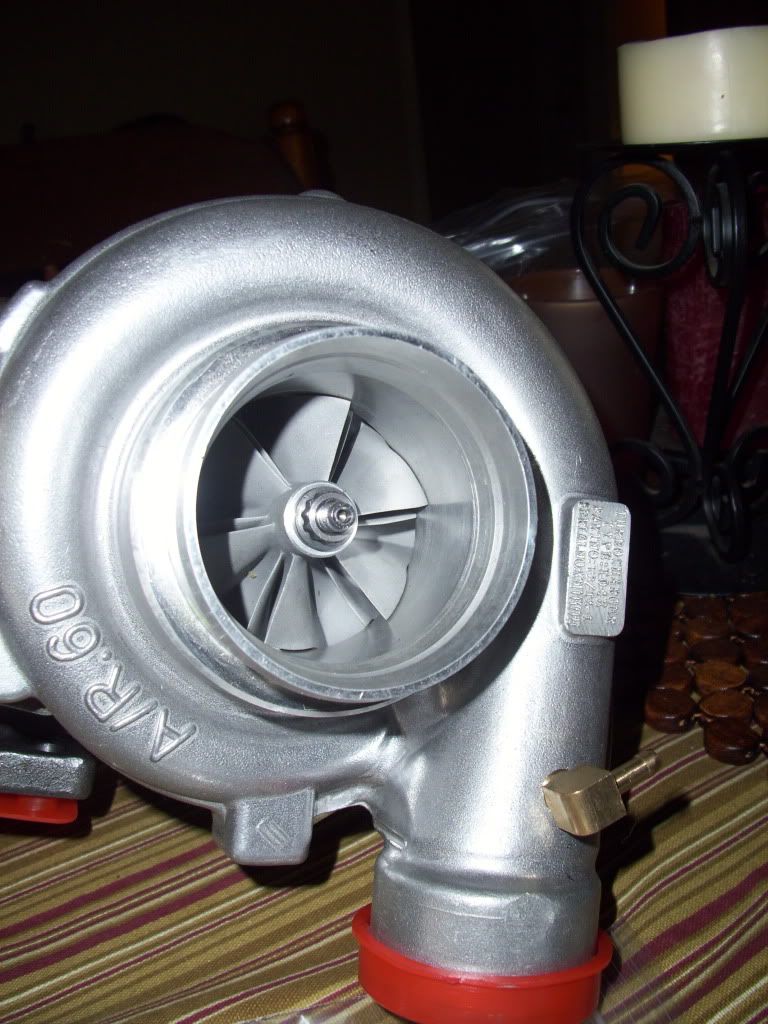

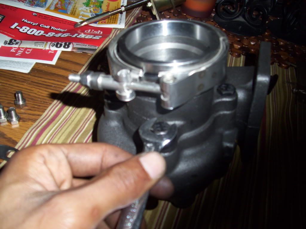

omnomnom $200 china turbo hate onnnnnnnnnnnnnn omnomnom!!!!!
This is exactly what you think it is.
I bet it outflows anything out there.  Period. It suxxxxxx.  Never again will i do it like this.  It was.....something.  I'll say that.  It walked bad welding it and will have to be slap chopped again.  I'll add a flex section.  I still have my old rwd crossover pipe so will try to recycle that.  People have suggested i move the turbo over to the passenger side.   That'd mean having to modify my drain after i already put the tube behind the alt.  Idk.  Open to suggestions fellas.

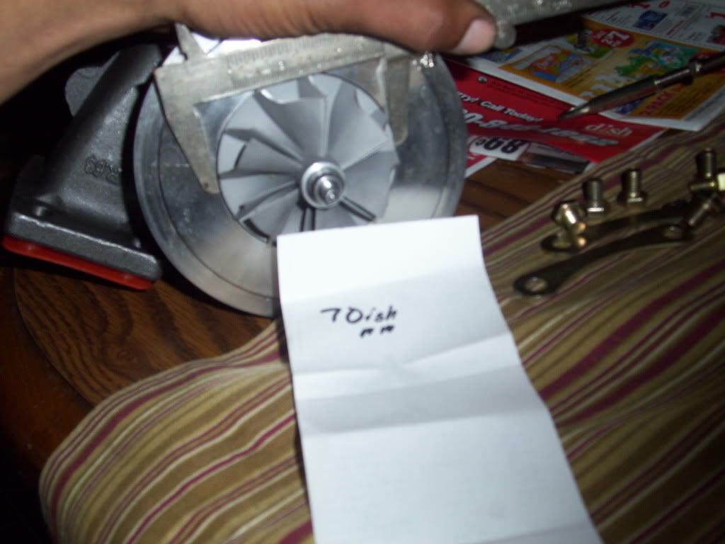

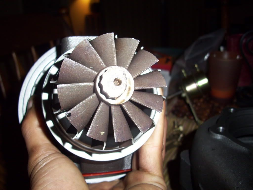

Any idea who the ebay sell was for that turbo? It looks like they actually did some balancing to the turbine.
NoPistons!
  • Posts: 495
CX racing.  Call them up sometime.
EMOTOR/EMUSA is another good distributor.
By good i mean they will look out for you if there is a legitimate issue or inquiry about their products because they want to be a successful business, not some seedy as fuck rip off "imma get rich off of stealing peoples money" scammer vendor flipping junk bin snails for $300-500 then fucking you when your shit smokes or is hitting housing out of the box.
Edit:  Compressor wheel was also balanced on the back side.  not with a mill like i've seen before with other parts/turbos/wheels i've had in the past.  Looks like nogs took a grinder to it until it came out good enough.  Lol.

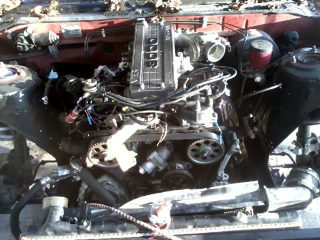

A honda lower header pipe.   The 2-1 with flex and 3 wire o2 sensor.  I can use every bit of that on v2 manifold.   Some random pipe i picked up off the ground that has some ok gentle bends to it.  not as thick as the honda pipe but the flux core can't burn through it.  I think the iron content in the metal has alot to do with how my machine performs so hopefully this version looks better too!
Z31 300zx front transmission seal plate, clutch fork, tob sleeve, slave cylinder and clutch fork boot.   That's the LAST of the gearbox shit in my hands i has now.   It took us 5 hours and alot of cussing, swearing, telling illegals to get the fuck out of our country, etc..... i got my shit and i am fucking pumped.  engine comes back out some time after xmas so i can put the clutch, starter, driveshaft and all that shit back on the car for good.   Lucky us the car i tried to pick this shit from last time was still there but this time i had some muscle with me and some z31 advice on getting the top bolts of the bell without removing the crossover pipe.
Still haven't tested my ms (because been busy foolz) but hoping to fire her up on my laptop sometime this weekend.   Junkyard work has made me pretty sore so i'm going to burn some fine shrubbery and prolly get to work pinning my db37.
