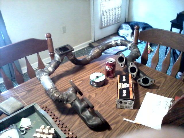

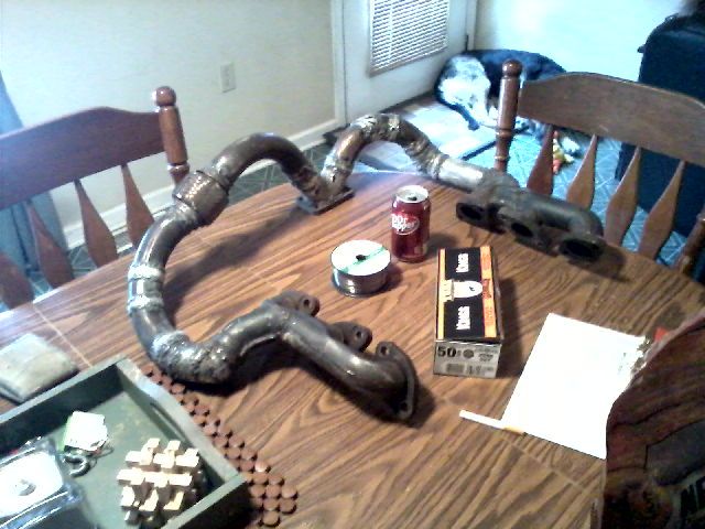

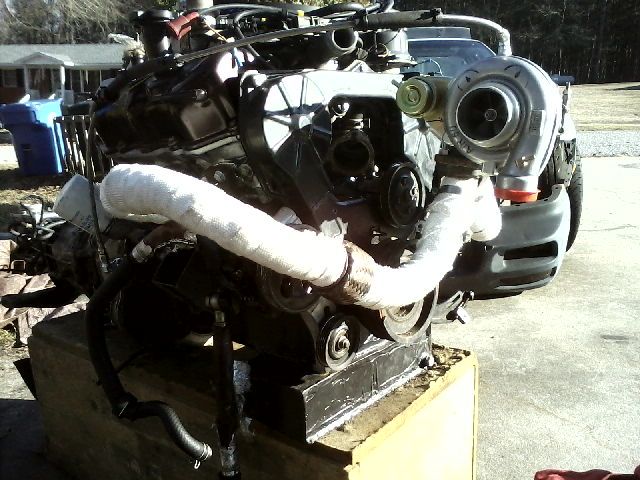

Last revision of the budget manifold.....   It looks the same but pushes the turbo closer to the front of the car.   Wont know if it clears the rad/fan until it's in.  If it doesn't clear i'm going to slant mount an eg half core.
Fuck hobart gasless wire.  I hate the shit.

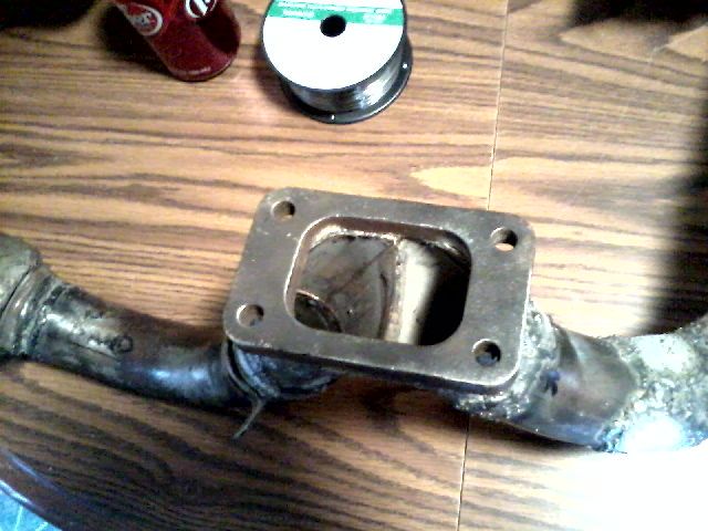

Originally, i wanted a sink trap setup off stock manifolds.  I guess i succeeded.
I went back in here and welded/de bird shitted inside the collector after this pic
Hobart fail.    Thank god i opted to run wrap....
Home.  Bolted.  Gasketed.  Clocked.  Wastegate actuator is set so the flap door is cracked open about 3-4mm at 0psi because megasquirt and questionable condition injectors and high compression motor.
Feed line on.   Proper restrictor and all.  Running 2 90* -6an's to put this away from rubbing on everything.  Glad i bought two kits!  I used pieces from both and it was non optional!

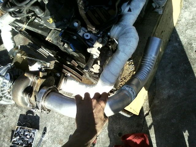

Picked up 3 more bends to aid in downpiping yesterday.
Something like this maybe?

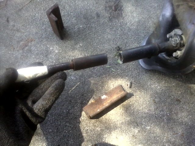

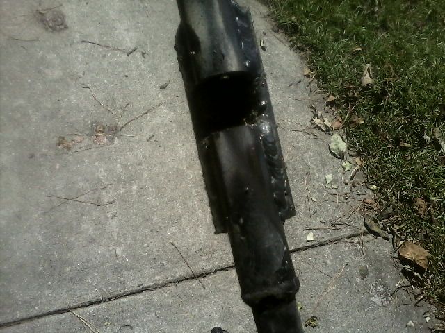

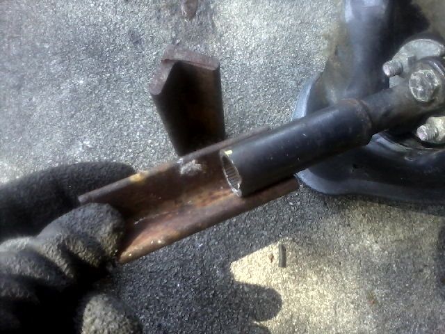

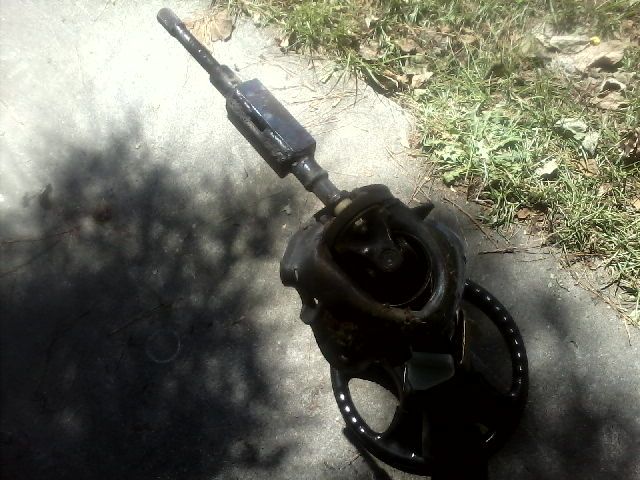

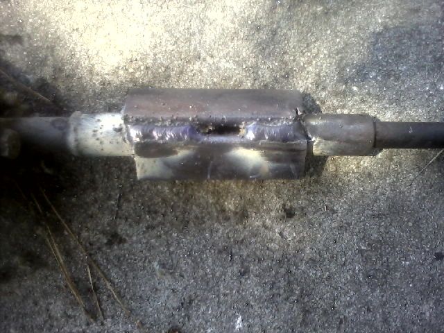

Oh, and here's pics from my steering column extension project i did a while back.
I'm ok at flux core if the wire is decent.  THis is cleaned up and lincoln brand gasless wire.  Good shit.

Doin werk. I like it. Haven't seen solid flux core work in a while.
