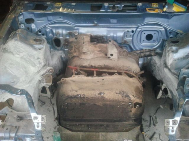

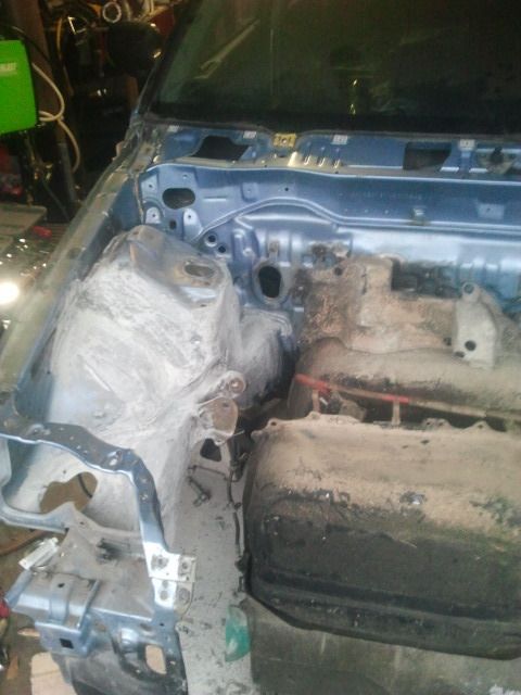

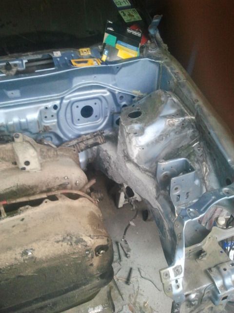

As it sits: Engine bay getting prepped for a white paint job.
Don't mind the fuel tanks

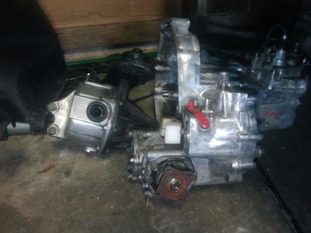

cleaned trans and rear diff

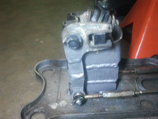

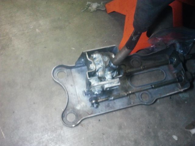

DIY rt4wd short(er) throw shifter. (Thanks to Gizmo for this idea.)

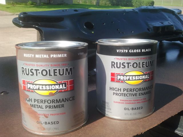

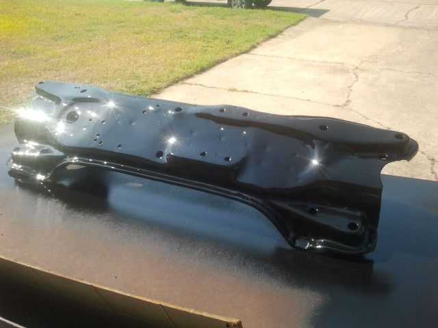

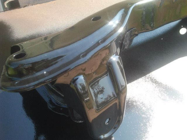

LCA, knuckles, RTA painted gloss black
(cross member sprayed as a durability test piece

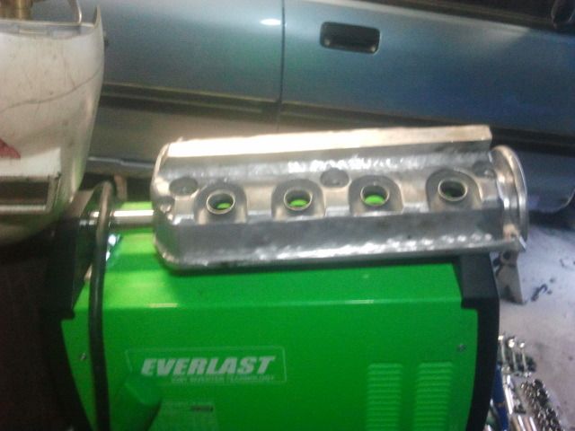

Speedfactory style vented VC
My aluminium welding is meh.

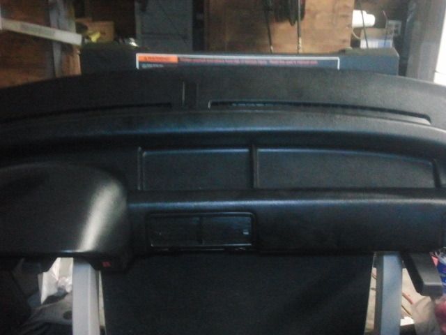

Interior repainted black

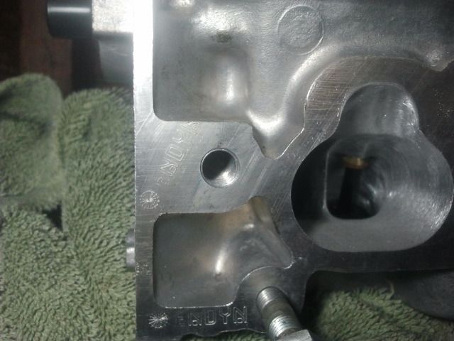

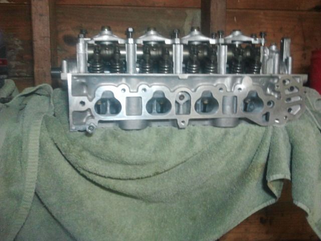

Endyn port and polish head with supertech valves, springs, etc

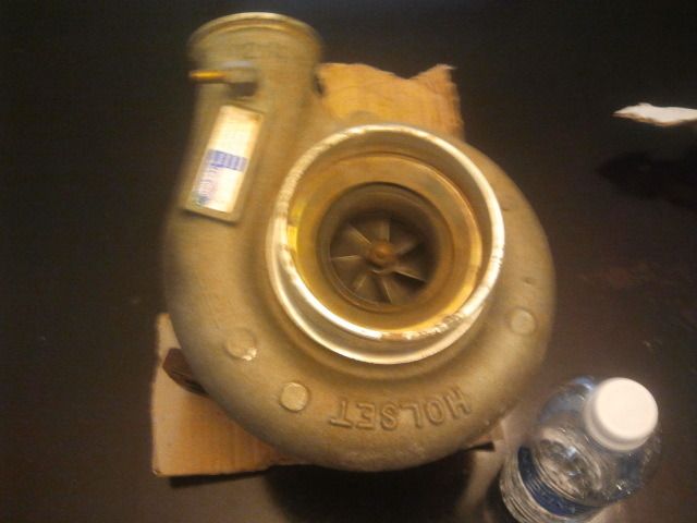

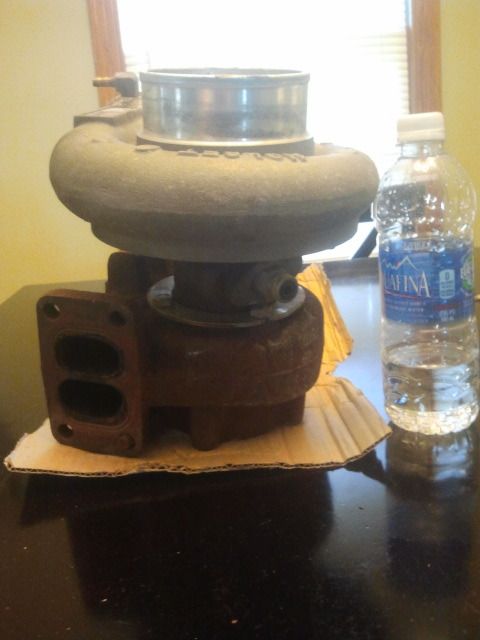

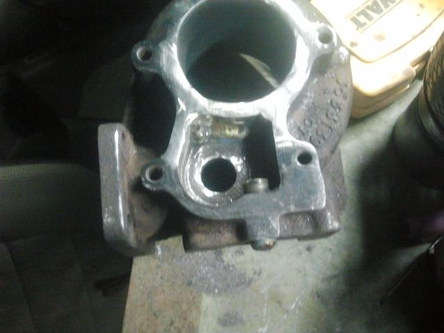

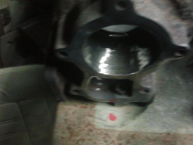

Hx35 7blade with 12cm turbine housing
Welded in a plate to separate wastegate "area"

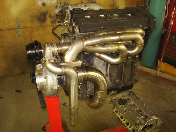

I will build my own sidewinder twin scroll manifold so I can retain my AC.
Manifold and turbine housing will be ceramic coated or blanketed to reduce heat/help spool.
If I can get close to using the full potential of the 60lb/min turbo I'll be happy.
(i know this is not TS, but so you get the idea)

The drivetrain should hold up ok. Only concern I have is the 90° gear in the transmission. On a RWD wagon build it was the first part to break.*
If transmission fails I will make a D2B and use a CRV trans with the wagon rear diff. I will use different size tires at that point to offset the difference between wagon and crv front and rear diffs.

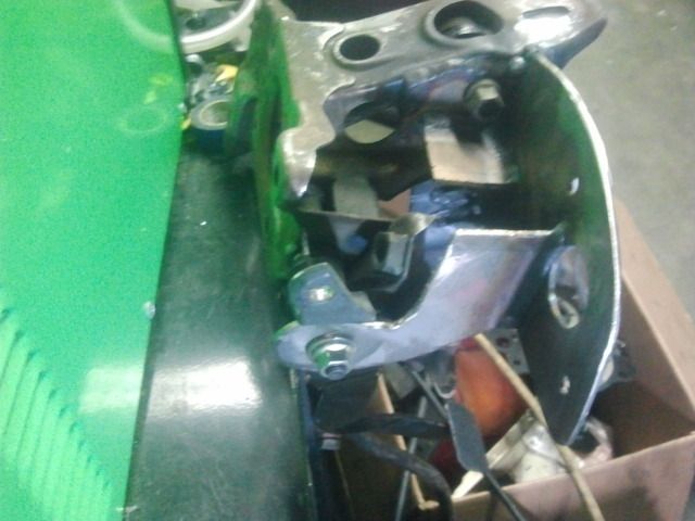

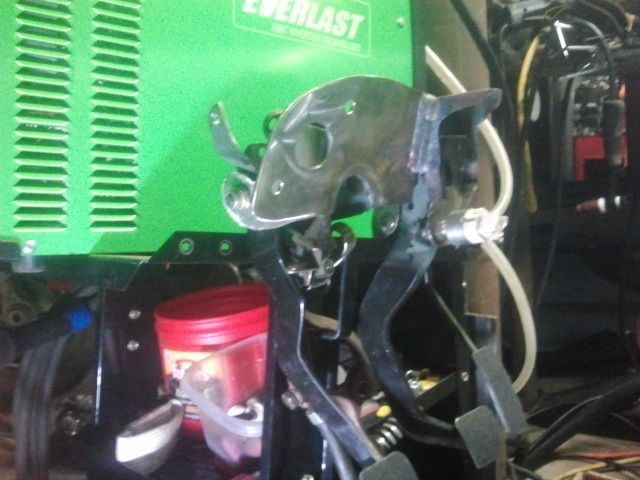

The I made a bracket for a master cylinder on the wagon pedals. It is hydro to cable converted to help with reliability with a heavy clutch.
Also, skateboard griptape on the pedals.

What is used to look like before I made into a project.
Did more putty and shaving in the engine bay.
Will have some after primer, paint and engine mounted for manifold fabrication.

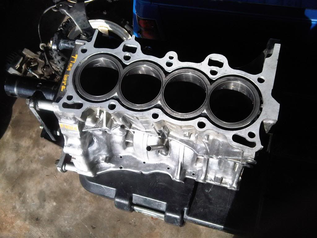

I sent the block to the machine shop with a new crank, and girdle. When I bought the block it had an A6 crank, and girdle that was align honed. The previous owner set the clearances on the tight end of spec. When I wanted to open up the clearances I ran out of bearing sizes. Since I would have to send it to the machine shop anyway I just figured I would use a Z6 crank/girdle. Getting the new crank polished, girdle align honed if needed, depending on readings, and a little bit of a bonus.
Readings that were taken:
Rod journal spec 1.7707-17717
Rod journals (after crank polish):
1) 1.7709
2) 1.7707
3) 1.7709
4) 1.7709
Rod bore spec 1.8898-1.8907
Scat Rod bore:
1) 1.8907
2) 1.8905
3) 1.8905
4) 1.8905
With that I can calculate what bearings I will need to get around .0018".
Do you think that these rod clearances are sufficient for a 500-600hp build?
Now the main specs, and readings.
Main journal spec 2.1644-2.1654
Main journal:
1) 2.1646
2) 2.1647
3) 2.1646
4) 2.1646
5) 2.1647
Main housing bore spec 2.3228-2.3237
Main housing bore:
1) 2.3235
2) 2.3241
3) 2.3241
4) 2.3244
5) 2.3237
As you can see the housing bores are out of spec. What that mean is that the bore is too big, and there will hardly be any bearing crush. So as you may have guessed I will need to get an align hone on the girdle.
What that does is take material off the flat surface of the girdle so it makes the bore smaller.
The machinist doesn't have the small enough tool to do the align hone at the time, so I will have to bring it back to him in a few weeks when he buys one.
Now the bonus work!!
I had a grove cut for a copper o-ring.
Here comes >30psi
It is a .040" grove cut down .030" so that there will be .010" of copper to crush for a better seal.
That's it for now I think. I've been out of town for over a month, and I go back after thanksgiving.
Yes they will work, your turbo will barely break 500hp, unless you make into a hx40/35 hybrid.  :noel:
When I said 500-600hp I meant flywheel, sorry about the confusion. The 7 blade hx35 is a 59lb/min turbo, equals to around 590bhp max.
Well, that's what it flows at diesel pressure ratios.  Good luck doing that on gas, despite the extra exhaust energy.

« Reply #27 on: November 26, 2012, 09:03:46 PM »
Actually, a 7blade hx35 @ 59lbs/min are logs that were taken from a dsm.
At any rate the rotating assembly, sleeves, head, and etc. will be able to handle anything I can get out of this holset.
« Last Edit: November 26, 2012, 09:07:59 PM by thagreenteam »
Re: Super slow build / twin scroll hx35 rt4wd civic wagon
« Reply #28 on: November 26, 2012, 09:26:36 PM »
JD means that the turbo will most likely max out around 500hp
thagreenteam
  • Posts: 14
« Reply #29 on: November 26, 2012, 10:29:14 PM »
Quote from: crxvtec91
That's fine by me. I'm shooting for maxing it out, and wherever it ends up I will be happy. Hell I would be happy with 100hp right now.
