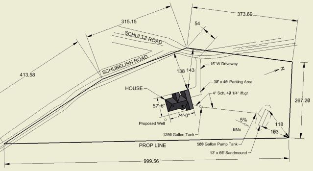

Siteplan, drew it up along with the houseplans using Autodesk Inventor:

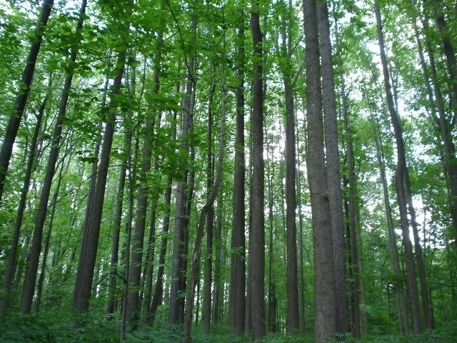

Here's what the property looked like.  100% covered in trees:

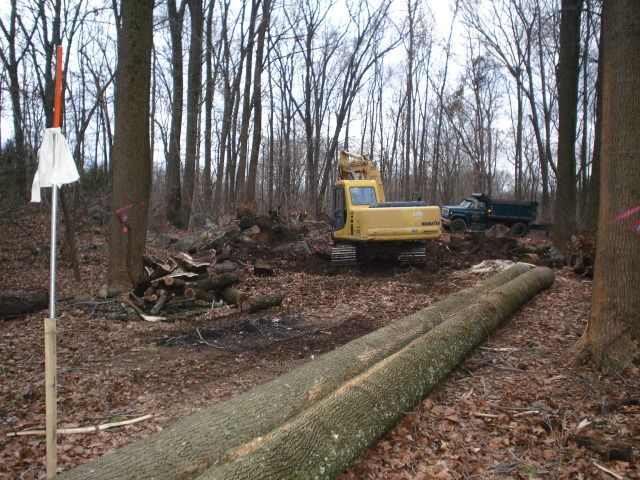

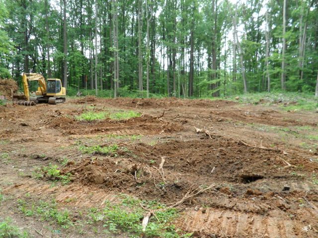

Start cutting:
Mother nature getting a good fucking:

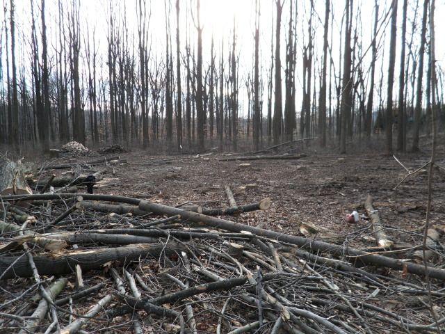

Burning is the quickest way to get rid of shit:
Damn Obama government ruining my progress:

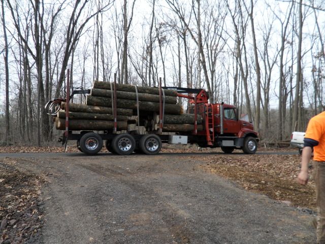

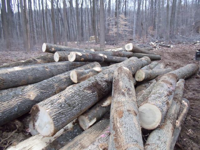

Sold off the larger lumber:
Cutting in for the driveway:
Found a full beer while digging the driveway.  Pulltop and all, free beer   O0
Stump removal:

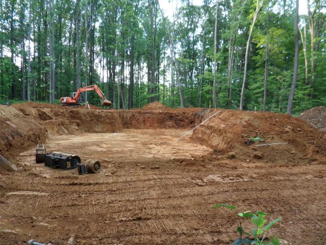

Starting the hole in the ground to throw money into:

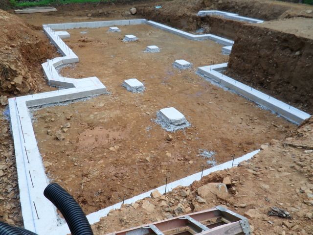

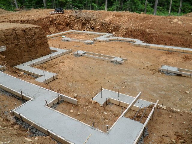

Footers:
Forms for the basement walls:

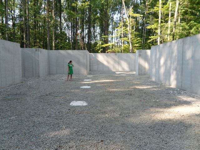

Future wife checking out the basement walls:

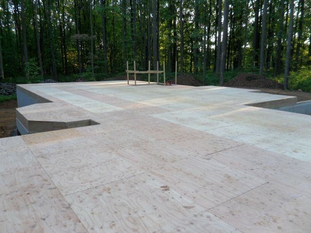

Started to decking
Subfloor done:

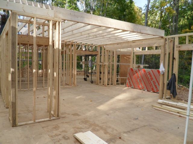

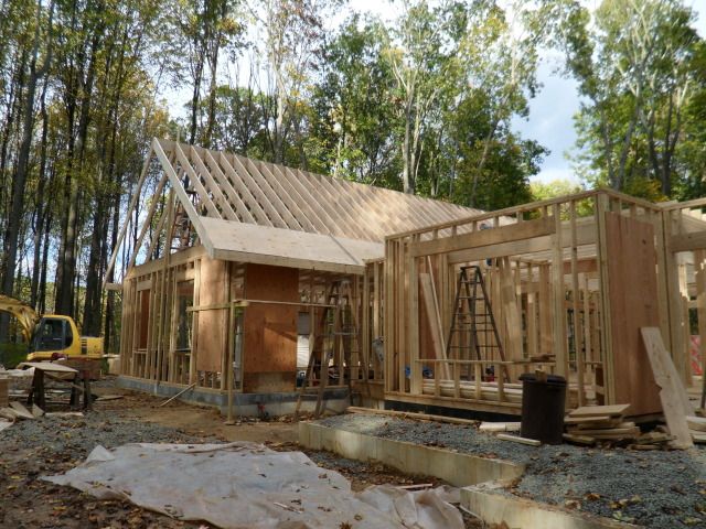

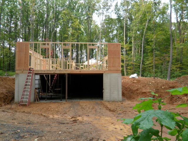

Starting the framing:
Testing out the garage:

Looks like you will a huge basement, what is the plans for this?  ManCave?
I wanted to build a 1-story and with that the basement kinda got real big.  That's fine since they can't tax it as livable space.  The first floor is 2460sqft so that gives me 5000sqft to play with.  I do have a walkout so I'm putting 2 6' french doors so I can get my motorcycles and 4-wheelers in and out.  I'll have a little workshop down there for all the bikes:
As for the rest of the basement, I'm putting in a bar in the angled bumpout with the bar taking the same shape, and a pool table. The table will go between the bar and that footer along the wall for a fireplace on both floors.  I may also put a guest bedroom down there but it will generally be just one big game room and such.  I may not finish it right away, I'll see how things go financially trying to get done the upstairs.  Here's the footers that gives you an idea of the basement outline:

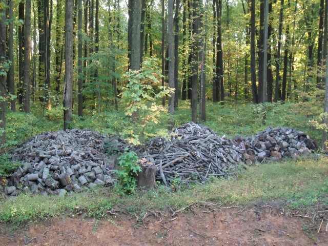

Here's my stump pile I'll either get rid of with gas and a match or just haul them away:

Thought you'd start a logging company before trying to pull that shit off.  :o Looks like a sweet crib. Not sure I've seen a gravel basement floor before. How does that get taken care of?
« Reply #13 on: October 05, 2012, 11:57:04 PM »
By pouring a 4" slab of concrete over it.
« Reply #14 on: October 06, 2012, 02:44:18 AM »
It's called a crawl space. And once the inspector signs off on it you pour concrete over the gravel and not have to get taxed on so many square feet.
It gets 4" of concrete, then carpet or tile or whatever.  Once the house is framed and watertight I'll pour the basement slab, garage and front porch
Even with the concrete you don't get taxed on it, at least in PA.  They don't consider a basement as liveable taxable space.

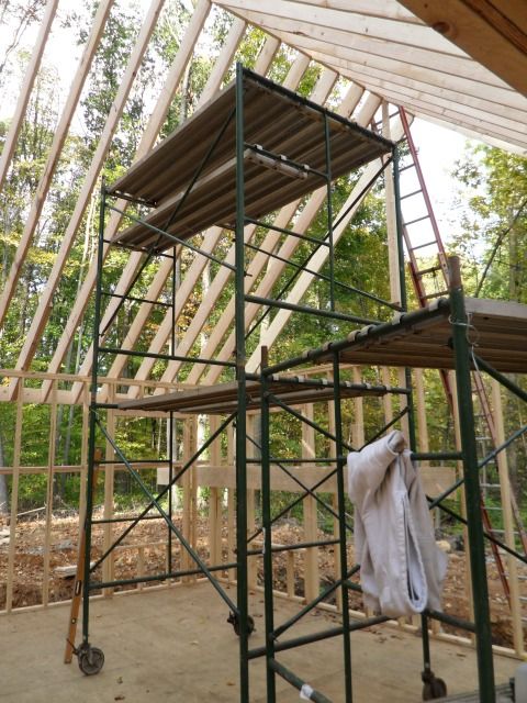

Starting on the Rafters over the garage and master suite:
18" front overhangs with 10" facia board. Was debating to run 8" or 10" facia (all the stuff that gets capped in aluminum trim) but finally decided on the 10 since the overhang was a good amount and I didn't want the trim to look puny:

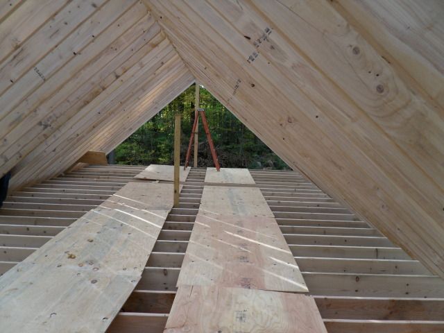

Attic or future bonus room:
Master bedroom.  I'm doing vaulted ceilings up to a flat but I don't know what to set the ceiling height at. Its 18.5' to the ridgepole.  You think I should vault them high and put a window above the plate in the wall?  Or should I just run a flat so the slope is the same distance as the flat in the celings?
« Reply #18 on: October 12, 2012, 10:33:29 PM »
I'm confused on the description of what you're asking. My thoughts would be go vaulted all the way to the peak, or an 8' ceiling with a minimum access panel in the closet to an upper storage platform.
If you vault the ceiling all the way to the peak the drywall pretty much always cracks at the seams so its nice to vault them and still run collar ties so there is a flat.  You can set the flat to whatever height you want

Ceiling height should always be based on how deep your pockets are for heating costs during the winter. Unless your going wood stove.
I helped build my moms new house a couple years ago. Flat ceiling 9'. Gas heat. Costs her damn near a fortune in the winter. Now with higher gas prices its not really going to do anything but get worse.
I would run 8' ceilings and call it a day. Make an attic and just insulate the shit out of it.

« Reply #29 on: October 17, 2012, 10:13:53 PM »
With the 2 roof lines over 8', I don't know if I've seen two angles of ceiling going to a flat at any height other than an attic loft or something. It could work, and 10' is always a good ceiling height, and would still leave some room for an attic storage above, but that 2' of roof line between your walls and your flat ceiling will be an in between wall/ceiling. It can work, but I'm not envisioning the finished deal.
