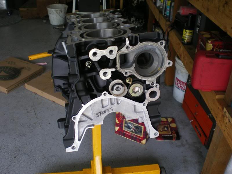

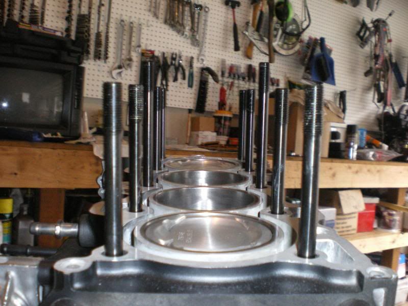

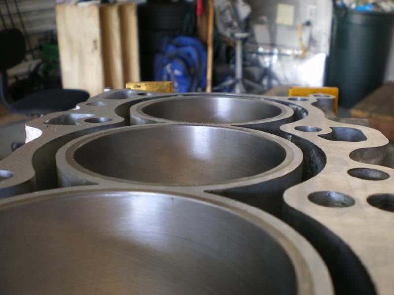

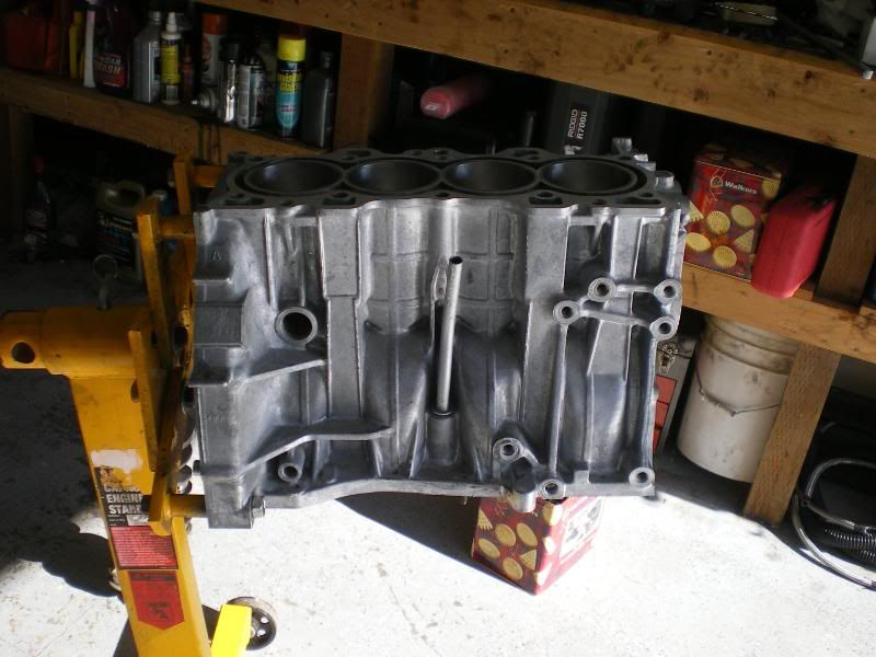

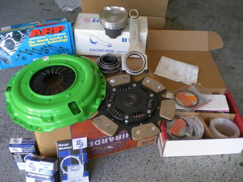

Well I have been putting parts together for a while now and thing are falling inline. Got my block back from the shop a few weeks ago.......
here is the set up.
B18a1 81.5 boreed, honed, and balanced

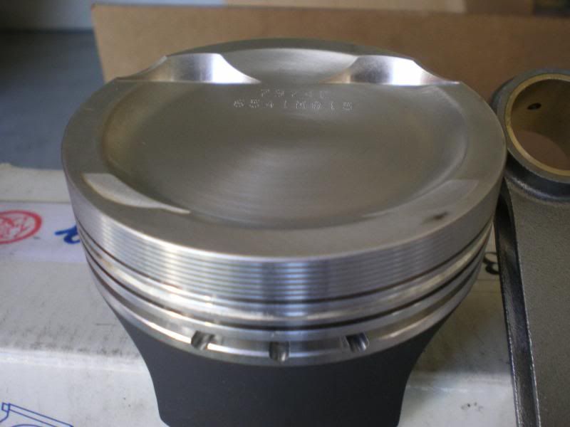

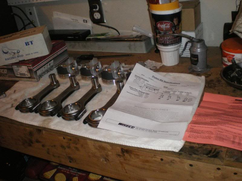

wiseco -12cc dished pistons
TunerToys rods
Skank 2 single valve springs
Ported polarbeartuning OBD1 intake manifold
70-68mm polarbeartuning throttle body spacer
74mm  polarbeartuning throttle body
Delta Cams Regrind 272/260 turbo cams
LSD dragger street disck and clutch
Garrett To4e 40trim
ebay 38mm wg
arp head studs
Eville140 splog
Weir traction bar kit
750cc injectors..... and so on
I got my bearings from majestic. I was gona use the acl's but it was too much extra money/work.

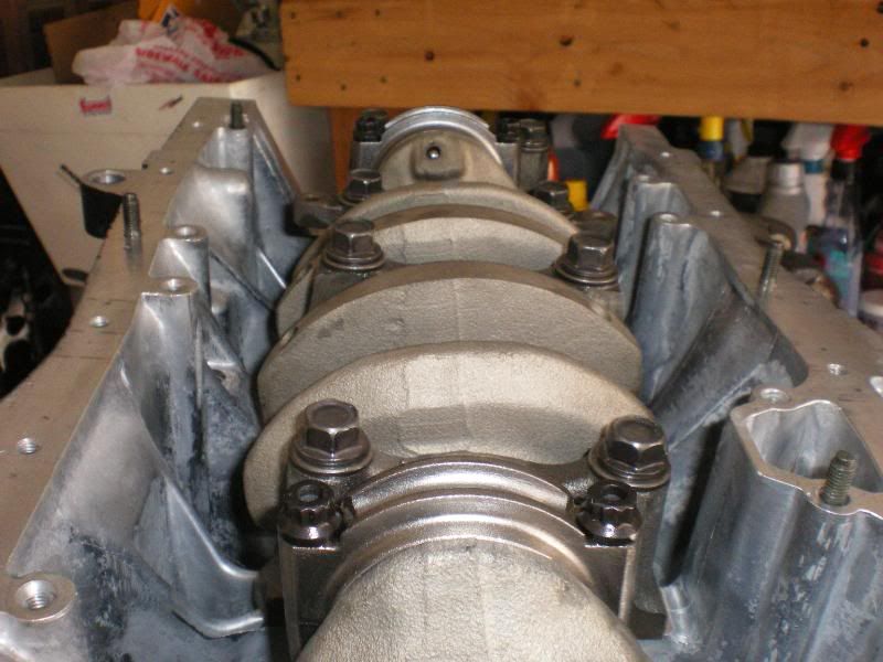

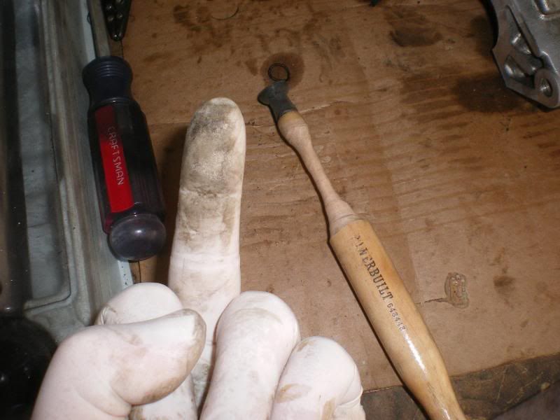

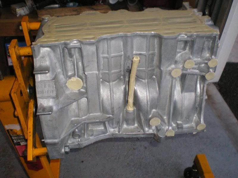

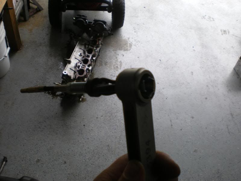

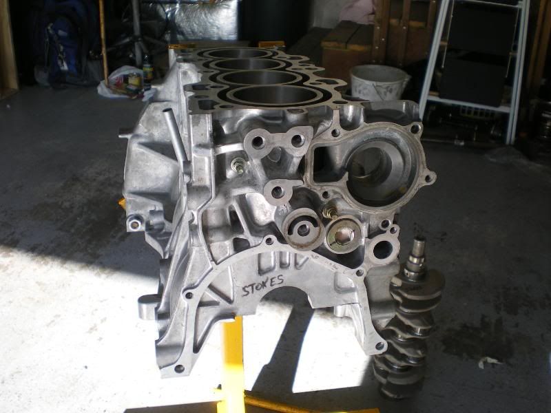

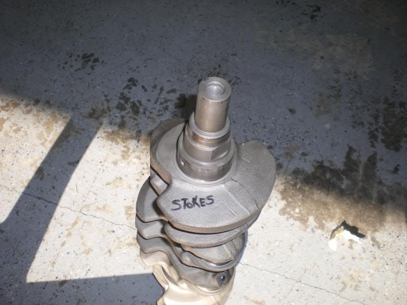

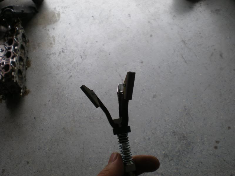

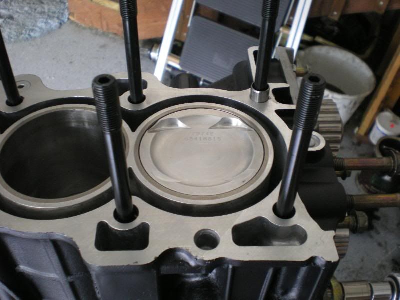

Well got the bearings in and they all fit very well and are in specs. SO now I hade to hone the small end of the TT rods to get my pison pins to fit. Witch is normal.
brake hone
It was a snug fit.
mounted the drill in the vice.
I did it a few differant times to make sure that I didnt get in there and just go overboard with it.

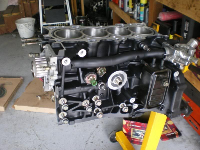

Now that the lower end was done it was assmbled, it was time to do the top end.

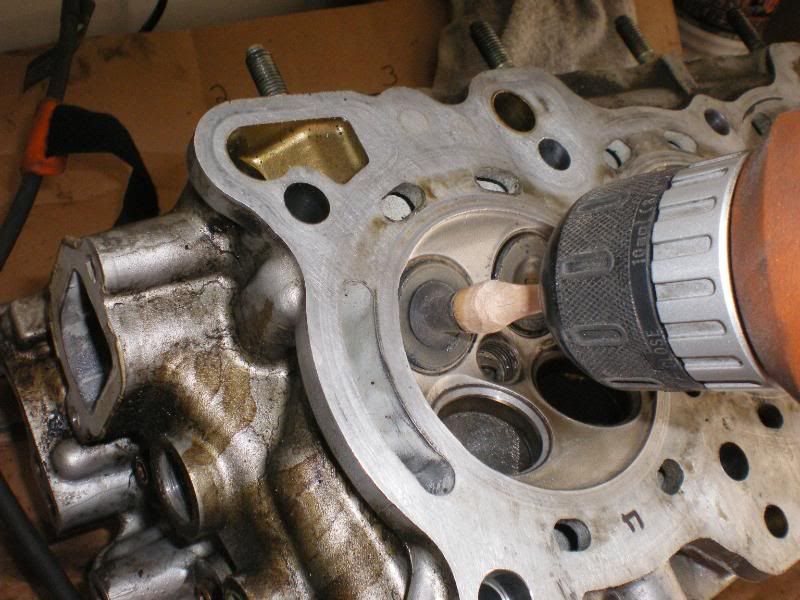

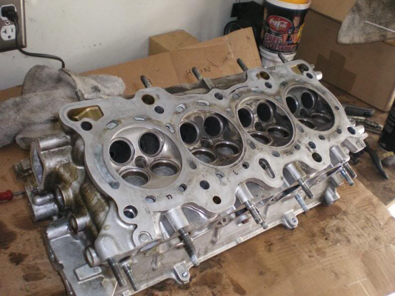

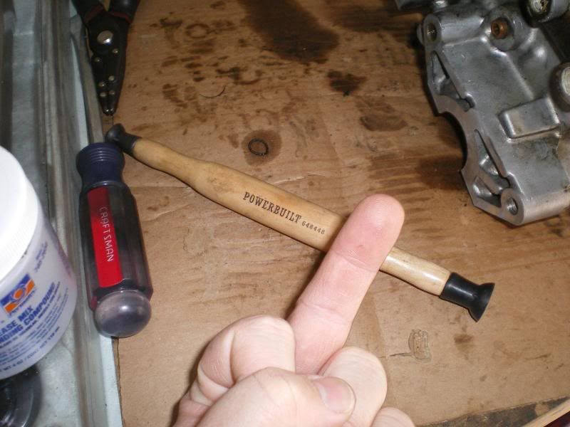

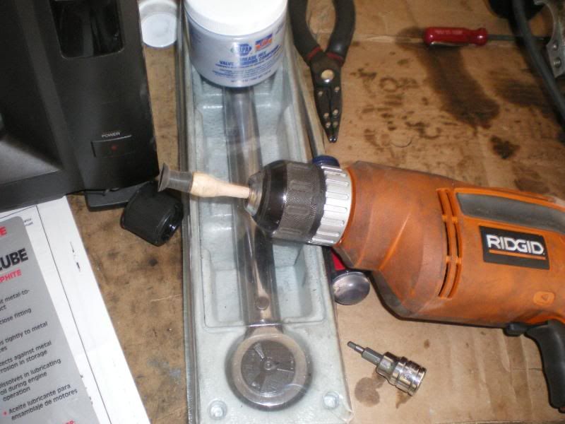

Went to napa and grabbed some laping compound

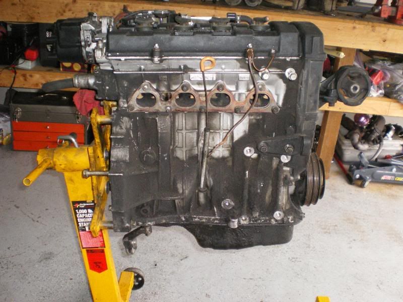

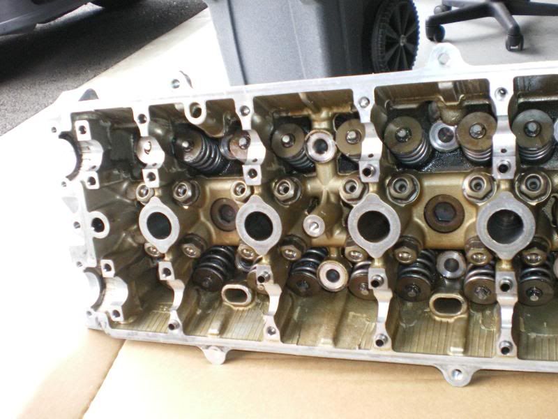

Pulled the head out and stripped it clean of all the internmals

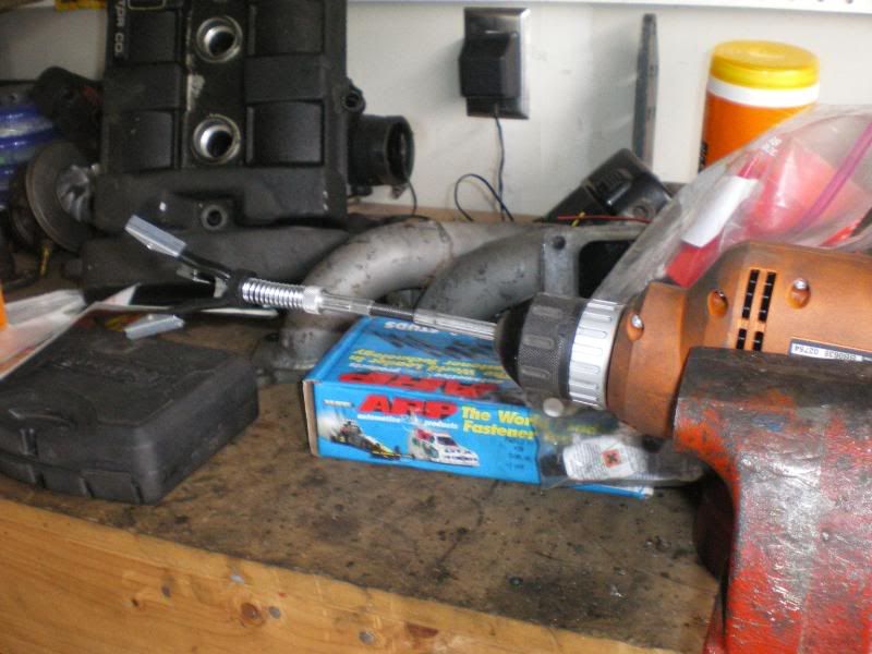

Lapping this shit by hand was a real pain.
So the I took the lapper and put it on the grinder and chucked it into my drill.
Then I lapped the ever loving life out of them!!!!!!!!!
turned out pretty good SO I put the spring seats back in and put the new valve stem seals in.

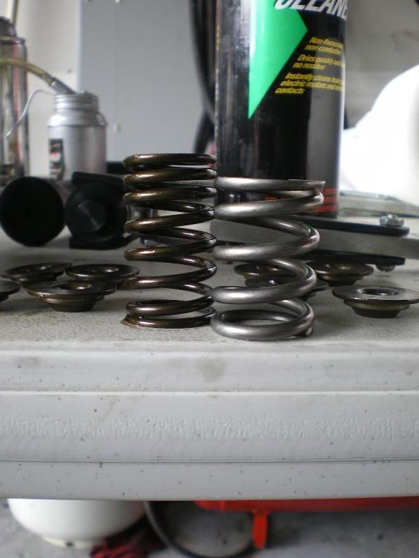

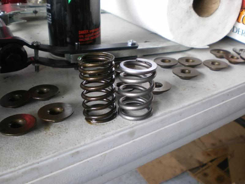

Pulled out my skank 2 valve springs Thanks 88DX
Side by side the skank 2's are so much beafer than the stock its not even funny.

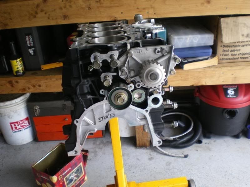

the head went back together, everything was nice and tight.

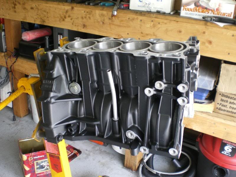

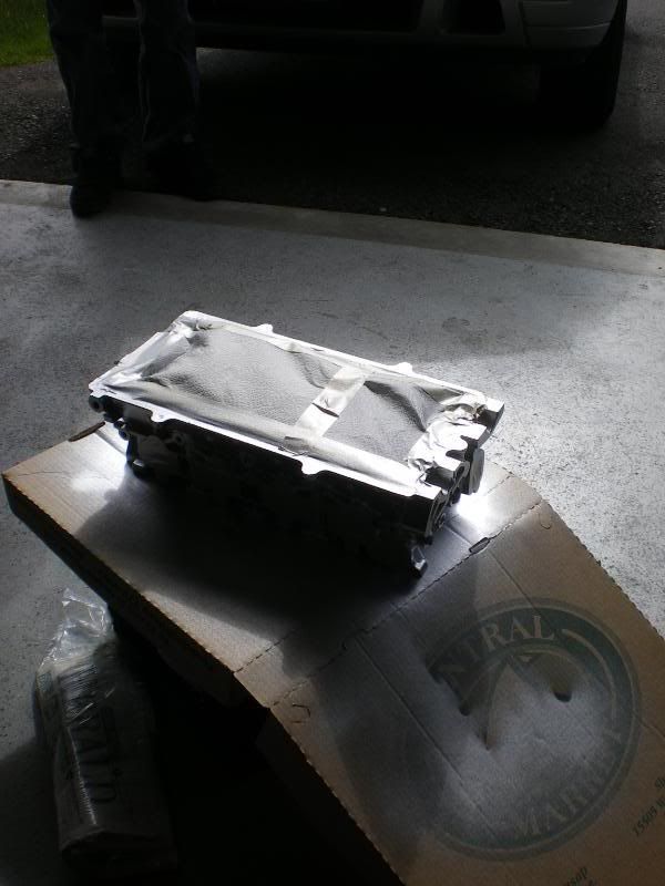

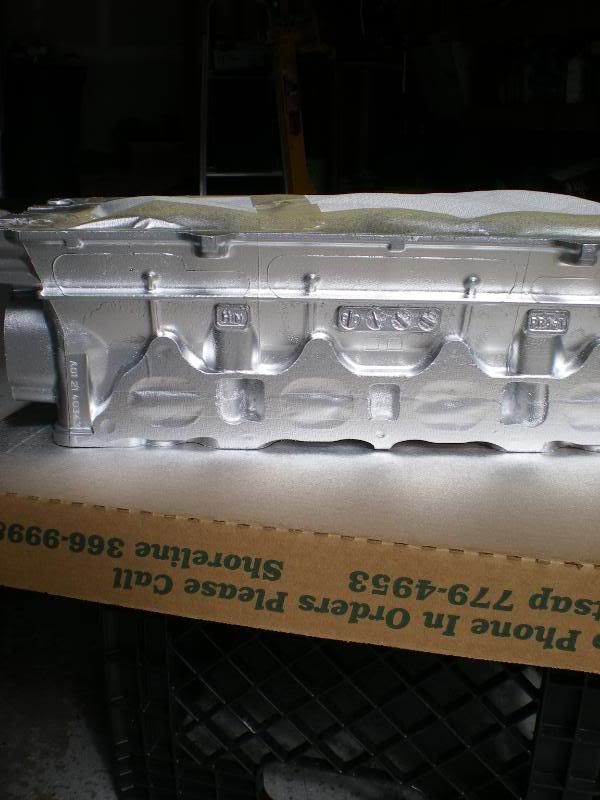

so it was time for some paint.
Looks way to much like mexican chrome
So I striped it back down to repaint low gloss black like the block.

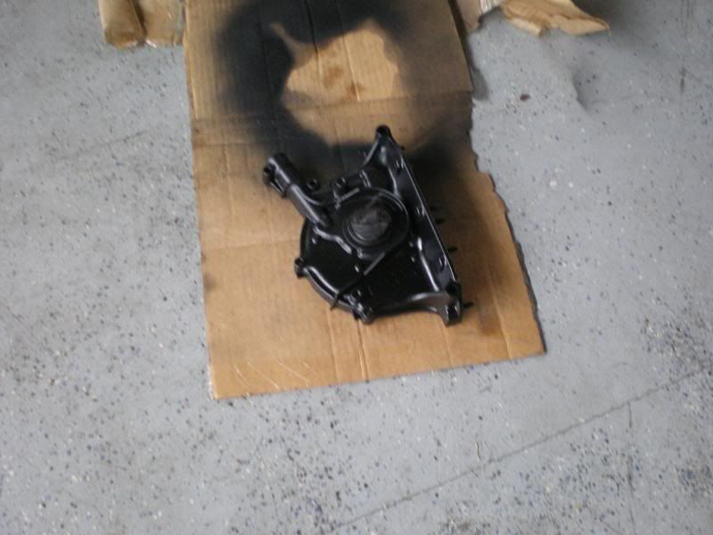

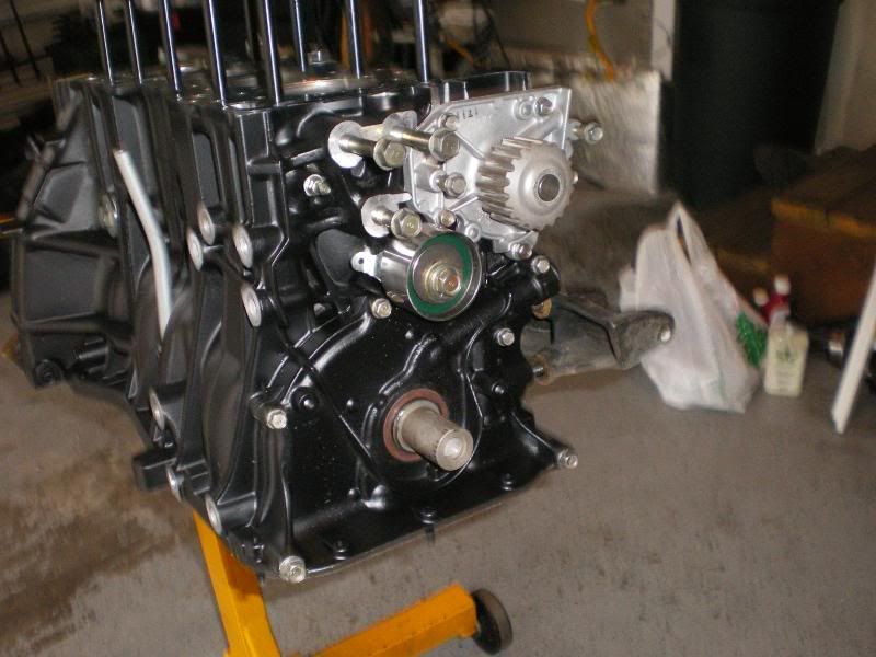

While I was wating for it to dry I checked out the oil pump and it was withing spec. so I painted it
and put it on
I put the head studs in and now I need to go to the store and pick up some more low gloss black paint.

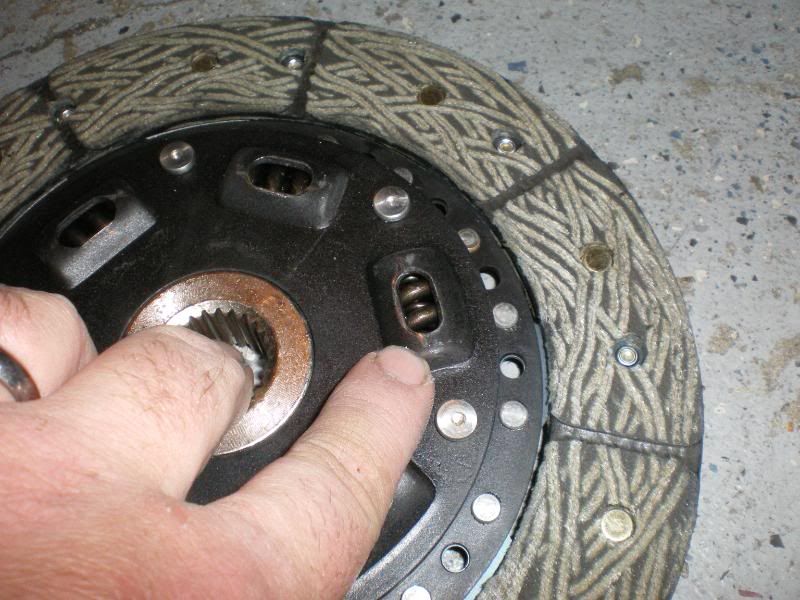

It runs!!!!!!!!!! but it wont move :'( :'( :'(

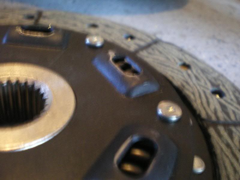

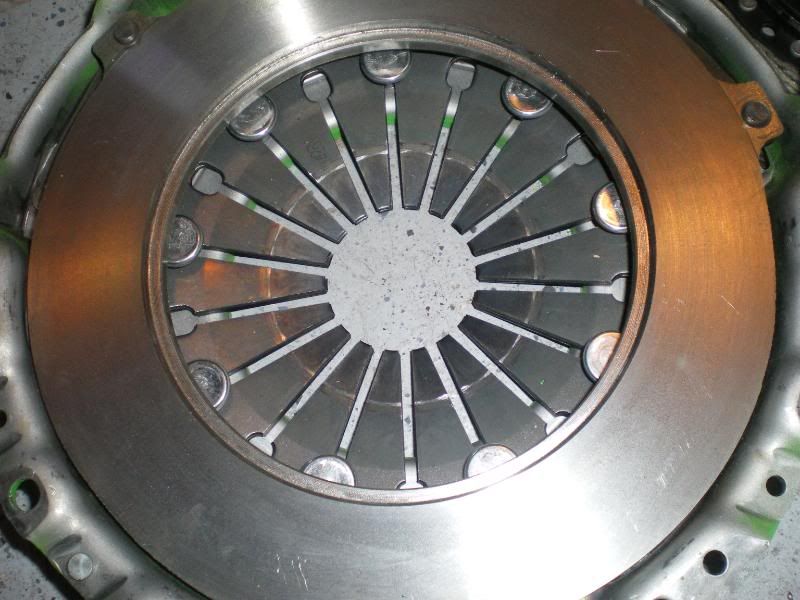

something is screwed up with the clutch that I got from LSD???? The sprung center section from the p.plate hits the clutch disk and it wonte let my cluth disingage/engage??? I have already sent them a pm, and a email. Here are the pics......
Turns out that mike at lsd had someone other than the normal clutch builder build a few of his clutches and the pp center would hit the disk springs when you pushed in the clutch.  So he shipped me one that was good. Keep an eye out for some more updates.  :yes:

So mike at lsd took care of the clutch and I now have about 1200miled on it. I did a comp check the other day and its 175 across the board. I took it to the track last summer and it rar a 15.1@ 91mph. Not bad for some 2.3 60' and 8.0:1 compres.

what paint did you use on the block? looks great. I'm going to do that on the two motors i'm building right now.

It was some paint I picked up at the auto parts store. It was LOW gloss black. Not flat. I will update this tread later today when I get home. I have a few new pics. Im almost done turboing it

No, Im using the street disk. I orderd the dragger clutch w/street disk from him, he sent the 6 puck disk for a 92-00 b trans, I sent it back, got the dragger disk for a 90-91, it fit but the clutch fingers hit where the springs on the disk are , and then he sent me a anther street disk that fit.  :o

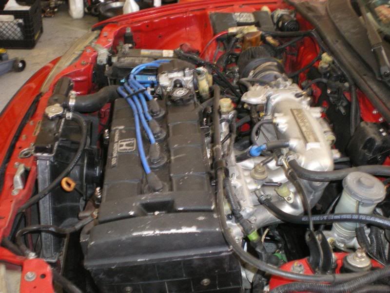

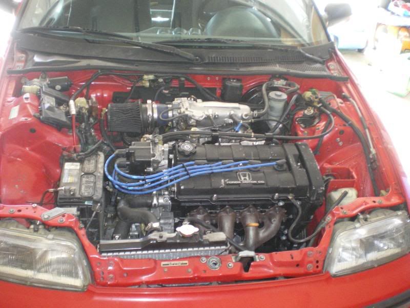

SO the car now has 1200 or so miles on it. It runs tip top. About 36ish mpg on the hwy, and 25 in town. 4 months ago I switched it over to obd1 chiped the po6, and all that jazz. I then pulled it back in to the garage about a month ago, swaped to some hasport mounts I traded for some parts, and to do a wire tuck.  :-X I wil never ever do such a thing again. It was the bigest pain in the ass, and a big waste of time. It looks really nice though....lol Still have some cleaning of the bay to do.
So im working on this thing at about the rate of 2 hours a day. It is taking forever to do all this. But I picked up a splog from randy (evilli140) thing looks great.

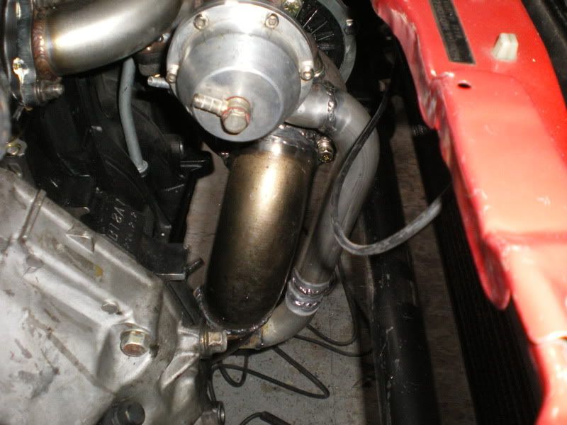

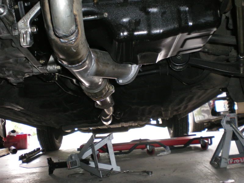

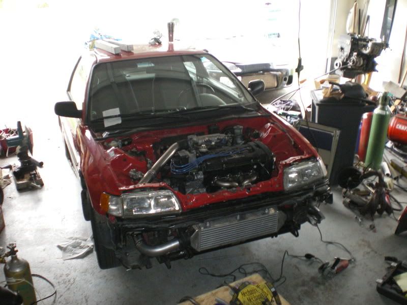

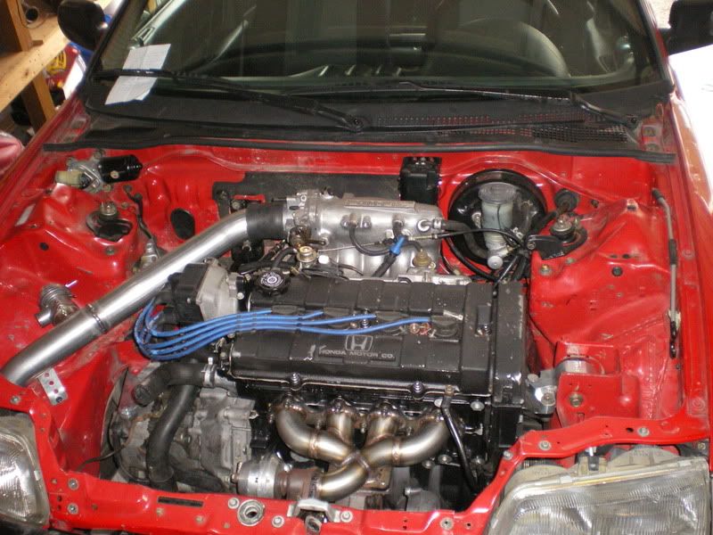

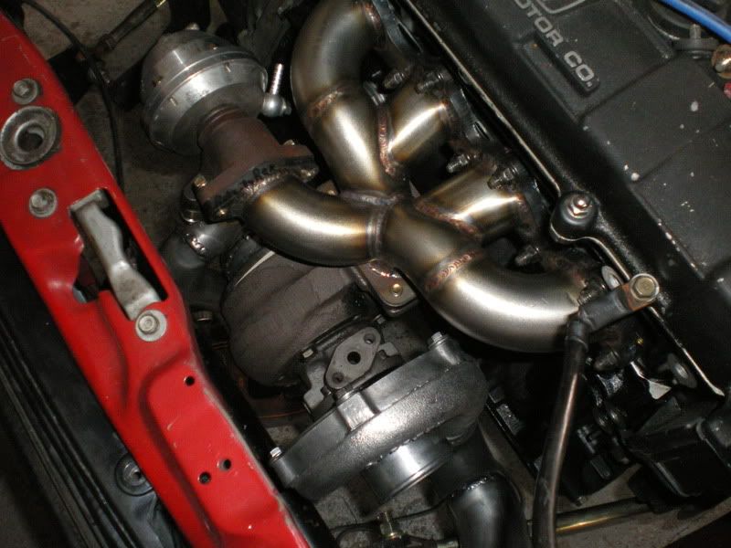

SO I finished my down pipe last week
I also put a cutout in that im later gona have a 75mm mustang tb with a choke cable set up so I can open it on the fly

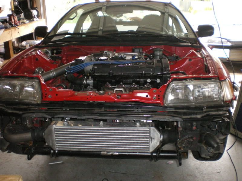

After that I torched my front bumper and mounted my way to small for my powere goal intercooler
On friday 3-5-09 I knocked out the charge pipes, and they now just have to be painted
Oh and by the way my garage is a total wreck....lol
So now im on the hunt for a new radiator. I dont realy want to run my halfcore due to the fact that im gona have to gangster lean the hell out of it to make it fit with my traction bar being so girthy. But I think i can get a 85-92 vw golf radiator to fit. Its 1.5"X13"X24" and it has 1.25" in and out just like the b18 and they are on the same side. Well see If I can pick one up cheep localy.

wow you must have some steady hand to lap those valves using a drill like that lmao
