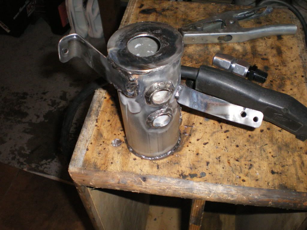

Well guys, Ive got a new problem. I pull up to the bank today and I notice a little oil puddle under my car, and its coming from the snatch can. So i come home and I pull the filter to see how much oil is in there, and HOLLY FUCK. Ive got a good 3/4 of a qt in there. In case you guys didnt see it back on page 8 here is the catch can.

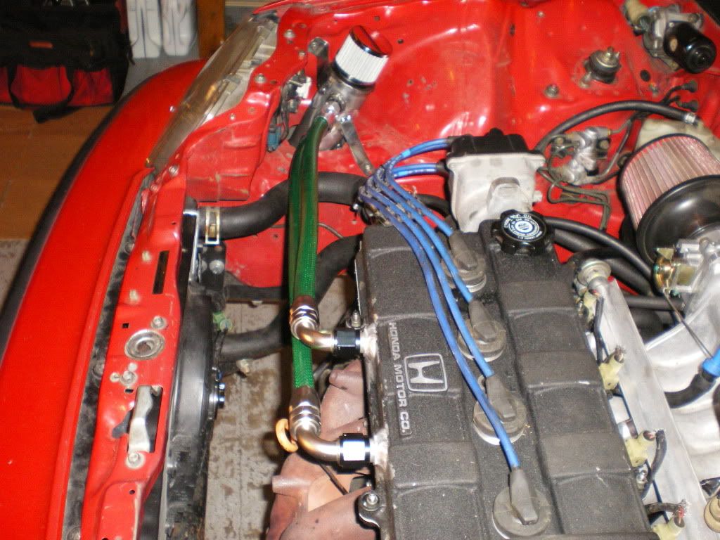

ANd here is the lines to it from my vc.
So I have no clue why there would be that much oil in there. Im still running my pcv valve. So why the fuck would there be so much oil in there? Do I need to make a baffle in my vc so it dosent just fling the oil in there? Assuming thats what its doing.
With your setup I would put the can higher than the fitting on the cover. Maybe liquid oil is going into the can instead of vapor.
holky fuck that thing looks like shit. I lOVE it.  Recirc the drain (bottom of the can)to the pan  since you cant baffle it now that its built darkness.
 :yes:
catch can needs to be higher than the ports on the VC.
or it needs a drain back
are the ports in the VC baffled?
No they not :-\
Well, you have to have baffling else you just hooked to oil hoses to the valve cover. And as mentioned, the can needs to be higher than the valve cover for it any oil that does get in the lines to drain back.
What are "baffled ports"?
just run a drain off of it into the oil pan.  done and done.
