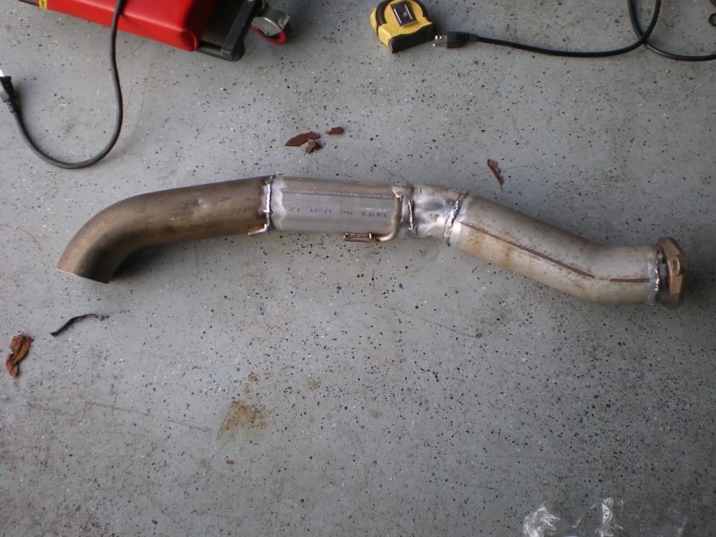

I dont know how loud it will be with just the resonator, but I have a feeling that sometime this summer I will be picking up a magnaflow and having new exhaust welded up from the axel flange back because I dont realy like how it turned out. Might end up stuffing another resonator instead of the magnaflow behind the axel.

Im not a huge fan of the way it turned out ether. From the axle back that is. Must be because I was just using left over parts and pieces to make it. I think the side exit through the rear bumper is where its gona be done. I hate how the crx's have the muffler that runs all the way across the back and then exits on the other side of the car. And Im not gona do some stupid ass staight pipe from the rear axle over to the other side of the car at a 45* angle. It looks like brown rice every time I see that done!! CHING CHONG MEOW!!

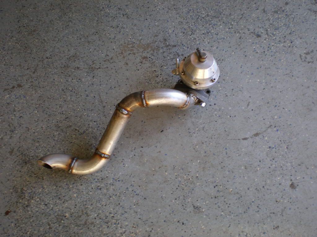

Well today was a good day. Got most of the last few things done. Got my exhaust from ryan on sat. Looks bitchen by the way. Then today I re-did the wg dump tube because the one I had was hitting the downpipe, and it had been cut and reused about 4 times so the pipe had all kinds of cuts and welds.....lol
So here is the new one, Im gona just call this one the snake..............
But it fits good.

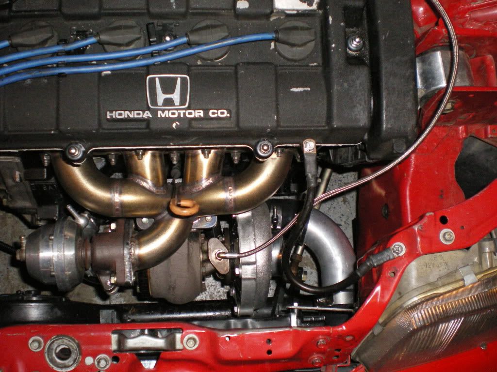

I cut about 3/16" off of each downpipe bolt so it wouldent bottom out in the turbo. I fitted up my feed line to see how I was gona run my feed.
So tomorrow im gona bolt up my turbo and my exhaust and run my hot side chargepipe, disconect the line to my pcv valve coming from my black box and cap it, then run a t from my intake run a vac line to my bov and my wg. Then I need to burn a new chip and set my boost cut at 1.5lbs untill I get my catch can and my baffles set up for my valve cove.

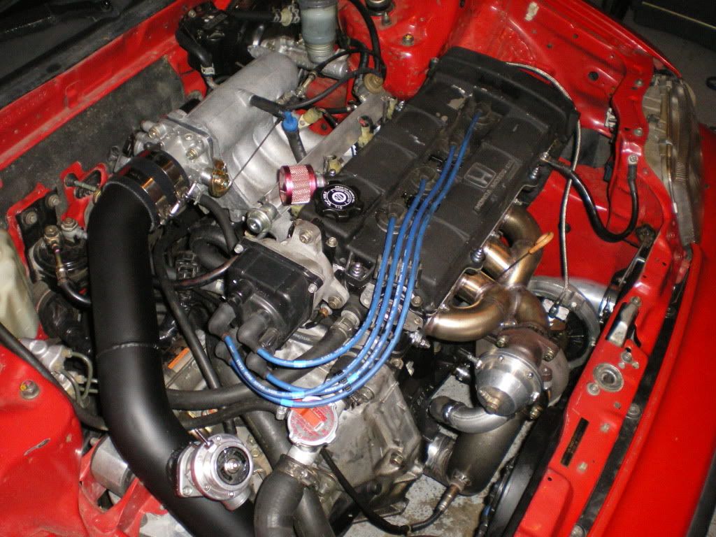

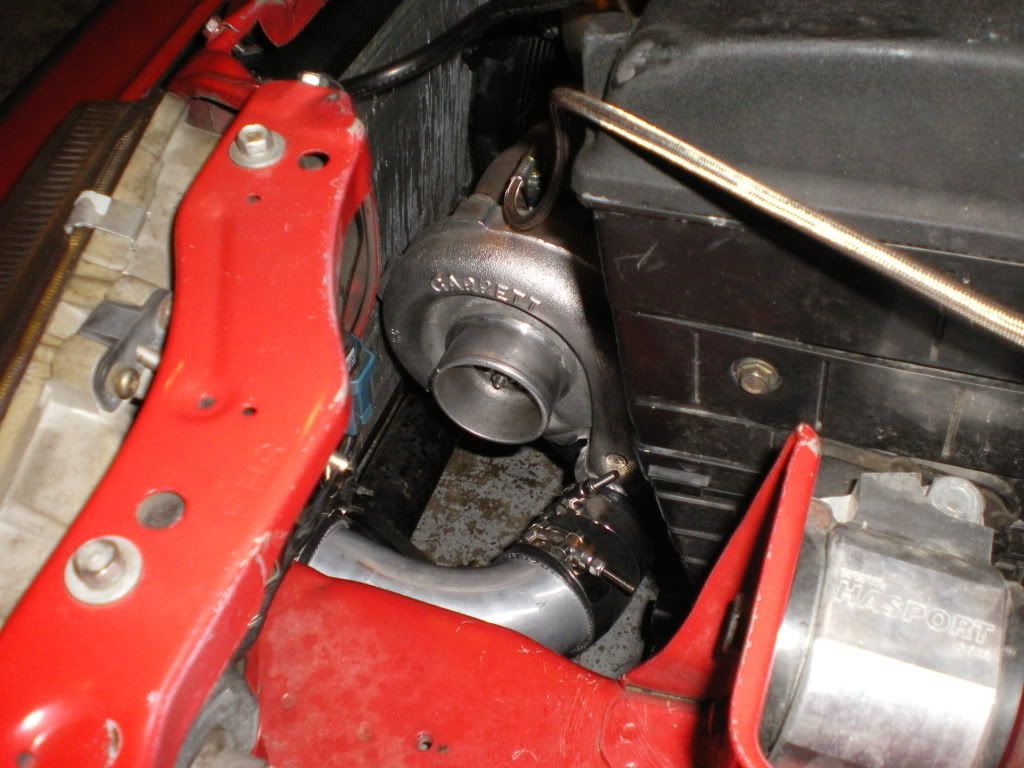

It runs!!!!! Well kind of. Boost control is with my right foot due to the wg not having a line ran to it, and the bov dosent work eather, because it to dosent have a line ran to it. And air filters??? Who needs them, Not me because mine dosent fit....lol So the plan for tomorrow is to get some RIGHT sized t's and run vac lines to my wg, and bov. The Im gona get some window screen to put over my inlet for the time being, Untill I can get the right silcone bend to make my air filter work. And boy the exhaust is real thumpy with the deltas and 3" with no muffler!  :D
