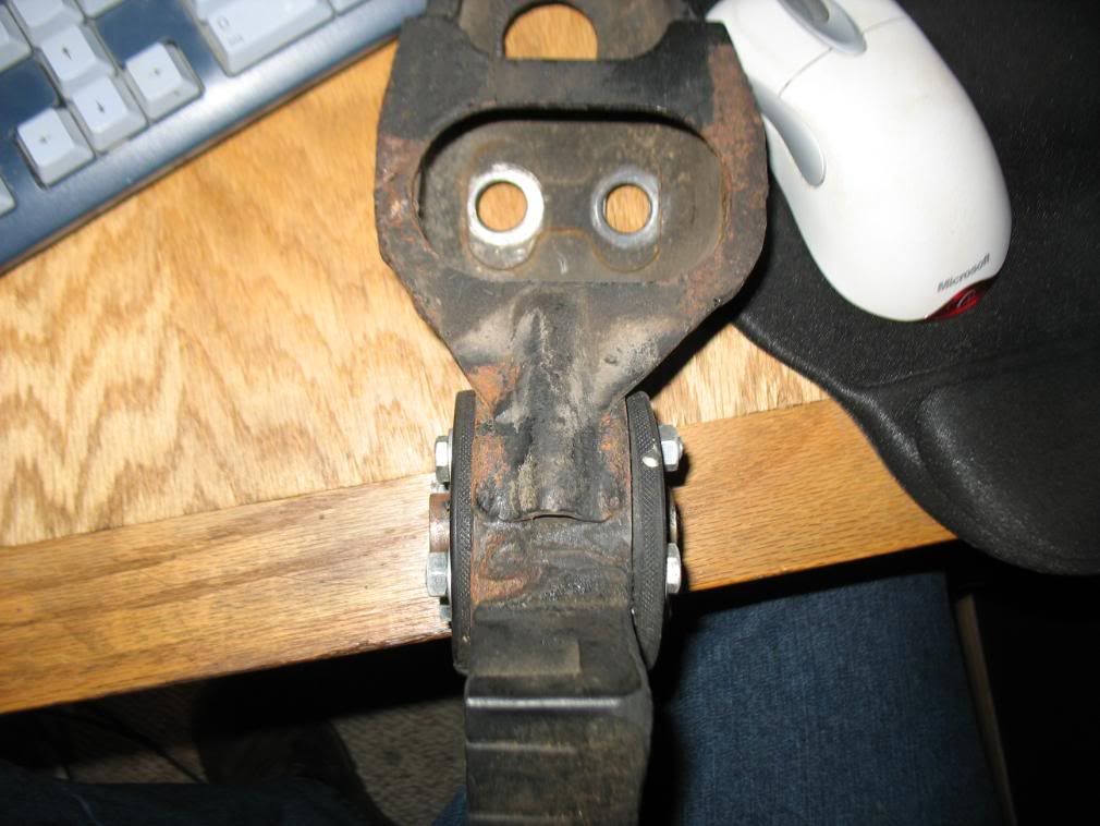

Rawr's thread inspired me to tackle my own engine and tranny mounts , this is the rear tranny mount from an EG..
and yes, those are Hockey Pucks.  $1.23 Ea.
Don't need a press either.
Saws all
2 Hockey Pucks
Torch
Drill
Rivets
WD-40

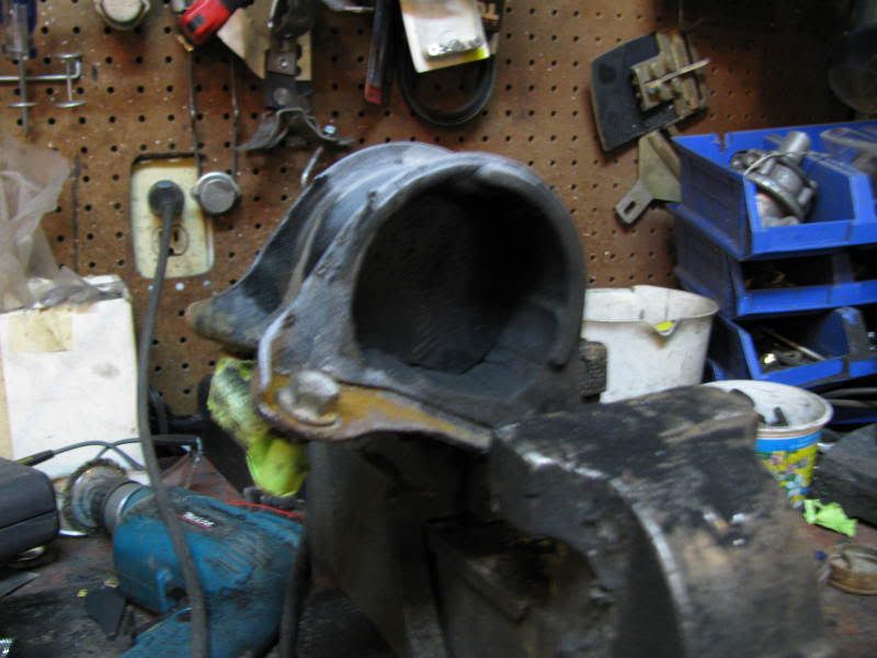

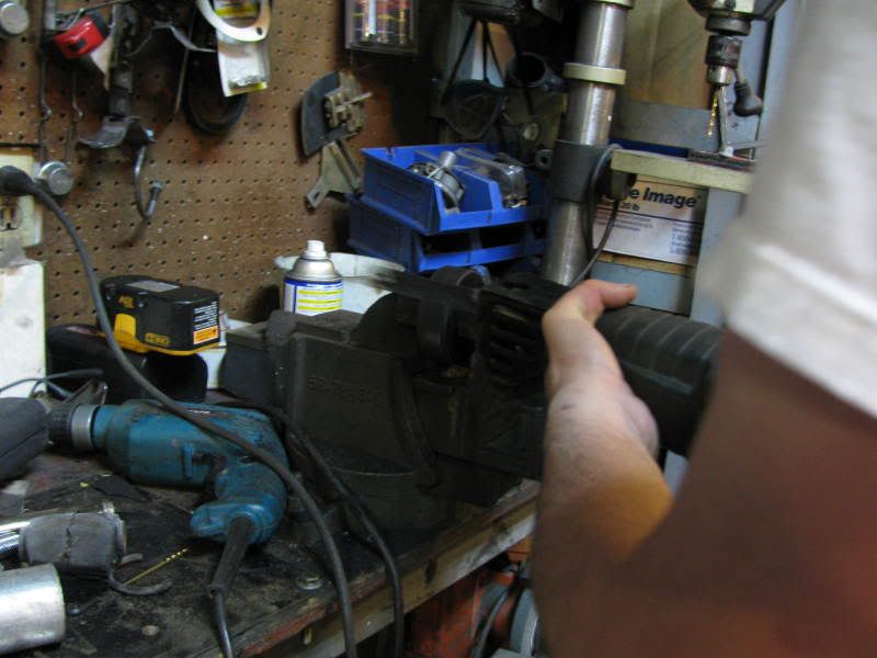

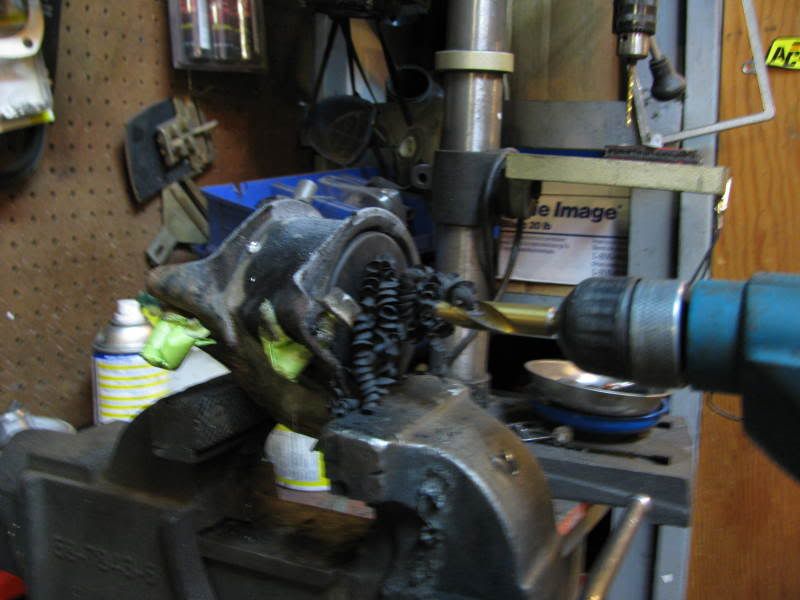

Cut out the center

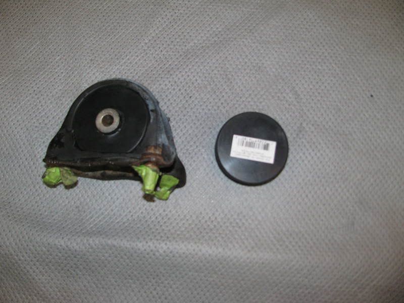

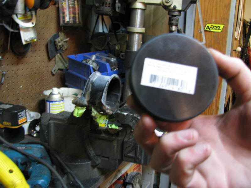

Cheap ass hockey puck (vulcanized hardass rubber)
Cut a bit off the bottom of the hockey puck

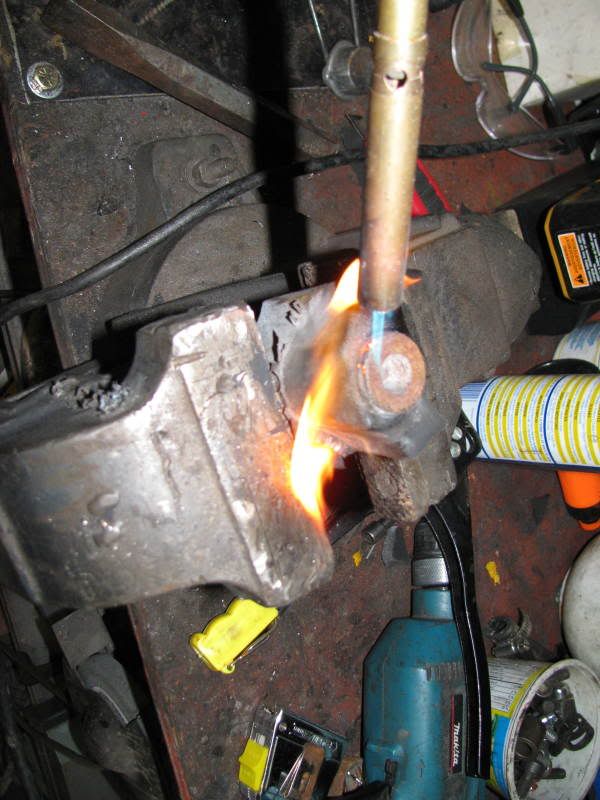

Take the old chunk with the steel insert.. heat the fuck out of the insert and push it put
Drill a big ass hole for the steel insert
Done

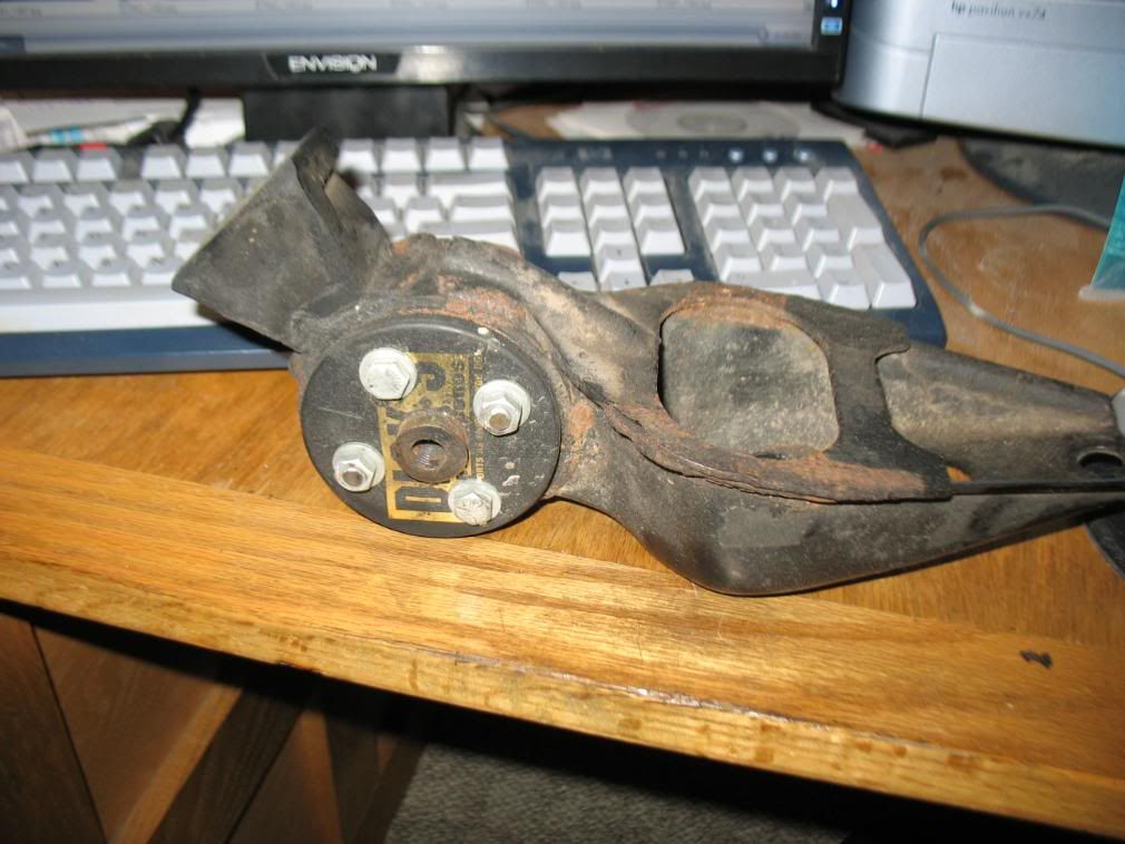

1 Hockey puck per side , I just pressed it in with the vice and some WD40, they were in there tight as hell , but for added security I drilled a few small holes in the top on each side and put rivets in them...
and thats my cheap ass GRM motor mount...

Piiiiimp
I need a torch
I found it was quicker to use a flat blade screw driver and a hammer to chissil it out, then use the torch to burn whats left. I still managed to set the workshop smoke detector off lol.
