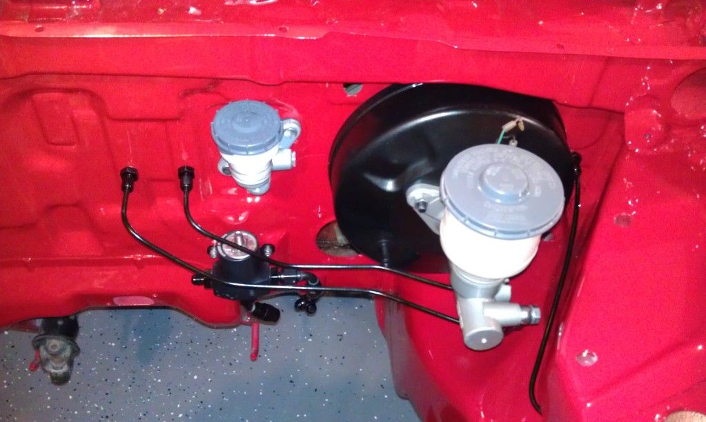

I have been racking my brain trying to decide how to actuate the hydro clutch on the H22 tranny in my crx. I really don't want a clutch cable, but I don't really see any room for a master cylinder at the top of the pedal under the dash. My hatch has a metal dash so I had all the room in the world for a master there. I'm considering this wilwood pedal and maybe cut a small hole in the firewall for the master to poke through. Thoughts?

Will see if i can find it read some one used a eg pedal assembly and mounted the master under hood like normal
Re: Anyone think this will fit in a crx?
« Reply #4 on: November 20, 2012, 07:52:26 AM »
That can't be. The shock tower is too close. I have measured that every way possible, it won't work. I'm forming a plan, but won't know till the weekend when I really have time to get into it. That wilwood pedal won't work either. Not enough room on the floor.

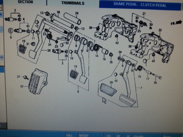

« Reply #6 on: November 28, 2012, 08:43:41 PM »
how does that work?
« Reply #7 on: November 28, 2012, 08:48:37 PM »
exactly. its oem. 90-91 Prelude. the brake pedal appears to be hallow and clutch pedal rod/pivot goes threw it....

yeah, hack in a prelude pedal assy, and a s2k cmc.
If ya need spacers for S2K clutch master cylinders.  :noel:
« Reply #12 on: November 28, 2012, 11:06:41 PM »
That's interesting. I think I'll keep that as a plan B to what's on my mind right now.
« Reply #13 on: November 28, 2012, 11:19:42 PM »
it might be worth a look. i know there are always a couple at the junkyard. if that side of the pedal cluster can fit without too much trouble, might be a solid idea...
« Reply #14 on: November 28, 2012, 11:33:15 PM »
Yea, I'm liking the idea. I think it's a bit more effort than my current plan. I think getting rid of the brake booster will open up enough room to get the clutch master between the brake master and the shock tower
« Reply #15 on: December 01, 2012, 10:40:18 PM »
should be plan a
