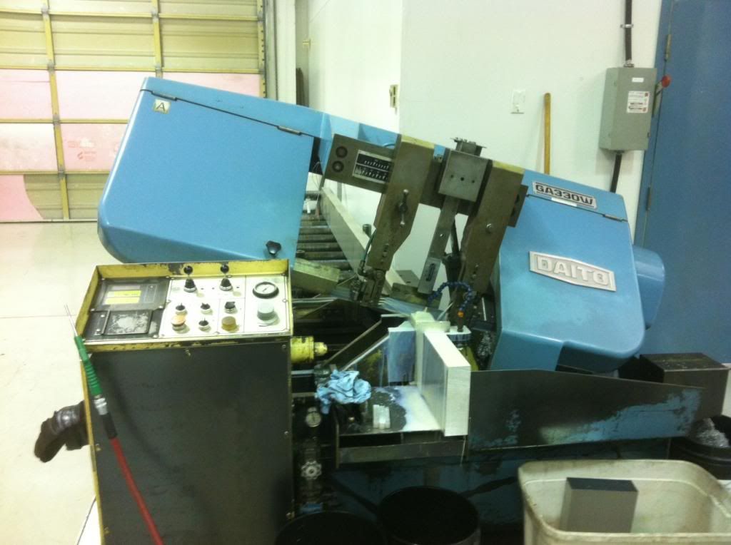

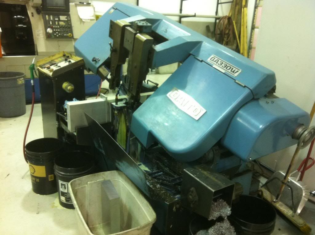

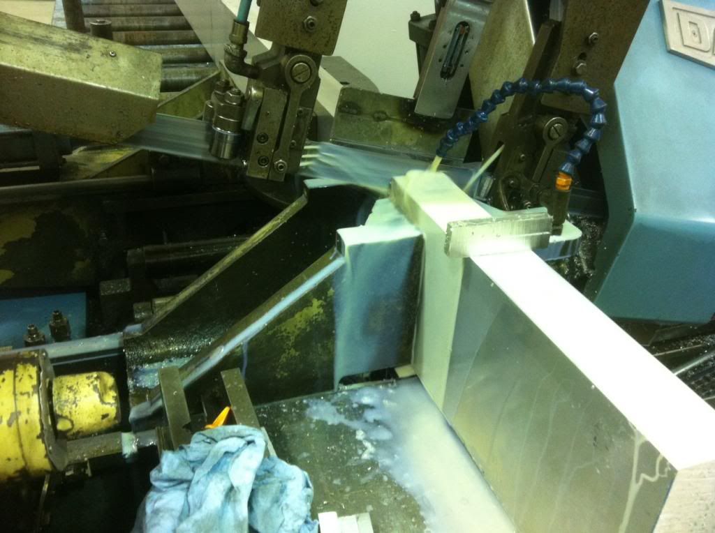

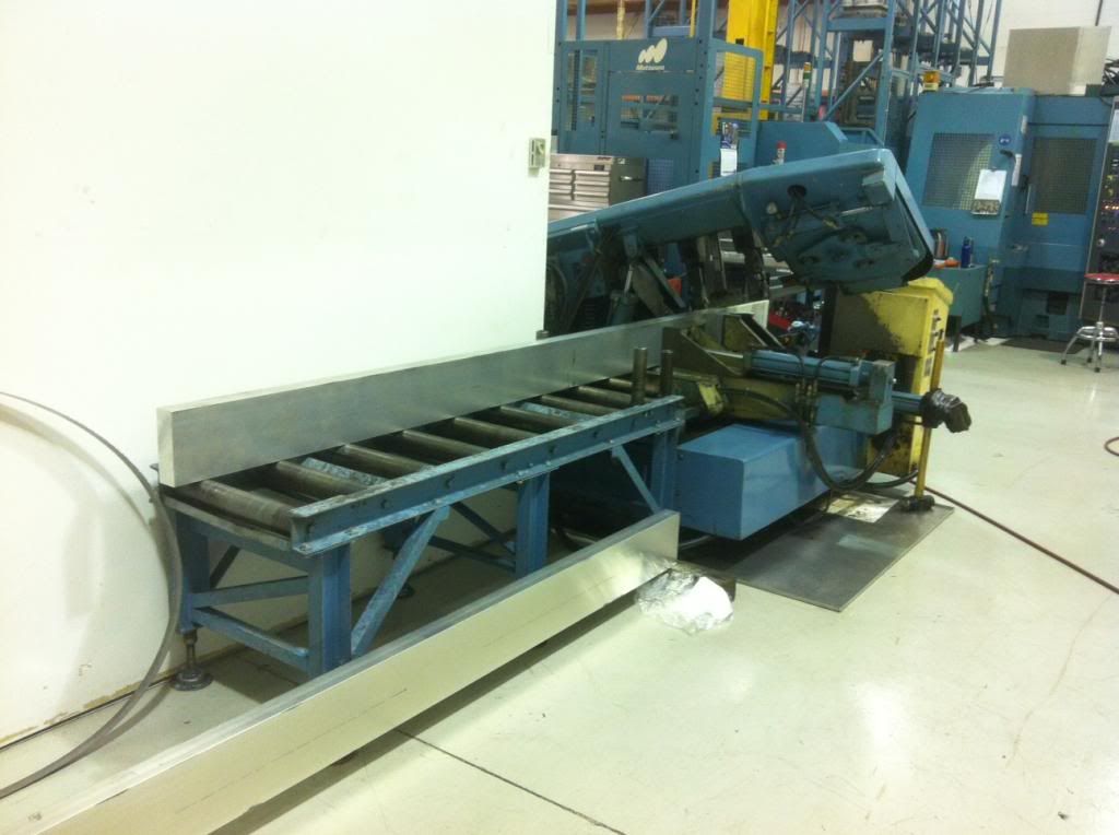

Start with the stock, 2.5"x8" 6061 in 12' sticks. No problemo for my trusty Daito bandsaw. This thing is a mofo, 4400lbs, 1.5" blade, 100l coolant capacity. Good little CNC saw.

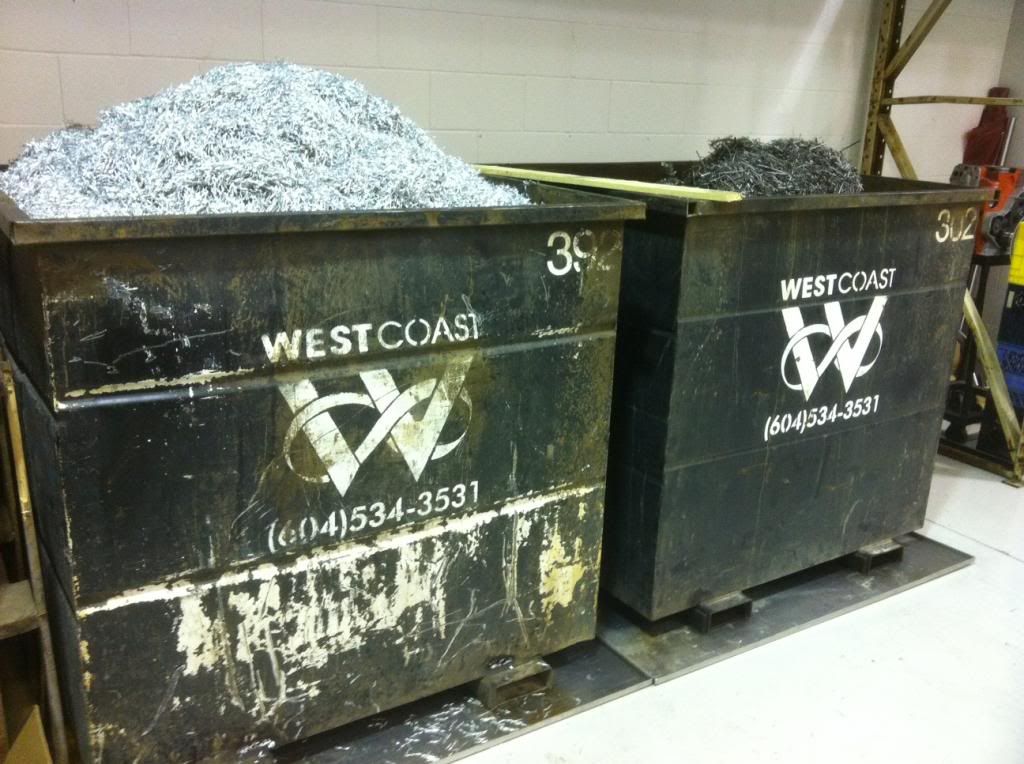

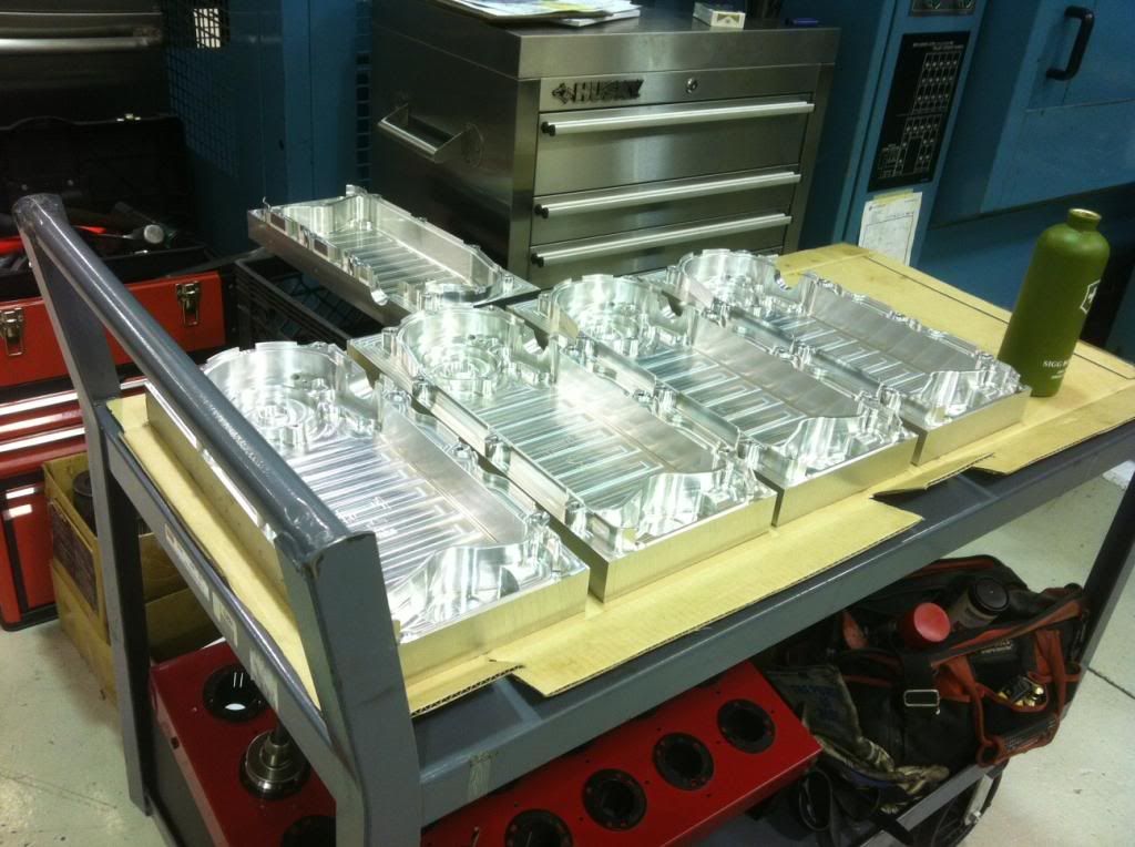

Make lots of chips:

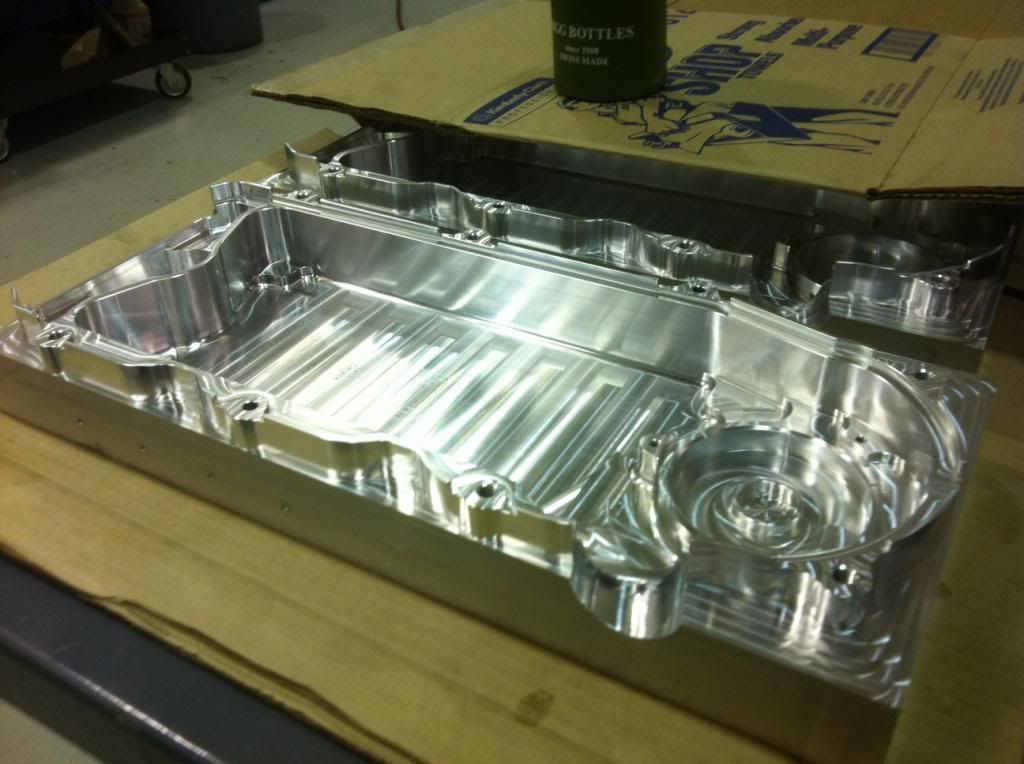

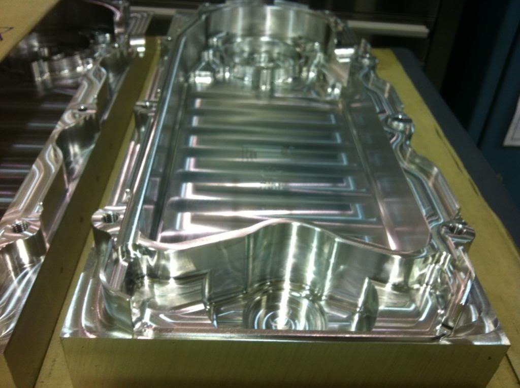

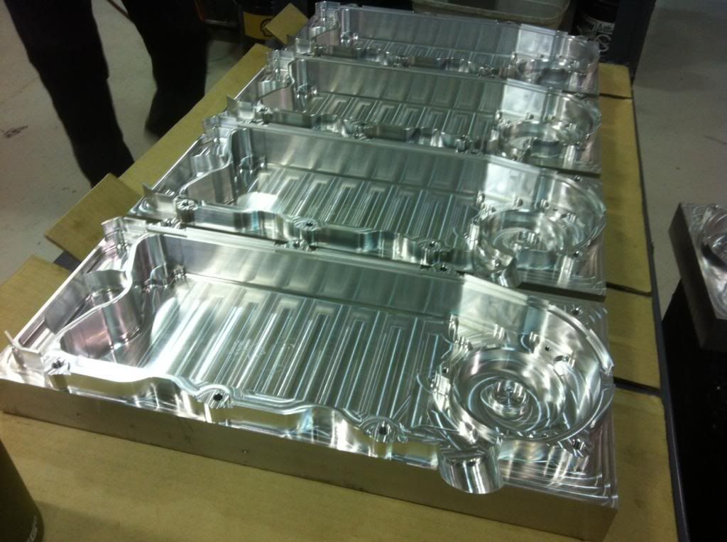

And some finished first ops:
Just threw on another 4pcs, going home, lettin the machine work the night shift by itself O0 :noel:

SECKS!!!! I like the bandsaw, i really miss having access to something like that

I just noticed you said "cnc saw" does that mean it feeds the material in automatically?
Re: Todays machining project
« Reply #7 on: January 23, 2013, 06:33:45 PM »
Yeah its a proper cnc saw, you program your cut length and how many pcs, or you can program different lengths and qts from the same bar.

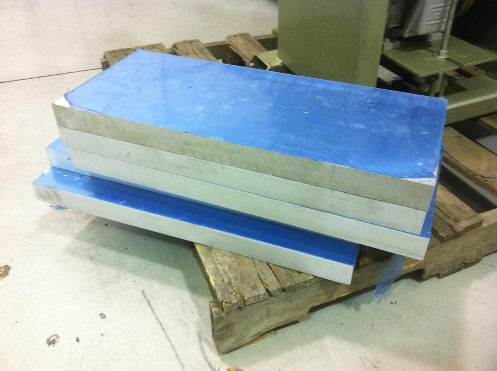

The mic6 plate showed up today for the second op fixtures:

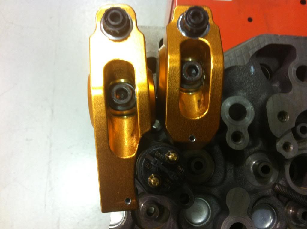

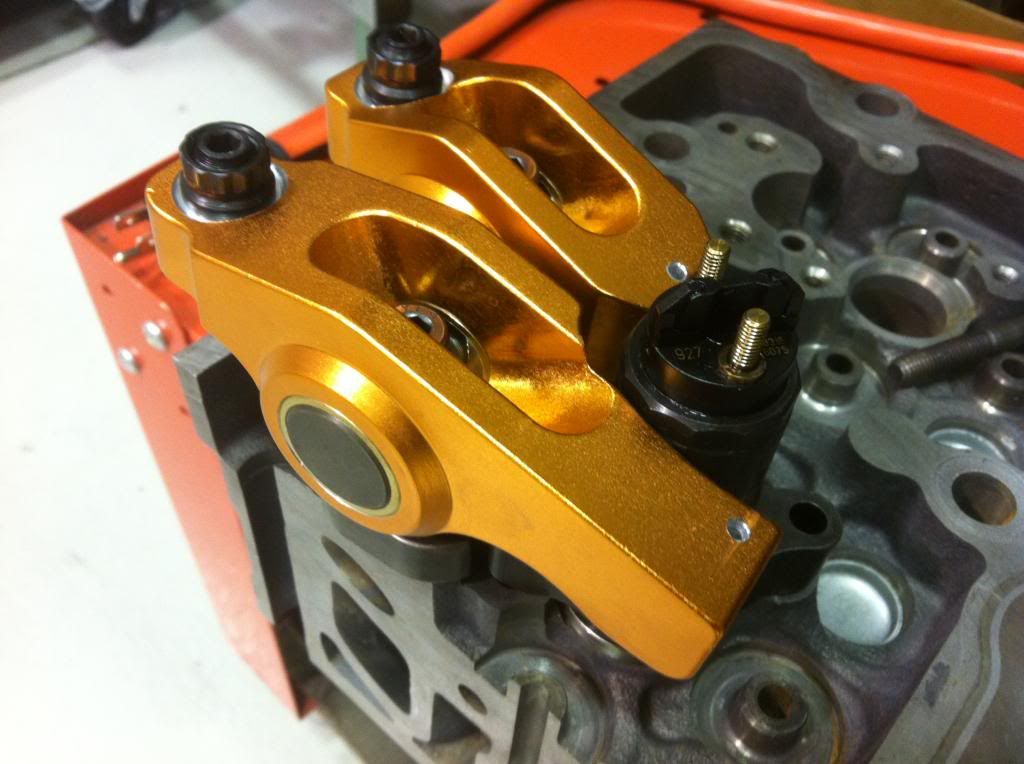

And don't worry Brett the rockers clear, they just don't fit the pedestals well.
Maybe it is just the picture but, wow does that look close. Are we going to need to do some work to the pedestals? Or new ones all together?

I might have to machine new pedestals. Not sure yet, if I can keep the rockers in the same location now I'll just clearance the bushing (harland just did a shitty job on this, they are supposed to fit), if I have to move rocker location to suite the new valve location then I will machine new pedestals. Either way, nothing to worry about, I'll make it fit, and it will be good.

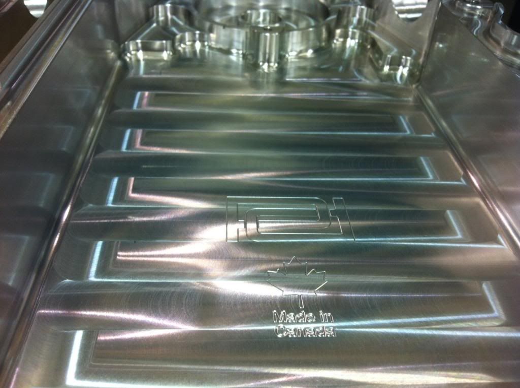

i knew there wasnt a market for it, just curious what it would cost if there was.
i cant get enough of machine marks in nice looking parts. i started going to school for machining, but got laid off from a machine shop while i was going to school. kinda killed the motivation to keep going. i miss it though.

what dose the top of the valve cover look like? And that made in canada takes $475 off the price  :P

So I was going to start machining the second op fixtures today but I was looking at the drawings last night and found a bunch of problems (new part time guy working on the drawings). So maybe tomorrow I can get to it. Bummer thing now is that I need to add some through holes through the extra stock on all these first ops, so all the parts gotta go back in the machine :(
As for costs, the pallets are 5k a piece, and there is one for each op, so x2. The tombstones are around 2k each (again x2). Parts and materials for the fixturing that goes on the tombstones about $1500. Tool holders and tooling for the job about $3-4k. Probably 40-50hrs for programming (parts and fixturing) so maybe $2k there before payroll costs. Had to get some features picked up with a cmm for the parts, I think that cost me $700, deign time maybe 15hrs? $500-600? Then the costs for a machinist to actually machine the tombstones and fixtures, probably 3 days there, call it $1k by the time the its all knocked down to the tenth and and everything is square and machined to center of rotation.
So about $23k. Yes lots of things could be done cheaper bla bla bla. This runs lights out now, and requires no operator to run these parts in the future. It will take 20 minutes for an operator to load first and second ops for the night and they can pull off 4 complete parts in the morning. No fucking around, no adjusting tool offsets, loading and modifying programs, shoveling chips, loading tools, etc etc. Load the raw stock and hit go.
The second op fixtures should turn out pretty cool, and then you will be able to see what the top surfaces look like. Both of these tombstones are designed so that I can run a few different types of valve covers so that will help the costs of the tombstones and pallets.
