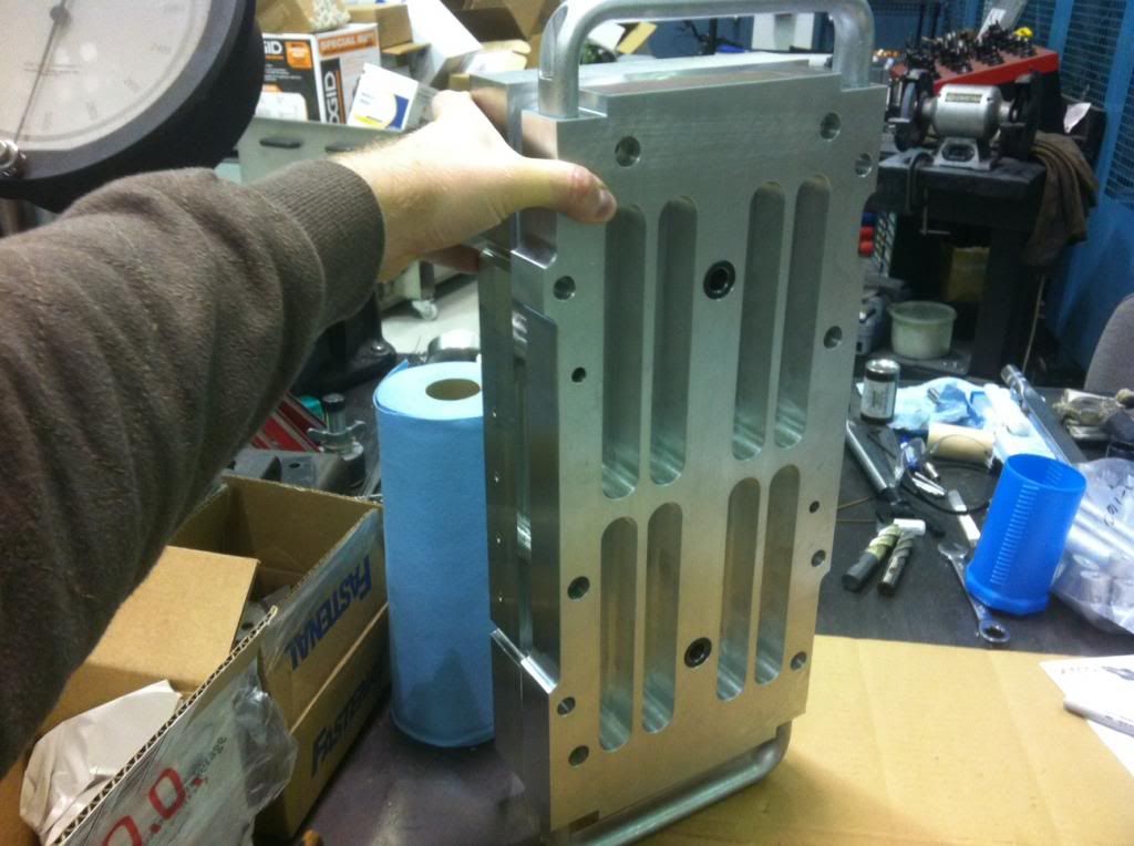

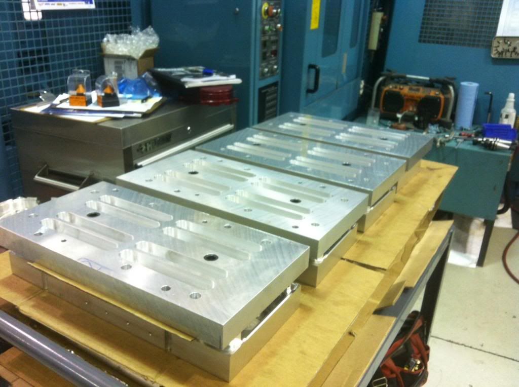

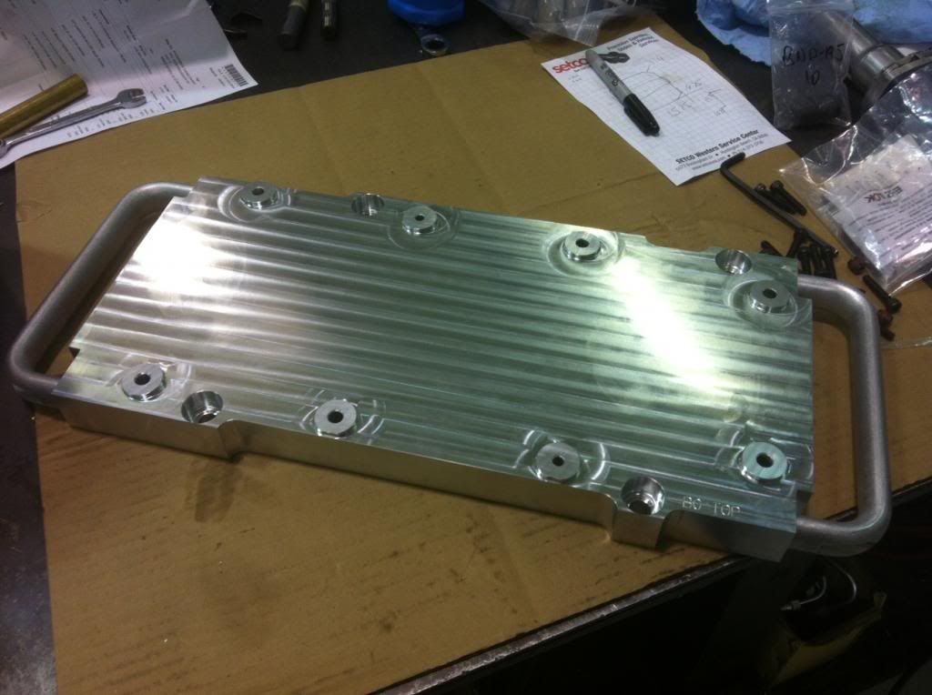

Ok so here are some updates on the fixtures.
Op1's all done:
Op2 was just putting 4 counterbores in so that I could hold the sub plates on the tombstone. Op3 was all the pocketing on the face and the side work for the handles:
Thanks to Adam contributing to the shop fund I could afford some nice German made aluminum handles O0
Put the dowels in the sub plate to locate the covers:
And now the subplate with an op1 part sitting on it:
« Last Edit: January 28, 2013, 07:52:47 PM by Passenger »

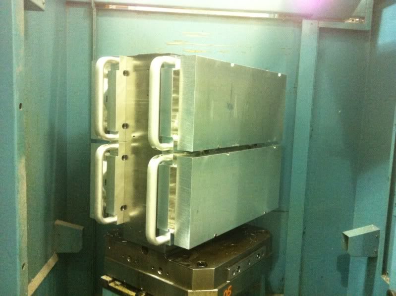

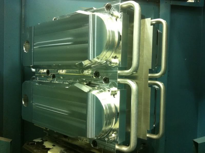

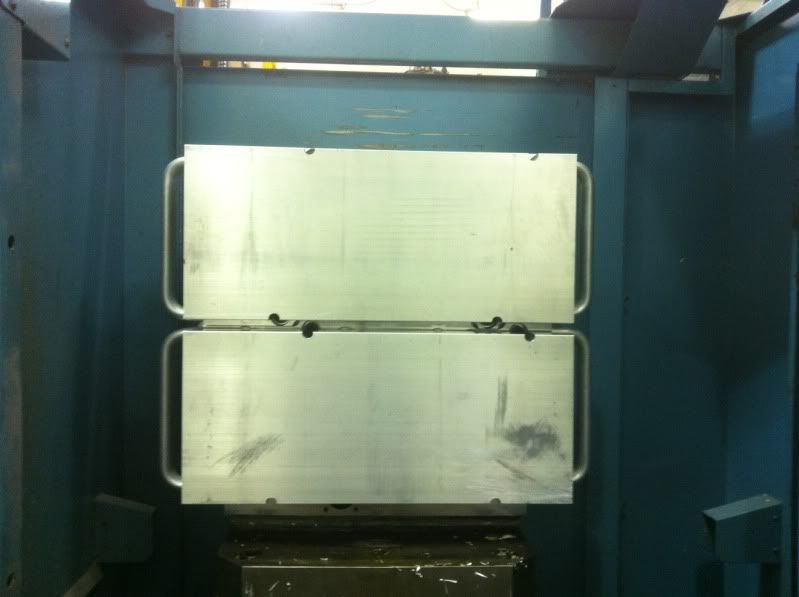

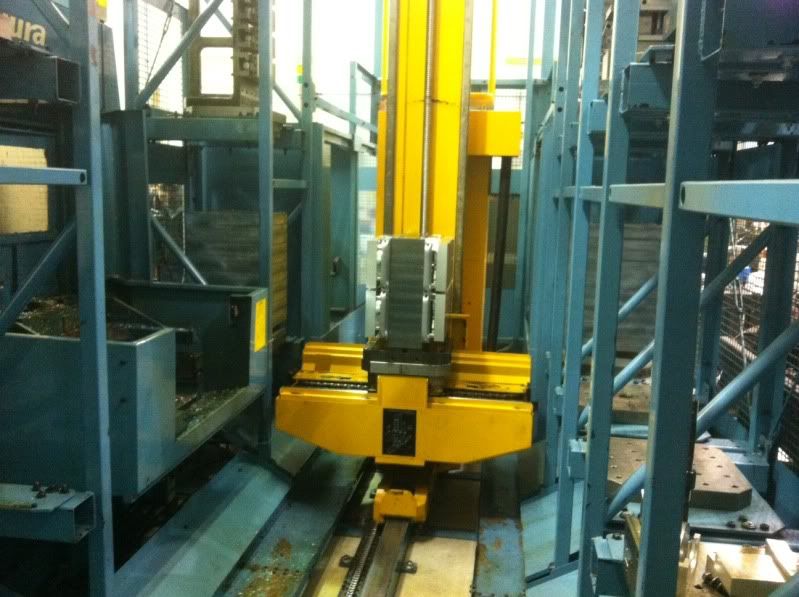

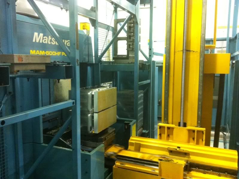

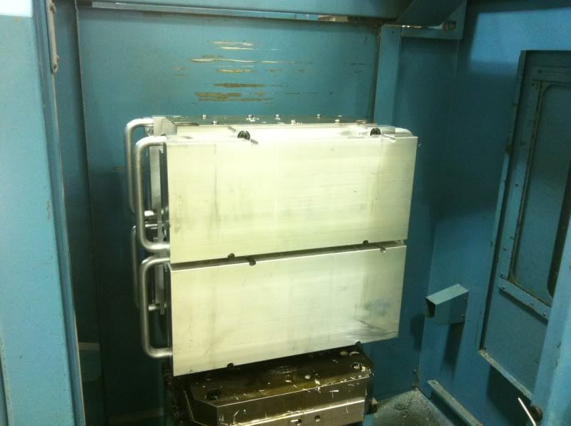

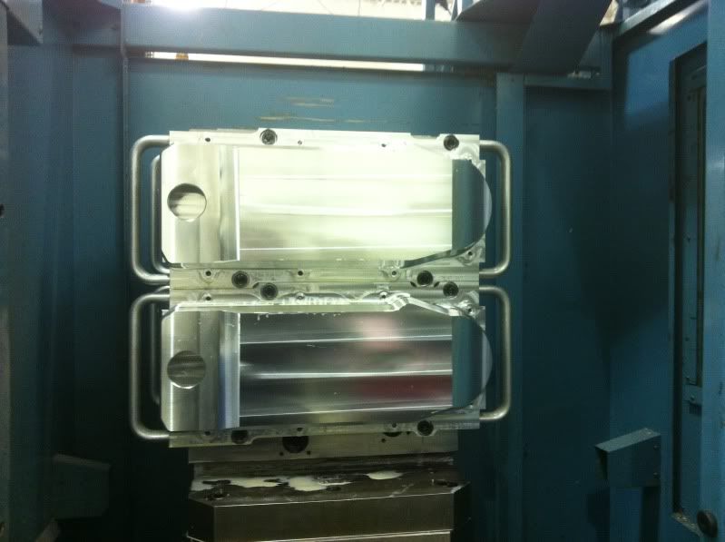

« Reply #36 on: January 30, 2013, 02:56:57 PM »
Gonna knock this out today one way or another ::)
Op1 parts mounted to op2 fixtures and tombstone:
Robot ride from the load station to the machine receiver:
And inside ready to start blasting chips:
Hopefully some complete pics in the next few hours!

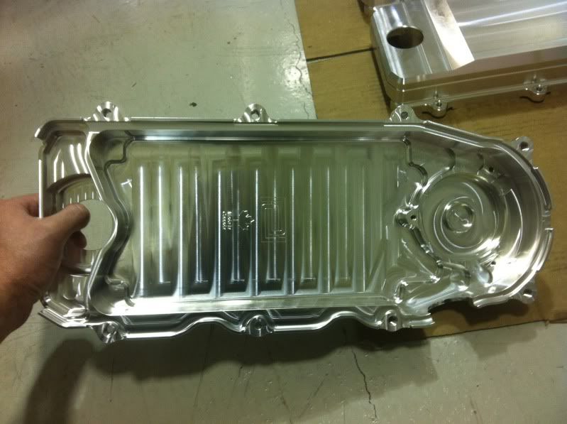

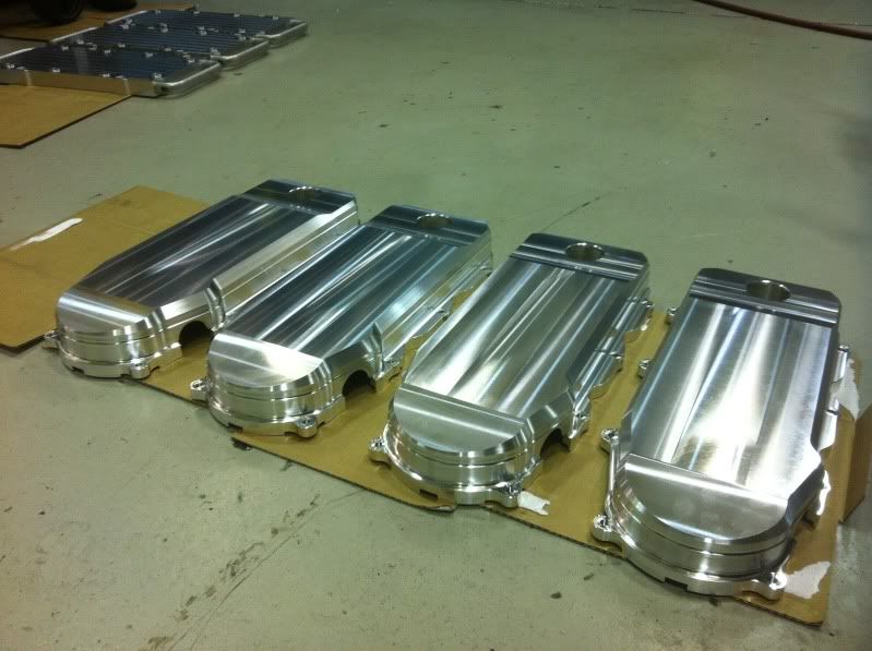

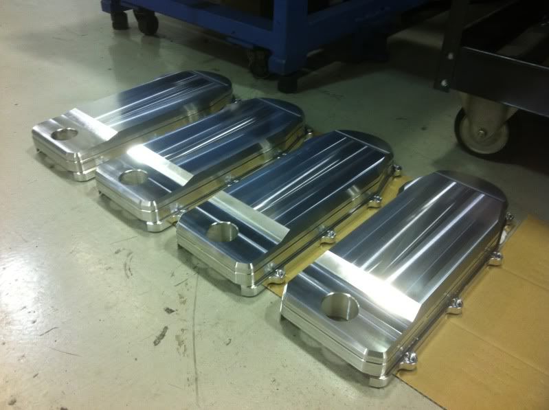

« Reply #37 on: January 30, 2013, 06:11:29 PM »
Finally, finished parts. Now they just have to go out for anodizing, I hope they don't scrap them :-\

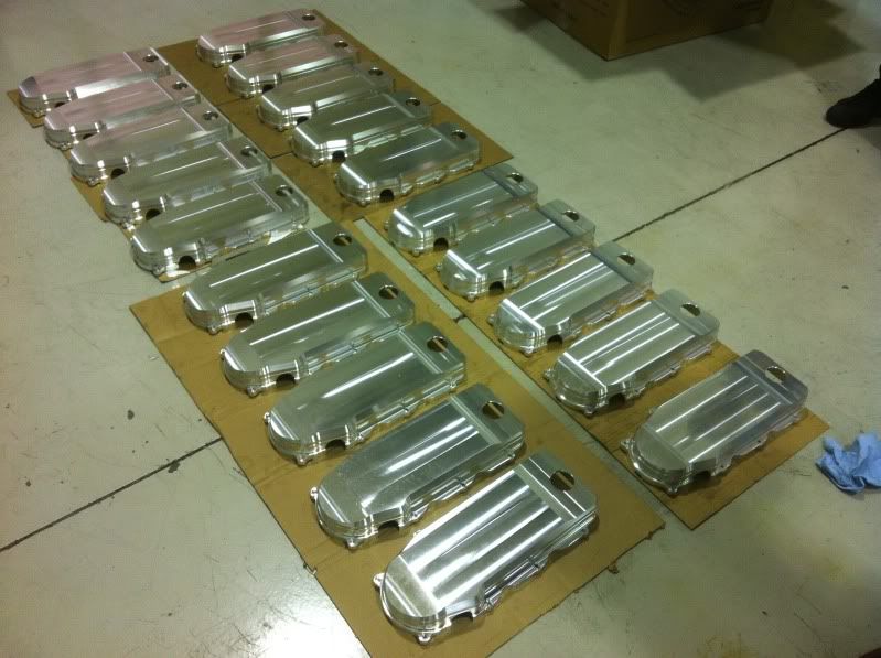

« Reply #41 on: January 31, 2013, 08:24:24 PM »
Here is the whole batch before anodizing. I'll hopefully have them back in a week from anodizing and then we will engrave them.

Obviously not crucial, but how flat did they come out, some decent material removal on both ops
Re: Todays machining project
« Reply #45 on: January 31, 2013, 10:01:35 PM »
Adam, I just sent you the instructions, hope your install goes well.
Philstubs, I think retail is around $450-475 anodized and engraved.
Flatness was way better then expected. We are using Kaiser manifold bar, which we find to be a little more stable then something like say Sapa extruded bar. Not sure why. But we are only .003 twist in these, I think there is just the right amount wall thickness on the walls and the deck is thick enough that is stays really stable.

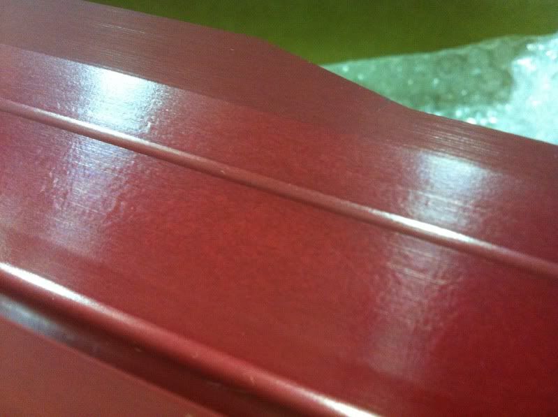

Well it looks like they might be repairable, they won't be as bright as they were before, but they should at least be consistent. I went to the new anodizers this morning that I am getting to try and re work them and the cover they stripped and re anodized looks good. We'll see how it turns out.
I'm fighting with the first shop to try and get my money back, its going to be a struggle to just get my money for the butchered anodizing back, you can forget all the other costs (including scrapping the parts).
Seriously, orange peel on an anodized part? Never even heard of it, until now:
Blotchy:
Looks worse in person.
I love owning a machine shop.
