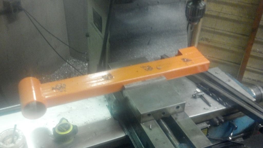

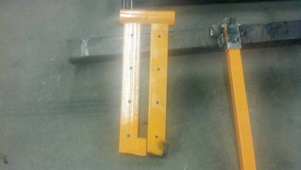

The first thing I did was was cut off the piece of the engine stand that is positioned vertical because it will need to be lengthened to get enough room for car bodies and such.

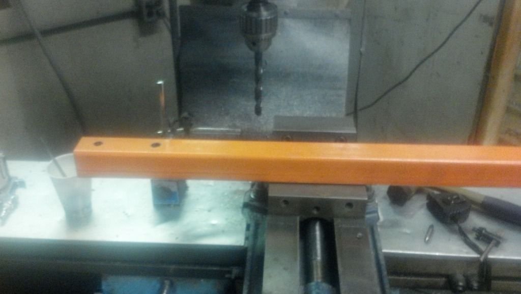

Next I drilled two 1/2" holes in the side of it so it can be taken apart later
The holes are 3.6" apart if anyone wanted to know.
I did the same to the lower bar that slides into it
This shows what it should look like when drilled

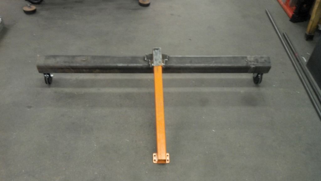

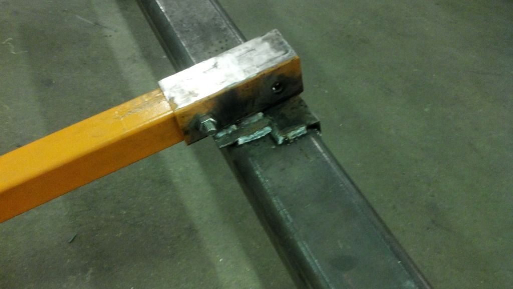

There was some 4" sqaure stock laying around that I am going to use as the base. Now this is ENTIRELY OVERKILL! This metal is super beefy but it was scrap so I used it. The main idea of whatever material you use is to make it roughly 5 feet long so the whole damn thing doesn't tip over on you when you try to spin in.
Here is a piece of scrap I used to space the lower part
Here it is welded together

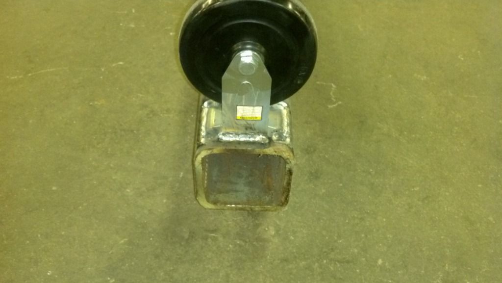

Here are the casters welded together

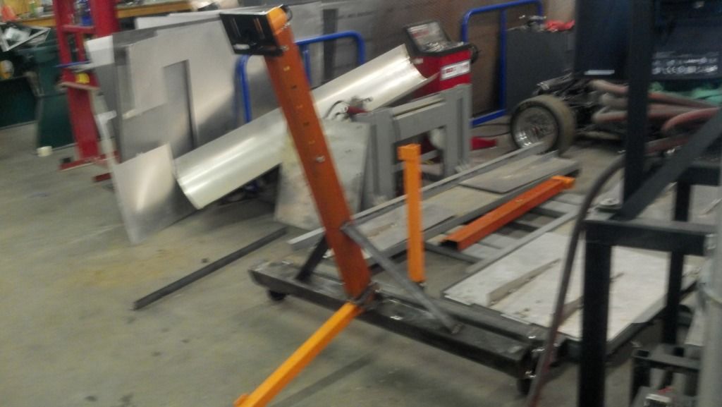

Here is what I have so far

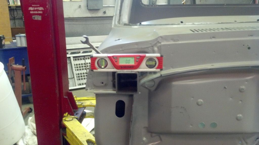

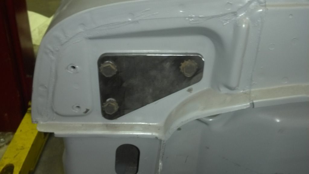

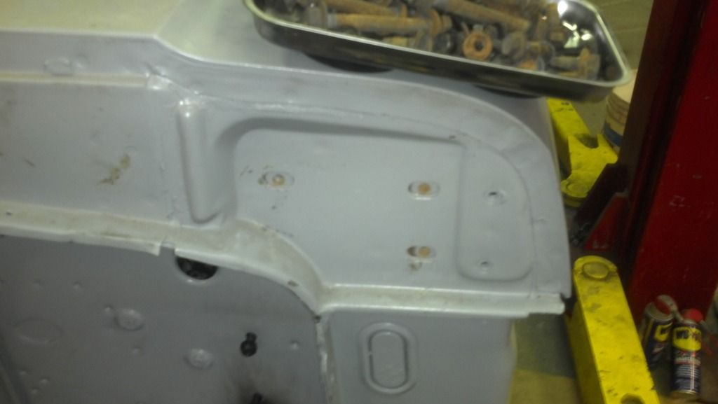

Now the tricky part to me attaching this monstrosity to the truck cab is that the lower cab mounts are rotted. I found a nice place to attach it where the fender wells are bolted to the cab

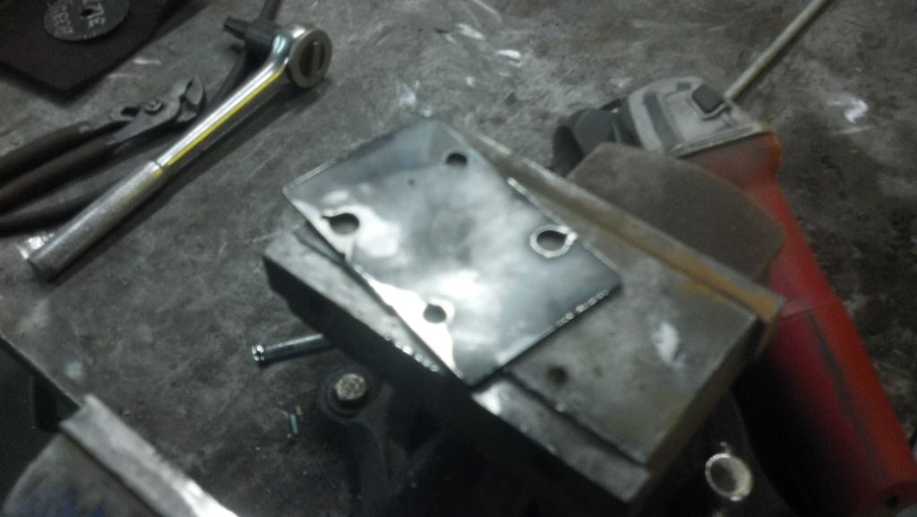

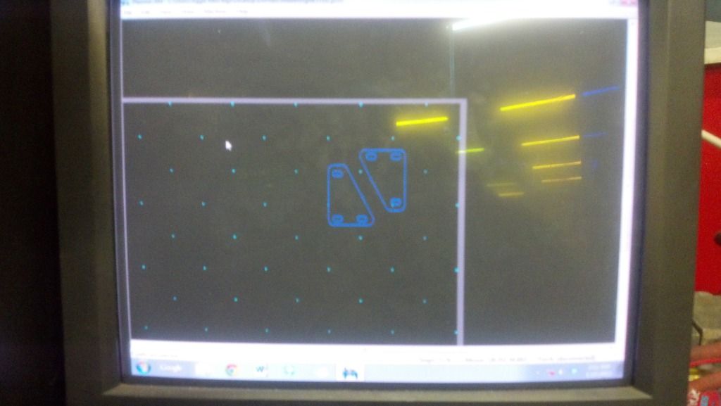

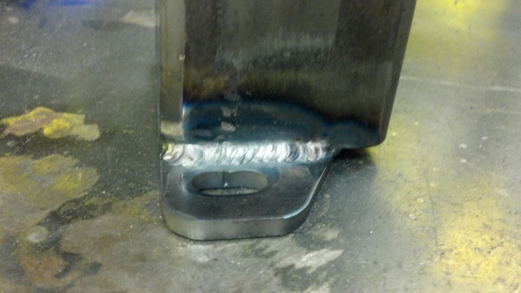

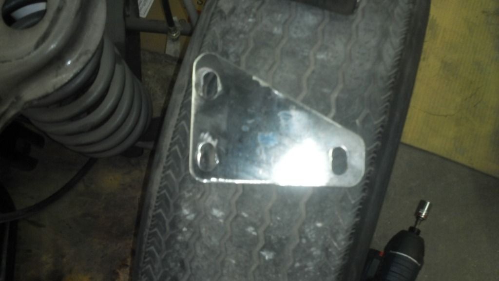

Solidworks model was made and converted to .dxf file for plasma CAM
Cut it out from some beefy stock in the scrap pile and it looks like this
Here is what it looks like bolted in
So that is as far as I got today. I will need to make the other side soon and get some more materials to finish the arms to mount everything.

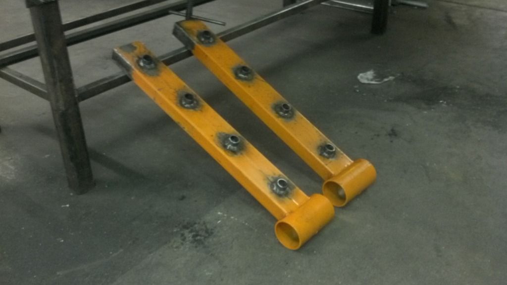

So I got a little farther today.

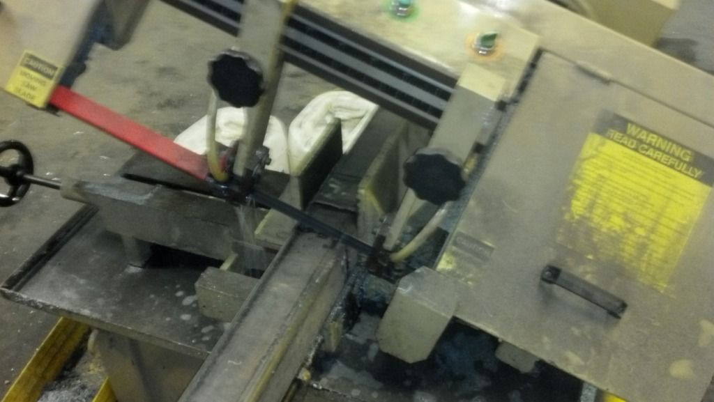

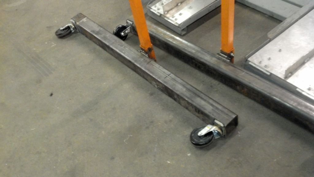

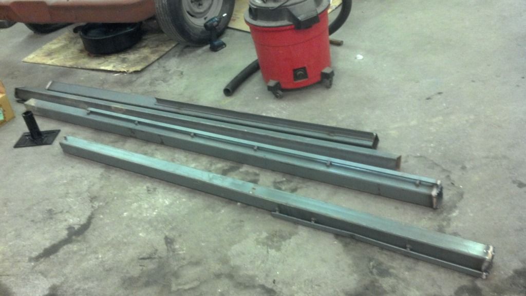

Here I cut up a piece of that gangster 4" square stock
Here is the other one with casters
Tomorrow I will be picking up some metal at the scrap yard to finish this

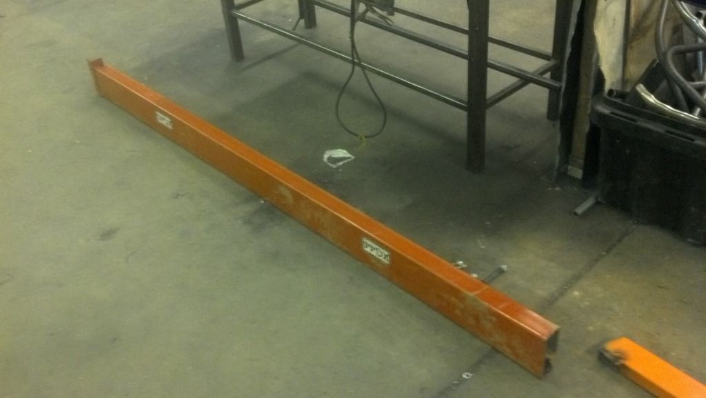

Just picked up some metal:
24 feet of 3 inch square stock. One piece of rectangularish channel at ~10ft. This only cost me $5!!!!  :Jew:  :Jew:  :Jew:  :Jew:  :Jew:

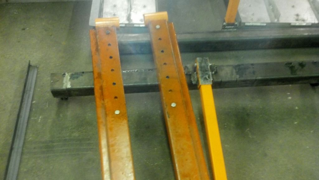

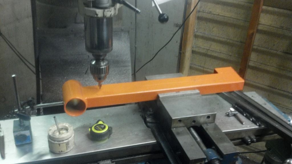

So I got a bit farther today. Here is the progress:

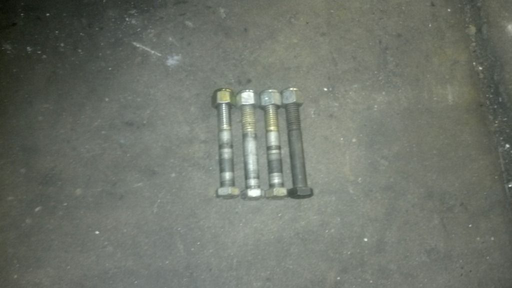

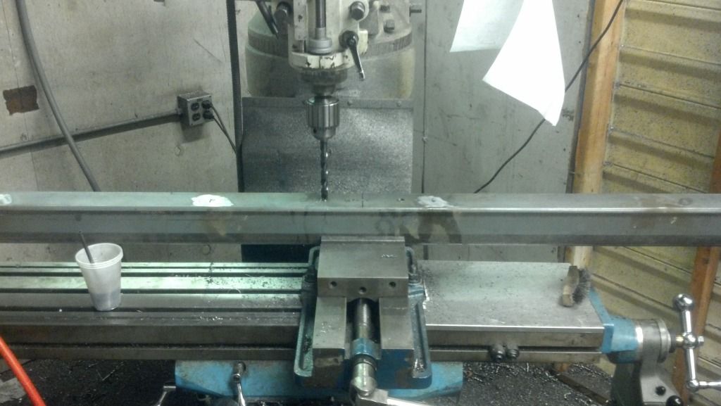

Found some 1/2" 13 bolts and luck nuts in the bolt bin. Score

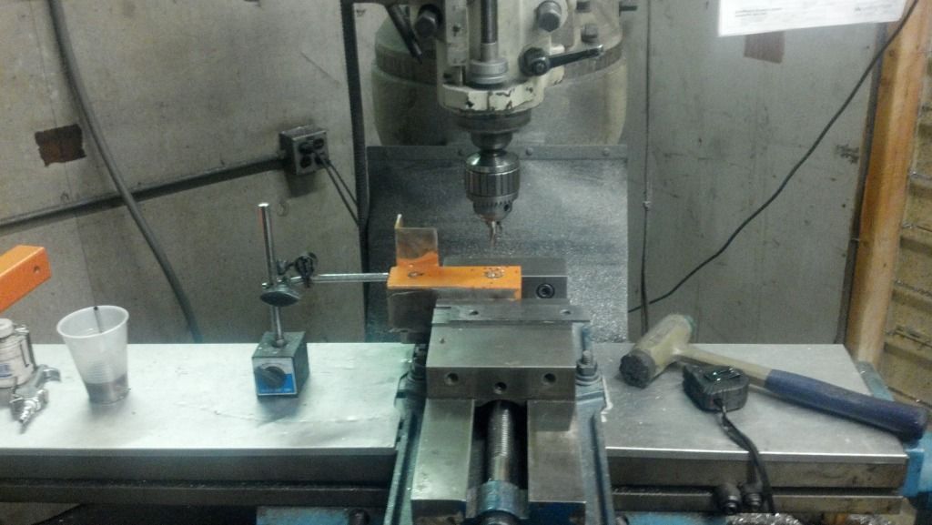

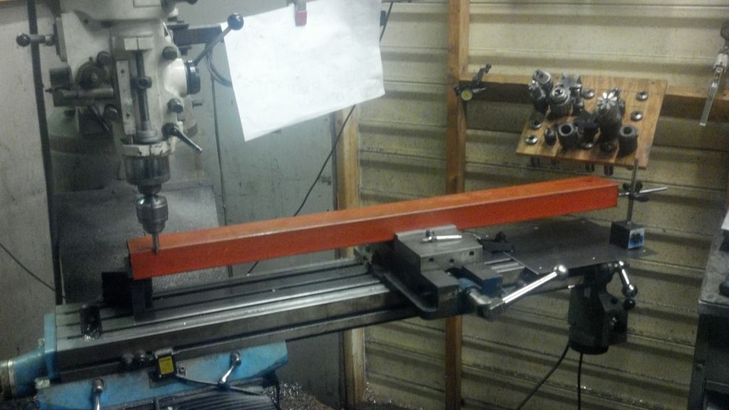

Indexed the vertical piece on the engine stand and drilled some holes
The holes were spaced 6" apart
Because I am balling on a budget here I have to work with this for the vertical piece that needs to be extended
To make up for the gap, I made some stand-offs to get the spacing correct
Now I indexed this piece and drilled some more holes! These were spaced 3" apart so the height can be adjusted
This is where I am at now
More to come

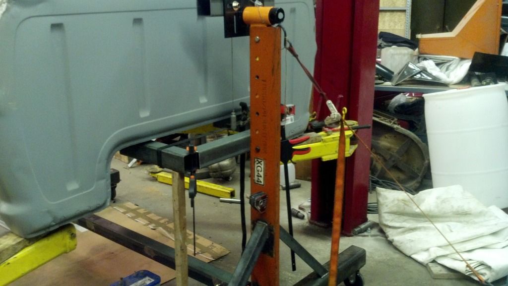

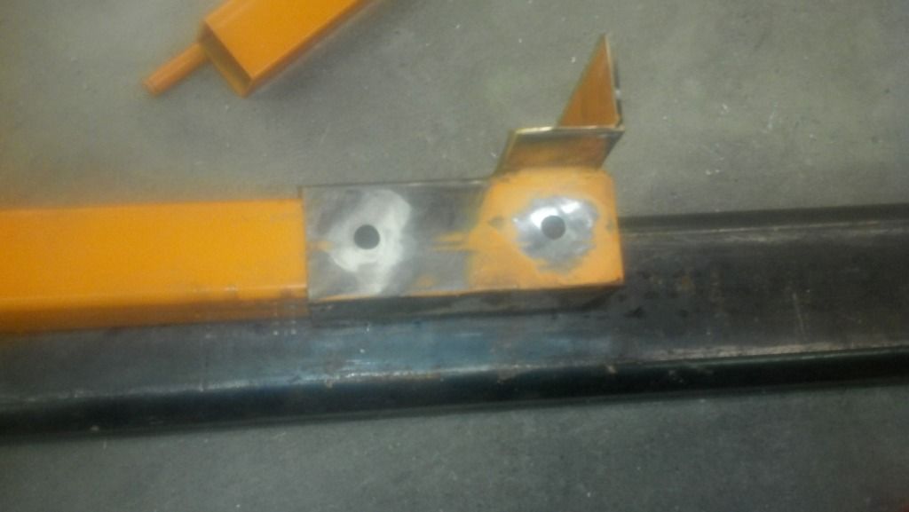

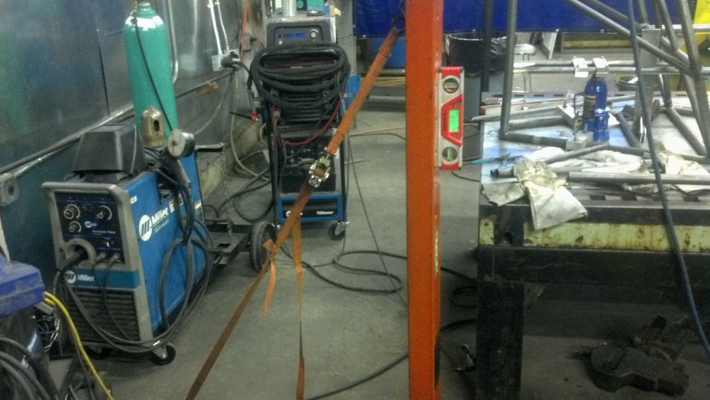

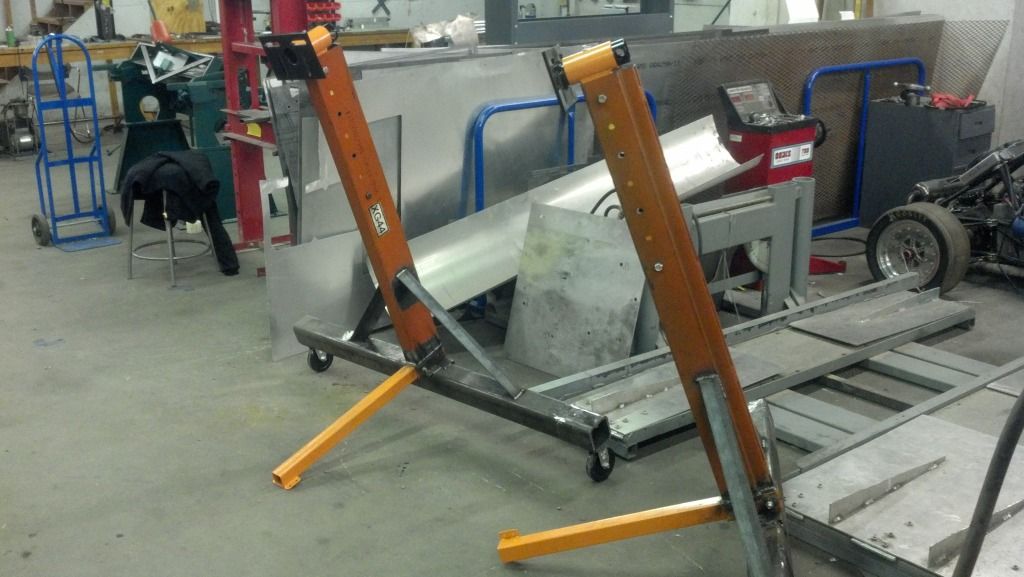

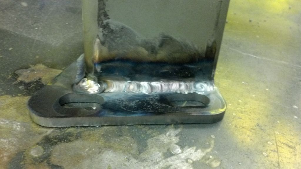

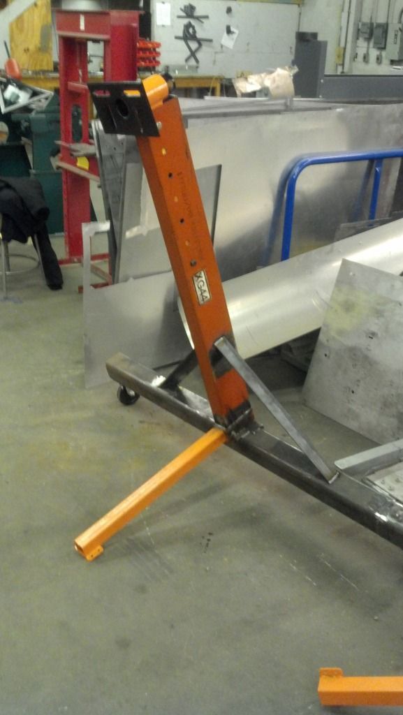

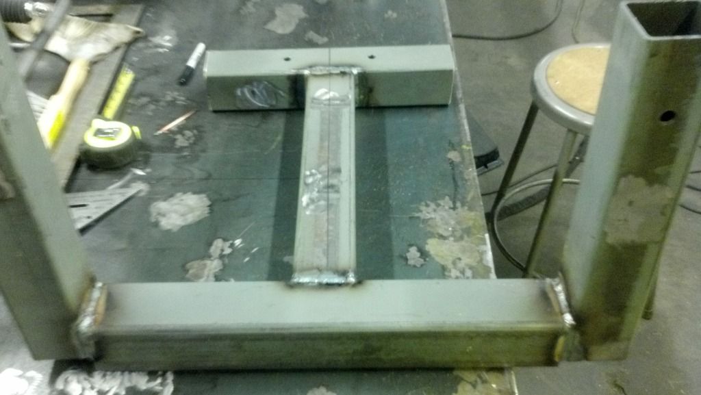

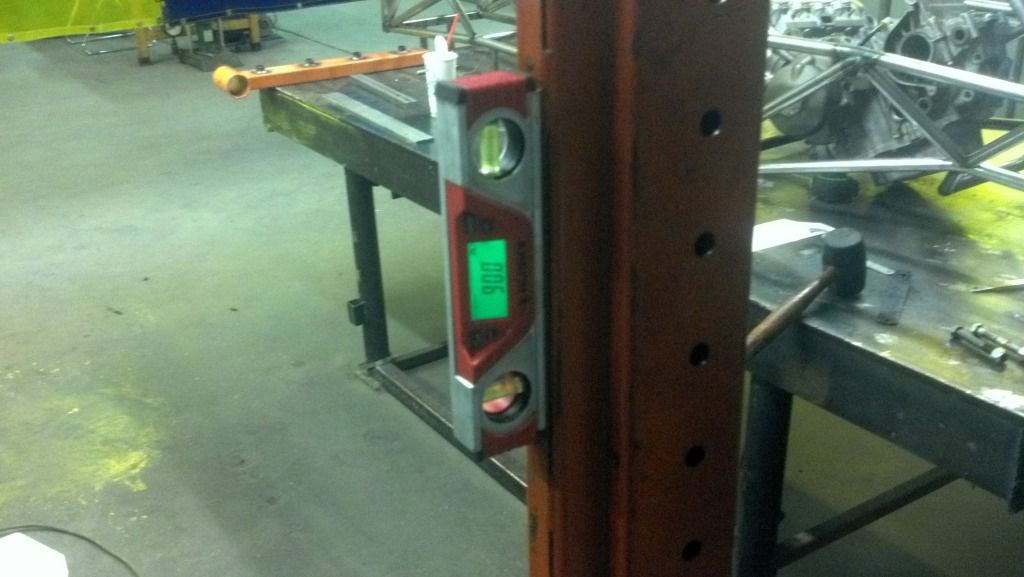

So I am near completion on the rotisserie. Here is how far I made it

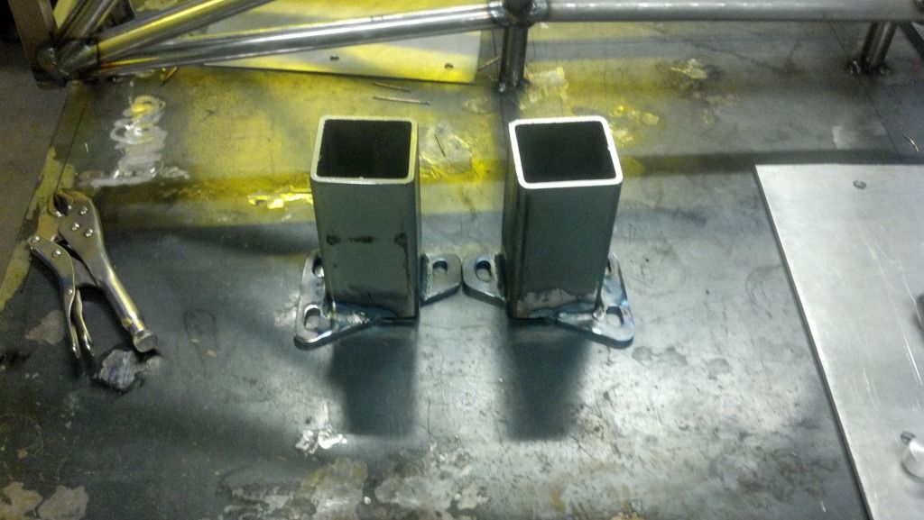

The hardest part of welding the vertical piece on is getting everything square. It's close :)
Here is the first one welded
Same deal for the second one
Ratchet straps are handy to keep everything where you want it after tack welding
Second one done
They are both ready to go

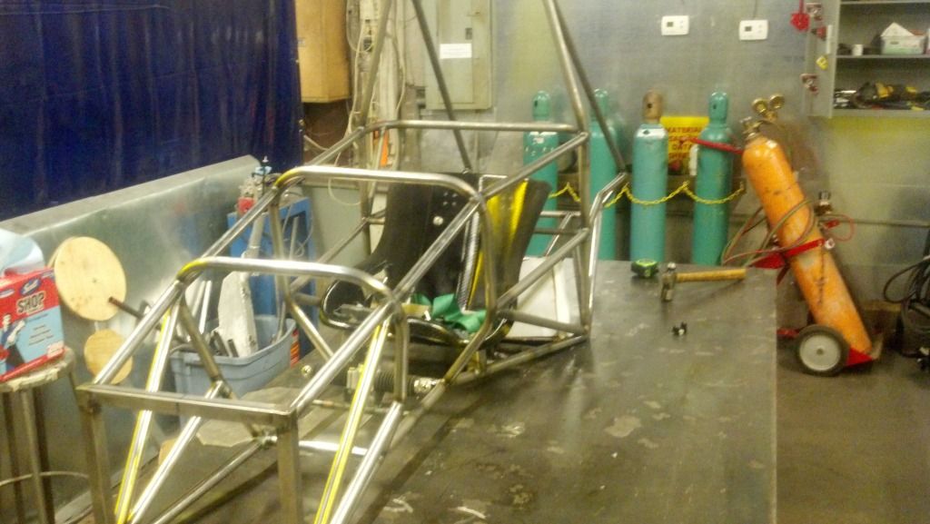

What are the projects in the background?  More info?
DSMR
  • Posts: 72
Re: Building a car rotisserie
« Reply #16 on: February 06, 2013, 11:57:28 PM »
The other projects are FSAE chassis build and BAJA SAE chassis build.

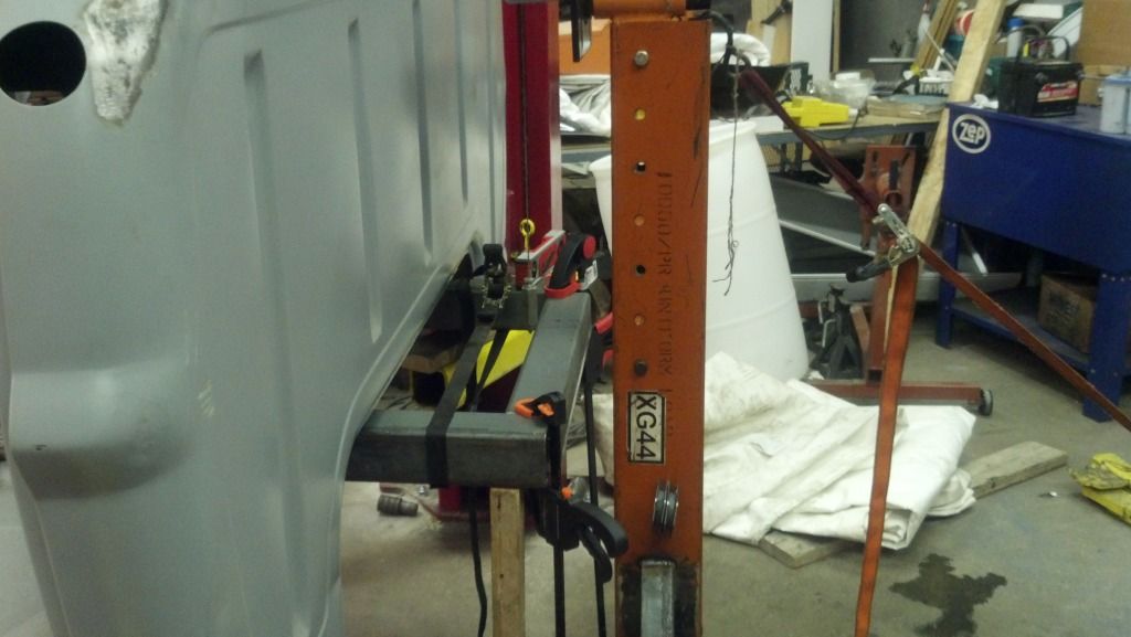

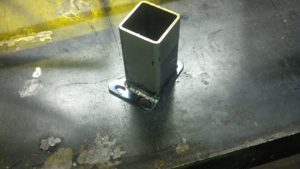

Got more work done:

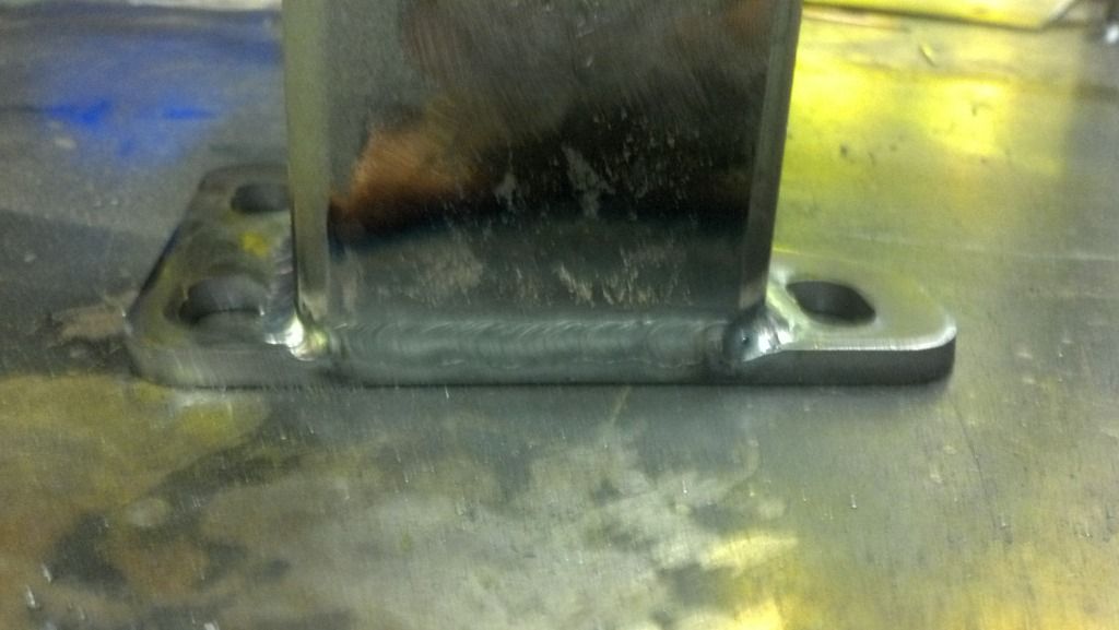

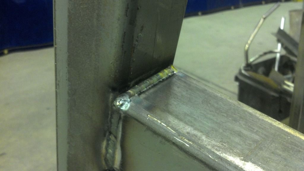

It really did not need to be tig welded but with all the weight of the body being on the Z component I thought that I should be safe.
2.75" from center for those who use harbor freight engine stands. 1/2" holes fit great.

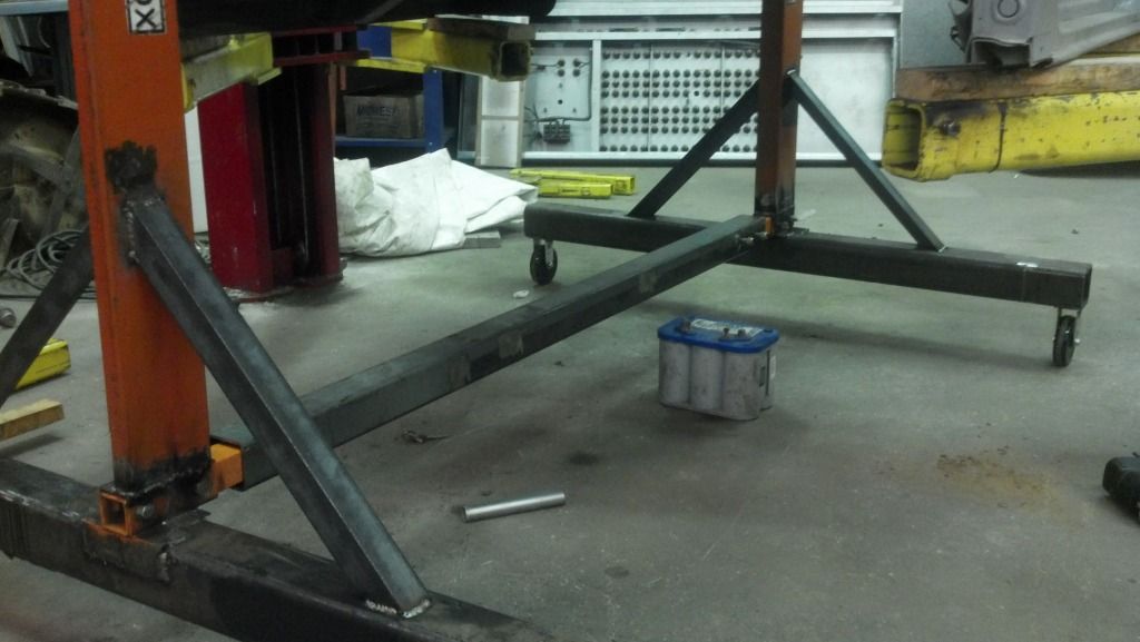

Measured out another piece of my $5 stock to connect both stands at the bottom. I am getting close to flipping this upside down.

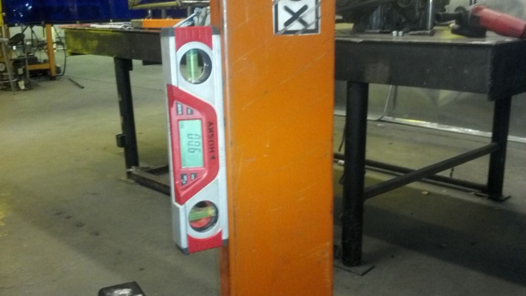

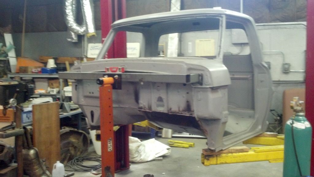

« Reply #19 on: March 02, 2013, 02:34:11 AM »

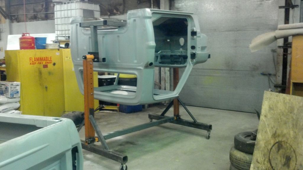

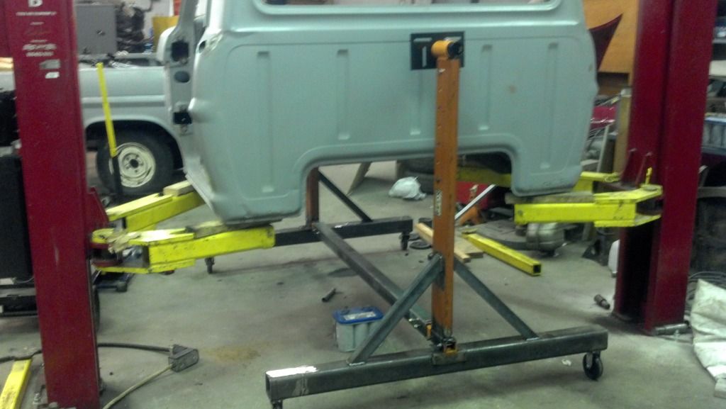

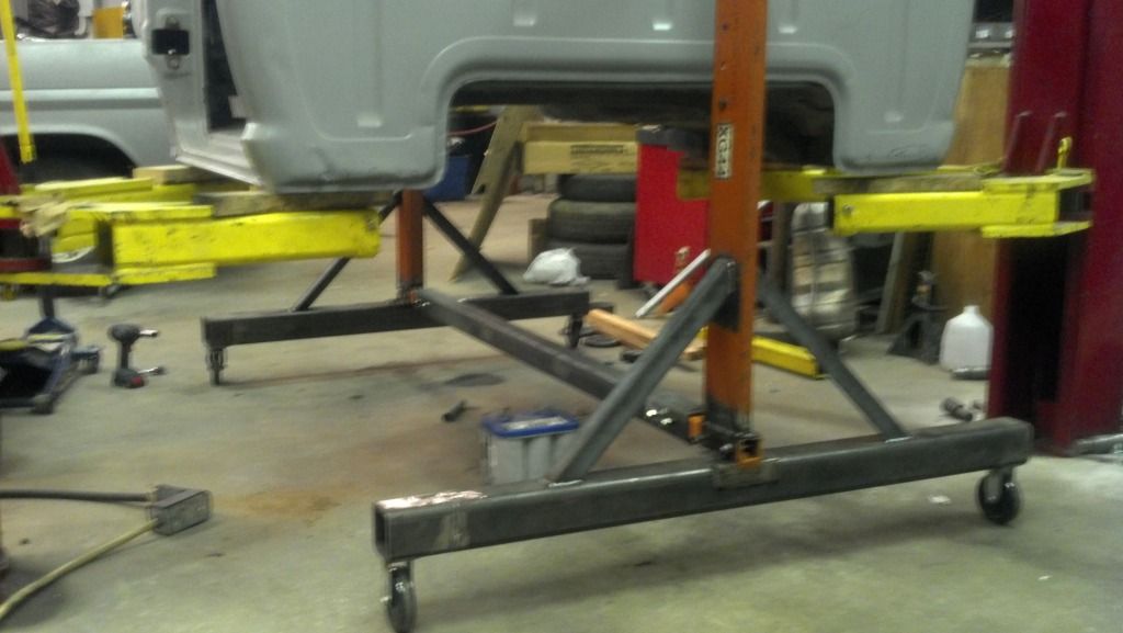

Figured I would show the completion to my $100 rotisserie.
Fixturing everything together was a pain in the ass. It is crazy how old ass tools like plumb bobs work great for stuff like this.
Tacked all that and threw some dookie on it...
I did not take the time to clean the part at all because I was in a hurry.
My buddy was there to help me out though  :noel:
And Viola! Topsy turvy
