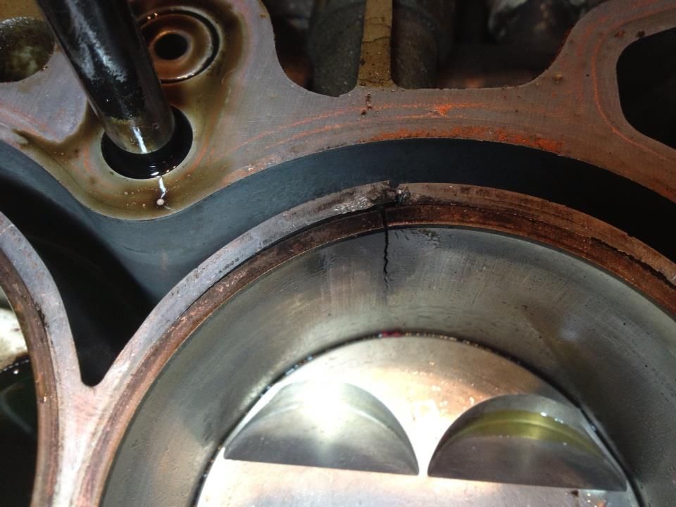

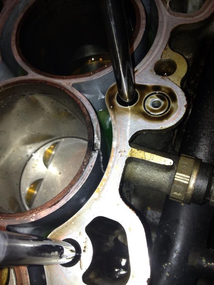

Pics to follow when I unlazy myself and upload pics.  Cracked cyl 2 sleeve.  Spiked 20 lbs, tune was good, plugs looked amazing.  Still ran fine, till all the coolant got sucked in the chamber and overheated the car in the middle of nowhere in MT.  Typical.  Blew a hole in a heater hose, cut, refit, filled with some water.  Made it 20 miles to a gas station, tried refilling with antifreeze.  Got on the interstate and fogged it out.

B18C1 is the one I split the sleeve on, I have 3 b16 blocks that i traded someone for, all 3 had spun bearings on the cranks.
I put the LS in yesterday (b18a) and timed everything, go to start it, and no compression...wtf???  So i run to work, rent a compression tester, and get 0 comp...so wtf.
All timing marks lined up, but don't depend on the reference.  Check cyl 1 w/timing marks lined up, and its halfway down the cylinder.  So i move the bottom end so that cyl 1 is at tdc (eyeballed  :noel:) throw on timing  belt and realign cams, fired right up.  Guess harmonic balancer isn't right or it shifted ~90degrees.
Fun never ends.  :mexi:

Ls is my trusty backup, a block guard would have helped but I figured by the time I was making enough boost to crack the block it was time to sleeve :noel:
