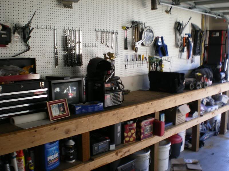

here on the left is a 2'x2'x6' box that I built out of 2 sheets of plywood. I used it as my dresser when I didnt have any room in my old place. I mounted it above my bed. Now its in the garage and holds all kinds of shit.
the other thing you can do is if you dont have room for a roll away tool box, then use pegboard and attache it to 2"x2" boards that you mount to the sheet rock, and harbor freight has the cheapest hooks around that you can get for the pegboard. then you can hang all your tools up.
Then I built a bench out of 4"x4" fence posts and 2"x6"x16' boards, and 2 sheets of mdf because its hard as fuck to beat up as long as you dont get it soaking wet. lots of extra storage there too.

Those are some good ideas. How much do you think you have into the bench?

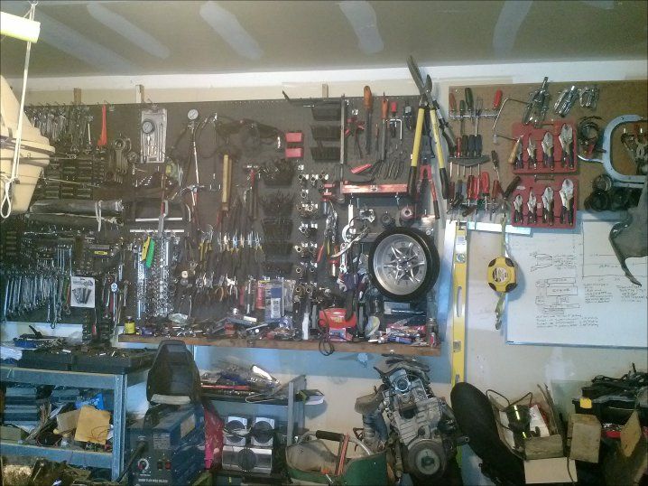

yeap pegboards work well  :noel:

That pegboard shit would drive me crazy. I have hand tools in toolboxes.

I probably have less than $100 into the bench. But I don't know the prices of lumber now. I built the bench 9 years ago.

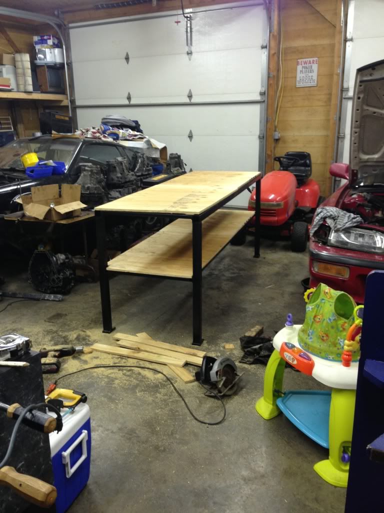

I built 2ft wide 16ft long shelves along two walls of my garage 6ft1in off the floor so not many people could crack their head on it.
I piled everything in plastic rubbermaid roughneck totes and labeled the sides before I threw it up there.
My workbenches werent' cheap, but they kick ass.
Welded 1x1 and 2x2 steel square tubing into a frame 30" deep, 36" tall, 90" long and covered the top and shelf with 17/32nds plywood that I bought with a gift card from lowes.  I can probably set a car on them and they would hold it.
You can see the shelf in the background top left of the pic, and the fresh finished bench in the center.
I store alot of tools under the benches and they opened up alot of space in my garage.
And I can actually have a place to work thats not scattered all over the hood of a car or a folding table thats about to cave from the weight of a transmission.
holy fuck!  Russ has a clean garage>?
Re: Cheap way to organize the garage
« Reply #17 on: October 19, 2013, 10:47:25 AM »
Not quite but I'm getting there, I got rid of all a, b and f/h series stuff. :noel:
