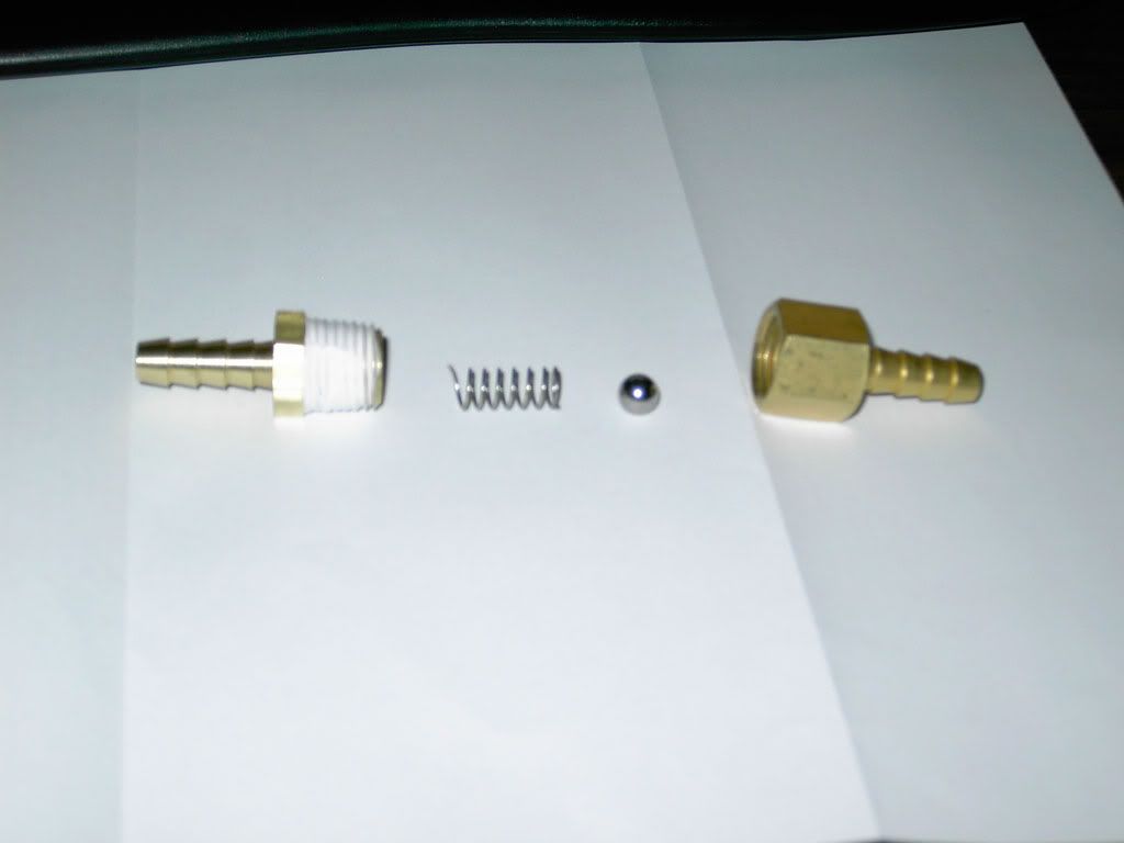

Could someone give me a link to info on boost controllers, or is anyone willing to explain them in detail to me? I've searched on here but couldn't find much. I know they trick the wastegate so you can run more boost, but what makes a $80 hallman boost controller so much better than a $15 ebay one? I assume someone would only need an electronic boost controller for boost by gear?
I made one like this, I wish I could give you more info, but it was like 5 years ago and I don't remember.
google "diy mbc" and you should be able to figure it out.
Took me 5 street runs to get it dialed into 12psi, just make sure you keep the wrenches with you to adjust all the time. just in case you need to adjust it a year down the road
Or try this http://web.archive.org/web/20071018023421/http://homemadeturbo.com/forum/index.php?topic=75418.0
I've been wanting to try this for some time.  :noel:
Thanks for the heads up, I'll definitely be looking into this and making a trip to lowes soon
Looks like it would be baller, pretty interesting that's for sure
