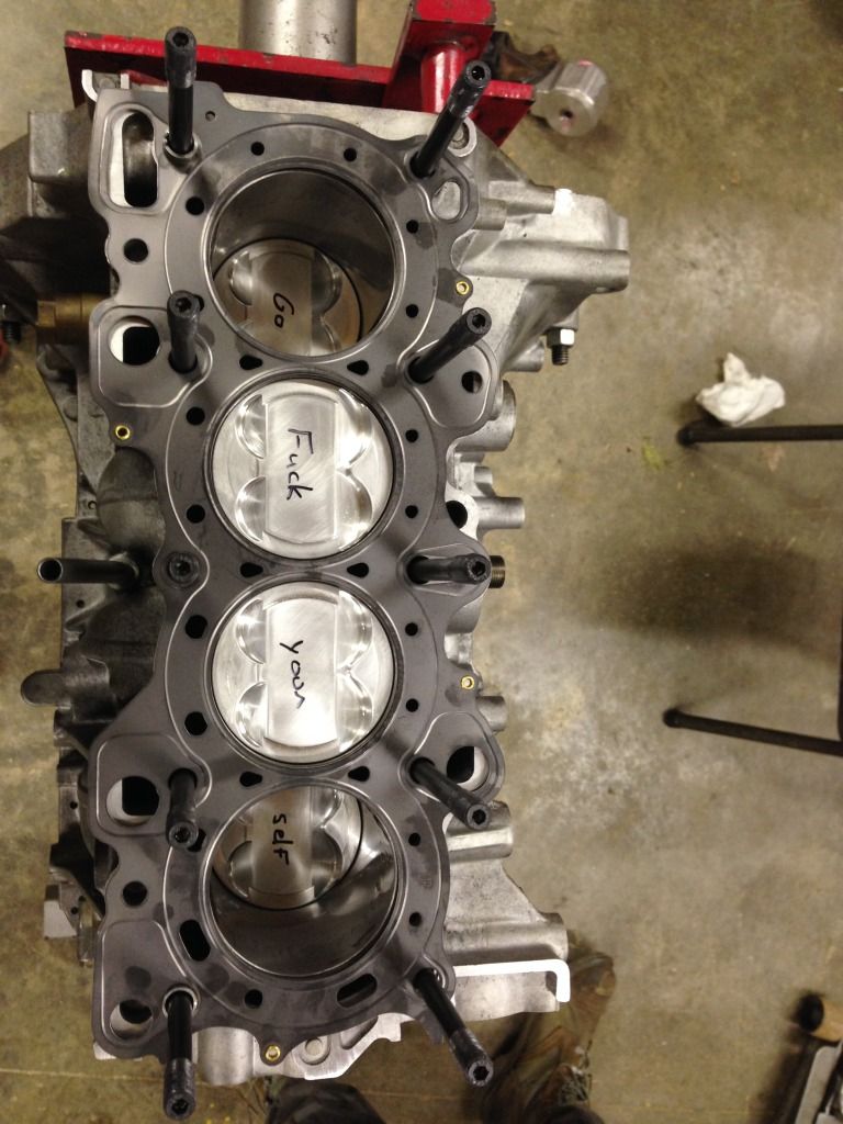

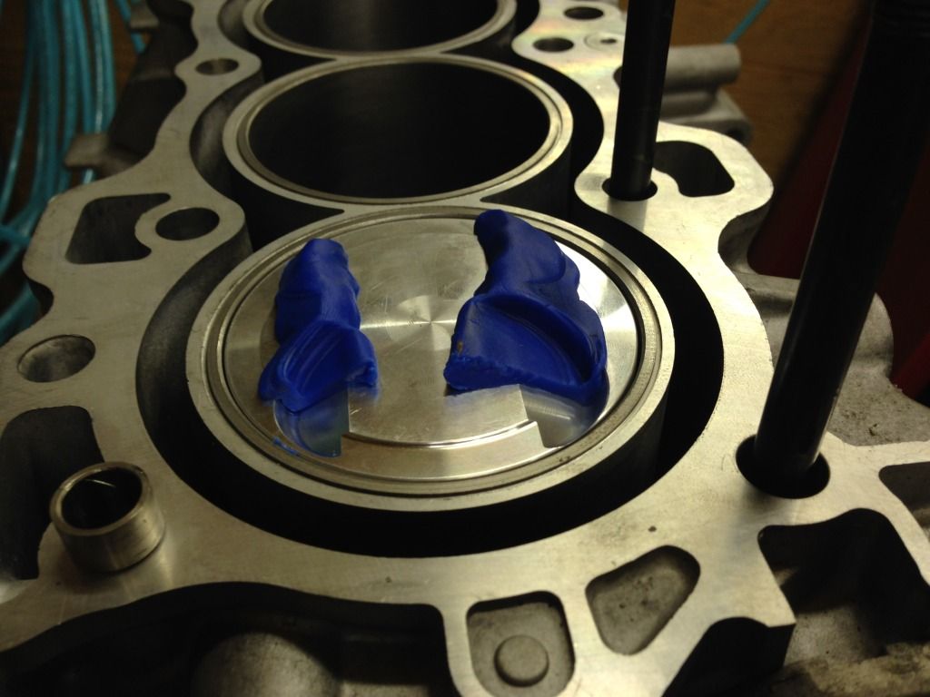

not much to report, still waiting on engine parts and my neighbor to weld a couple parts for my wastegates.
Tried to assemble my 'backup' motor so I could get it running sooner.
My main clearances measured all fucked up.
Either the shop screwed up the line hone, or I suck at measuring shit.
#2 0.0015, #3 0.0025 #4 0.0010
First time at using dial bore gauge/micrometer combo so i'm hoping its just me not using it right.
Might throw it together with plasti gauge and see if those measurements are as fucked.

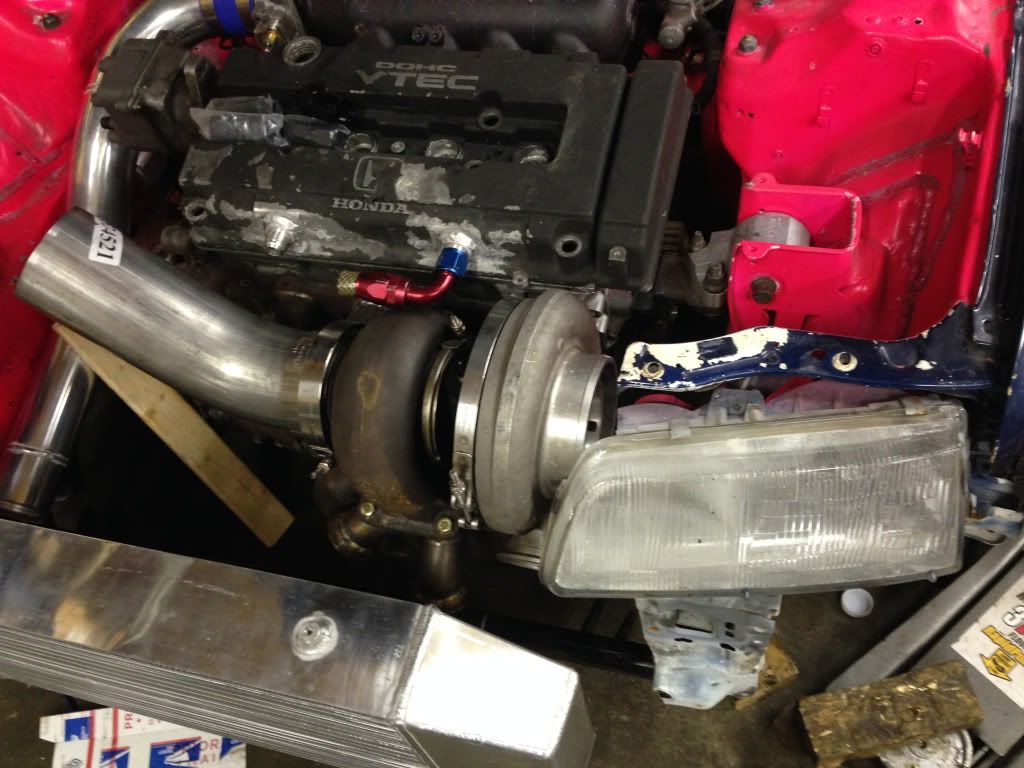

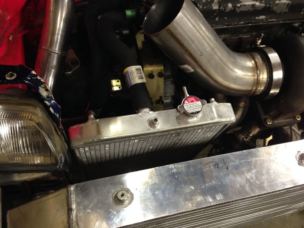

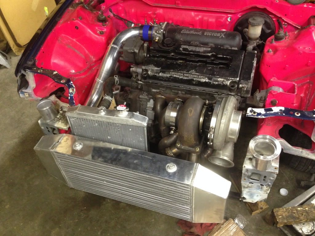

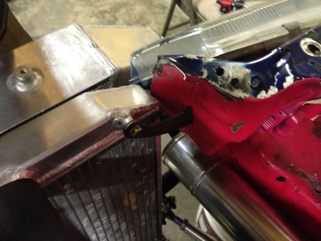

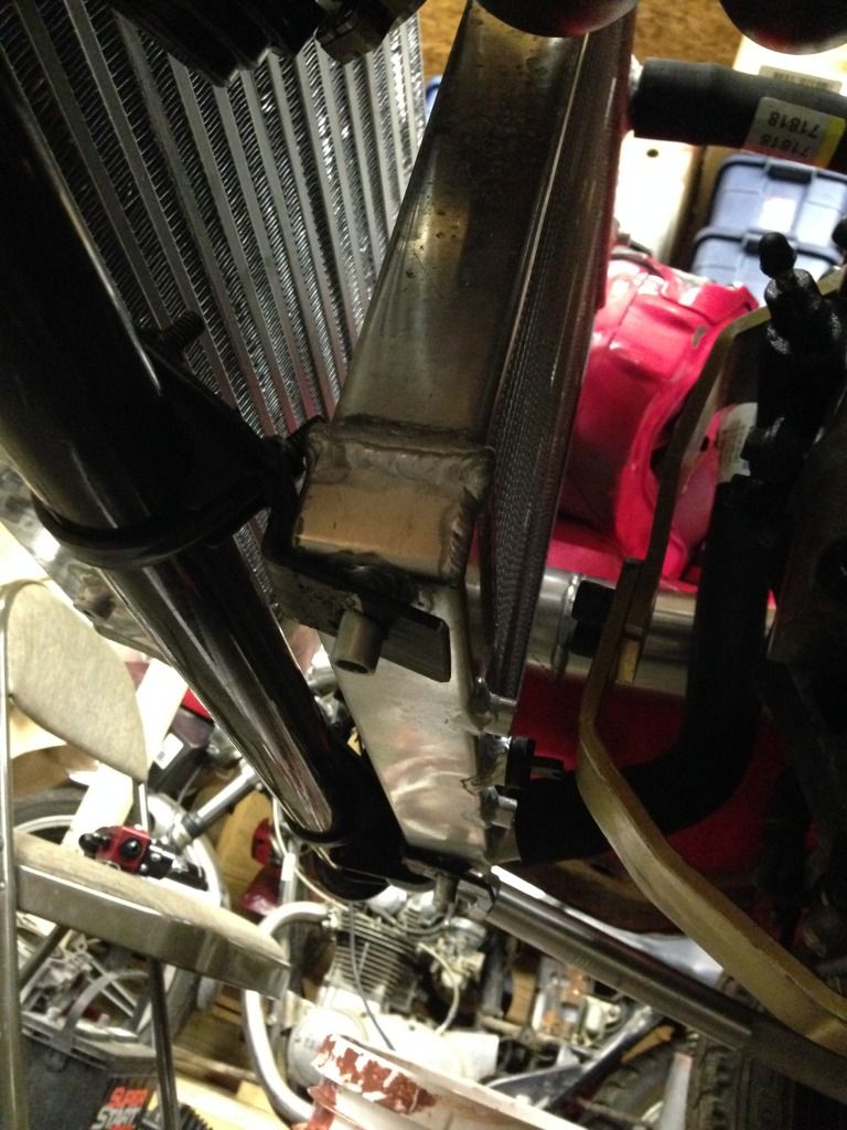

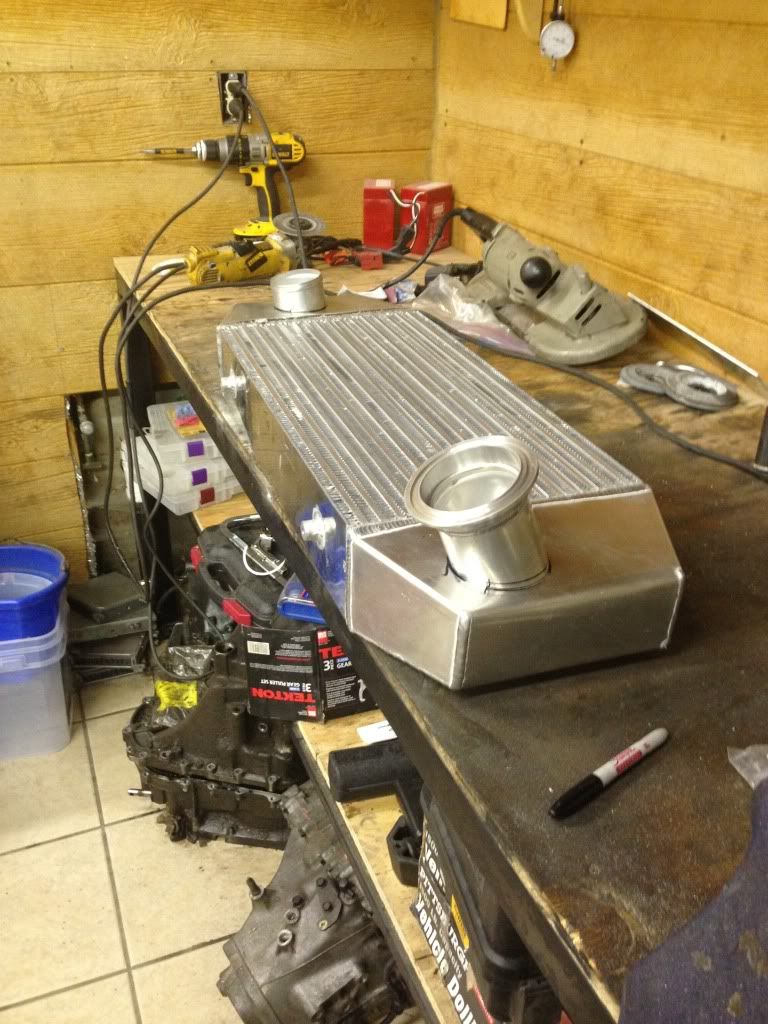

Did manage to get the charge piping and intercooler end tanks welded
Got the last parts of the charge piping mocked up now, hope to have it welded tonight.
Vband straight to the turbo, coupler on the passenger side, coupler on the throttle body...
shouldn't have any headaches like my integras 7 couplers.

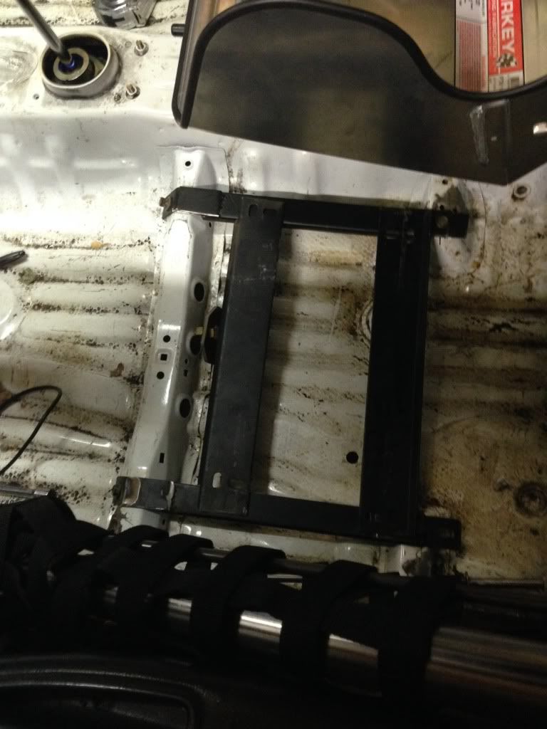

seat mount from scrap steel, tried to keep it as low as possible and cheated it towards the center.
Don't want to brain myself on the halo
slaved over making an extensive exhaust, also was bored so I checked to see if a headlight still fit on the driver side.

« Reply #34 on: May 02, 2014, 01:15:24 PM »
Trim the head light!

« Reply #35 on: May 02, 2014, 01:18:18 PM »
Plastigauge that shit
Re: My CRX shitbox that should be scrapped build
« Reply #36 on: May 02, 2014, 01:22:48 PM »
looks like he did.
« Reply #37 on: May 02, 2014, 01:29:35 PM »
Yup, took a grinder to it.  the glass throws sparks like I was cutting steel.

These main clearances were all over the board.  Nothing like mix and matching aftermarket bearings to get it right.
How fast you think we can get this thing on a junk/stock sleeve engine?

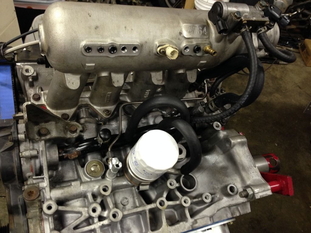

« Reply #40 on: June 26, 2014, 02:36:40 PM »

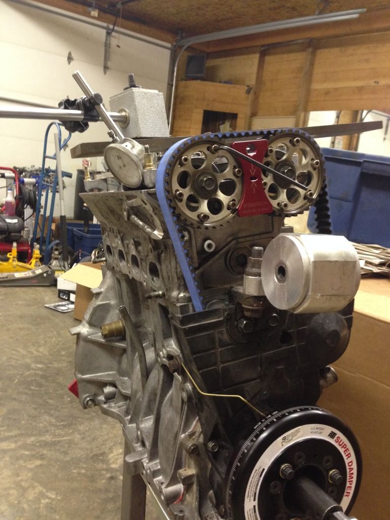

Its been a while since I've added pictures of this pile of fuck.

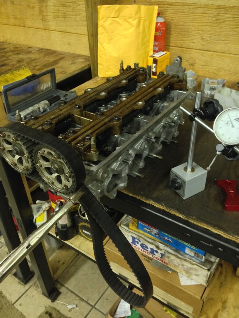

Used cams I bought were fucked, broke down and got a new set.
I should quit buying used shit to save $200, reality ended up wasting $400 on top of buying new ones.  Budget is now in the negative...
Checked clearances
I'm sure I fucked something up so I doubt this engine will last long
ballin 316 SS vtec oil feed line pulled from the scrap bin at work

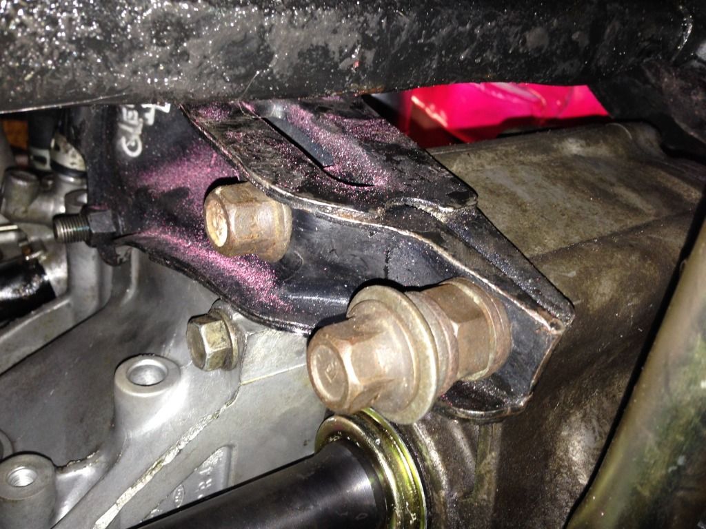

couldn't find the right length bolt for a hydro trans but short enough for the cable T bracket.

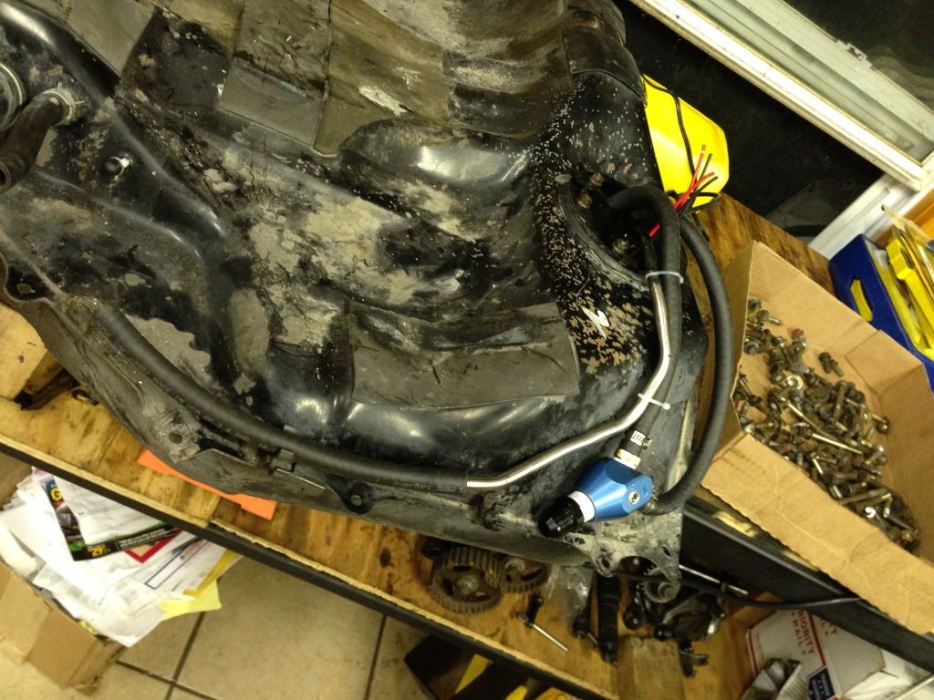

-mount dual pumps in tank
-run fuel line, regulator, and filter
-throw in the rywire harness

lol. did the same thing in my crx for the trans bolt  O0
how you like that timing belt tool? I am about to buy one...
« Reply #42 on: June 27, 2014, 12:52:38 AM »
Love it. Buddy bought it and left it and the fancy valve spring tool at my house when he sold all his honda shit
Just don't leave it on and crank your starter or it will fling your new timing belt in pieces

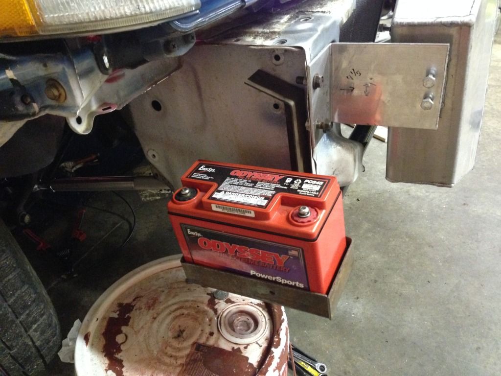

on my CRX I welded a brace from the back outside of the tray up to the frame rail area, maybe 8-10" or so? I can look for a pic tonight for ya.

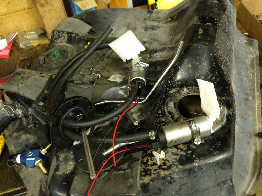

« Reply #47 on: July 03, 2014, 12:27:47 PM »

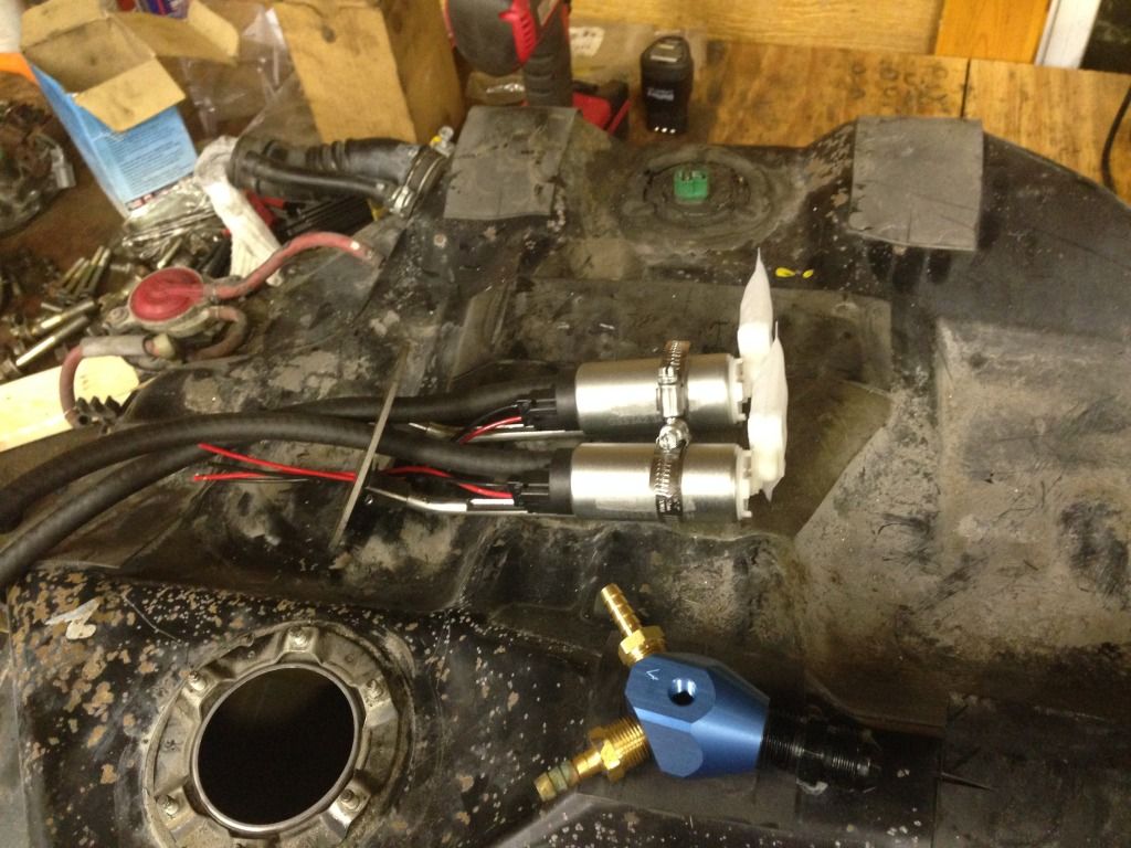

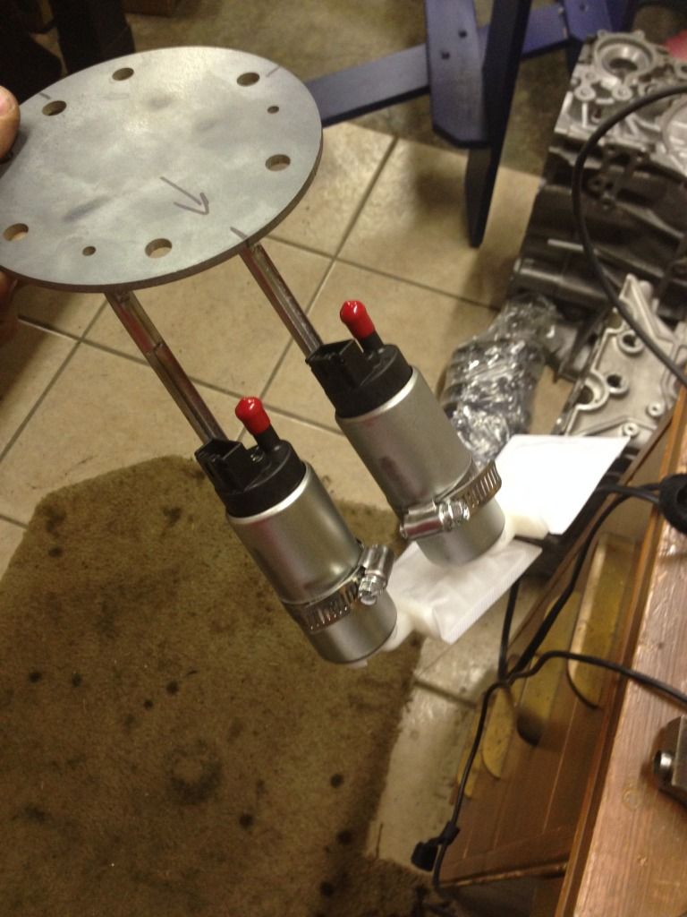

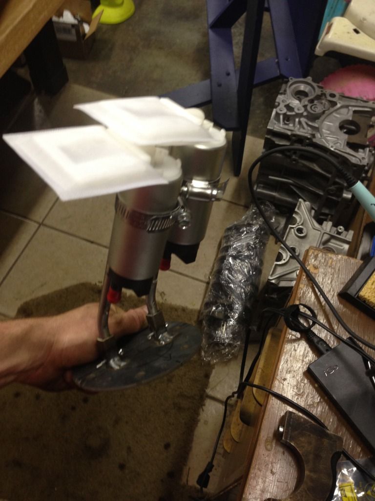

I've been told you can zip tie the pumps to the stock hanger, but I can't see how to reach in the tank and make that work.
I looked at pictures of the Full Blown hanger and modeled my own in Solidworks.  Had a buddy that was going to make a couple from 6061, till he broke his finger to the point of 2 surgeries to put 2 plates and 10 screws in. He's off work for weeks.
Had the top plate cut on a water jet from steel instead and picked up metal from lowes for a couple bucks.
Should work, but I'll find out tonight hopefully.
Getting the cotter pins in there was a total cunt, glad I didn't do as others and weld little nuts and use bolts in there.
I figured the things can only flop around a tiny amount with a cotter pin.

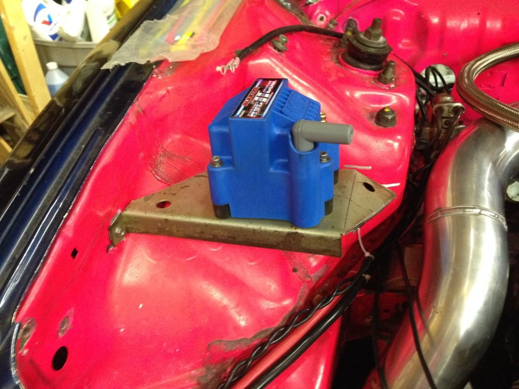

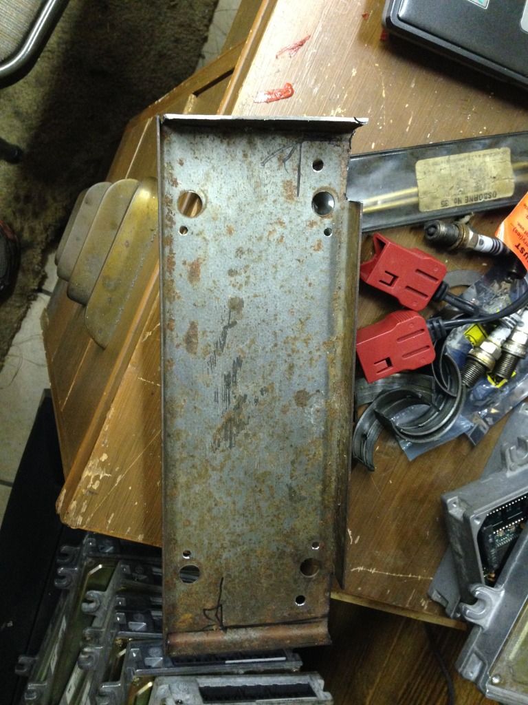

Hammered out a random piece of sheet metal
Mounted my ignition box to the firewall with it
Did a fancier one from the same sheet to mount my coil and boost solenoid under the hood but must have forgot to take any pictures.
Should make engine sounds tonight or tomorrow as soon as I get all these wires buttoned up and tied down.

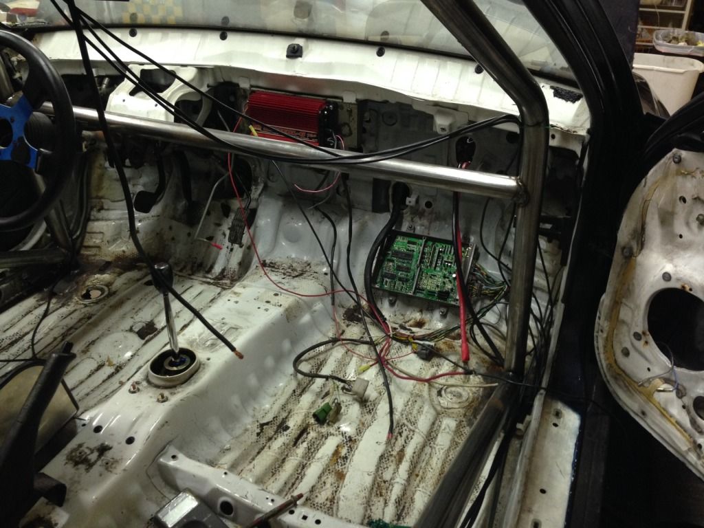

fired it up sometime this morning, there's a shitty vid on facebook.

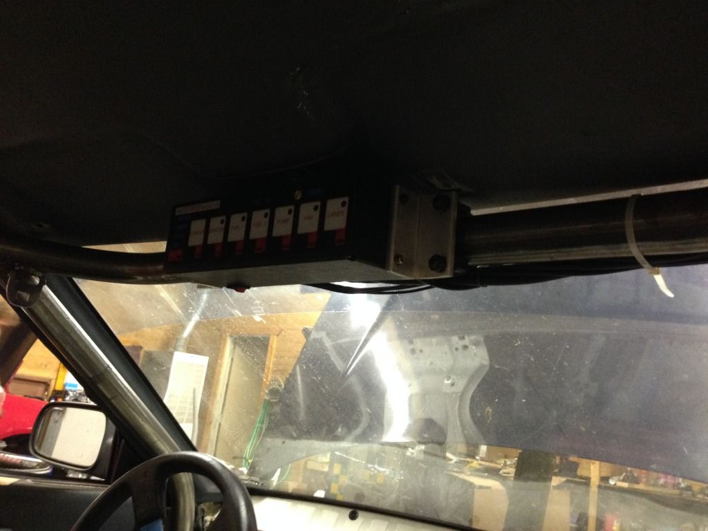

This switch box is bad ass.
I had all the components laid out to build my own fuse/relay box and switch board.
Saw this for sale online for less than half what I could buy the parts for so I scooped it.
It has circuit breakers instead of fuses so if you slip up and overdraw something you aren't fucked until you replace a fuse, just reset the breaker.
Customer service is top notch, it came damaged and they told me they'd fix it real cheap even though they knew I bought it used and dead. And they turned it around and shipped it back the same day they got it.
It was brainless.  I had a big schematic drawn on how I was going to wire everything and I was proud of it.  I threw it away and ran power and ground to this thing, then ran a wire to each component that this thing controls... done.
Hopefully it performs as well as it seems when I'm beating on it down the track

what's the name of the circuit breaker thing?

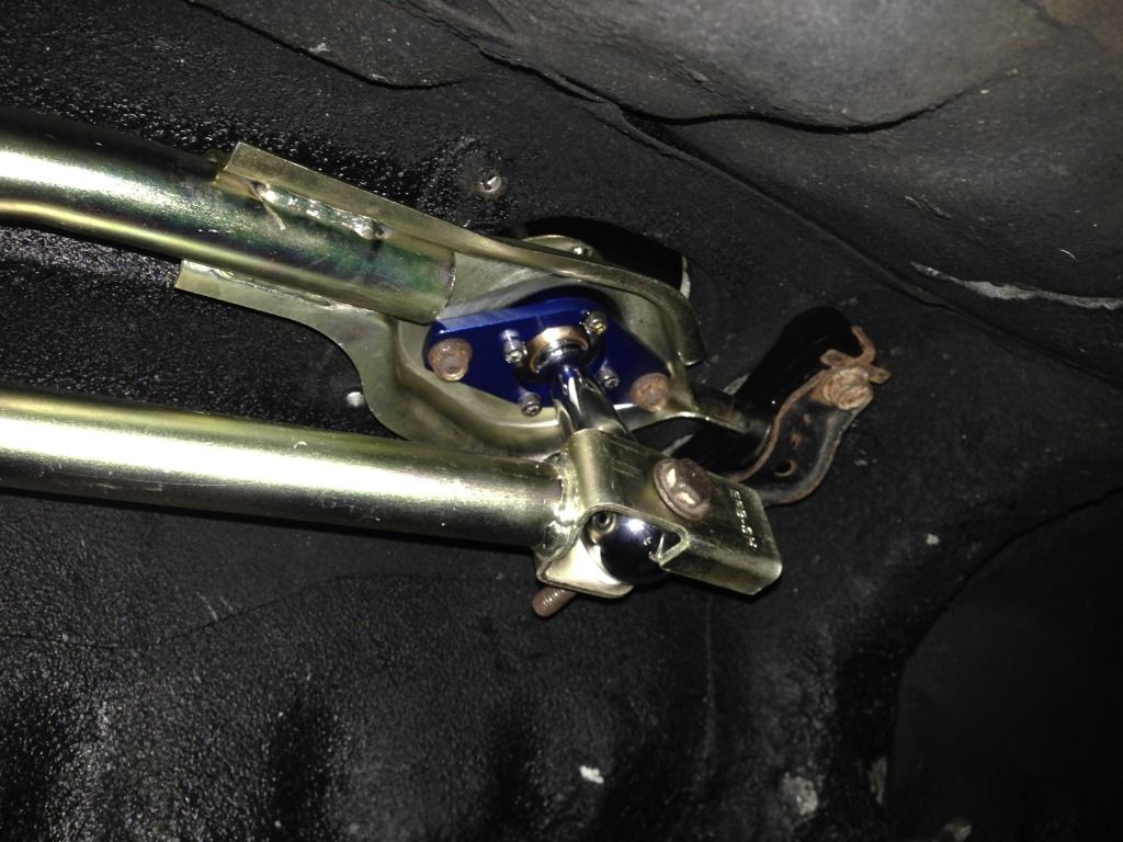

and what;s going on with your shifter setup? that looks like it would eliminate a lot of play.
« Reply #53 on: July 15, 2014, 07:29:52 AM »
Auto rod controls 3720
Looks like its pretty old and can't be bought anymore
Their current version has a small switch panel and a separate relay panel connected with a ribbon.

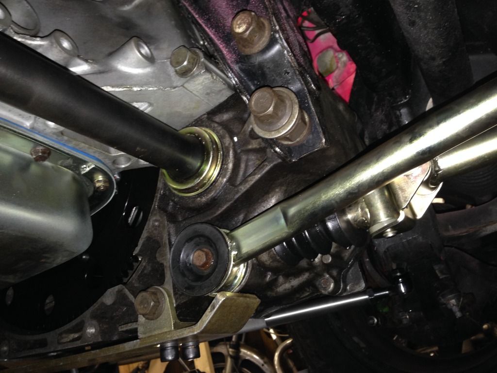

The shifter is a b & m sport or something.
I used new shift linkage as well and I don't really have any play between the two.

-tow it down the street and use an old neighbors air compressor to lock vtec and degree the cams in.
