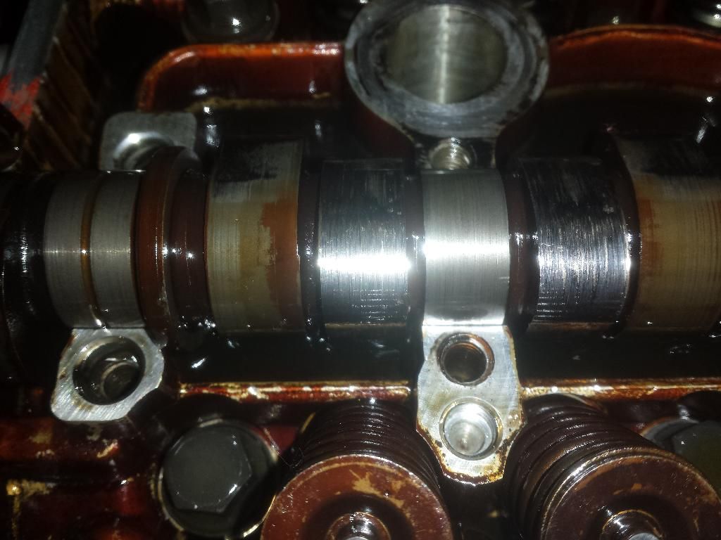

Having sound issues today.... ive heard this before, but it was never this loud and noticeable....
it goes away when revved, it doesn't go away when the clutch is in...
Did a valve adjustment, went intake .08 and .09 wont fit, ex .10 and .11 wont fit.
never had a issue before, been a few days since the valve adjustment. went to work, came home. Moved into the garage and I hear this...
http://s788.photobucket.com/user/sedrohatchstyle/media/VID_20140321_171822.mp4.html
Is it the valves  again :?
Im waiting for it to cool down, make sure i got the caps tight. Pretty sure I did but you never know...

Look at your pads. Hear a pa tap tap meaning 1 could be wiped out only working 1 valve. Just take the damn thing apart

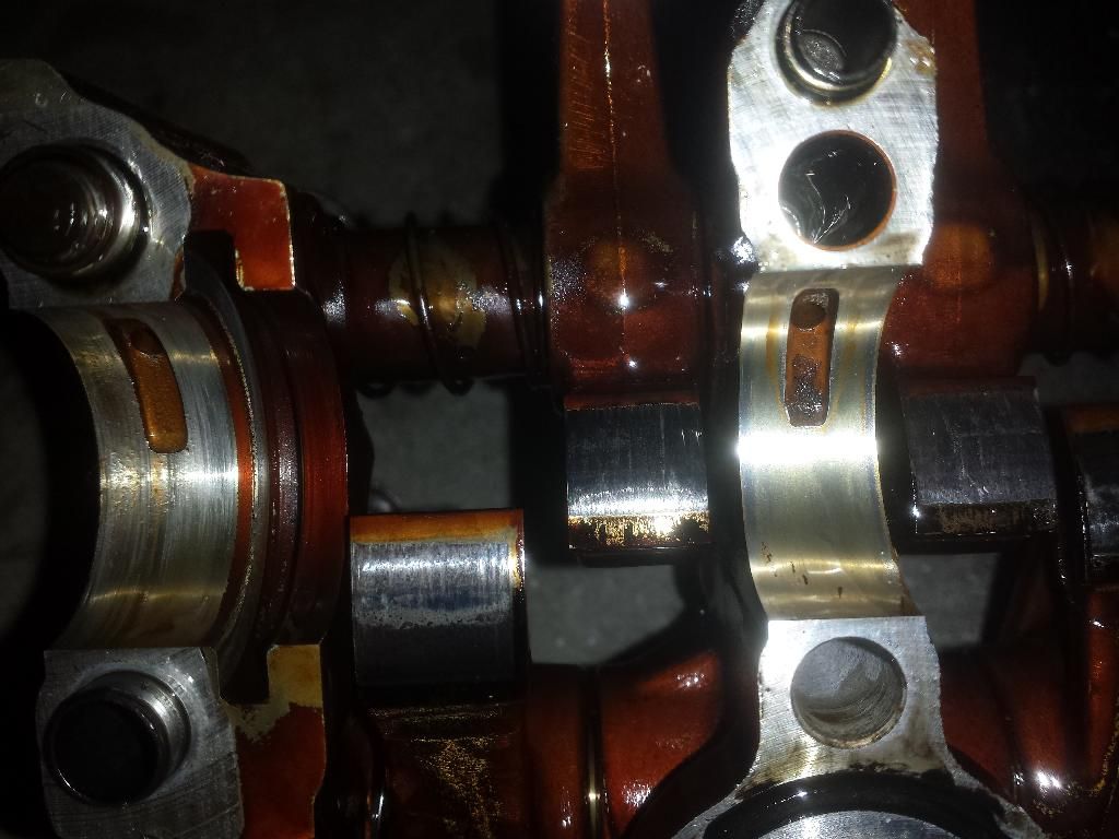

Slide off timing belt and all the 12mm bolts holding the rocker gear on flip and inspect 15min tops
Sedrostyle
  • Posts: 106
  • Turbine Noob
Re: "New" HMT forum guy
« Reply #54 on: March 22, 2014, 06:21:17 PM »
Looks okay... cam is a little scored twards the dizzy, rocker faces are a little scored. can't really tell in the pictures, but i don't think this would be making noise? everything moves freely
Looks horrible on the computer I just noticed... :D
Also noted, that it only does it when its warmed up.

Dude that motor looks like shit what's its history? My 180k d15 without an oil change in 30k mi looks cleaner than that.

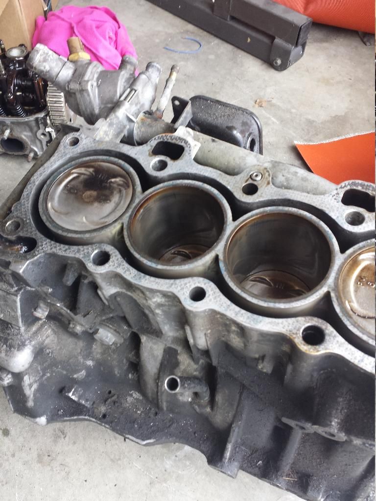

uhhhh... idk I bought from a guy in bellingham, years ago, said it needed to be rebuilt.
In my shed it sat until finally the 1.5 on the freeway.. .kerplowy.
So what did I do, had to put it in did minor gaskets, drove her hard :D
probably put a good... id say 75000 on it since. Finally did valve seals two years ago,
Present day, would go thru a quart every 4 days or so... for the last year or so. i'd only add oil when my oil light would come on :)
got burned on the two motors. one had spun rod bearing.... bad.. black ring lol
second one, came with dizzy manifold harness, full long block... said it " may " have popped a head
got it home, took the head off in 30 minutes. top looked good, I have pictures somewhere.
thought ya okay this will be okay to slap the rings and bearings in...
ehhh wrong, cracked piston ring gland in one piston. and the bearings were chewed...
WELL I figured, meh my motor in my car doesn't knock or leak or whatever.
So I rebuilt it. rings bearings gaskets hone.
block came pretty clean.... head I didn't really clean, just the surface and brake cleaner and a pressure washer.... didn't go all out on it. I wanted it together.
The z6 head I have is in great shape and the plan is to put it on asap. Which SHOULD be next weekend.

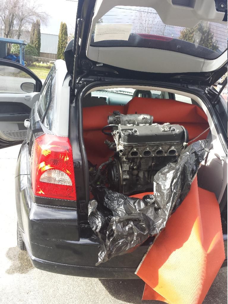

If I can't verify compression or look at the bearings, I don't buy it - unless I can get it for nothing. Except when DasPoop brings them to my house, stuffed in the hatch of a CRX no less.
Sedrostyle
  • Posts: 106
  • Turbine Noob
« Reply #58 on: March 23, 2014, 11:59:30 AM »
Well the first one was 80 I think. But I drove to BFE to get it.
Second one was 150? So ya shits weak oh well. Now I know I guess.
Had my wife's new car 12Hrs. And loaded it up in that beeetch.
