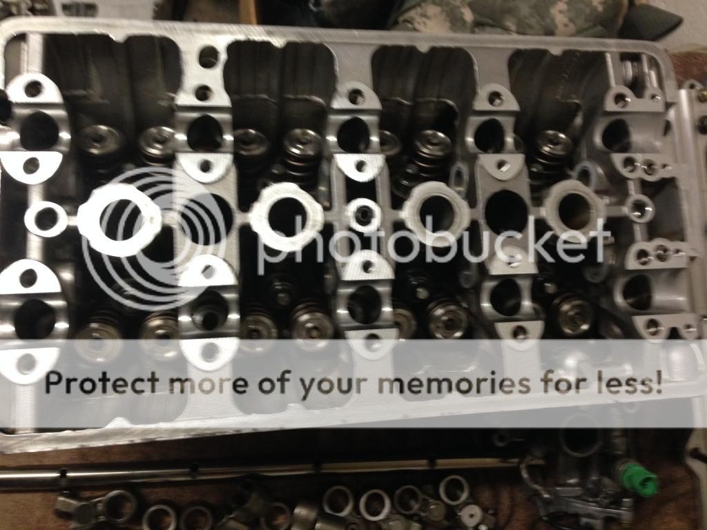

It was raining really bad today so i did the keepers and had to take a beer break. Didnt think they would be such a pain in my ass.

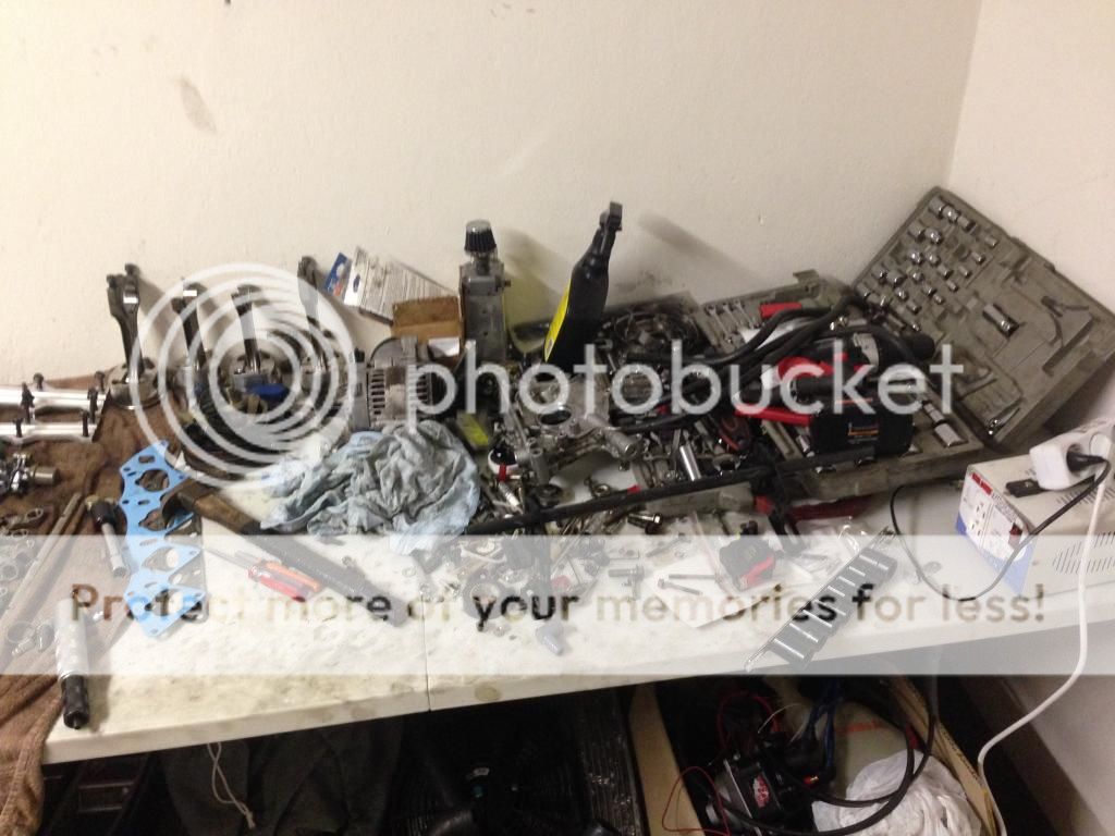

Here is my small ass basement/storage unit.
Re: The rebuild Begins
« Reply #33 on: October 20, 2014, 12:39:02 PM »
Damn dude, I don't know how you can work on That thing in that small of a space without loosing anything. Looks like a hot fucking mess. Keep up the good work.

« Reply #34 on: October 20, 2014, 12:53:23 PM »
its rough, i had to put the bolts in baggies and boxes so i wouldnt loose them, it might be getting worse if i pick up an engine stand like i want too.

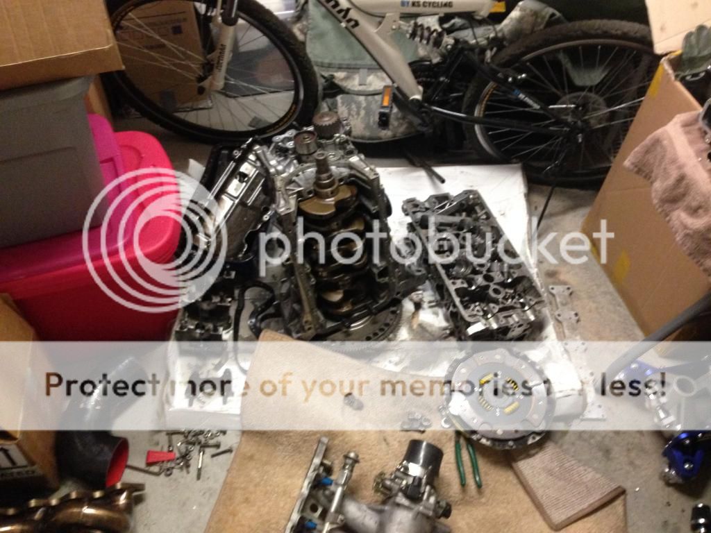

The German shop i took my block to, doesn't like Americans and he took 4 weeks to do my block. After installing everything i noticed my piston in number one was offset. I took it apart and come to find out i twisted the rod. I should have the rods here by Wednesday and then i can have it running by Friday. I have finished all the electrical, the block is in the car and the head is finished.

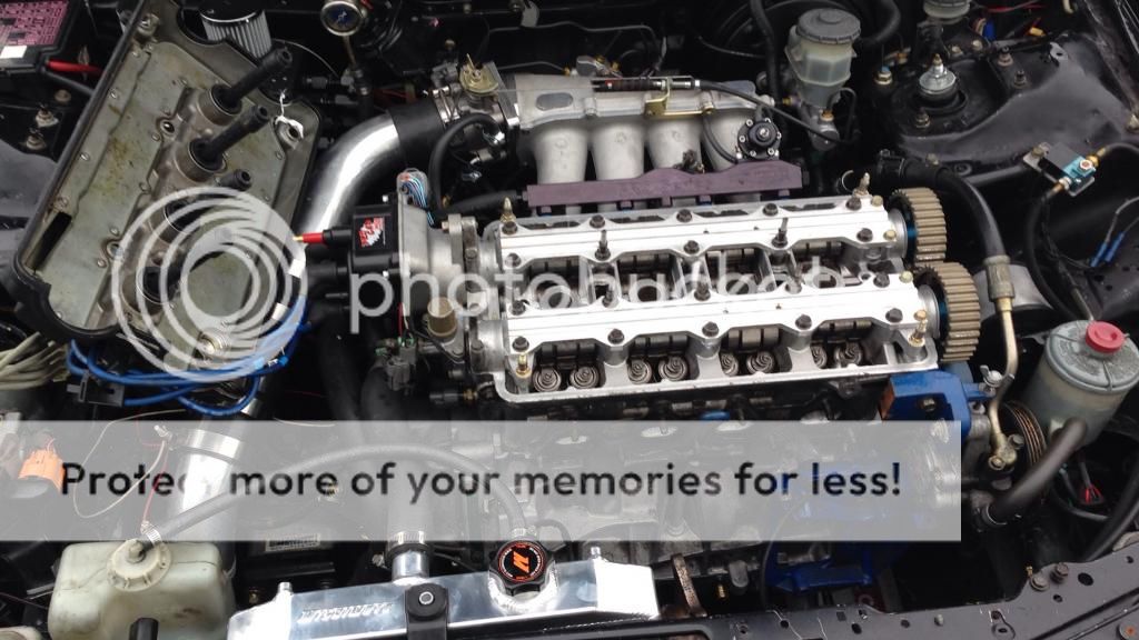

So i put the cams in and started on the electrical and ran all the hoses, but then the snow started and we are currently at 2 inchs and the weather is calling for a little more. Plan is still to get it all done tomorrow.

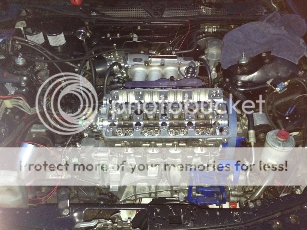

As you can see i got a lot done today. Now i would have finished if w didn't need to go to the emergency room. Pregnant wife was freaking out for something that's normal. First kid and she freaks out about everything. By the time we got back it was dark and i need a nap before i watch the Superbowl, since it starts at 1230am. Hoping to get a few hours of sleep and i will finish it tomorrow. (heard that before) I plugged the battery in and there were no CEL codes. That's good.
Left to do:
Tighten crank bolt
Valve Lash
Turbo Vac hoses
Tighten the timing belt
Finish wiring the MSD
Fill with fluids

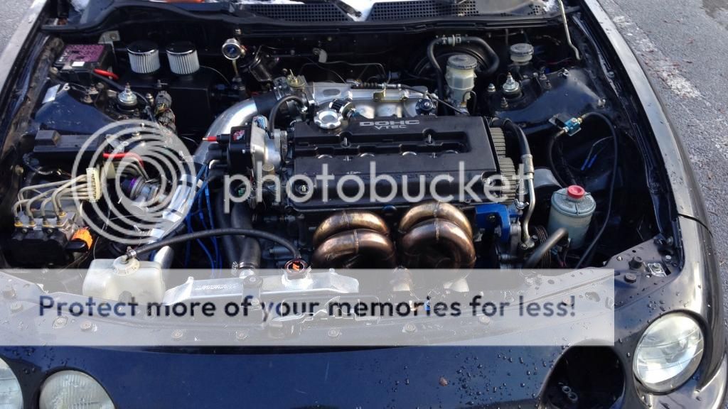

Re: I cant feel my feet, but its done..........Finally
« Reply #53 on: February 02, 2015, 10:44:00 AM »
Fuck the cold, I cant wait to get back to the states where i will have a garage. I cant feel my feet and my hands are really dried out.
« Reply #54 on: February 02, 2015, 01:11:36 PM »
But it's  running? Way to do work and get it done!!! I've done all new brakes/lines/disk brake conversion on a my truck (64 ford) into the wee hours of the morning when it was 19° outside and I was sitting on concrete and I could feel the heat literally getting sucked out of my body.
99gsrturbo
  • Posts: 162
« Reply #55 on: February 02, 2015, 01:52:35 PM »
its been around 25 here with 10-20 mph winds, and the non stop snow wasnt really helping. It is done now i need to do some tuning and figure out why my computer isn't datalogging and my lc-2 isn't seeing the o2 sensor
