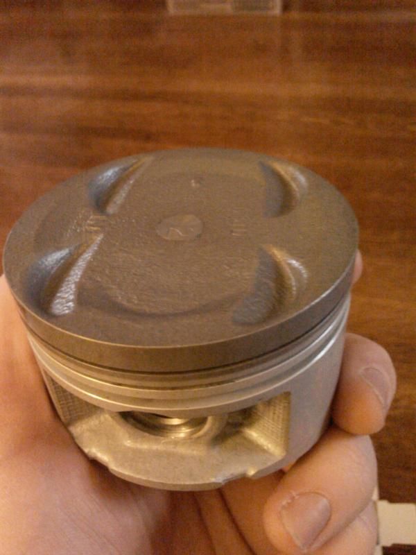

nippon b18 "turbo pistons"  aka stock ls castings with upgraded alloy 10:1 cr

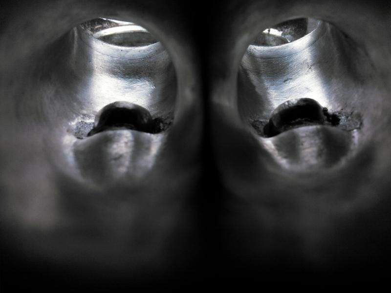

some light port work never got a pic of head all finished up

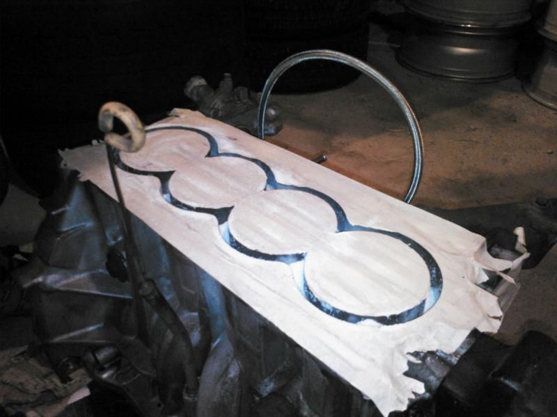

nippon turbo pistons
Filling block with salt for moroso block filler

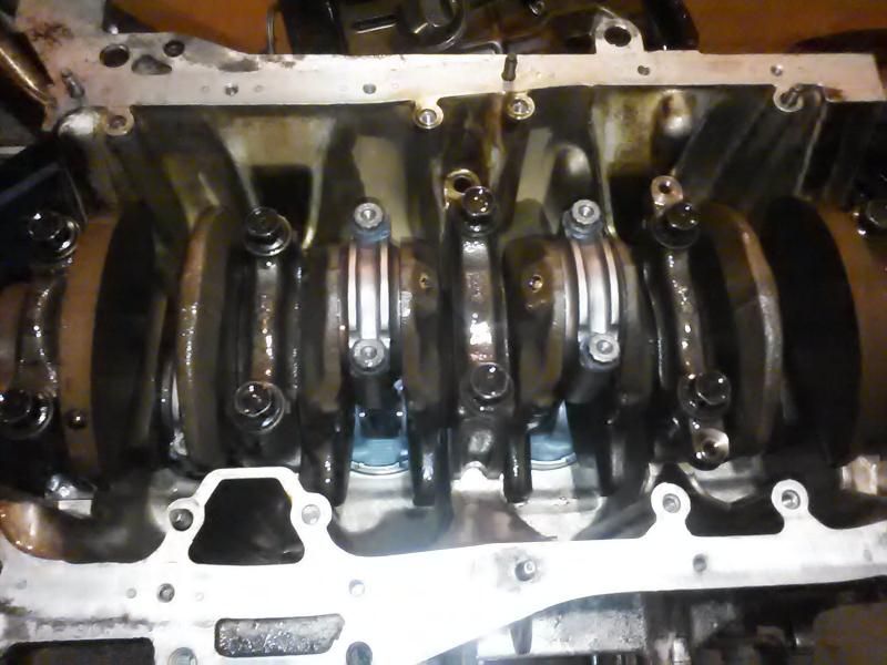

eagle rods

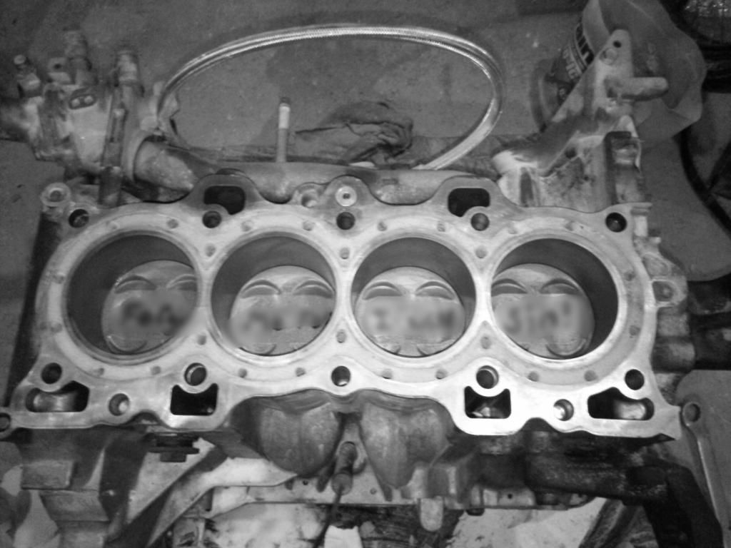

block all filled up with coolant holes drilled to match head gasket

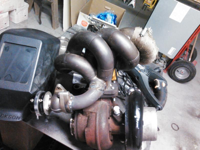

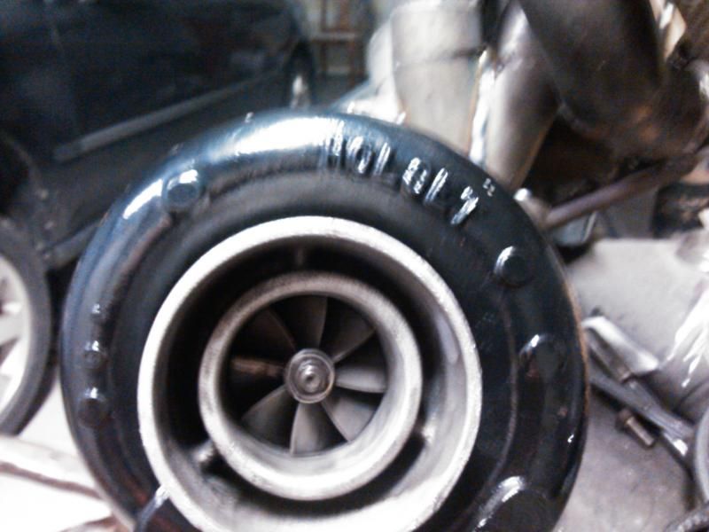

hx40 8 blade with 16cm divided t3 housing
turbo manifold

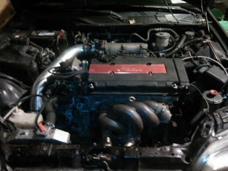

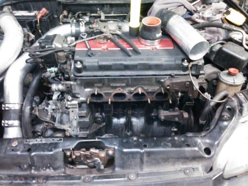

all assembled including custom radiator

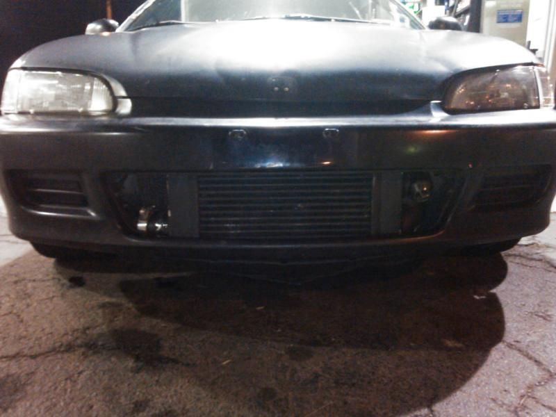

that intercooler might look small but it is huge 4.5" core was made gmc cyclone  with hks knock off bov welded to inter cooler

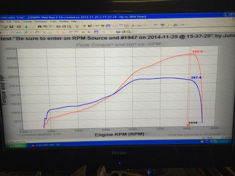

So i finally managed to scrounge up a lil cash and time to get car up on rollers and see what she makes here are results
http://youtu.be/biJDk2cmsWU?list=UUcwlILj9b0Aiu6fNAO1GHlQ
car ended up making 409 at around 15-16 psi on pump gas. after that couldn't really get it to make much more power with any changes attempted
so I tossed couple gallons of c12 into it in hopes of going up higher near 450 ish but started running into lot of ignition problems (autozone dizzy)I know i know cheap skate but it was a free new dizzy
So I gapped the plugs down to .022- .022 and then it started going lean so I think the fuel pump may have been maxed out. but all in all for the budget 419 whp aint to bad. I plan on going back in spring with hotter ignition and better fuel pump and see what it can put down.

Are those numbers corrected? Looks like it. I would like to see them uncorrected. But all in all it looks like you have a hwy screamer. How's it feel?
shanerv
  • Posts: 1153
Re: Finally got my own project up and running DYNO RESULTS IN
« Reply #16 on: December 03, 2014, 04:25:29 PM »
yes sae correction is used. was using a dyomite dyno thu far it has been one of the most accurate dyno's I have seen around.
thing is a really fun car to drive, bit laggy but for a hx40 I think it's not to bad. it's quick 1-3rd but once it's in 4th above 6k it really pulls like a freight train. only thing that sucks is that I am only able to run 2.25 exhaust on street and it really chokes it bad. I have 3" cutout for track but it's not electronic ....yet
