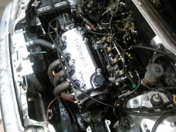

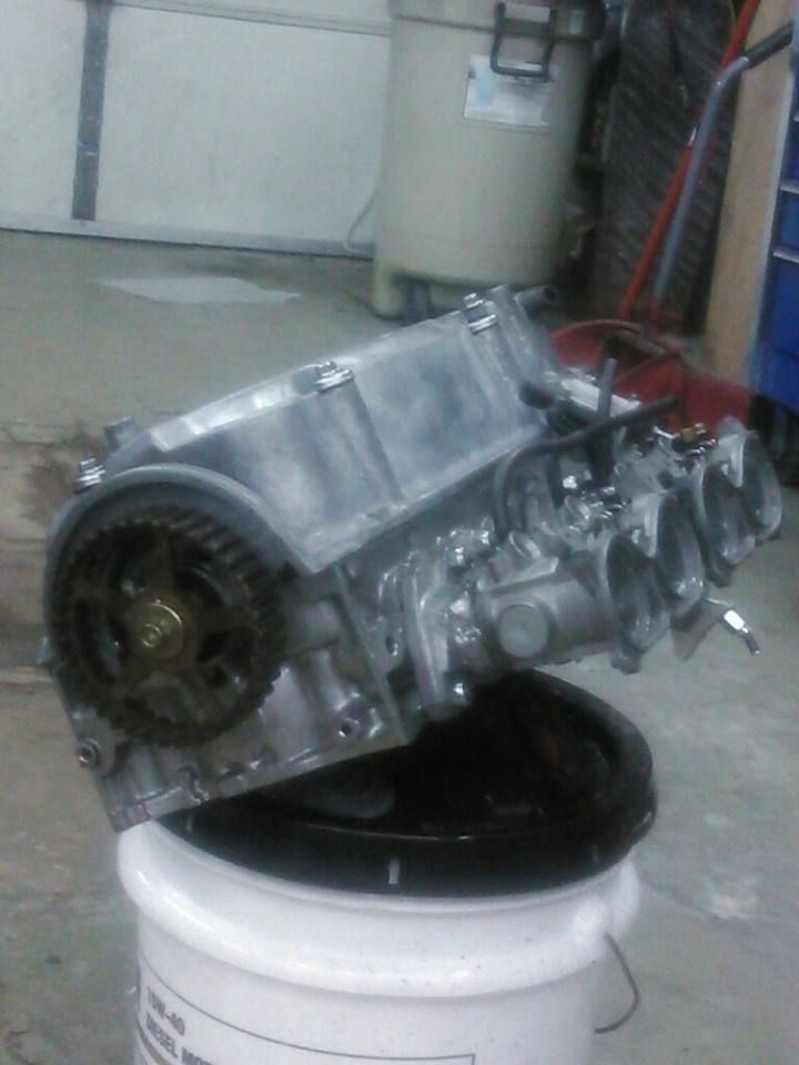

I am going to update pics when I get a chance but here is the final result on e85..
d15 block
d15 crank knife edged and balanced
Stock Pm3 pistons smoothed and oil holes radiused on the back side
d15 rods with arp bolts rehoned although it was withing a few tenths so I probabally would have been ok
Y8 head casting 14 hours of porting.
y7 valvetrain which is awesome because its aluminum rockers!!
Crower springs, stock retainers
delta 272 Y7 cam
Cbr1000 RR TB's thank you Jeff(Hiprofile) on a dpfi intake stub
Saab 365cc injectorators
Modified ebay 4-2-1 with 6" secondary instead of 6' lol
Chipped pm6 running sorta alpha-n
You guys said it would never happen but I LOVE this motor in my rex

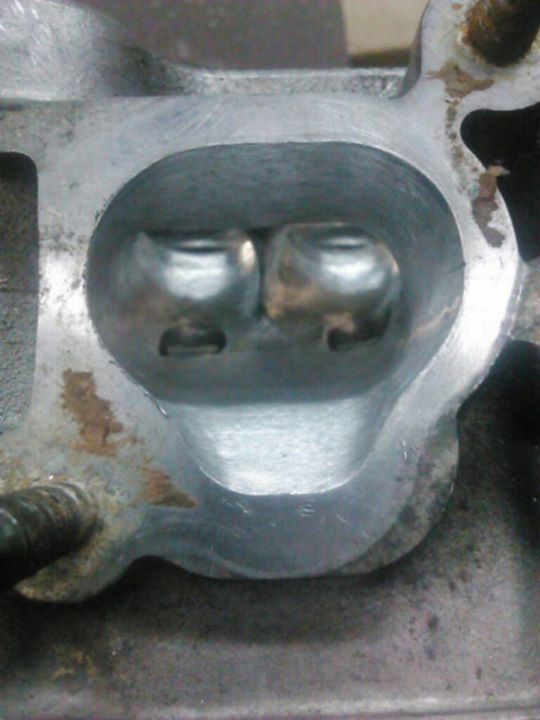

Intake port..
Pur:: SEX

That is a y8 head, what are the port dimensions?

So for an update. The motor that was in it lost a rod. Actually I believe it was a piston that let go first. It tagged the head but it was ok after a .010 skim. I just put another bottom end together in the last couple weeks and got it back in the car last night. I am hoping to make some fire tonight but we shall see what happens. I had it pretty much tuned. I ditched trying to chip tune and I am currently about to use a dynojet power commander and see if that will allow a much better degree of tuning.

I high rpmed it to the tune of 9xxx? something rpm. Thinking the wrist pin pulled out of the piston. either way I got it running today and yup put a big smile on my face to hear the thing come to life with a 1/4 point more compression. Going to get the tuning finalized and out of the way and see what happens on the dyno. either way I am hoping this motor hangs together a bit better.
