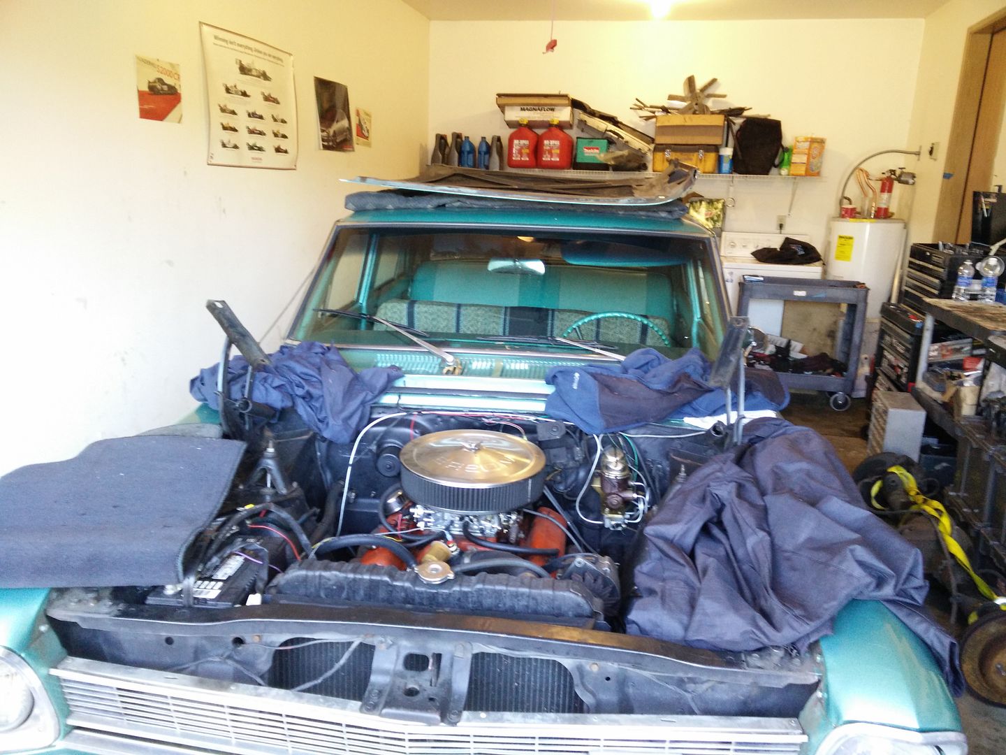

took the hood off, by myself, and damn I rally feel like I have room to work now! such garbage that the factory hinges let the hood only come up like 20°... anyway. I got the bumper and most of the drivers fender off too. fighting with these bolts. only broke one so far. but some seem rusted in decent and others come out with little issue.

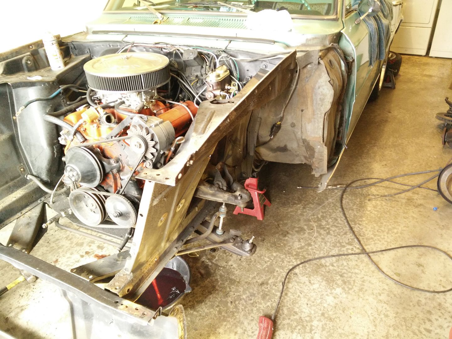

oh yeah, believe it or not i have been working on this.
the 'easy' side. kind of a bitch i gotta say. i dont think this side had been off the car before. the other side has for sure. and was a bitch. some of the bolts wernt right. hell one was metric (had to grab a 10mm). some stuff was stuck/tight, others not seated but rusted/stuck. had one bolt break on that side, and had to cut one off.
space is limited, got stuff in the trunk also...start throwing shit inside next...
as far as rust goes, doesnt look like anything. rustiest spot is around the bumper brackets bolted to the rails. super rust powder buildup (bolt broke on drivers side bumper bracket). only spot of concern is a shotty repair job done previously.
moving along...
not nearly as much as i thought... knocked some more loose later tho.
liberated  ;DDD   btw some asscock (GM) put a bunch of industrial rivets in the bottom of the core support/suspension. didnt they know we where going to race these things out? lol.
pulled the brakes, PS ram/linkage shit, springs, really anything that looked like i could unbolt it semi easily. need to make the front end lighter for later when i take it off and cut it up.
oh and be sure to label all your hardware...
need to make sure you put it back in the right spot later...  ::)

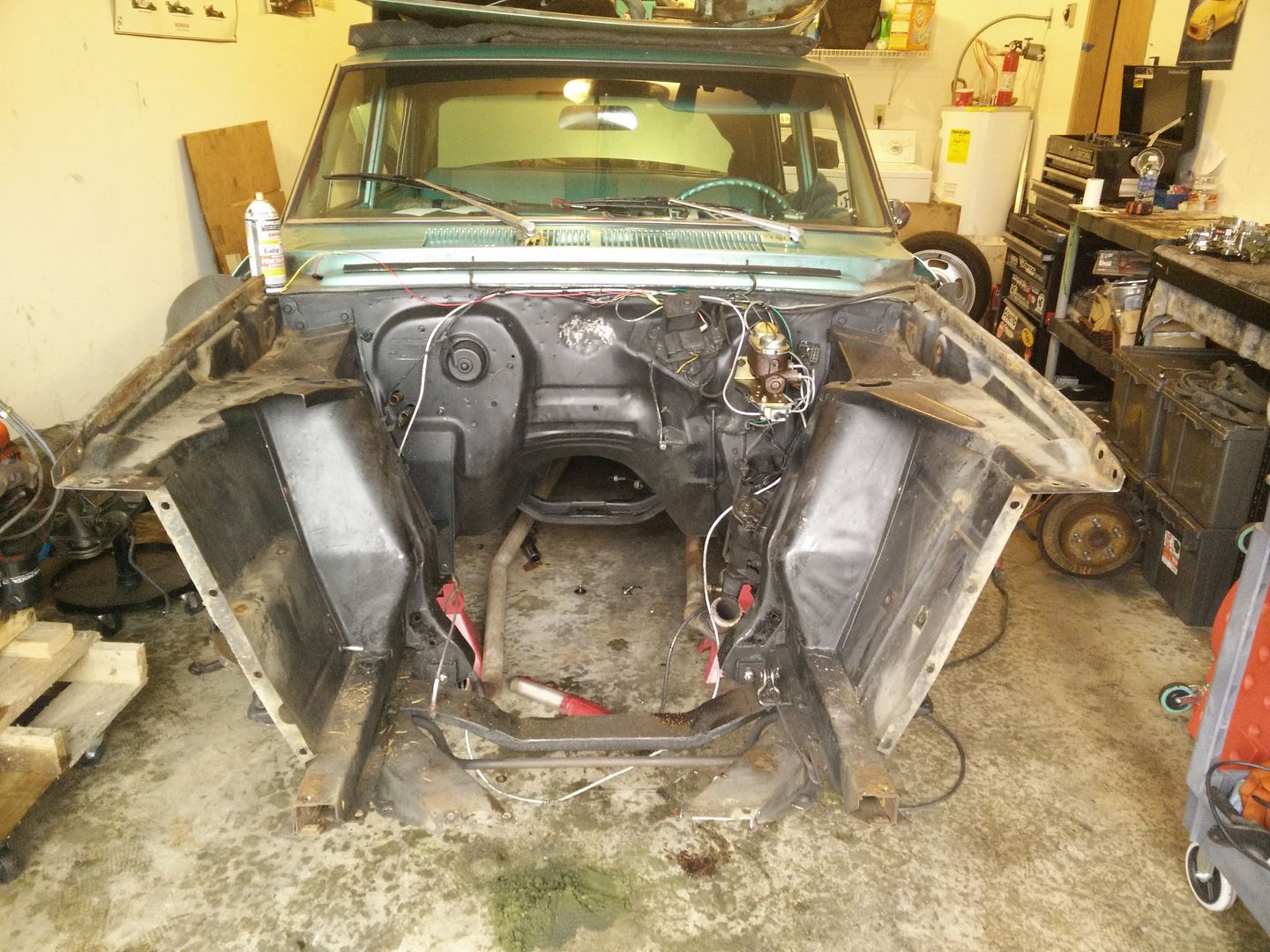

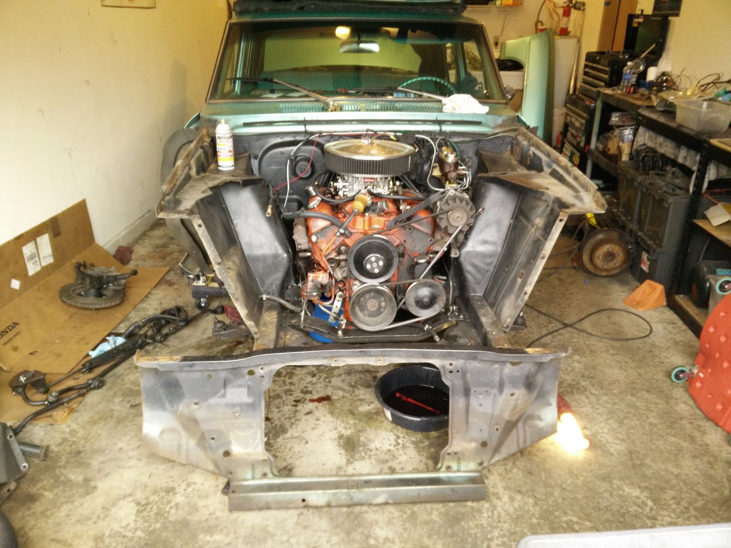

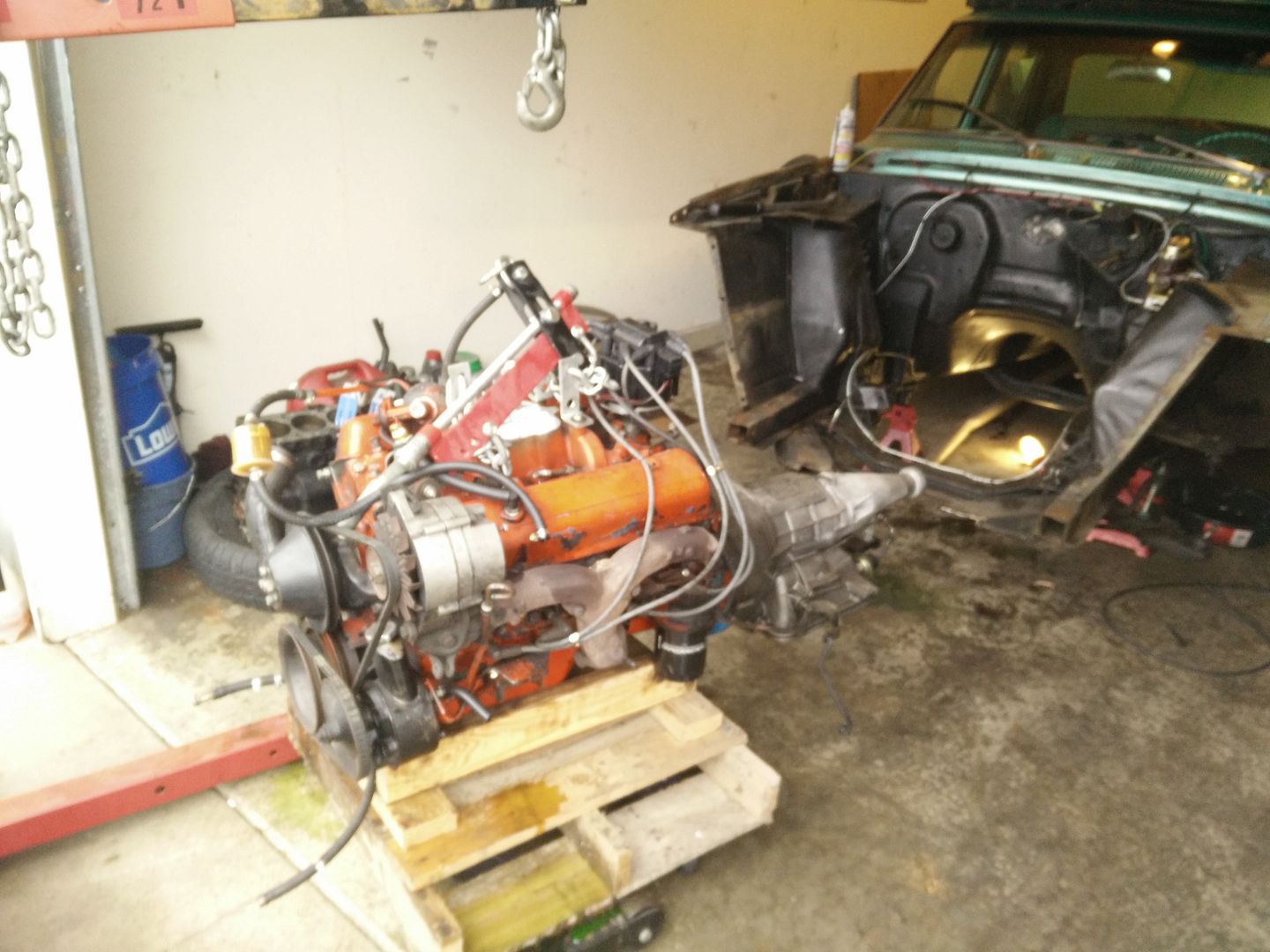

went threw and unhooked a bunch more shit. unbolted the trans. got a couple driveshaft bolts out before i gave up and had to jack the car up a bit to get under it. pulled the driveshaft. unbolted the exhaust...
i have had that engine leveler thing for like 15years i think. i think that we tried to use it once? i usually just hook a chain to both sides of a engine/trans swap in a transverse car, offset the hook to the chain and yank. figured this would be a good time to try it.
got pissed as i couldnt find lift points i liked, cant reach the back of the head where there are bolt holes im sure. and figured i have seen many people use the carb plate to lift, so why not?
funny thing was my landlord comes by. he is a car guy too, has never seemed to care about me doing this shit. makes some comments/jokes and moves on usually. i ask him about this, he says "you wouldnt think so, but its fine [shrugged shoulders]" lol.. ok.
oh yeah. speedo cable and aftermarket coolant/oil pressure.... you should remove those.  ::)  actually it was easier to remove the oil pressure and coolant gauges once the engine was pulled out a bit. both are in bitch spots.
neighbor was over at the end of last weeks work, suggested that engine stand he got with a crate motor, works champ, even with the PG hanging off the back. tucked the whole thing away for later.
still have room...trying to use my space wisely.
stripped off most everything. lower arms are still there as they suck to remove (lazy). pulled the fuel/brake lines all out the way. just the steering box left i think.
havent decided on the steering box yet. probably just sawzall threw the thing to leave as much shaft as possible yet still drop the box to the garbage? i am going to be using the stock steering column for this project.
someone left this pretty little dent for me. looks like it was needed to clear the HEI distributor unit. i will need to smooth that and make it more presentable....

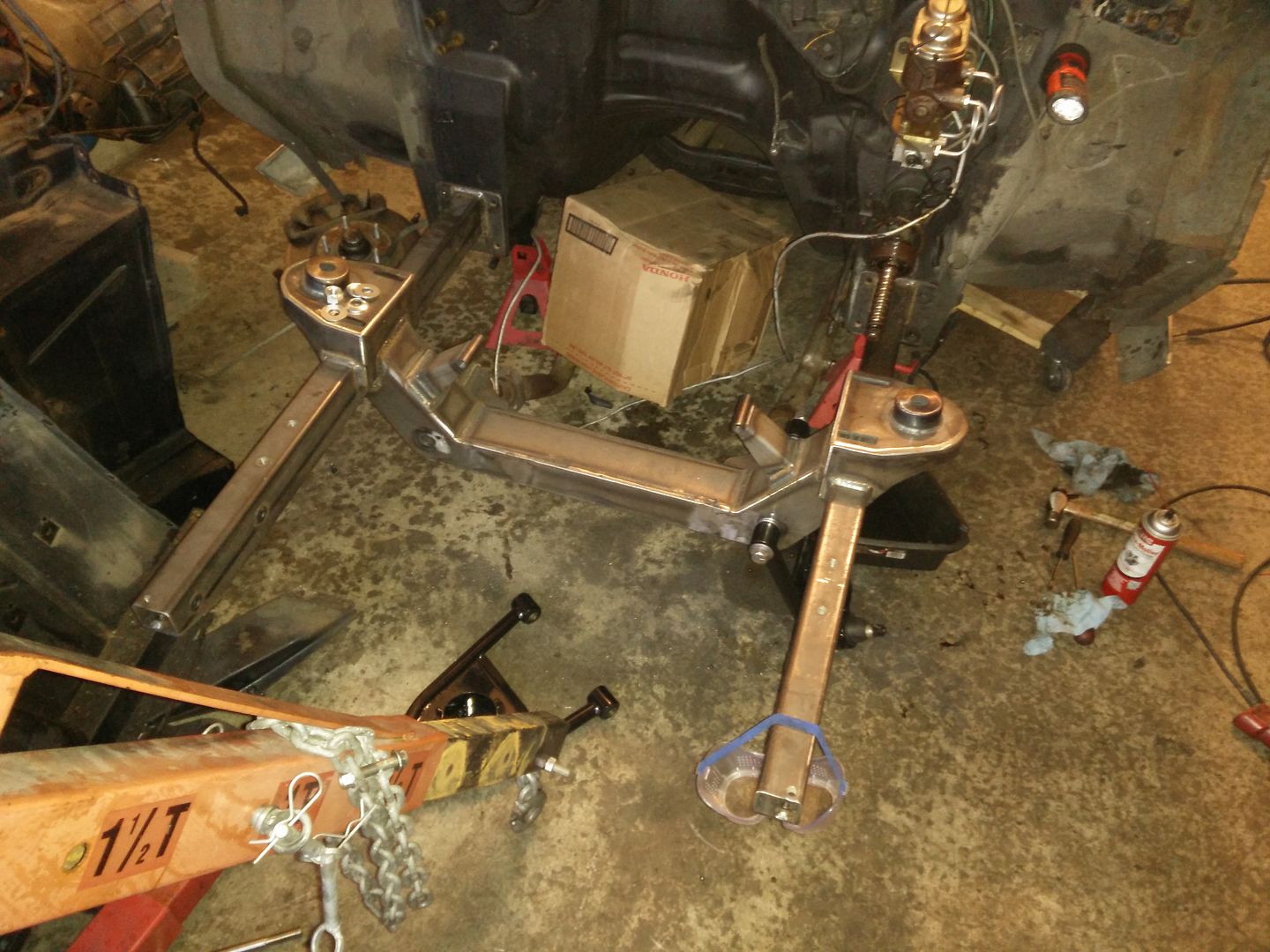

did work, not many pics...
for sale lol. seriously, make offer im throwing them away saturday.
little test fit, see how thing are going. oh and cut off rack tabs that are angled wrong.
narrowed the lower control arm mount to get lower arm all test fitted. i assume thats the left arm, they arnt marked.
thats as far as i got mangling the steering gear box...  :o
