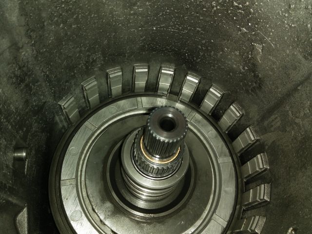

got the bushing that i fucked up in the tailshaft housing replaced.

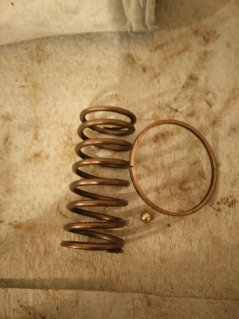

cleaned the shit out of the transmission and started playing with that crap. putting the trans back together is a bitch. you need to assemble most the shaft then drop it into the case. its heavy, and no good way to hold onto it. and in fucking around with all this i seem to have manged to break the sprag. or it was just junk and i was trying to hold on. idk. damn bearings keep falling out. i gave up.
so ordering a sprag.
most this other shit looks like ill have it here before the weekend. so maybe ill get some heads on the motor this weekend.

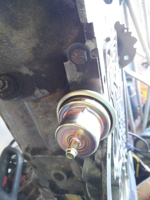

Re: 1966 Chevy Nova mordor project... aluminum LS6/TH400...
« Reply #303 on: May 27, 2016, 10:41:39 PM »
PARTS!!!

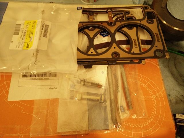

GM Performance LS1/6 headgaskets, couple headbolts i was missing to make a set (motor came with most of a new set), and oil passage plug i buggered up. also not pictured is the sprag for the trans, just OE style replacement, no fancy 34 sprag whatever thing. $13shipped off ebay lol.
and a little win before the weekend
not sure you can tell but the clip is in, and holding that shit down! abvouisly i got the new sprag in there, and hopefully the trans is together the right way so i dont have to pull it back out and try again. lol.
thats it for now. ill probably finish engine/trans work sunday/monday when im off.

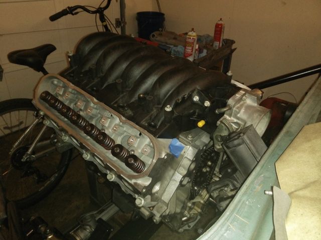

« Reply #304 on: May 30, 2016, 04:29:46 AM »
MINT  :noel:
looks like i forgot to take a pic of where i left off, so here she is tucked away for the night.
threw the intake on to feel like more of a win. still need to clean the valve covers out really good, and put the pushrods/rockers in on the right side.

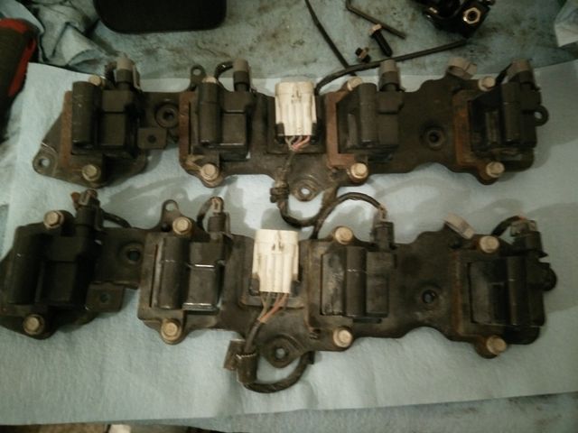

coils - seem to go for around $80-100...would like to find some for like 60

ones that work, and bolt to my valve covers.  ::)  ok, havent done much research on that. lol

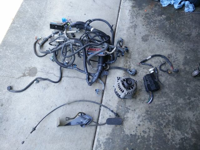

went to the junkyard this morning. lots of win, and fail...
so, lets see what we have:

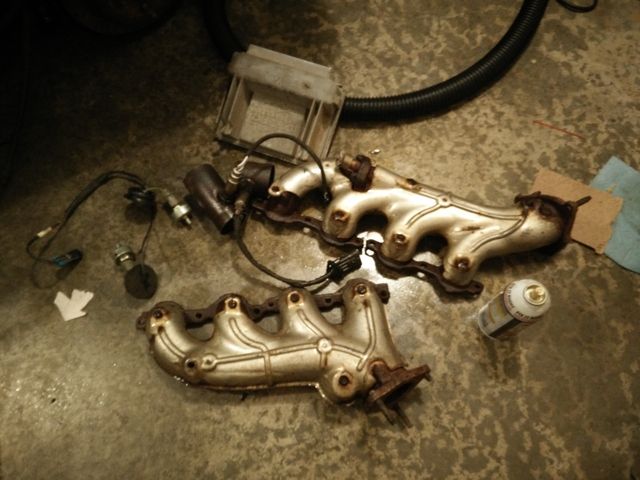

-complete, uncut, was just sitting lonely in the engine bay of 2000 Silverado 5.3... and was the ONLY thing really still there worth a damn.
-throttle cable from the silverado. think it should work.
-throttle pedal from S10 Blazer. think i remembered denmah/Matt saying he used one on something and it was easy enough
-relay box from round body Taurus
-air temp sensor w/pigtail off Blazer
-turn signal plug off the Silverado (to maybe replace my burnt one in my Silverado, if i ever get around to it)
-alternator plug, and ~12" of battery lead off that.
total: $48.97 (with 9.something assrape sales tax) plus like $6 back if i can find the junk Galant alternator to return for core.
phone says i walked 1.21miles. damn.
the fail:
still no power steering pump
didnt look to hard for electric fan

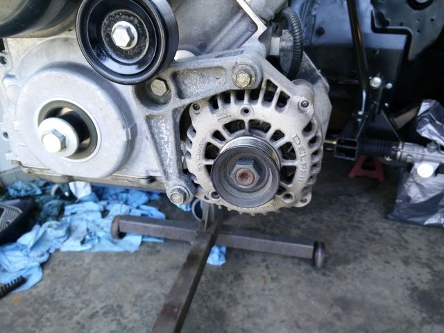

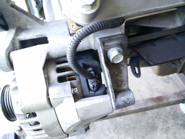

that alternator is from a 2000 S10 Blazer 4.3L... and as you can see it fits 100% perfect. good plug location. uses all bolts, hell even uses the extra bracket on the back (i had it, so why not). its a 100amp alternator (vs the 102 of Camaro), and this one tested mint at 14.69v at autoparts store. and they are all over the junkyard. S10/Astro/Blazer 99-01 it looks like are same.
there you go. solid TECH/INFO. i swore i seen someone say they used one, and in lots of searching i seen one guy with one mounted.

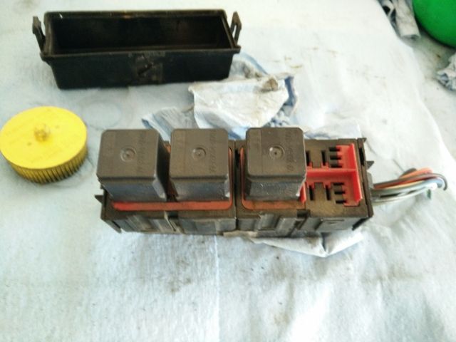

relay box. again, seen someone on ls1tech talking about these. should work great for fan/pump/ign in my new harness.

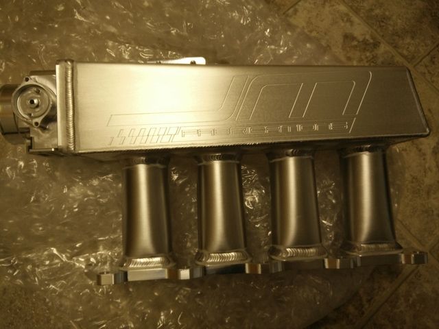

speaking of turbo
im just gonna put these right here... these are some Delphi 50lbs injectors that where in a box that came with my motor crap.

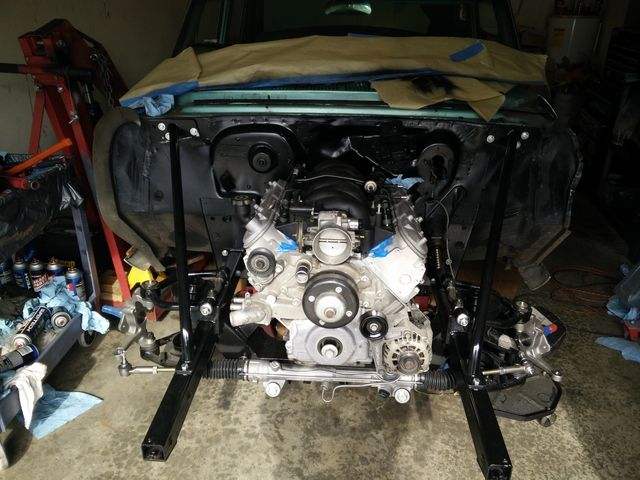

little test fit of all the accessories. i still need a timing cover gasket before i torque all this down final.

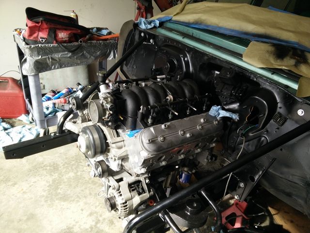

ok, so i had to see it in the car...

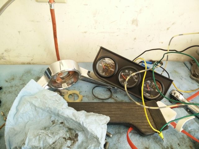

ok this weeks mid weekend update (i have sun-tue off)...
went to the junkyard again

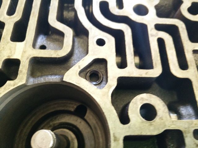

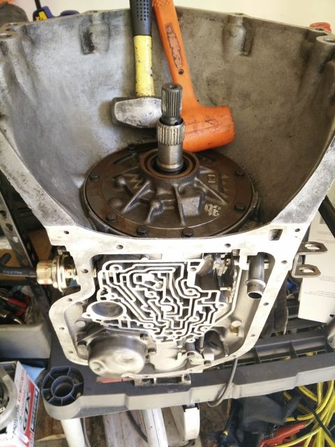

got a bunch of misc crap. some TH400 (it might have been a 350? whatever) linkages/brackets/hardware i needed. handful of OEM plastic EFI fuel hoses i hope to make work. what else? oh, a mild sun burn.

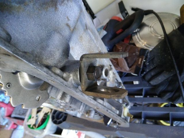

modulator bracket i got at the JY, cleaned up, installed mod. then took back off and lost the fuckin bracket. awesome. anyway these seem to be difficult to find for some reason?
shifter arm bracket thing. whatever, mine was missing.
tapping this sucked. taping holes in things isnt for me lol. going slow, precision, etc. bah.
transmission how i left it. waiting for a plug i should have ordered weeks ago. to plug of some feed something. internet told me to do it.
also ordered a new oil pan. so i guess im waiting for that also. but i can bolt the valve body on tomorrow at least.

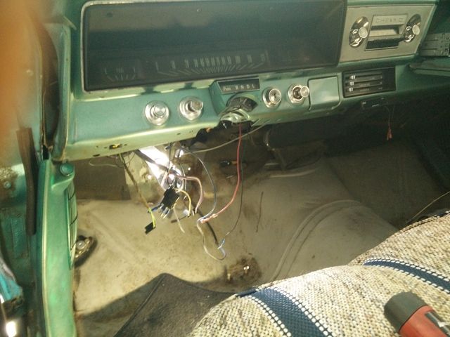

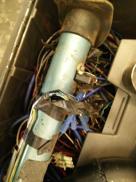

this is cool. looked like one wasnt connected when i went to pull the column. and another ripped out.
more room now... but i pulled the column to make mods to it so it will work with aftermarket/mustang front end stuff. but sure will help not having it there to fab up a gas pedal.
pile of junk thats probably not going back in. 90* sweep gauges are junk.

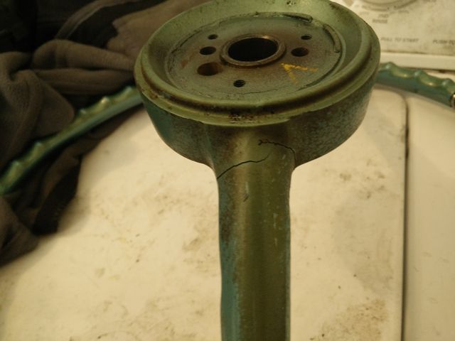

oh, thats cool. steering wheel with cracks in it. along with the horn ring thats broken, this wont be going back in either.
or the broken parking brake thats not pictured.
at least the floor is solid...
found this when i pulled the stock gas pedal. after vacuuming, and poking it with a screw driver. anyway. ill throw some sound deadner over this soon, and the problem will be solved.
looks like im out of pictures.
ordered a couple parts that wont help the big picture, think i came up with a fueling solution. still have 3-10k in parts to order/fab/install, so stay tuned!

So I guess from what I've read that the 68 and newer nova pedals Bolt right in to the factory spots on the firewall of the gen 1 and 2 novas. Then you just poke a hole in your firewall and run the cable in. Gonna check into that once I get to that point with mine.
BTW, local hardware stores and my local napa carry cup plugs for the valve body. And it wasn't the size that Jake said in his write up. It was a different size. Go back to my thread where I was molding the valve body. I wrote down the Dorman number. Think it's 005 or 006 or something like that.

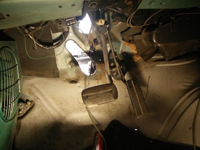

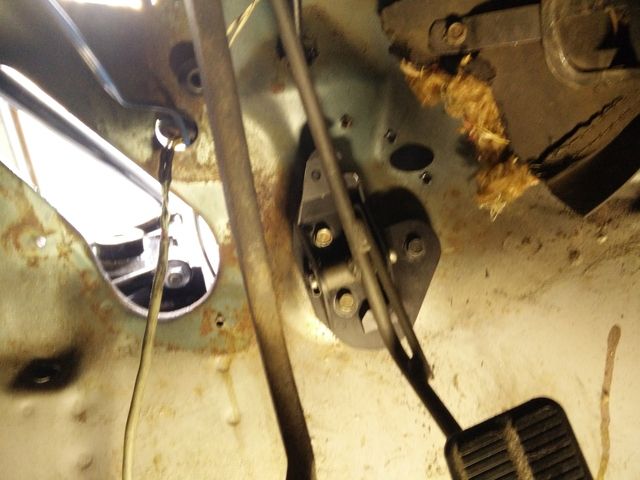

throttle pedal...
tried a couple different things. S10 pedal, Venture pedal...dug the stock pedal linkage shit out stared at it. got ideas. threw that halfass back in. held all them up to it. mmm.
cut the S10 pedal up some. i think i can make it work almost stock style (more 68+ or lokar). shaft is the same size. etc. then im looking at the venture one after i had taken it part to cut up. throw it back together...
i got slightly creative. but mostly how GM made the pedal. i shimmed out the mounting holes to the firewall, ground the pedal arm for more pad (still needs little more). cable needs a little shimming also, like the piece i broke at the JY  ::)

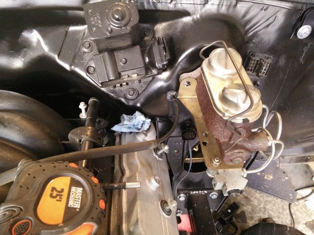

dont think im going to be running a booster with this setup lol.

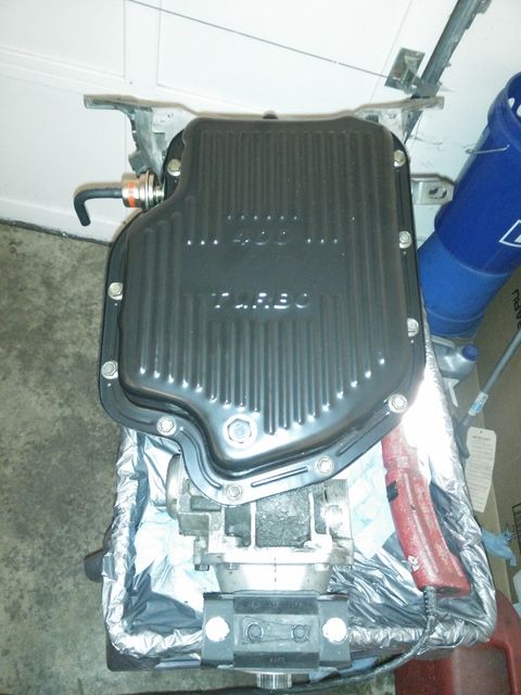

transmission is together!
now lets hope the damn thing works LOL. as you can see i bought a brand new oil pan w/drain. black of course, dont line shiny. think its all together. all the brackets, mount, etc. just needs a converter, lines, yoke...?
oh yeah, is there, or should i buy some magnets to throw in the bottom of this pan?
and the left over parts...
some gaskets and orings also....and a whole bag of orings that never made it into the trans lol. not sure where they went, but i think i replaced them when i noticed.
it does have new:
oe style sprag
pump oring
pump gasket
shift shaft seal
valve body gaskets
rear housing gasket
rear housing seal
rear housing bushing
oil filter, gasket, pan.
Jakes free mods.
so i think my total is around $250 into this transmission.

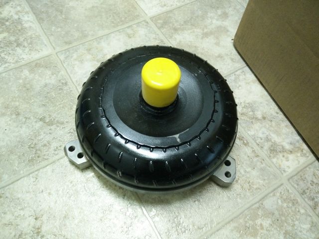

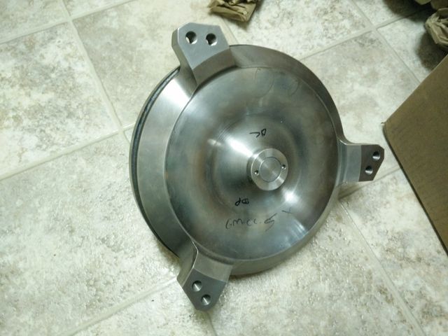

talked to Josh @Jake's. he ran me threw it all. spent a bit of money, but whatever.
~3500 rpm stall (at 600hp)
billet cover
tig welded fins
anti balloon plate
9.5"
etc.
think he said 550 (might have been 650) + 30 shipping.  :o  not very jew. but also from what i have read, going to be worth it. from what i have noticed most seem to spend between 550-750 for same billet goodness, 900+ for triple billet racing ballerness.

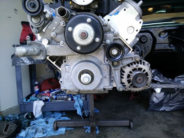

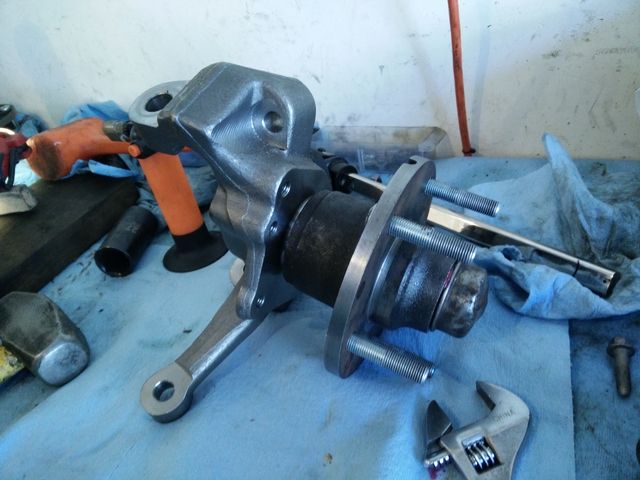

« Reply #325 on: June 20, 2016, 09:25:51 PM »
little update here, probably wont get much work done this weekend as im sick.
i did do a couple small things to the motor. put the front and rear covers, accessory drive, etc.

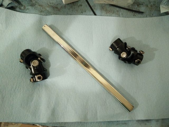

steering linkage stuff. ordered a 12" DD shaft, looks like it needs to be about 8.5" or so, probably needs a couple more test fits before any cutting.
i got coils. they are truck coils i think. fuel lines need a little tweak to clear, no big deal.
my converter showed up from Jake's Performance also:
:D
billet cover
tig welded fins
anti balloon plate
245mm/9.5" core
etc.
 :Jew:

truck (aka turbo) manifolds w/EGR. not first choice, but got hooked up with deals.
O2 sensors
knock sensors
00'ish ECU.... from the looks of it it can be OS updated to 01+? to run the 3bar, fans, etc.??
got all that for like $90 shipped.

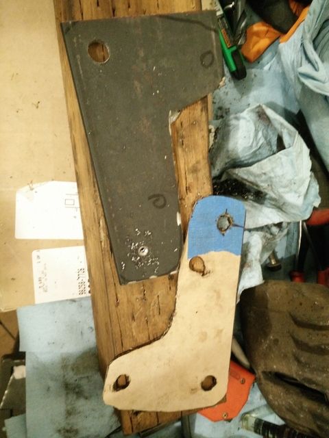

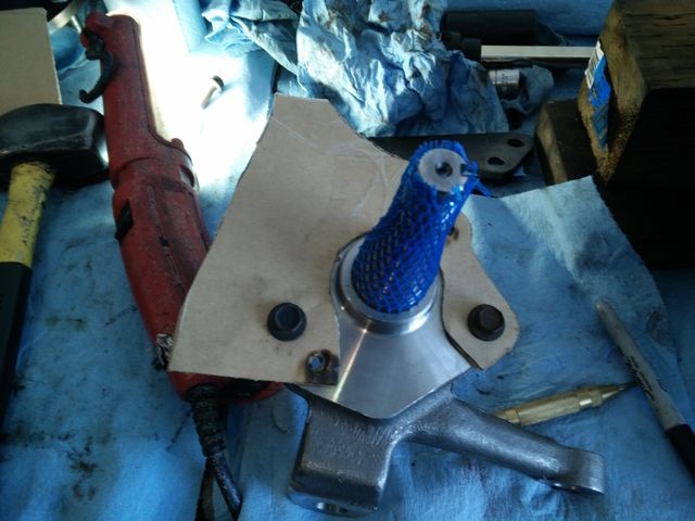

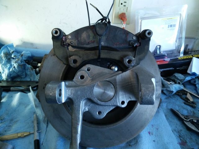

ok...so ill need to dig out some info here because someone asked about this....
this is:
MustangII drop spindle.
65'ish Nova front DRUM brake hub, turned down to fit into 98+ Camaro 12" brake rotor, and some extended Dorman studs (forgot the part number, but easy search)
Speedway wheel bearing kit for GM 11" rotors to MII spindles... should be this ~> http://www.speedwaymotors.com/Bearing-Seal-Kit-GM-11-Inch-Brakes-to-Mustang-II,9814.html
part numbers on studs and specs on the drum hubs might be in my build towards the beginning, but also all over the internet.
ok, so thats the simple part. just SWAP THE RACES! and pack bearings, etc. all pounded together like it should (ok, i have never done this before. but seems like it should).
me mocking up my brakes.
yup, some zip ties holding the pads in, got a couple bolts holding the caliper bracket at ok height. etc. precision. i tried to just eye ball the caliper to the center of the back side of the spindle, quick mock on the car shows to have a ton of steering angle before caliper bolt hits the lower arm. and even then im running 215's up front, sure they will hit the rail first.
helpful tip, only assemble one spindle at a time ;)
making cardboard caliper brackets on the other side spindle.
trimmed down. all super ghetto. anyway. trimming it down to this L shape also helped me to only use one piece of 4x12" steel plate. so that was a bonus. also way easier to cut out. and only like 10bucks lol.
so it was hot in the garage. grinder started to sound like crap (was hot as hell), both my batteries died for drill, and i gave up right there.
btw. i have the set of caliper bracket adapters for the STOCK GM drum spindles/hubs to 98+ Camaro brackets for sale. only bolted up and driven around the block once lol.
that badass template may be for sale too when im done. gotta be worth like 100bucks+ lol....
 :Jew:

What made you go mustang deuce spindles?
How much are those brackets you are selling?
