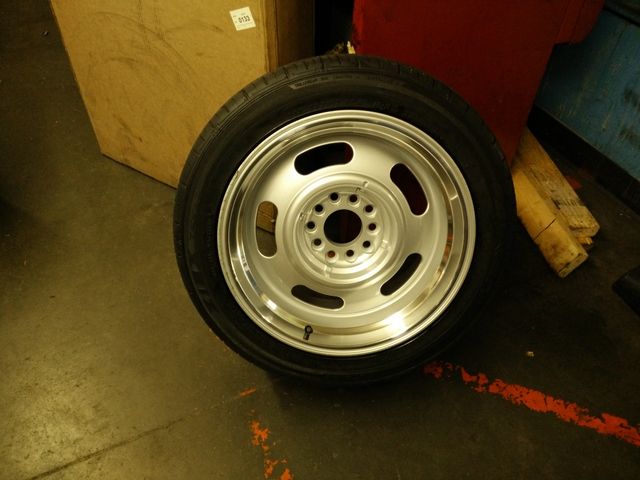

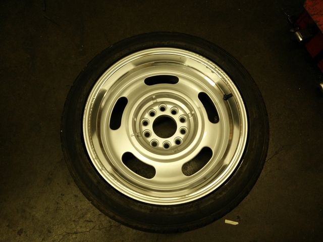

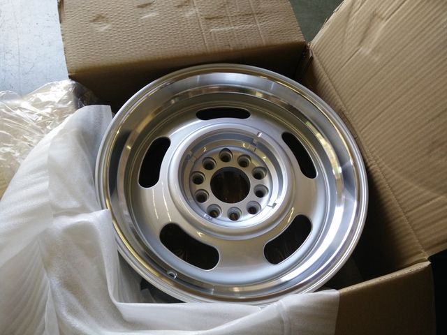

those are the wheels im looking at. 17x7 17x8, aluminum Rally wheels. REV Classic 107 Wheels to be specific. they have silver center, machined lip (no beauty rings), and "police" center caps. they dont come with caps, but i think i found some cheap ones that are stainless steel without bowtie, so i can hit them with green/red scotchbrite and give them a nice bushed finish... i dont like shiny things so much. i know, muscle car guys love there polished/chome shit, fuckem. i dont care.

ordered wheels and caps... now i wait...  :(

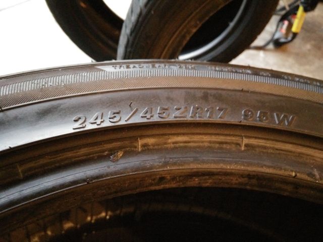

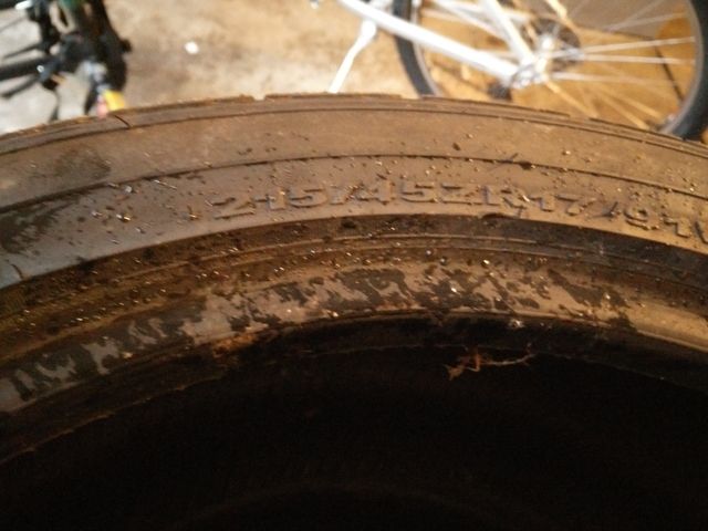

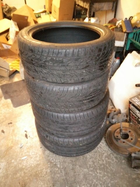

i did some searching for tires. i have a note pad filled with tire sizes, total heights, etc.
found these on CL...
215-45-17 and 245-45-17
hope the rears fit... but even if they dont i got mad  :Jew: dealz... lol.. $40... in total, for all 4.  :Jew:

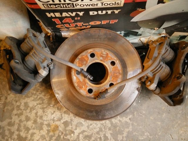

also went to the JY over the weekend cuz AJ has been talking brakes.
got me some 12" dual piston 98-01 Camaro brakes... like $60 for all that.

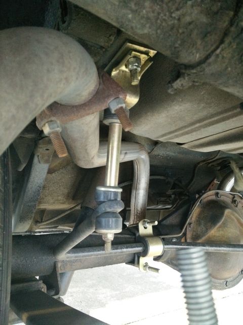

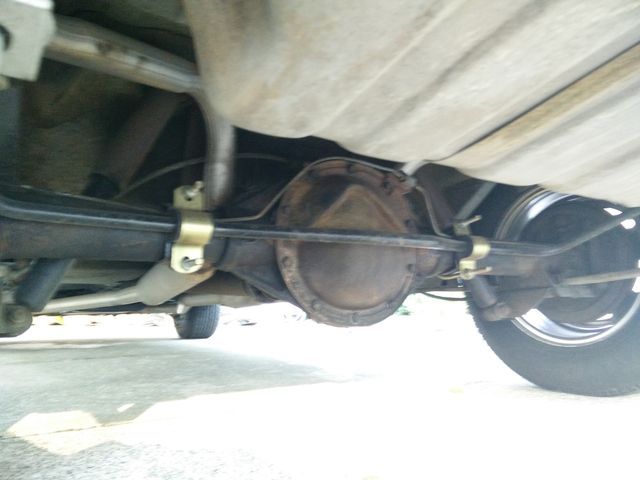

so i was looking under the Nova to see what the tires have to compete against. well there is fuckloads of room in the fenders it looks like. i think i can go way lower, and wider both ways on the tires, as long as they are low pros with little sidewall flex. plus the rear fender lips look to be made of tin can thin metal, so shouldnt have a probably rolling them for another 10-12mm.
also while i was under there i took a good look (and pics):
looks like some kind of aftermarket sway bar. i didnt notice any markings. kid i got the car from told me surprisingly little about the car...

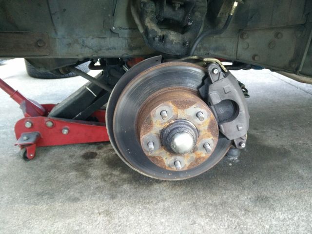

ok, so here is the front disc conversion the last owner did.
looks like metric calipers and 10.5-11" rotors.

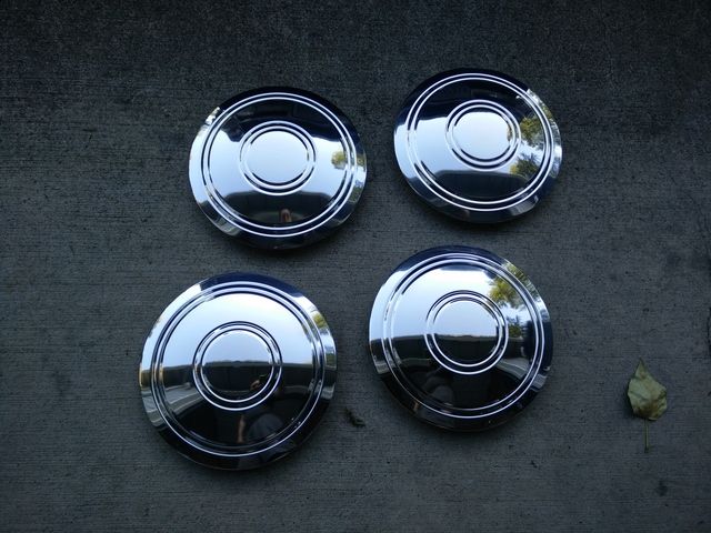

the mini moon/police caps i bought.
still think im gonna scuff them up for brushed look.

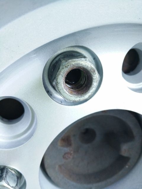

***ISSUE!***

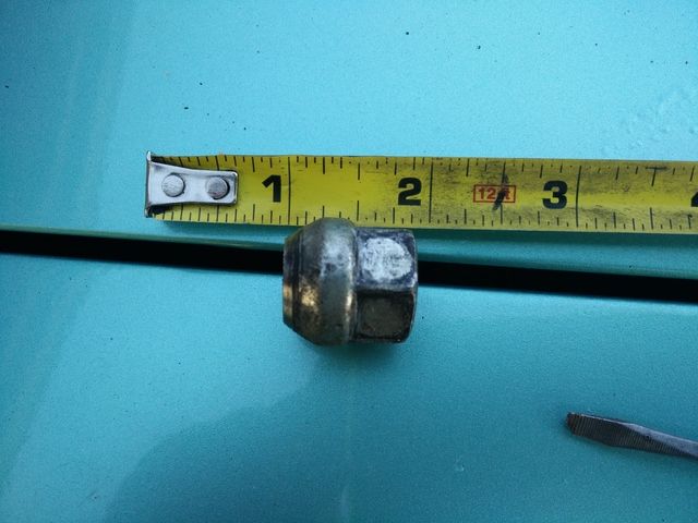

so, fronts i checked and i get 6.5-7 full turns. just a little bit wider than the width of the stud. which is about half the lug nut. rears look like about a thread less. those look easy to replace.
that legit??
Re: 1966 Chevy Nova mordor project...
« Reply #85 on: June 06, 2015, 10:29:41 AM »
Those actually look pretty good on there. I've always seen your hub caps called "poverty caps"
You need longer studs, those will kill you lol

Dont be an idiot, replace the studs.
« Reply #87 on: June 06, 2015, 01:21:24 PM »
