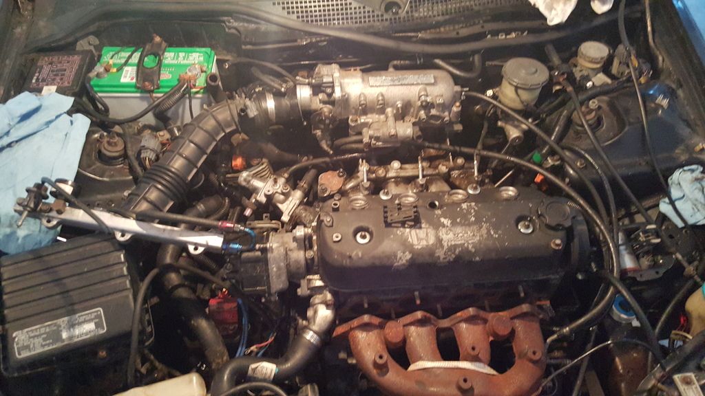

Anyway... i drove the car a couple months on the basemap beating on it, before i went to get tuned and then the head gasket took a shit during the tune. Rolling smoke clouds on the way home from the exhaust. Needless to say the car has been sitting the past 6-8 months at my parents house in there driveway. Only thing I have change exterior wise is the wheels.

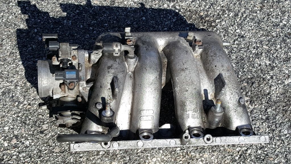

pick from the other side

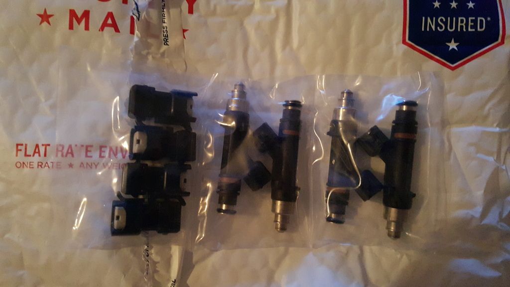

Oh yeah. I shipped my IN 800s to HiProfile for testing and cleaning. All was good.

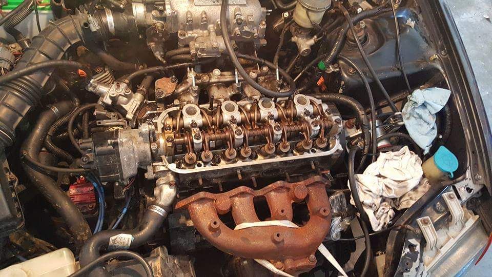

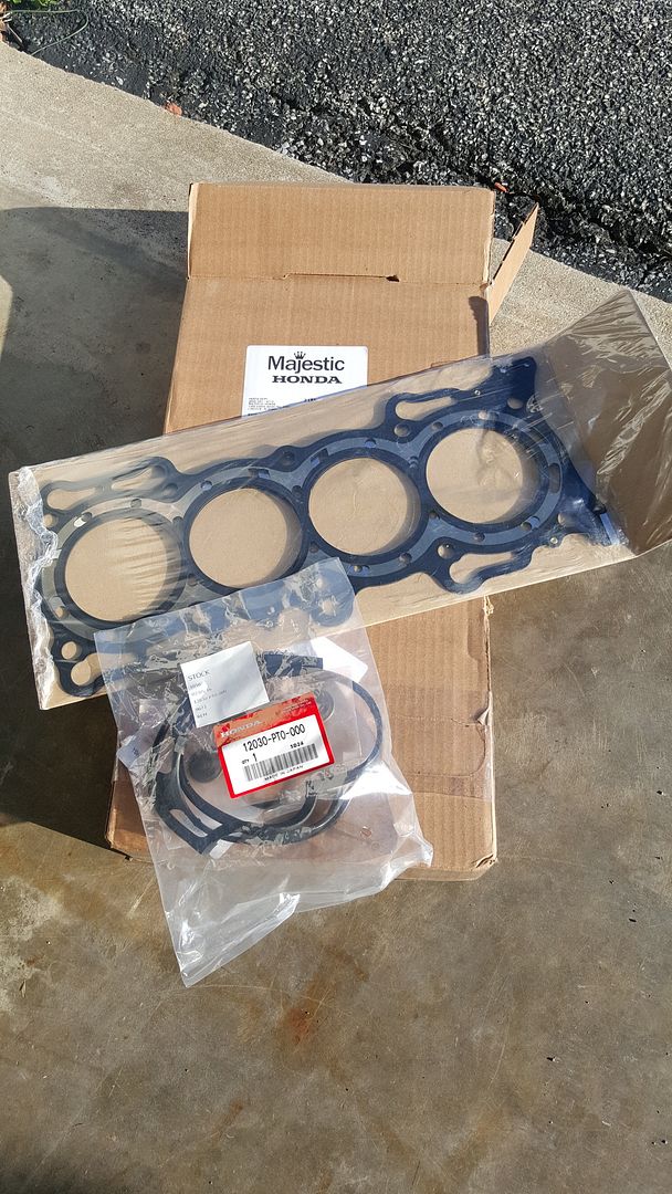

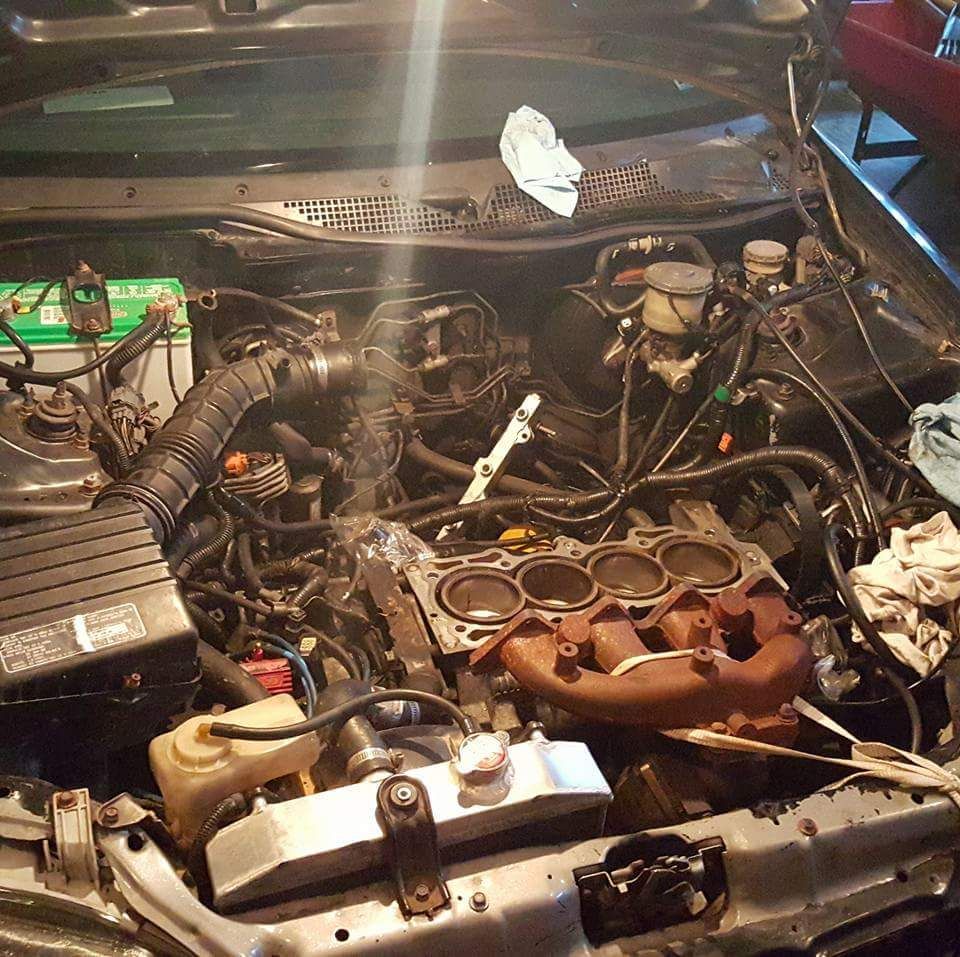

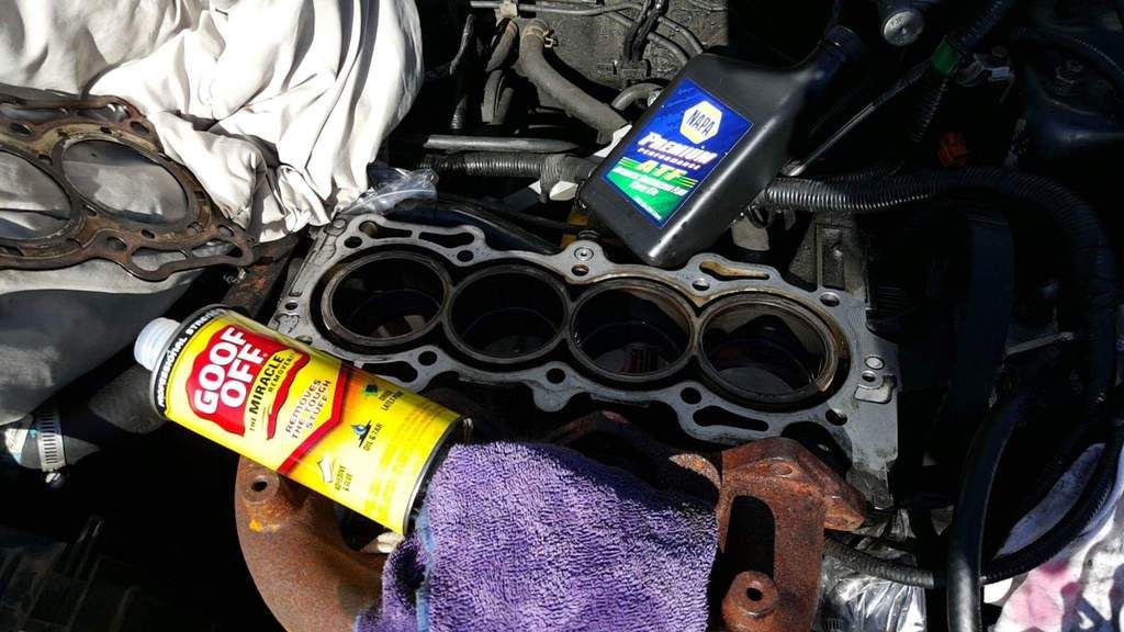

Two Weeks ago it was nice out so i finally started to tackle the car. Pulled the head and thats when I got to see the damage. So I ordered a head gasket and valve cover gasket set.

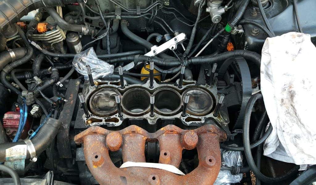

Heads off and no cracked sleeves.  O0

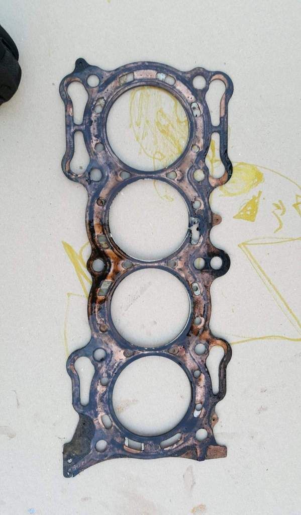

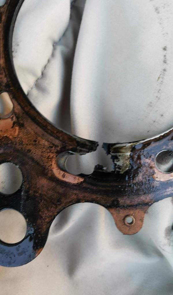

Close up of the gasket  :?:
So Friday morning i started to clean up the block deck but realized i didnt have any razor blades... Pulled the ARP studs out since they got loose when i removed the head and oil got down in the holes. So next i was using a rag and goo gone. I also put some ATF in the cylinders to loose up some of the dirt. Also i thought this would be a good way to check the cylinder rings and see how much they drain or if they dont at all.

Also friday morning i picked up my head gasket and valve cover gaskets i had being held for me. I always miss deliveries.
