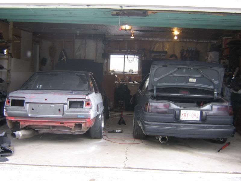

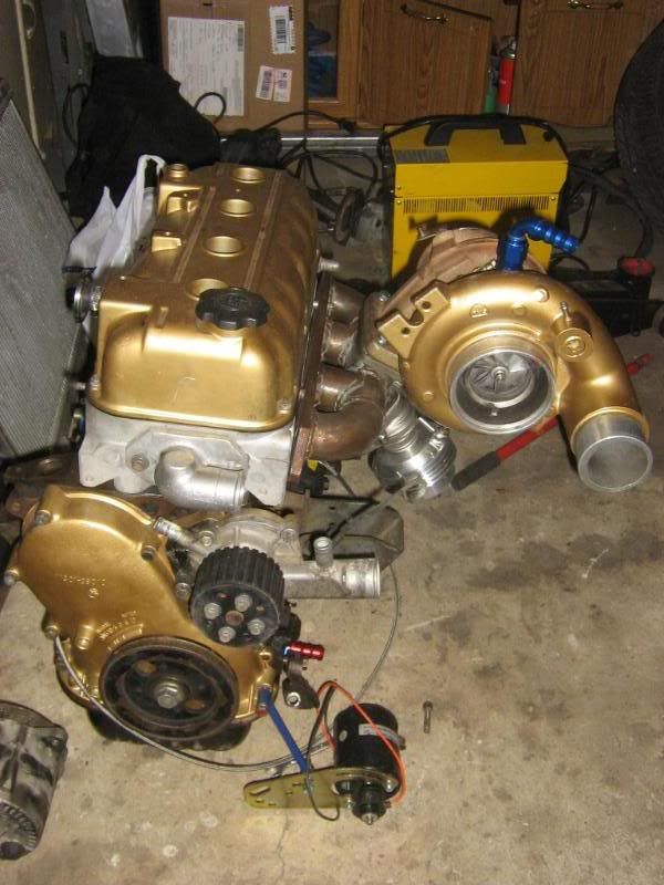

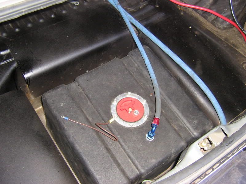

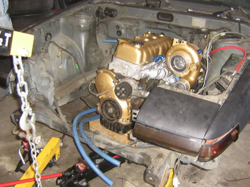

So i'm running a toyota 3tc motor, they're strong and love the boost. Decided to try using obd1, honda harness and honda dizzy and convert it to efi. Of course i am boosting it too. Made a box for fuel cell and ran the lines through the cabin. Just got going on this recently after school started so I hope she gets finished sooner than later.
this is what it used to look like, changing up the stylings now tho
peace

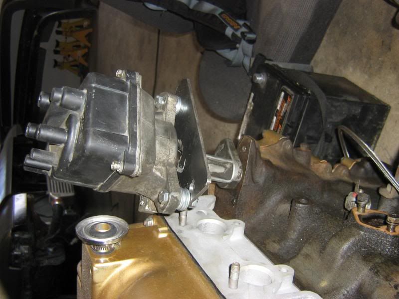

Nice work! How hard is the Honda dizzy to swap over?

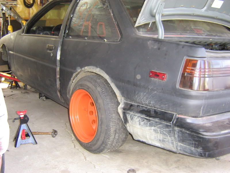

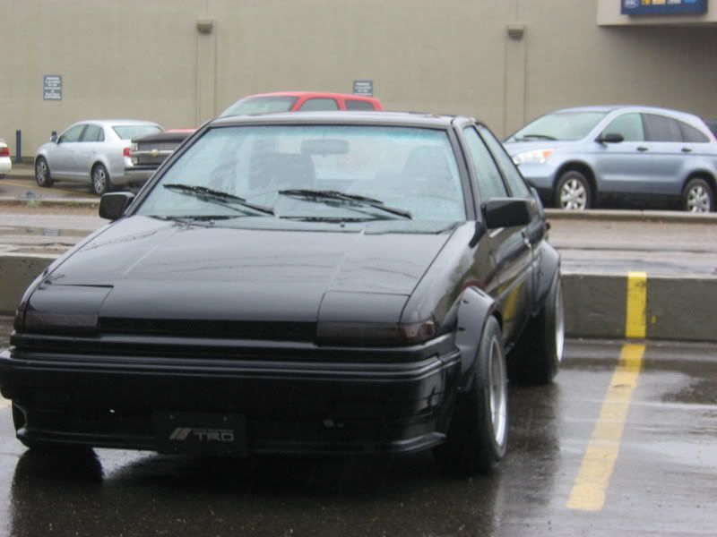

all of it looked ok untill I got to this pic. It screams I have a wide rim, and a narrow tire. That = gay

Just wait till the flares are back on, sideskirts on and dumped on it's nuts. It will look hawt!  those wheels on the back are for the front, i have 225's for the rear. 14x10 all around with 205 front and 225 rear. I'd like to get bigger wheels with lower pro and more tire later on, but this is what i have and it was very cheap, gotta make do with it and get some dope wheel fitment.
As for converting the dizzy, it wasn't really that easy, had to cut the 3tc dizzy and make an adapter for it, I might have to make it all again. We'll see how it actually works tho, no one has done it before so I have to experiment a bit.

One would think that a wider wheel is for a wider tires. Just not practical.
You wouldn't run a 4" exhaust and put a single 1.5" in/out muffler at the end.

The holset and honda ems are the only things here I like.

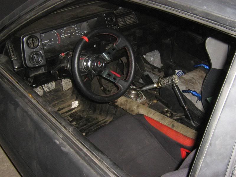

Your shifter is the supreme form of failure.  You sir are a faggot.

True that, but it's always been on an overhead cam motor where they could attach the honda dizzzy straight to the exhaust cam with a simple plate on the front. Never seen someone mate one dizzy to another and run it like that. Still not sure how it'll work out, but I thought I'd give it a shot. But ya using honda stuff to run a toyota motor is definitely not a new thing, it's worked very well in the past tho.
It'll work fine, but you are turning the rest of your car into a piece of shit.  Seriously, I could care less if it's for WRECKLESS DRIVING (what "drift" was called before weaboo faggots had to try to act like it was a fresh JDM thing, and that is didn't have it's roots in North American hotrod culture) or not, but the supposition that poke and tuck VW rimshit is going to "look hot" completely defeats the function of a pure tech site.

pretty sweet, my buddy (he was on ohmt) he stuck a d16 dizzy on a 4age and has it running. right now it is running fine on a stock civic ecu its not even chipped yet. its in an 86 hatch

Taker easy guys, I'm not just a drift whore, i do a lot of autox and track days. The fronts need a good deal of stretch to actually turn without rubbing, the rear has a good amount of tire for the size. I'll get 16's later on with bigger tires and what not, just using what i have for the moment. The shifter is just funny, but it's the only one i could find with that length, ae86 shifter sits really fucking low and i am tired of it, wanted it up close to the steering wheel.
This is good to hear about the dizzy, I've been worried that it will actually work.
I made an adapter for the honda intake to my motor today, makes things easy for wiring and vacuum placements. A lot less work than making a new intake, plus I don't have a tig welder.

i think for drifting and auto X your shifter is right about where you need it since you dont want your hand off the wheel for lond and that would be pretty quick. my friend had a donkey dick of a shifter that he had bought for auto X for his ef, looked like he would be changing stations while shifting but its made for being hight up so you can steer faster with both hands unlike straight line driving where it really doesnt matter as much. im still digging the project even tough yotas been ran on honda ems before, plus i like your style of pron. keep up the good work.
my friend was a member of ohmt but not sure if hes here yet, ill try and get a pic of his shifter and post it.
