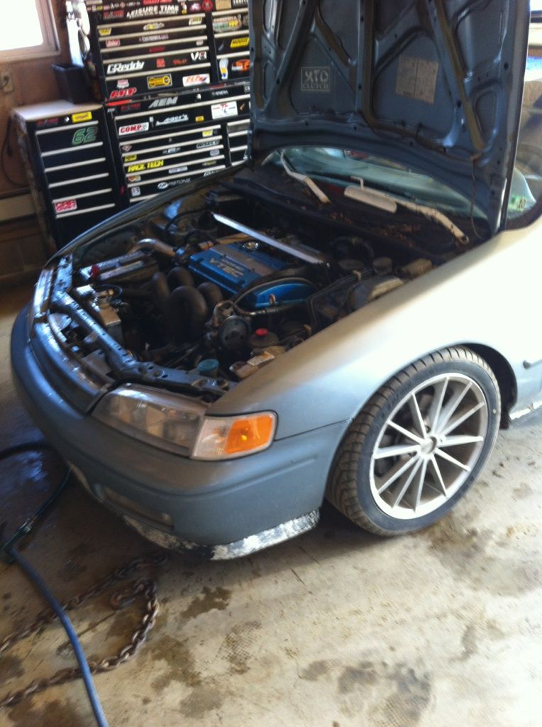

Today i felt ambitious, and decided to tackle changing the turbine housing. I got the 16cm housing on, converted my down pipe to V-band and hooked my wideband back up. i took it out for  beating and it is kinda lean, but the car runs so much better. even out of boost it is so much more responsive. Next on my list is a new CV shaft, windshield, and inspection then its off to Ohio to get a tune... hopefully some slacker gets his shit arranged so i can get this bitch tuned....

so... car has been getting a lot of love lately...
yesterday i cleaned the shit out of it, apparently a mouse, or many, took over the car this winter. it was full of "nesting" and smelled like piss.
today i put fresh 93 in it, and had a windshield installed. next move it renewing registration and inspection.
also today, took it out for beating, upped boost to 18lb, and car really came alive. got a little wheelspin at 70mph, the rough road didn't help, but its def running better than before! I like!
looking forward to strapping it to the dyno (cough*Tom*cough) soon???
