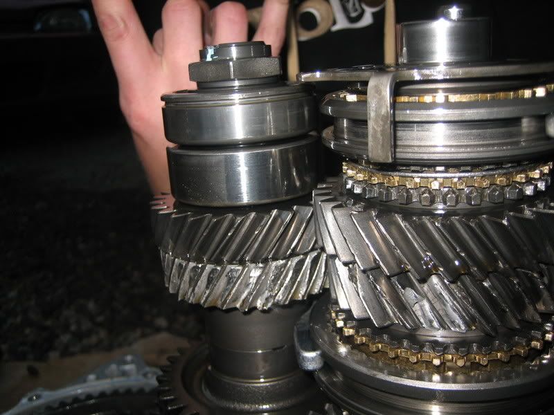

D15B LSD tranny, shifts great!!!
I have some pics of trannys that shift flawlessly too here:
d-rail
  • Posts: 1005
Re: Trans Question
« Reply #12 on: June 11, 2009, 03:36:45 AM »
Brand new slightly used.
Seriously though don't be afraid to take it apart and look at it yourself. To nerves? TAKE PICTURES!!! It's not that bad and if you have an issue like I once had you could just have some Jacked up shifter bushings or a bent shift linkage from not double checking your shit before you pulled the motor

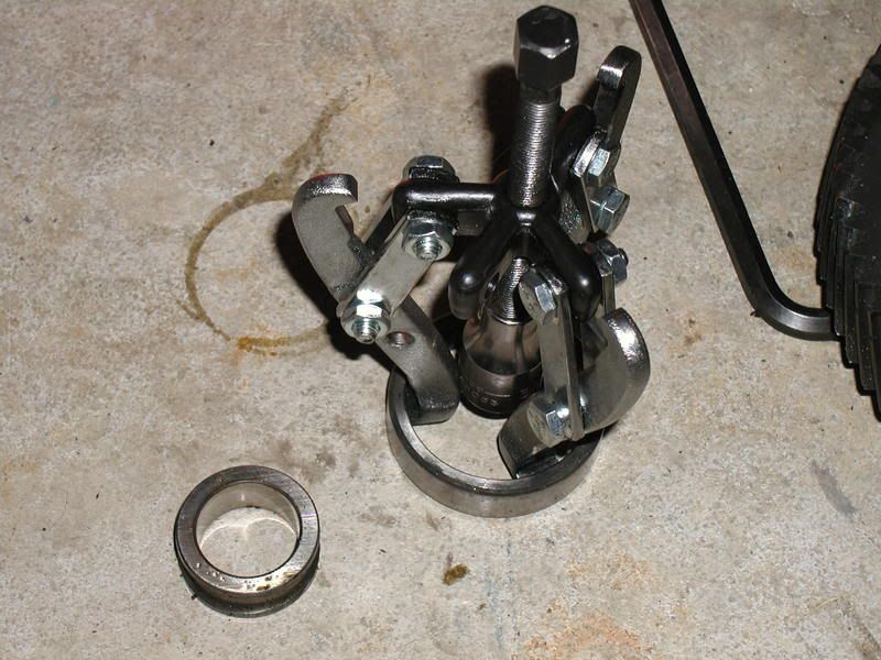

« Reply #20 on: July 15, 2009, 08:55:28 PM »
Input shaft bearing is making noise now.  Tranny is coming out this weekend.  Fuck.
Re: Trans Question Input shaft bearing going now too...
« Reply #21 on: July 16, 2009, 12:15:36 AM »
Easy work....unless the ISB has exploded, I have a long night ahead.
« Reply #22 on: July 16, 2009, 12:00:11 PM »
so what if the ISB exploded, you just have to get creative
« Reply #23 on: July 16, 2009, 05:21:36 PM »
collect your balls, rebuild the ISB, use normal puller, but I like your idea as well.

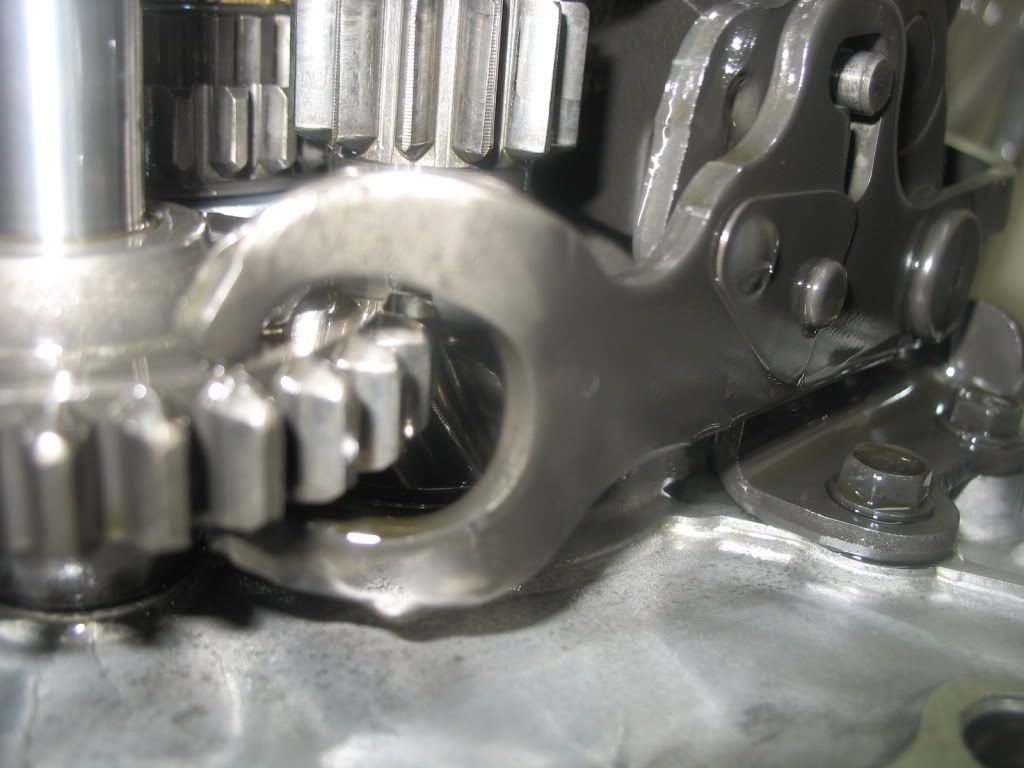

« Reply #24 on: September 20, 2009, 08:40:57 PM »

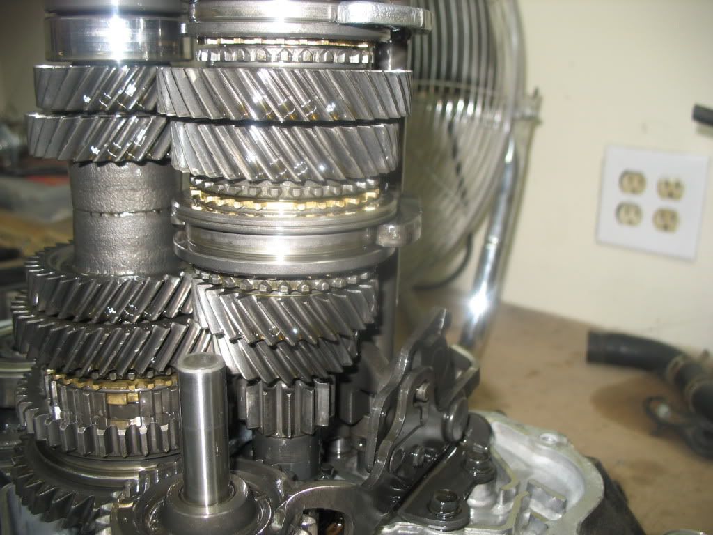

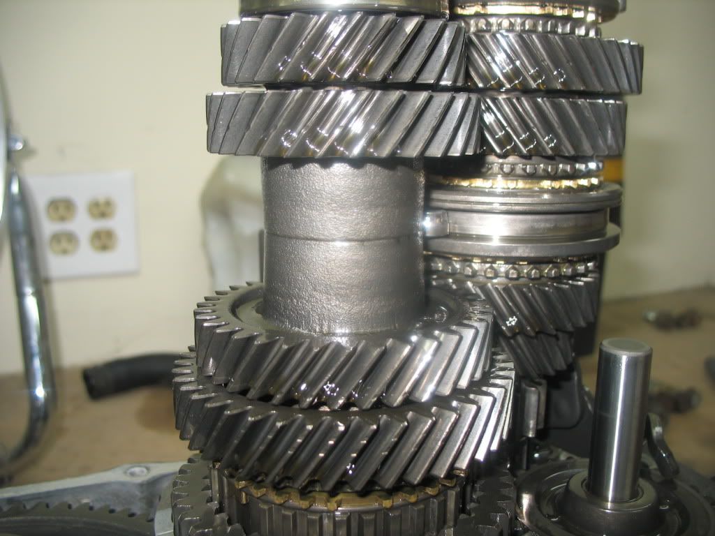

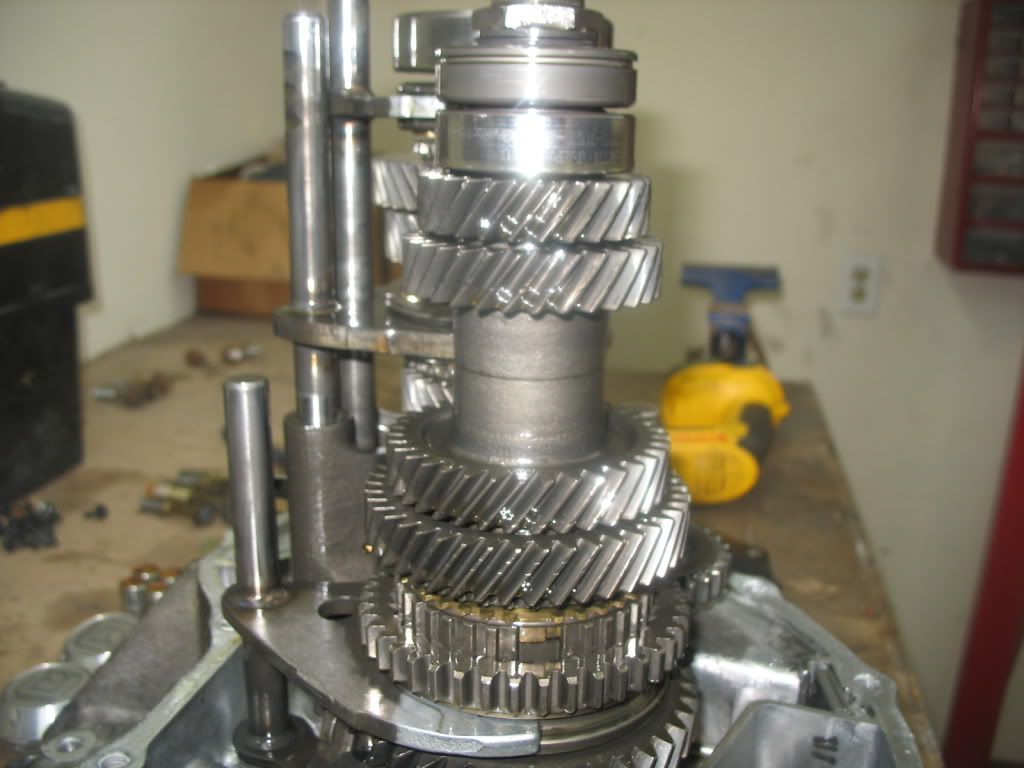

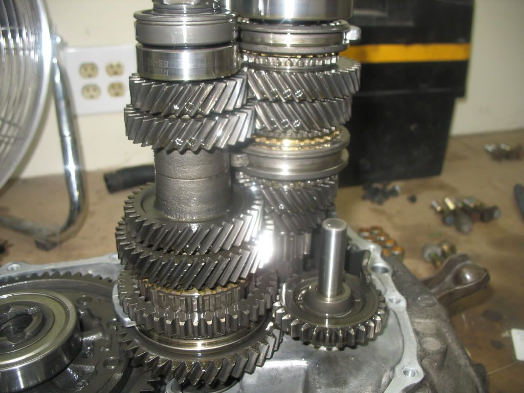

Took me 2 months to get to this...
Just tore into the transmission.  The gear sets and synchros look flawless.  I'm going to get a new ISB and seals for it.  What do you guys think?  I can't see anything that looks bad...
Does this look bent?
Re: Trans Question/ Just tore into it what do you guys think?
« Reply #25 on: September 20, 2009, 10:59:47 PM »
No its not bent. It's fine whats the issue  :-[

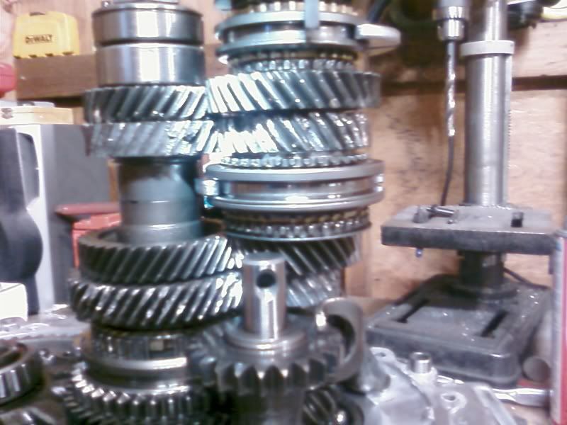

Time for some tech Q & A
The typical 'grinds going into 3rd at higher rpms' complaint is typically caused by the 3/4 synchro sleeve, correct?  That would be the part that looks like this:
or the correct piece in part #4 here:
My question is, what exactly would one inspect if the above complaint is given?  Is it a clearance issue between two components (i.e. synchro ring and gear) or is it a wear issue with the teeth?
« Reply #29 on: October 14, 2009, 02:18:24 AM »
burrs on the hub and slider.....
The slider gets deformed from the engagement teeth on the gear, this in turns causes burrs on the hub, the whole time it is killing the brass synchros.
This is why Honda sells everything as a kit, #4.
If you don't like the price of the kit, it would be like rebuilding a motor and only replacing one rod bearing.
It's gonna come back to bite you in the ass.
