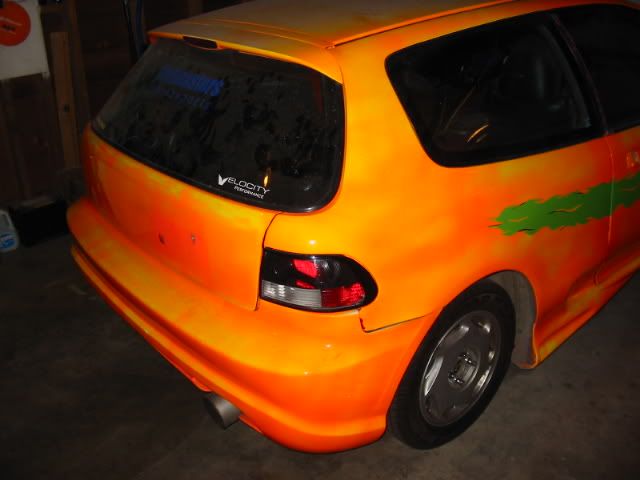

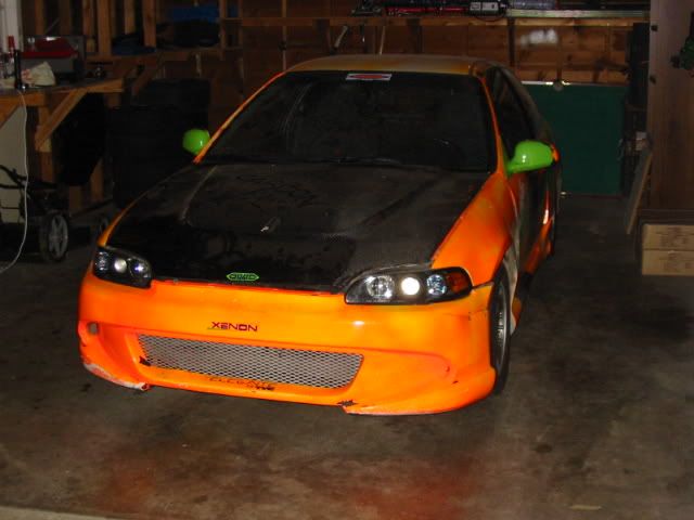

-95 Civic CX hatch
-picked it up from some ricer for 1000 with a blown engine
-Sold the Del Sol seats, sold the motegi (sp?) 17" rims, and sold the blown swap and made my money back and then some, essentially got the shell for free
The day I got her:

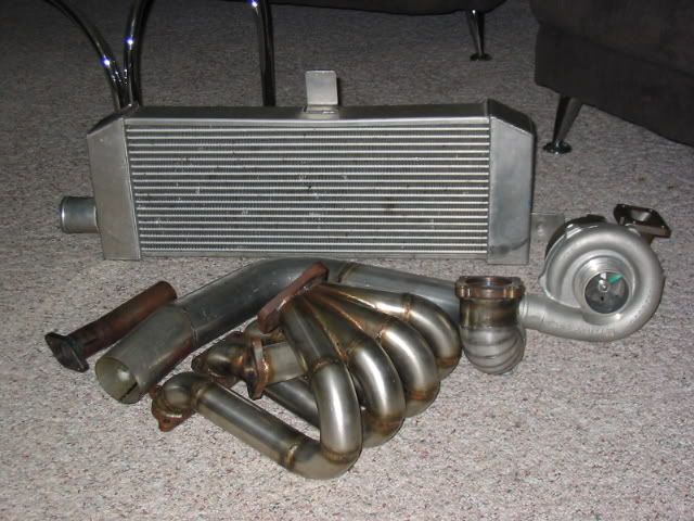

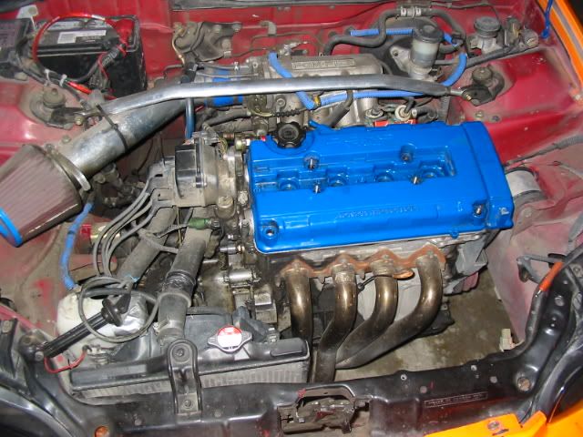

What's going in this ugly thing?!?!?!

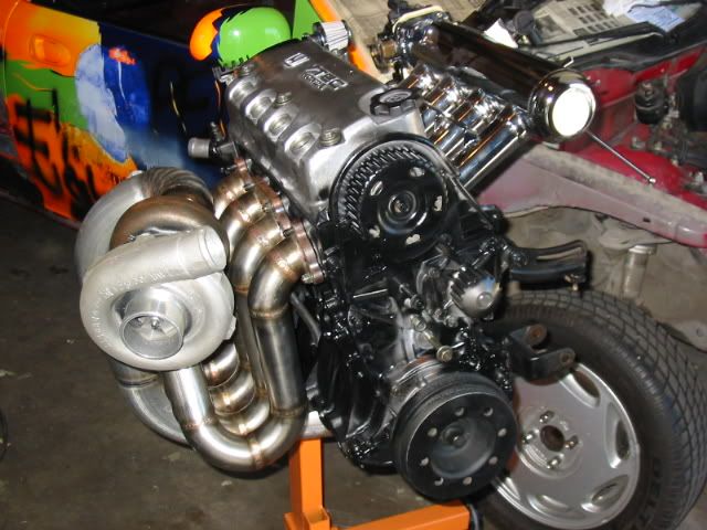

-Garrett t3/t4 .60/.63 57 trim
-SLS backdoor intercooler
-BMC top mount manifold
-3" dp
-Tuner toys rods
-SRP pistons
-JE Rings
-ACL bearings
-Golden Eagle block guard
-ARP head studs
-Zex 59300 cam
-OBX intake manifold (it's gotta flow better than stock, right?) Garbage, just ask JD.  :noel:
-LSD motorsports clutch
-Freshly rebuilt transmission w/ OBX LSD
-D16Z6...yea buddy!

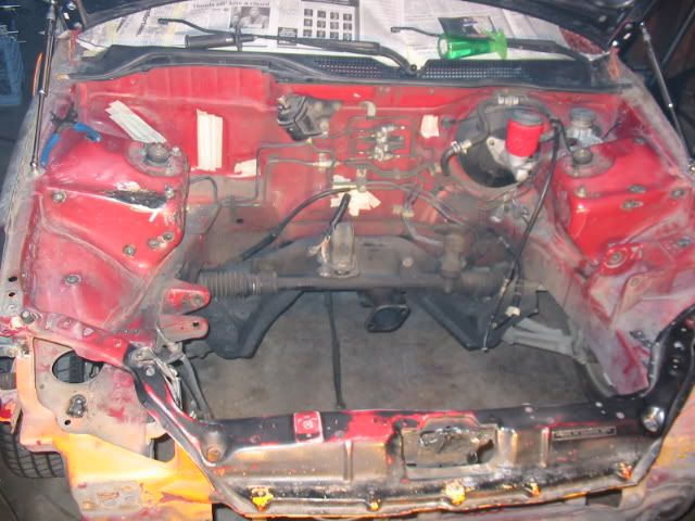

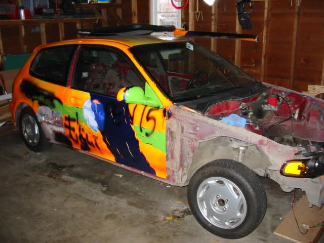

Ugly car:

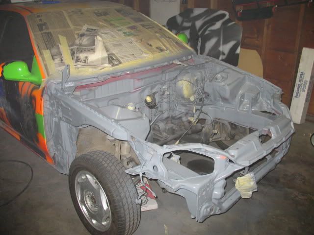

Engine bay shave:
And wire tuck:

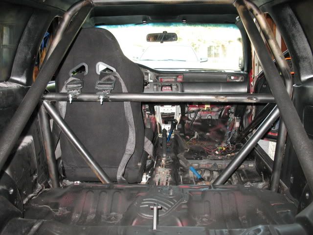

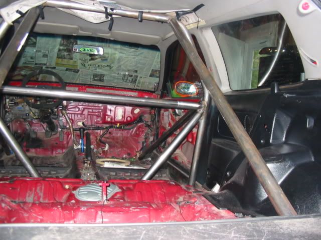

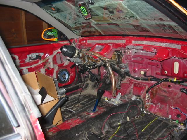

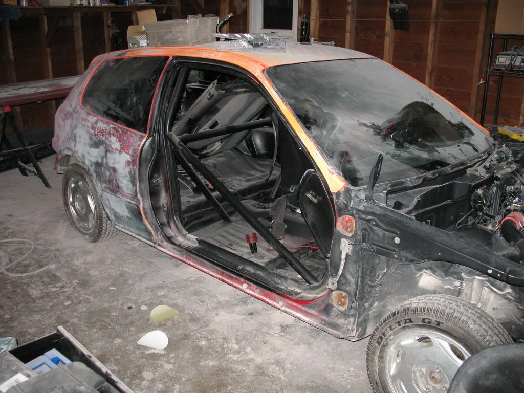

Cage going in:

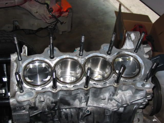

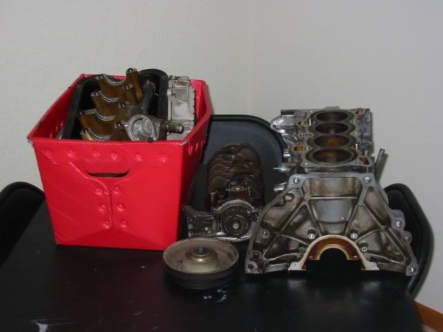

Engine building:
Ready to go:
I got sick of shaving so I gave up 3/4 way through and called it good enough:

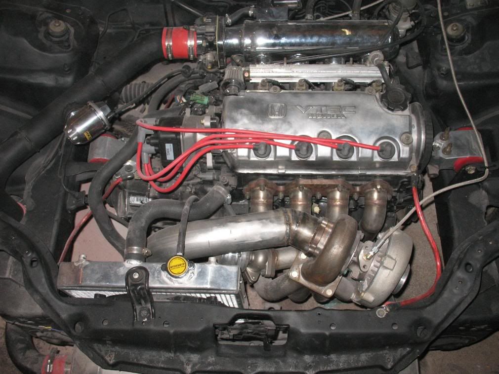

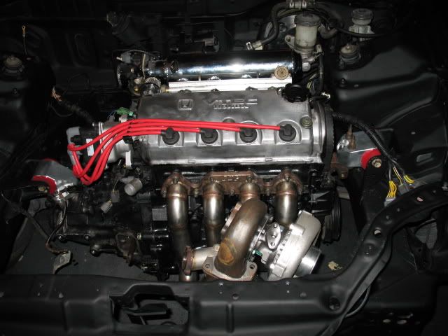

Engine in:

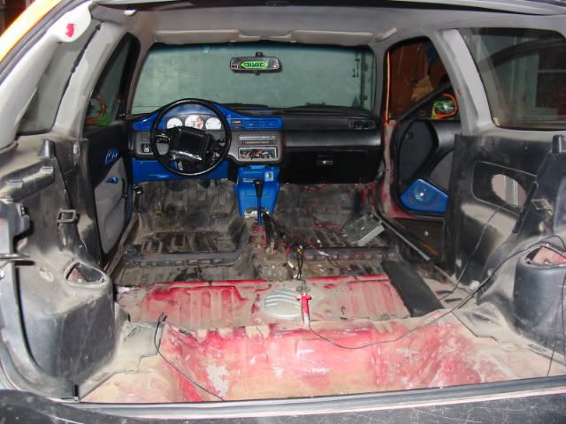

Interior coming together:
Ran out of paint, I have since finished painting interior so there isn't any more red:
Tight fit, but the door panels/cage/seat are all in:

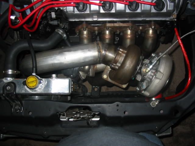

DP had to be modified to fit:

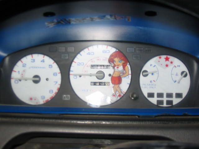

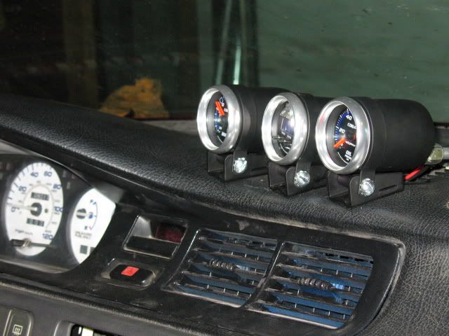

Gauges (need to put a little more paint in those vents):
Body work:
HOW NOT TO SHAVE MOLDINGS!!!:

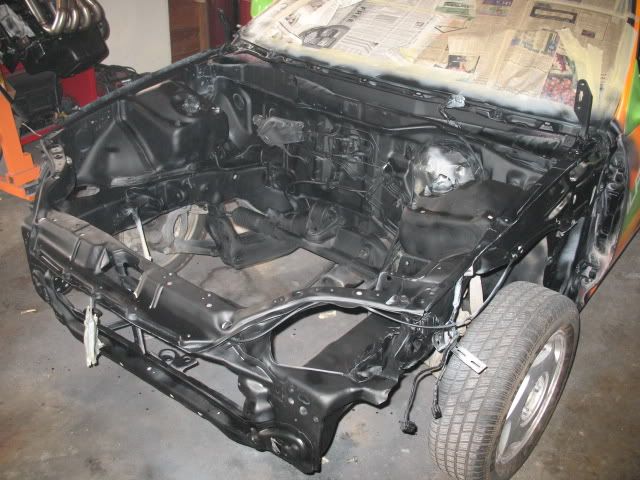

How the engine bay currently looks, and yes, I am going to make a metal upper rad hose due to how close my dp is:

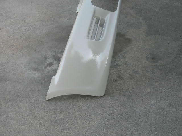

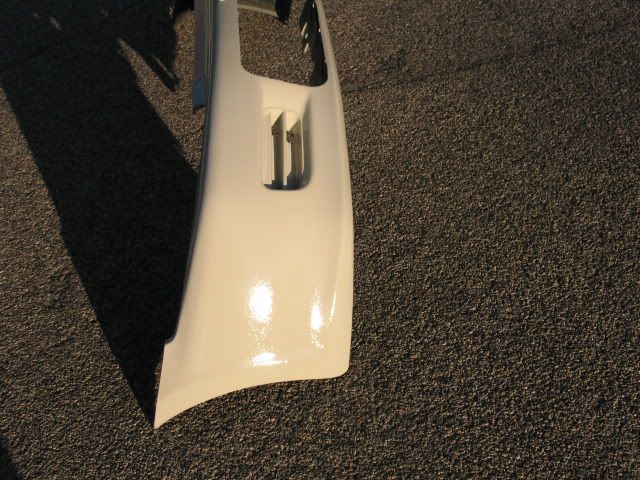

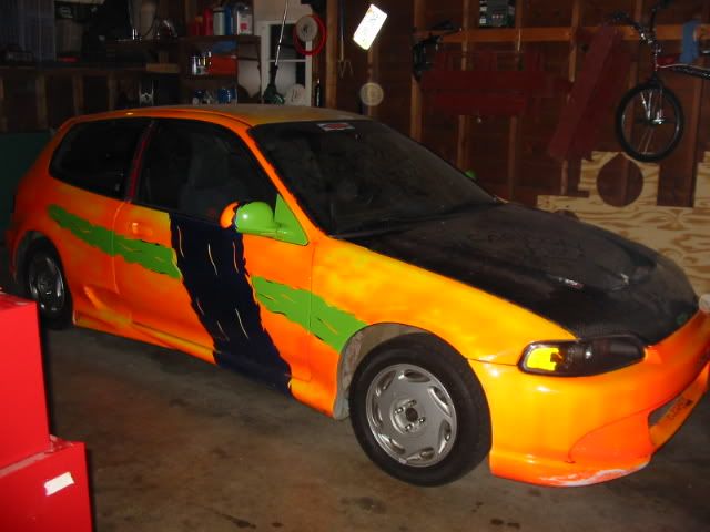

And two more pictures, I did a test spray on part of a junk bumper the other day to get a feel for the color...note I didn't use any primer, i didn't do any body work, i didn't wetsand the paint...I just sprayed 3 coats on to get a feel for the color...yes, it is single stage, yes I'm painting the car with single stage...
In the late afternoon sun:
In the shade at the same time:
darkelvis

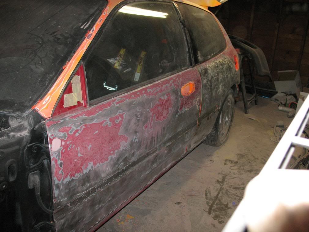

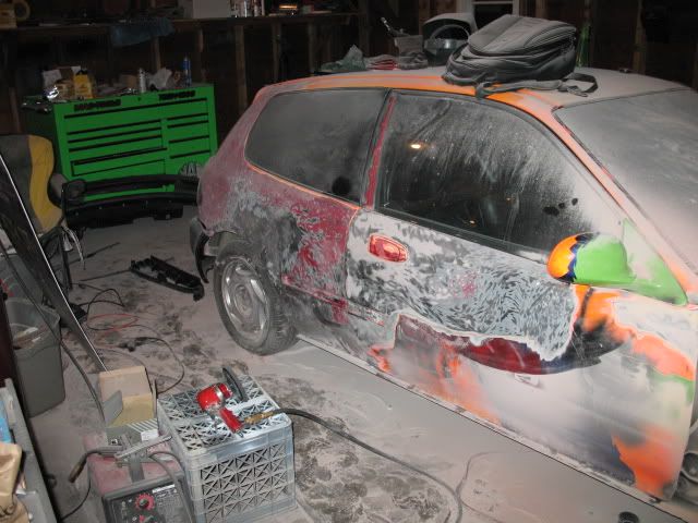

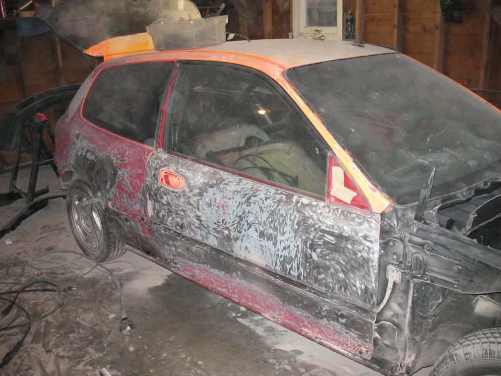

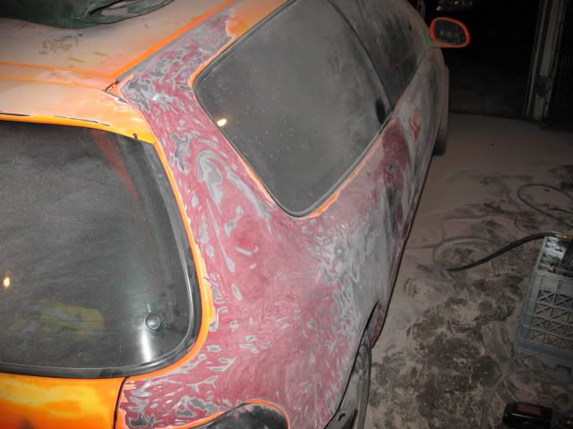

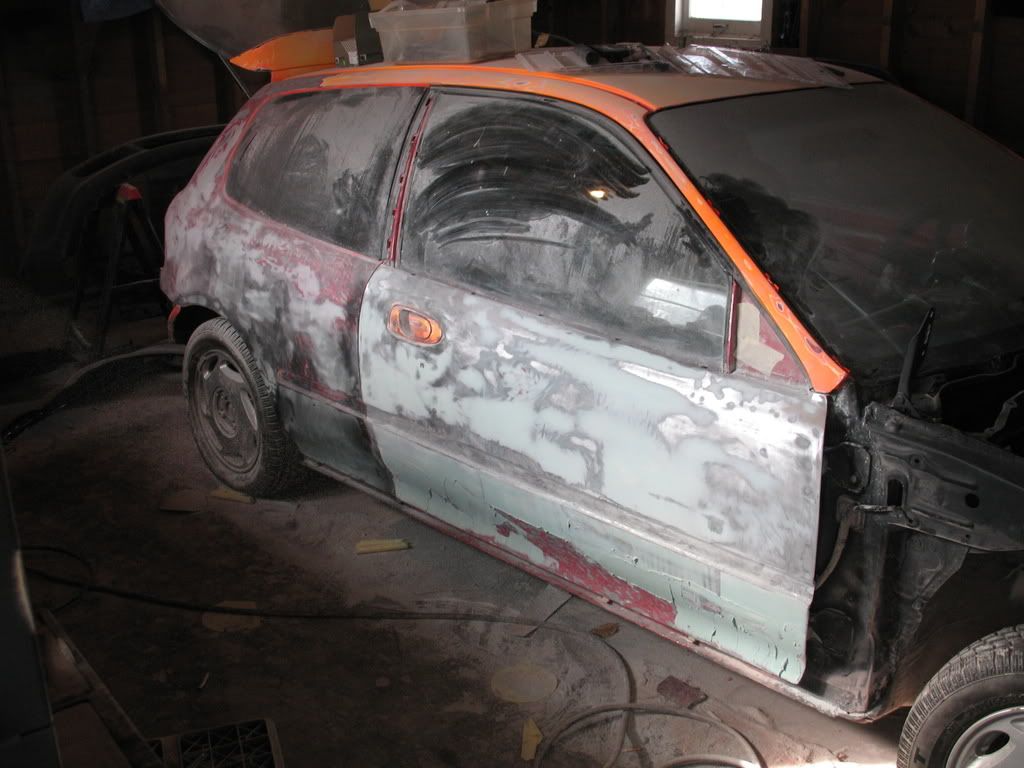

quick update, wasn't as nice out as I was hoping today.  I've got the pass. side skimmed, knocked down, and partially blocked.
darkelvis
  • Posts: 1882
  • RHMT King of Rice
Re: De-ricing the rice rocket....
« Reply #5 on: March 09, 2009, 10:27:20 PM »

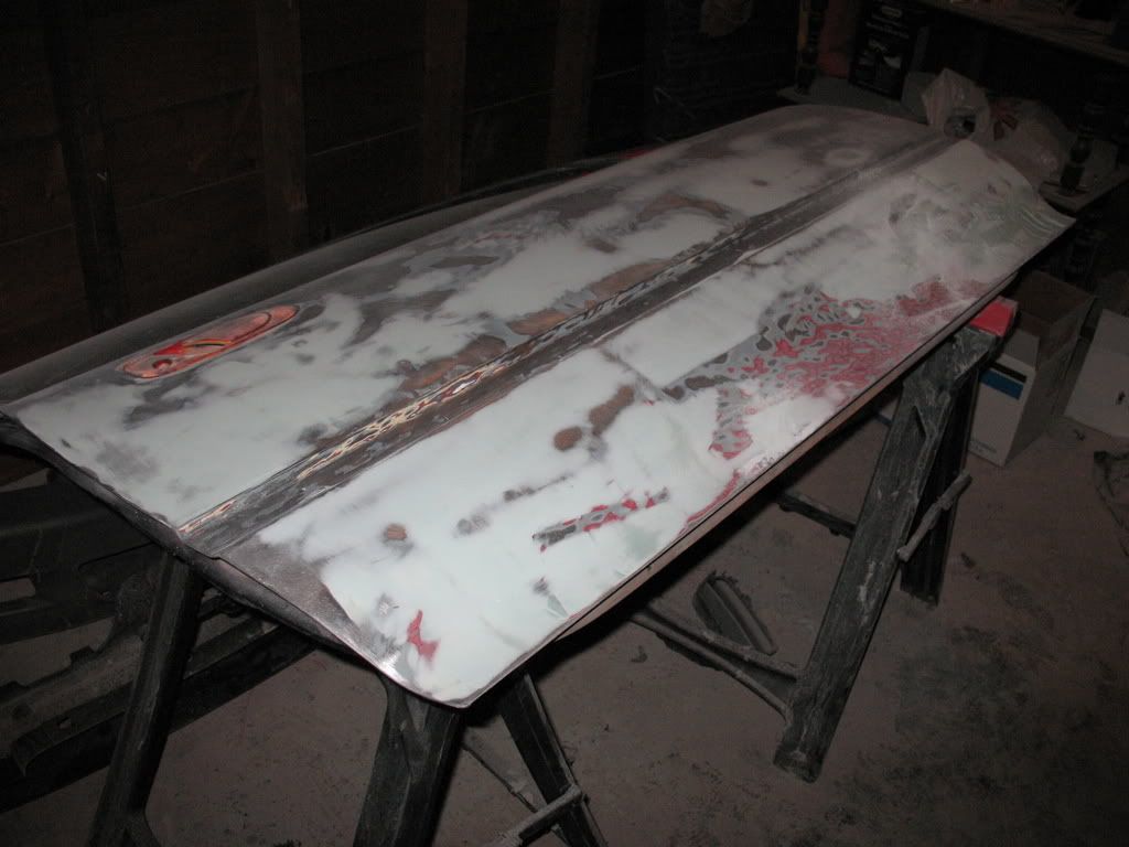

I finally broke down and took off the door so I could block it without sitting on a milk crate and hunching over.  I'll pull the other door off to work on it when this one is ready.

You do some really awesome work man, how much did that cage cost you in materials?
darkelvis
  • Posts: 1882
  • RHMT King of Rice
« Reply #9 on: March 09, 2009, 10:50:57 PM »
bought it from some website and had to modify it slightly to fit, I can't remember the site off hand though...ask stevemode...he has the same cage.  I think it was around $300ish though for it.

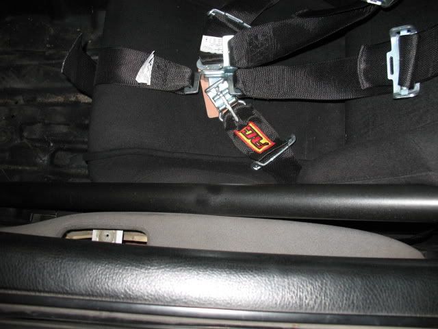

Thank you for cleansing the earth of a riced out POS. Should be solid when done. You head/helmet gonna clear the main hoop and down bars of the roll bar? Looks awfuly close.
darkelvis
  • Posts: 1882
  • RHMT King of Rice
« Reply #20 on: March 10, 2009, 05:10:11 PM »
I clear the cage, although I am thinking about making new seat brackets to lower the seat a little.

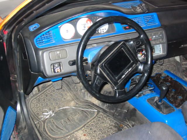

I forgot how ugly it was to begin with, and my god man it has a blue dash.
had....had a blue dash..
