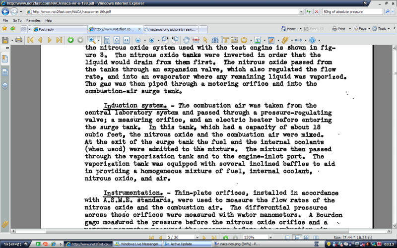

« Reply #46 on: June 30, 2009, 04:21:55 AM »
NACA papers are handy, sometimes wrong since a few of them are concatenations of theory and not actually based on testing, and you always always always have to take them within their context.  You dropped the ball on the last bit, sir.  Don't worry - so has everybody else.
I very much can argue that it doesn't play a significant role if you aren't injecting the nitrous in front of the compressor.   Nobody does that.  Think about it.  You are always and forever compressor (and turbine) limited, Thomas, and if the compressor sees hot air the turbocharger's efficiency at compressing it is lessened, regardless of how much of a free ride is coming across the turbine.
(for the record i had a 98 page essay typed as a reply to you, somehow i deleted the shit, and heres the condensed I'm piss'd off to the point version)
 I understand the difference between concatenations of theory and real world testing.  There was no ball dropped on my end on this one.
  I read the test, there was no turbo or supercharger involved. The nitrous was injected in a constant pressue manifold(50hg) which would mean that applying the results of this test to our application would mean it was after the turbo would have compressed the air, meaning into the charge pipe or intake manifold.  NOT the inlet of the turbo.
   And i agree that once a exhaust port/sides  flowed/choked/maxed out , theres no way to make anymore power, which was the case for scotts car.
  We can argue all we want about this, talk about how nitrous changes the VE of an engine bla blah blah but there is more than any of us here can completely explain going on when using boost and nitrous.  Any way that its argued,  it works great.  O0
