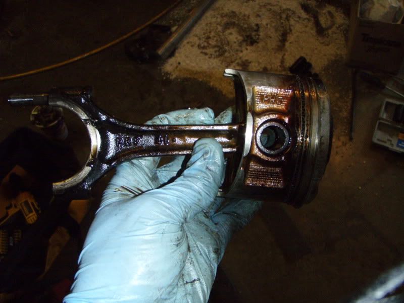

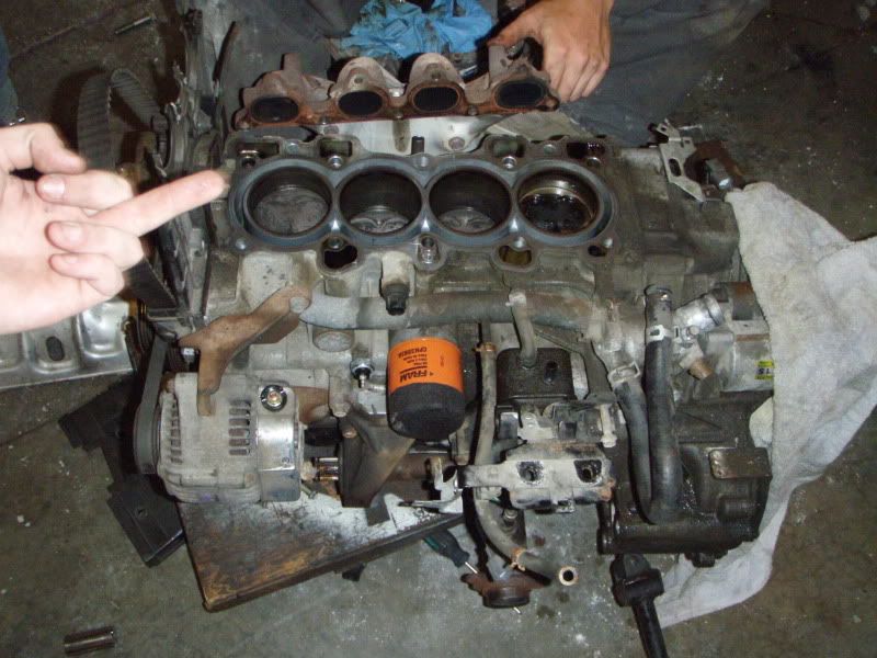

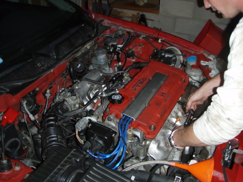

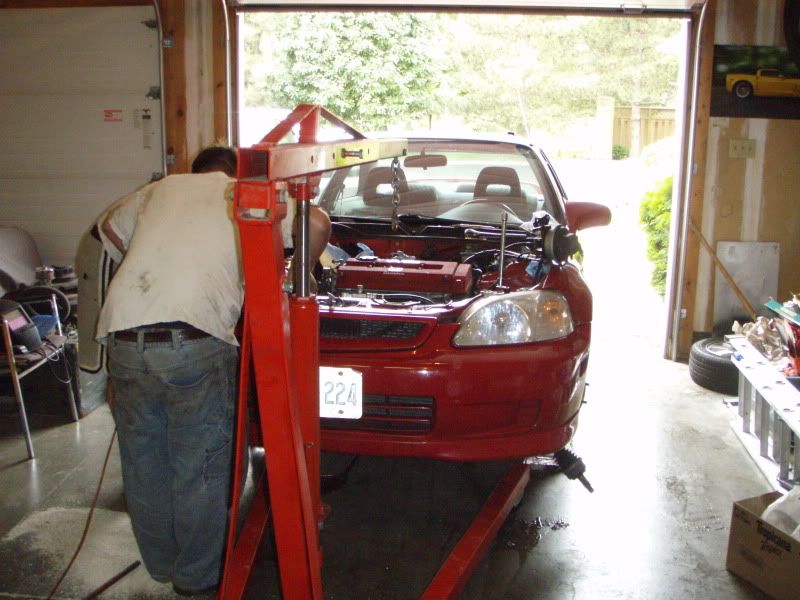

dvst8r wrote:
buy a ricey car, get ricey results

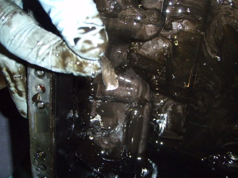

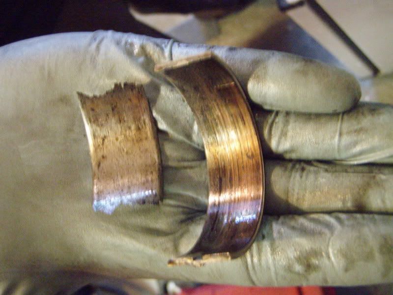

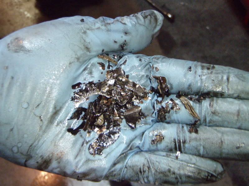

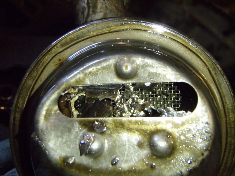

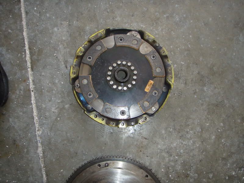

and just like that , less then 2 weeks after buying my 2000 SiR civic the motor let go tonight lapping..
5 laps in ...clack clack ...oil light flashes , check engine light and she stops dead.

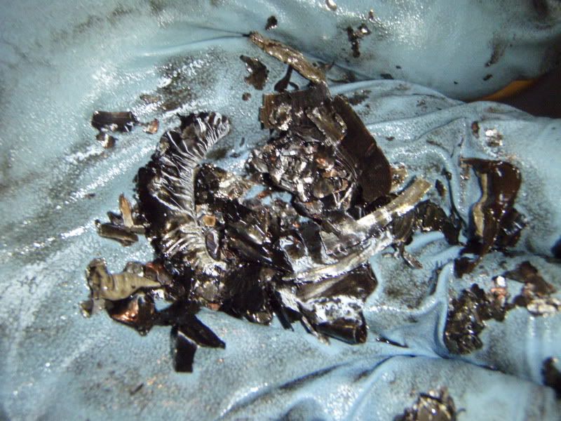

how bad , I have pics of metal shavings in the tip of the apexi N1 exhaust!

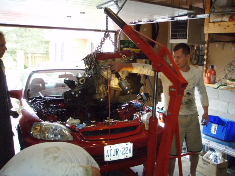

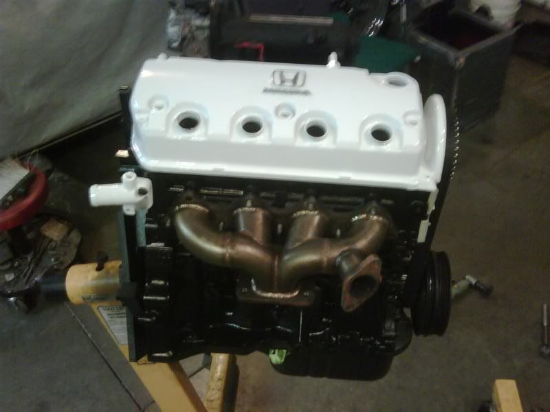

gonna pull it out tomorrow and swap in somethin new Another B16
Ultra low mile ...smokin good deal B16A3 <- Fuckin minty fresh shortblock
ACT 6 puck unsprung
new headgasket
ITR Oil pump
and an oil pressure gauge...
Tapped the pan for a Drain :)
Gonna Turbo it now that I know the motor is good.
This is from Friday night until last night @ around 11:30.
Done

That manifold looks good untill u see the WG placement  :?:
It was the night before I left for GRM on a 30 hr drive. THe Rb25 T3 I had puked and I put on the t04E from my corvair. I wanted to make sure I could have the manifold fixed easily , so that's where I put it on.

Got another B16 for $100 (shortblock)
cometic HG
ARP rod bolts
Valve Seals
gonna throw it in tonight.. May as well tap the oil pan for the obvious next step.

I needed it done by Sunday night , I had no choice and for boost the B16 is far better then a B20 (from what i have read) in stock form
no one had stepped dowel pins for an LSV or B20 Vtec Swap. No access to a machine shop on the weekend and I didn't want to drill out the head by hand.
Wrong.
Ask JFK78, of Vitara power record fame.  We compared notes and his are the same as mine - 50% of B16 at the 300+ whp level break a sleeve, and no broken B20 sleeves yet.
