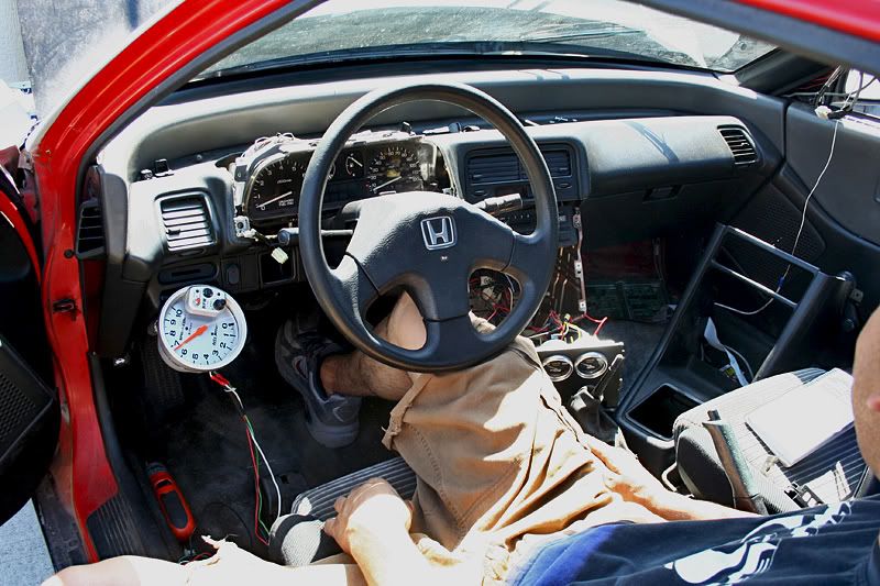

wiring in a tach, in case the stock tach goes out on us again. It's blown that fuse a few times already.
