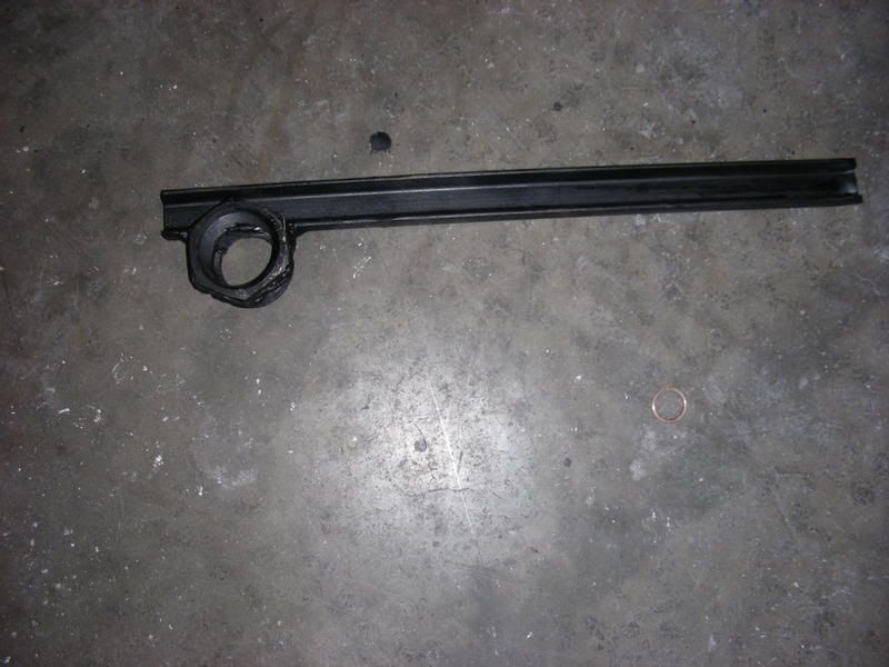

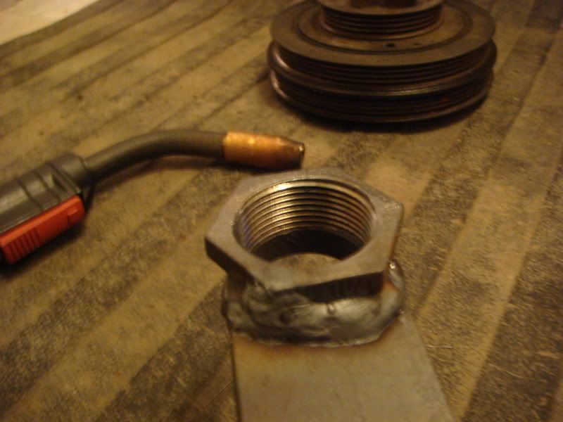

You need:
Welder
Grinder
Steel bar of some kind , round flat..doesn't matter, just make sure it's rigid.
 Plumbing fitting.. I forget the size. But measure the hex opening on the pulley and go to home depot and get the same
Instructions:

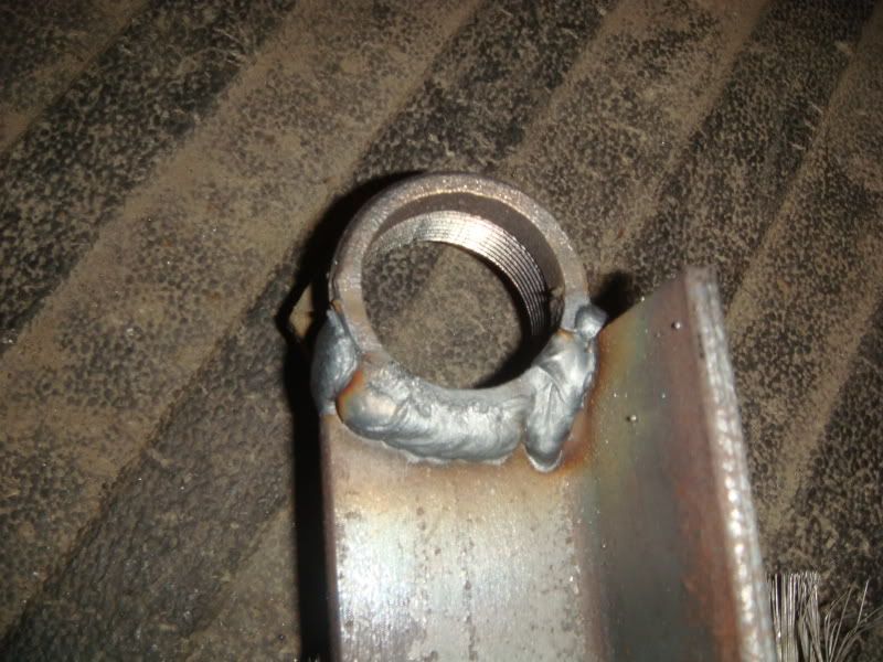

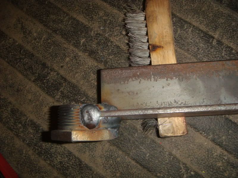

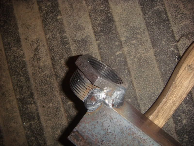

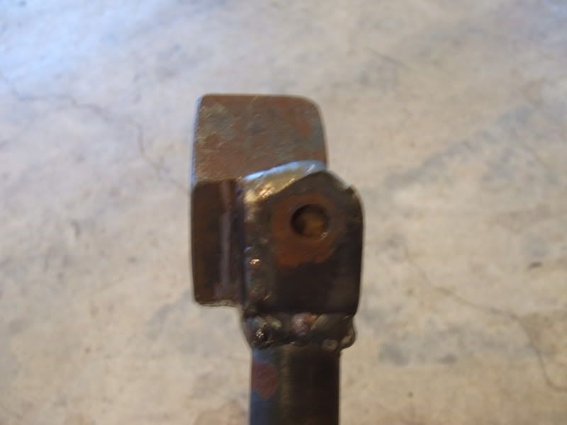

1) Grind out part of steel bar so fitting sits somewhat inside
Weld fitting to bar...
 use...

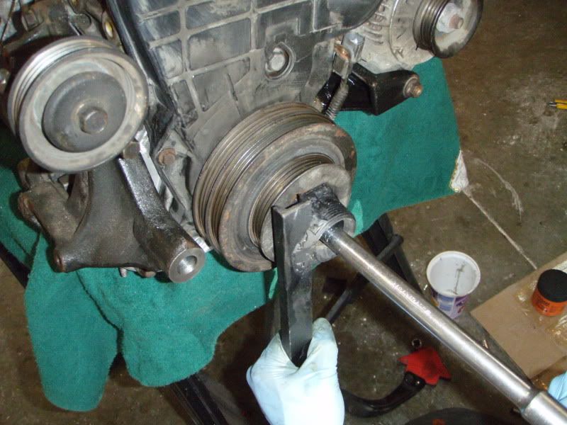

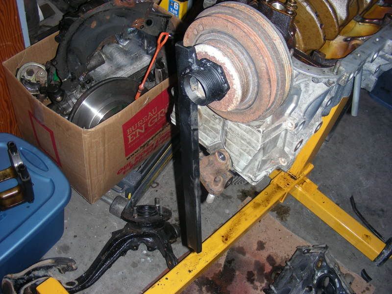

Paint if neccessary.. My old man made this one and he paints everything ,then hangs it on the garage wall.. Old man not needed

I'd rather have the DIY type, that way you can use your breaker bar on the crank bolt.
Luckly I've never had to pull it off in-car. I made the flywheel tool that engages a tooth, so it will snap a grade 10.8 bolt before moving.

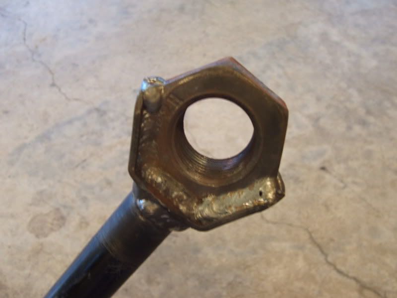

I think the hex is some metric size, but 2.00" fits it pretty good.
I made one with a 2.0" nut, and junk shift linkage i had:

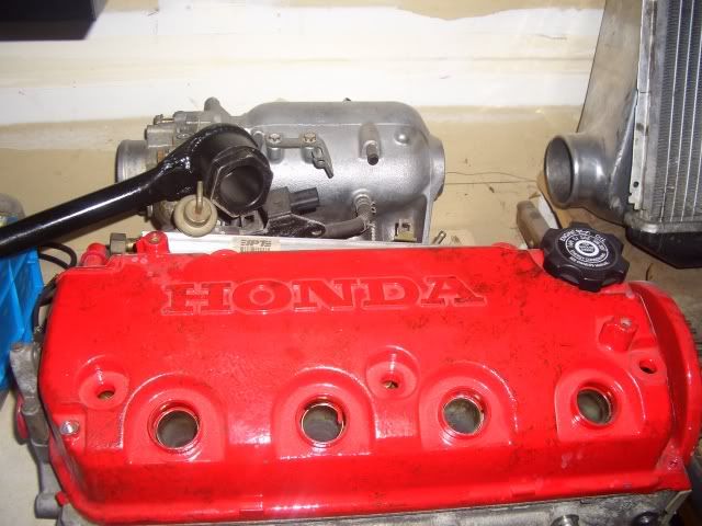

I just made a 1.5"x1.25" bushing-style tool, mother fuckers who owned this H22 last need to die in a fire. Bent the bushing AND 1/4" angle iron (welds held ;D), and bolt didn't even budge with me BOUNCING on a 4 FOOT extension. Once I impact'd it out, come to find out there's nary a drop of lube on the threads, contrary to Helm's requirement. Fuck clueless honda owners. /rant
Found out they built a Fastenal less than a mile away, got a pair of "heavy hex nuts" in 1.25" thread size, fits perfect. A regular nut is only 1.875" OD, heavy hex is cunt hair under 2" OD. My grandpa is machining one down to fit in the h22's tight space (and an impact socket just in case), so I'll post pics later. I'll also snap some of my flywheel holder. A real gem when the tranny is removed.
