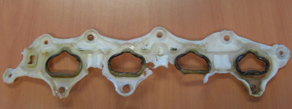

Basically do the cheap ones get destroyed like that or are they full of shit?
I would like to see the res of the motor. I bet ya it fucking ran out of coolent and they drove it untill it overheated and locked up.......lol
It also looks like they left the stock gasket on and bolted this one on top.

Most people are using a very cheap plastic basically sheeted pvc. Any of the cheap white plastics gaskets are suspect.
I already did alot of redneck engineering with plastics+toaster oven
Stay away from the white material gaskets. Someday maybe Ill actually do a write up on my findings but thats the best advice I can give you guys in a short simple answer.

The white shit people use melted at 200 degrees in my toaster oven and gave off nasty fumes. Then crystalized and I shaped it into a ball with tongs. it has held that form ever since. The cheap white shit is basically pvc

god hondata is a joke. i have NEVER seen a cheap plastic gasket do anything like that. they indent the flange shape a bit but thats it.
this is boosted and n/a cars.  seriously if the white ones melt your doing it wrong. :?:
