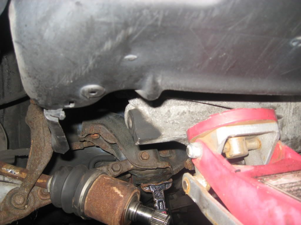

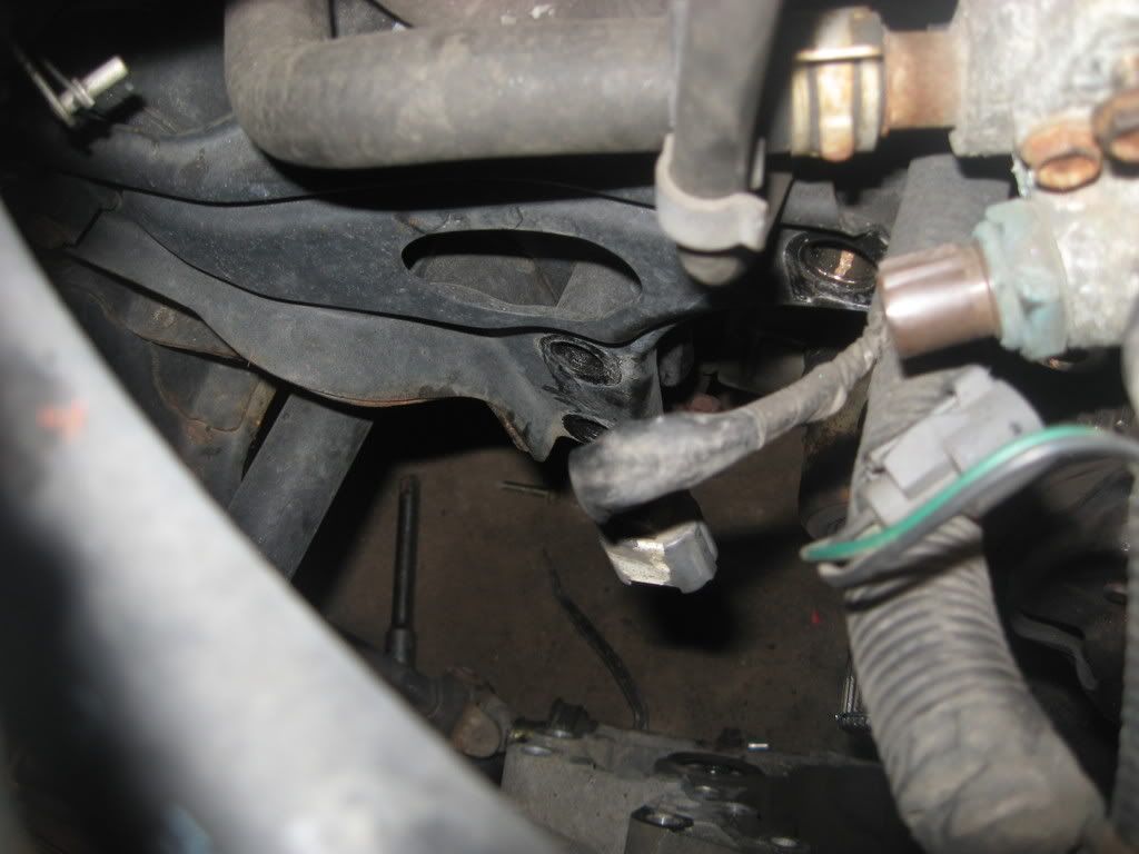

Jack up the car take tires off  then remove lower ball joint (easiest with a ball joint fork)

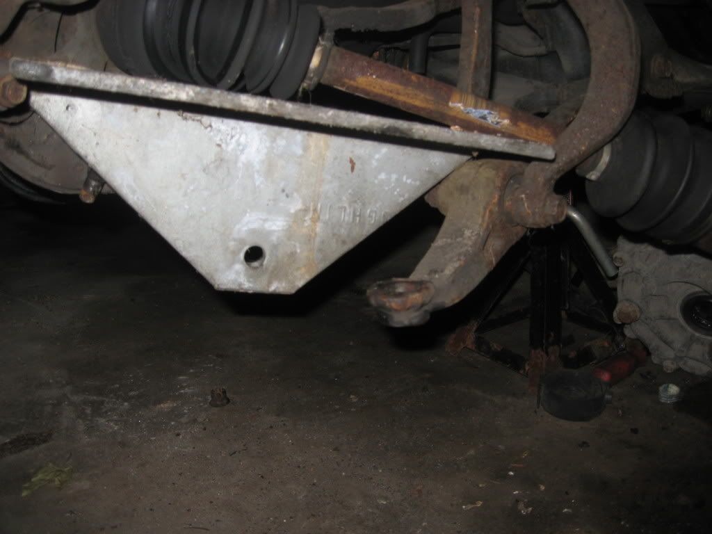

 and pick up whole knuckle assyembly and move it to the side.
i then drain tranny fluid and pop axles out of tranny with a prybar.  i used random shit to stop the knuckles from moving back in place.

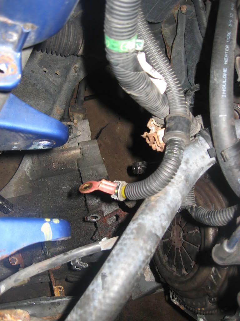

Remove intake tube and starter 2 bolts for the starter Must be removed or tranny Wont come off.
 Also a good idea to unplug harness from the head for the coolent temp and all that other B/S Unplug battery and all ground from tranny to Chassis remove lower tranny mount 3 bolts.

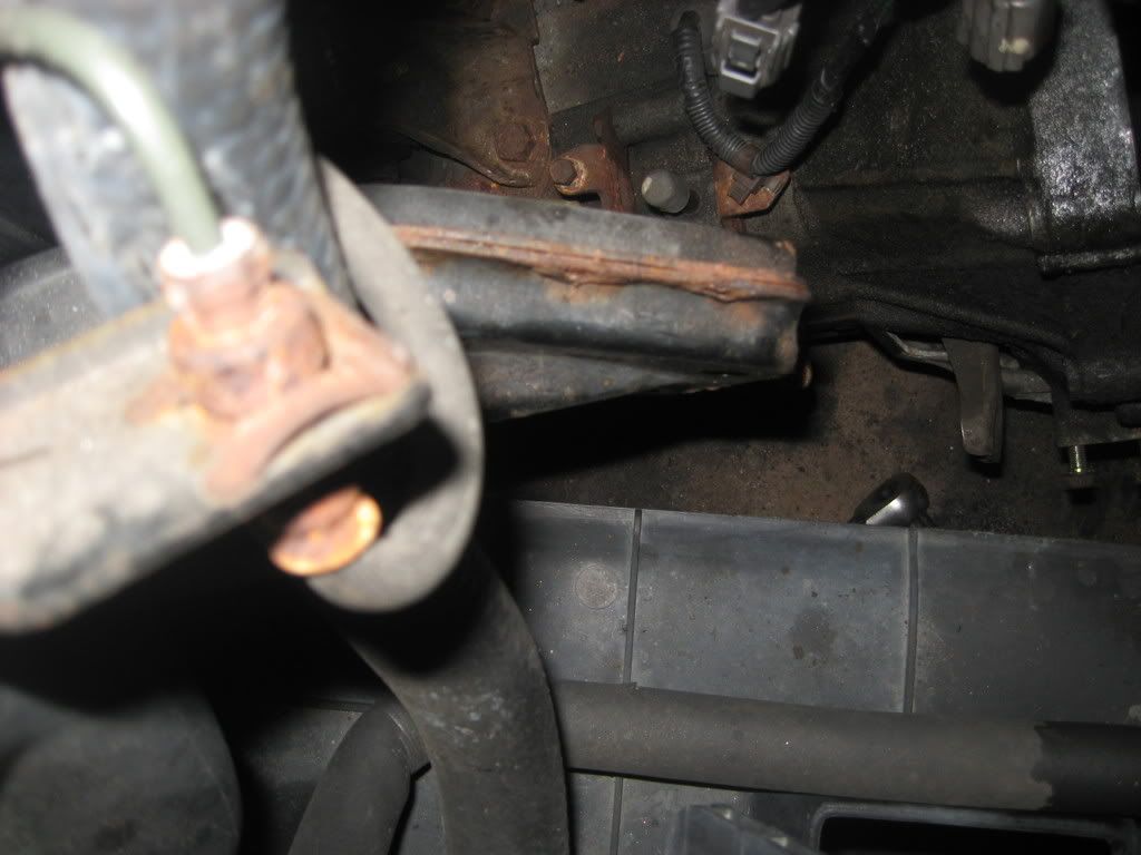

Now after that near where the starter was remove 1 bolt from the Rear T bracket while.
Then get under the car and remove the 2 bolts that secure the tranny to the T bracket
1 bolt for the shifter stabilizer.
If you dont want to fuck with the bitch pin then remove 2 12mm from the Shifter linkage it self.
( Motor should be swing like my nuts  W/ stock motor mounts).

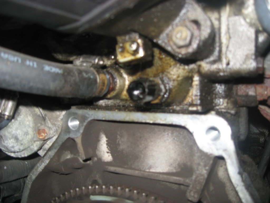

Then remove 7 Bolts from the transmission 2 on top 2 front side 1 rear and 2 for the dust shield
And 1 bolt from the passenger main motor mount.
 7 BOLT PICS WILL BE UPDATED.You should now see the seal from the block to tranny open a little bit.

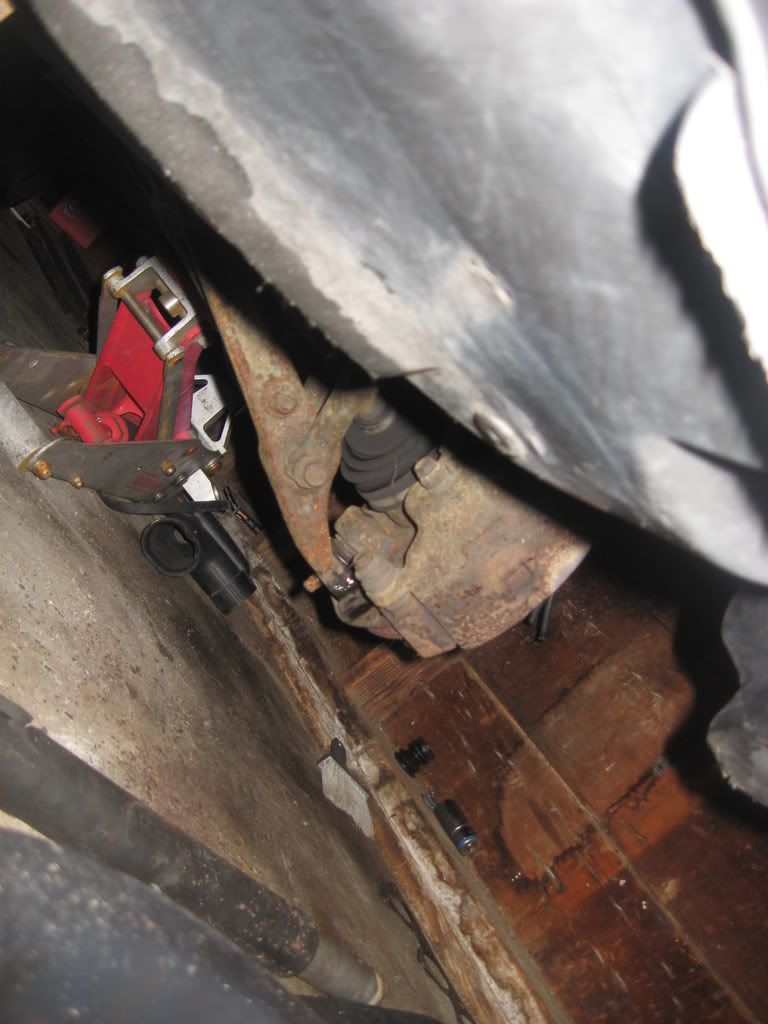

Secure the tranny with a Jack lower it and the trans should basicly fall off now ( may take some rocking)
drag that bitch out the way and jack the motor back up secure it with a jack stand.

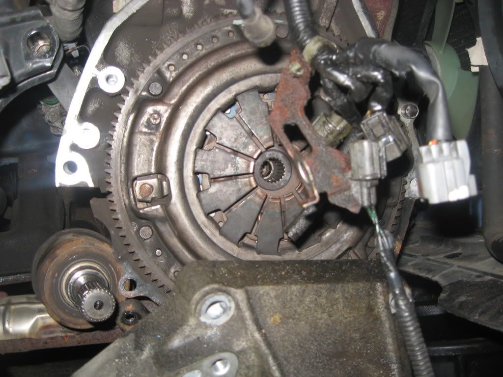

to remove Clutch there are 6 10mm 12pt bolts the are kindoff a bitch to remove
 if you dont have air tools what i did was start from the bottom
tap a Wrench with a hammer till they came loose.
 i didnt use the alignment tool eyballing it is a bitch
basicly dont over tighten the 12pt bolts they will snap.
You can choose to get the flywheel surfaced i didnt b/c this motor will be coming out in a few months.
