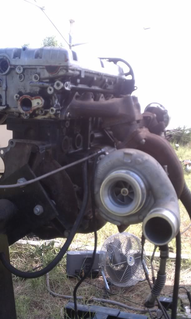

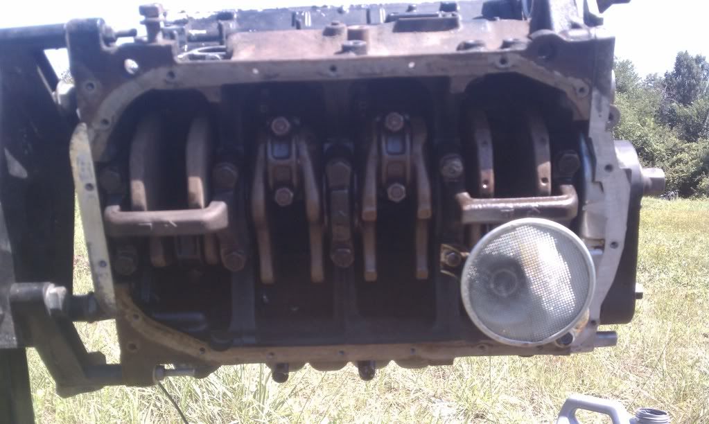

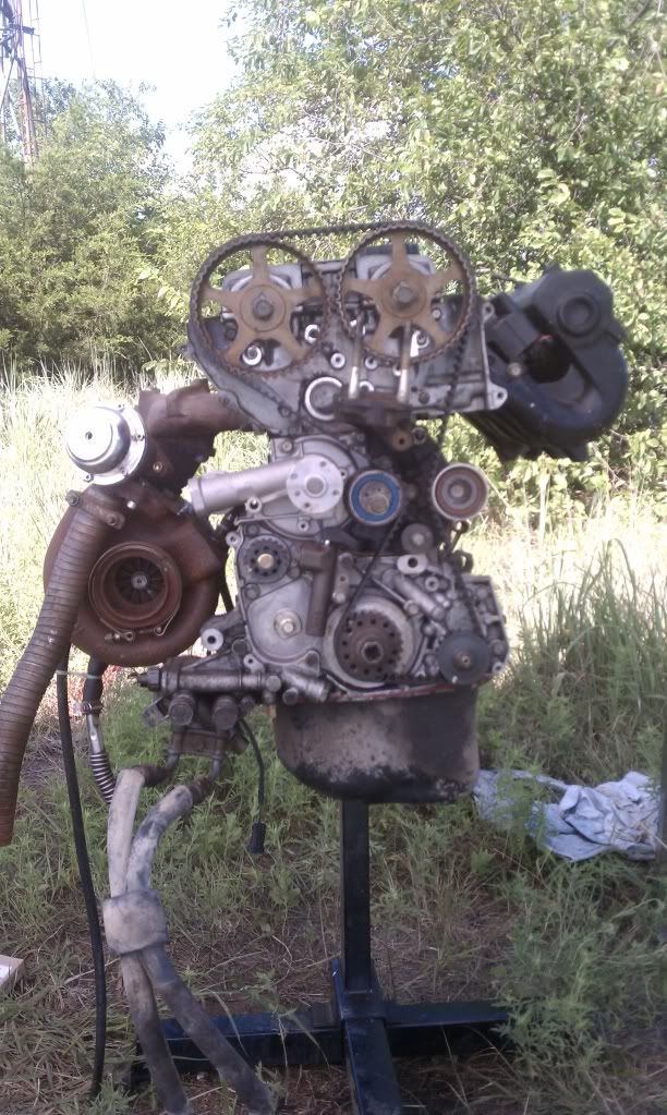

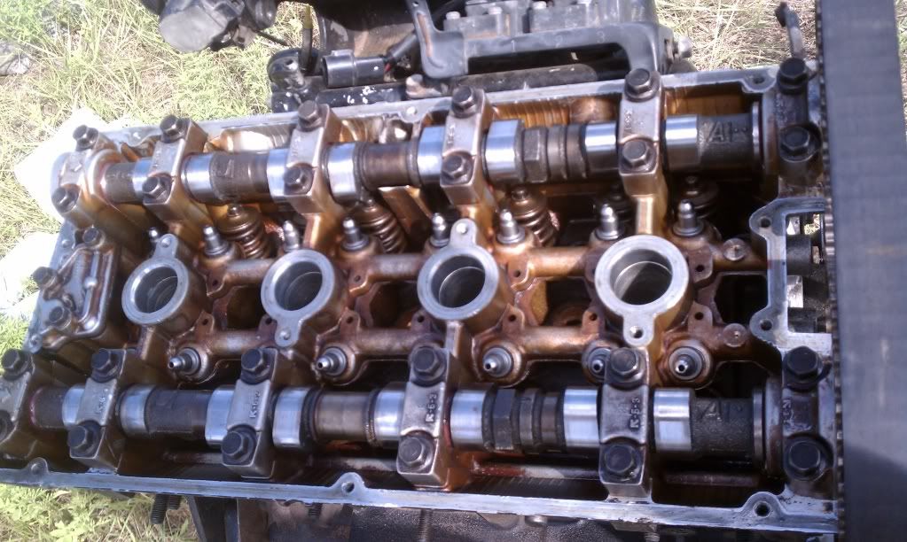

Making some progress finally. Stock 6 bolt motor until I get wiseco piston BS taken care of and my stroker back.
Stock high mileage 6 bolt bottom end.  Taken apart, inspected, cleaned up and reassembled.
Stock cams, high mileage head with new valve seals and new revised 3g lifters.

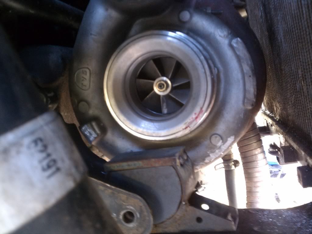

Mocking up the turbo and manifold, just for my benefit lol.
Got the cyclone intake manifold on the way, stock 2g till then.

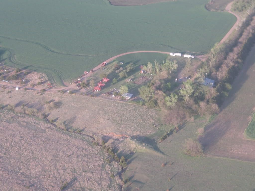

I just realized I don't have any good ones.
Its not a particularly pretty place. 140 acres of land. grow wheat mainly, 70 is covered by pasture from the CRP program.  Only livestock we have is a horse( my parents are hippy-ish vegetarians).  Most of our farm related stuff we do is local custom harvesting of wheat, soybeans and milo.
Half mile long driveway winding along the tree row.
Here are a couple shots of part of it from when I went flying over it last time.
My DSM is parked under the apricot tree just to the top of the three red combines lol. Which is where all the current work is being performed.
The windmill my dad built from scratch, mine and my brothers names painted on it.

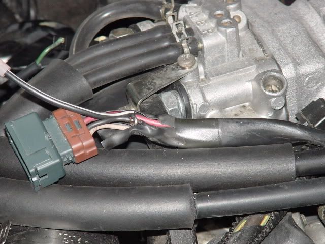

So I got the CAS thing fixed, except for needing a new connector, the one I got with the CAS is half broken and I don't trust it. My old one was a 90, and the replacment is a 91+ with a different connector.  Anyone have a junk 2.0 1g 91-94 DSM laying around with a good connector?
take a pic of said connector..I may have one for ya

The plug is shaped like this 4 pins.  Top left. http://www.roadraceengineering.com/eclipsetech/justin/CASwiring.gif
Here is a picture of it.

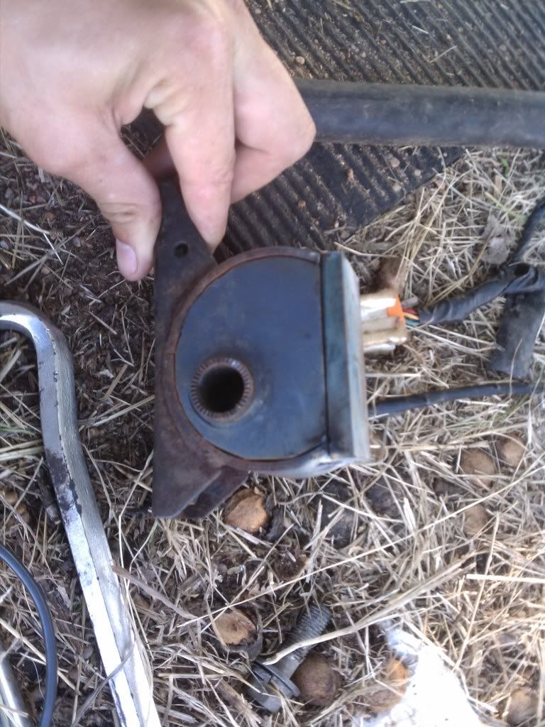

So I solved the motor mount/compressor inlet interference problem tho CHMT way.  :noel:
Lopped off the top of the mount with the chop saw.
