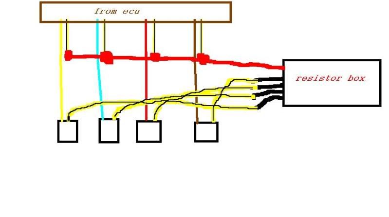

Maby he meant harness not ecu. Thats the way I did my resistor box
